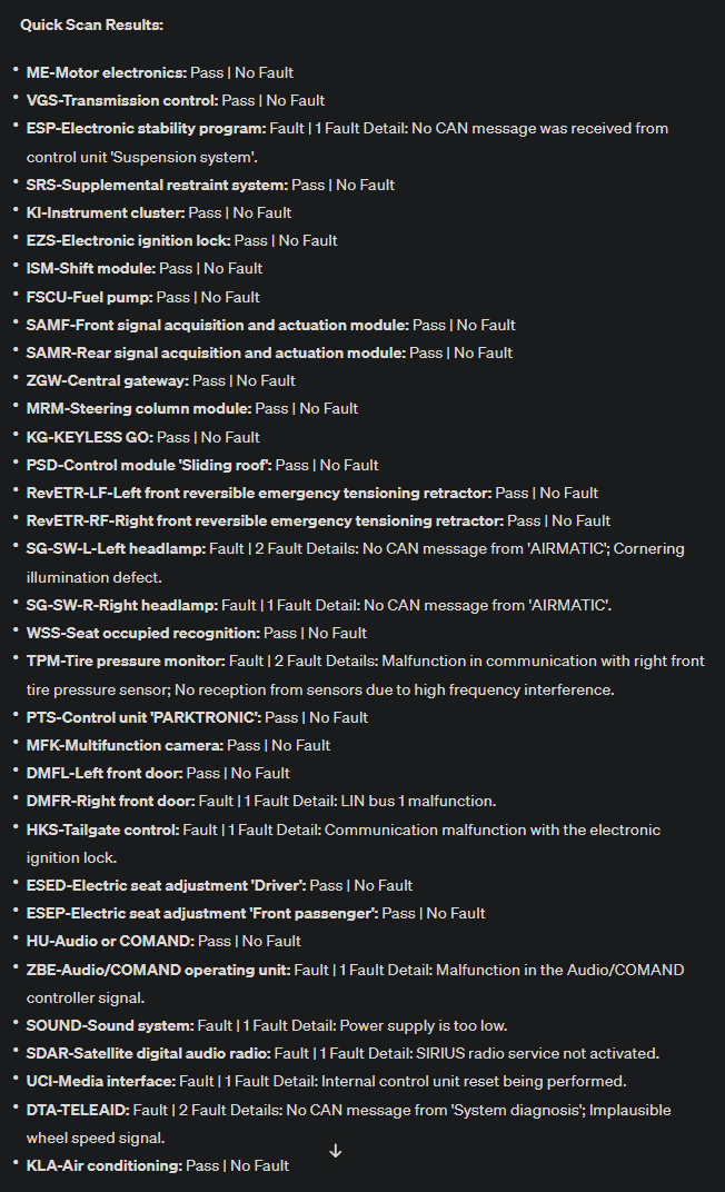

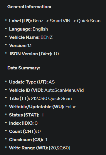

Quote: I attempted to get data from the Mercedes-specific scan tool.
The tool dumps raw data onto a memory card. I've attempted to de-obfuscate the data:
"Vehicle Version"
"System Data"
"System Data" continued

Overall it's a fairly clean report. The only concern I have is with ESP due to AIRMATIC issue. This can impact ECU ability to use CAN-C .
The radio and TPMS are in CAN-B... mostly unrelated to ECU besides SAM for Batt sensor.

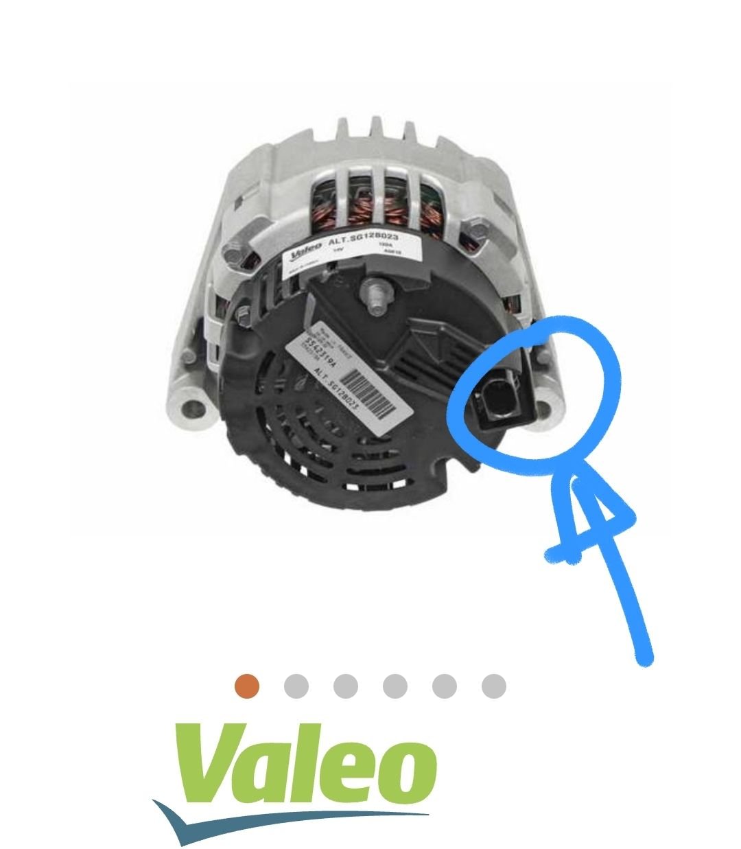

Poor ECU control of LIN Alternator leads to low voltage.
The shortcut is to unplug the ALT connector to get 14V internally regulated by ALT itself.
control connector slot
> ALT uses 2 cables:
-- 1 large cable bolted on: don't touch big red!
-- 1 small connector: unplug that one!
Measure voltage with engine runing : 13 to 14V.
Confirm poor voltage problem solved?
Fixing that involves a time consuming GND cleaning campaign. First i suggest to learn to display battery vitals on dashboard using steering wheel keys.
> ALT uses 2 cables:
Having a good power supply will let your chassis operate under normal conditions.
