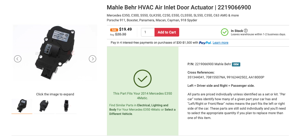

You might try this: https://mbparts.mbusa.com/oem-parts/...tor-2219066900

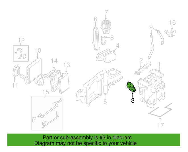

2219066900 is the correct part number. I don't know what is involved in replacing it. Apparently, you just remove the glove box and access the actuator motor from the side that the glove box is on. The instructions are in document AR83.10-P-2001CW.

I have replaced the Actuator 2219066900 and everything is ok.
The location for the central vents motor location is not side to the glove box(This one is for Foot vents of passenger side). The correct location is close to driver side so you have to remove the panel in the driver side to access it and replace.
