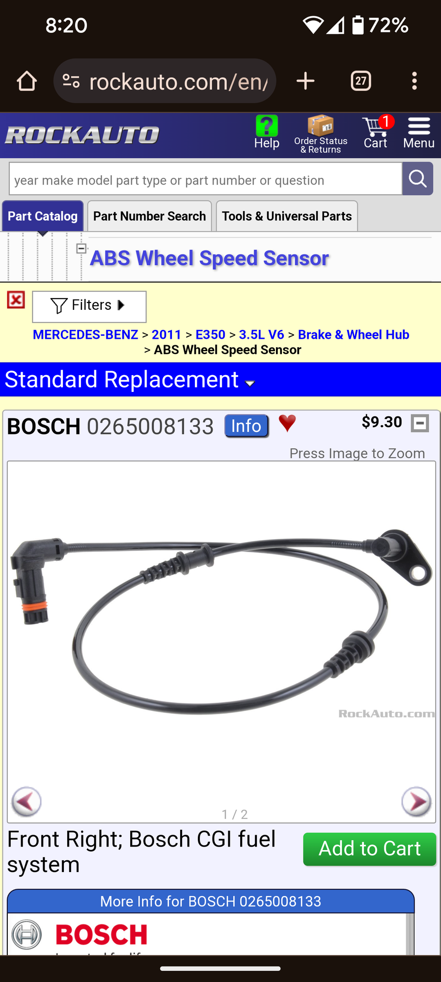

Hey all
finally got around to replacing the front wheel speed sensor.I used this bosch sensor from rock auto and problem is fixed..This only cost 10$ and I'm sorry but bosh who's been around forever and was 35$ cheaper then original Mercedes sensor..Here is part number if anybody needs...Could not tell difference between the two visually..

Sweeet ..... now I know what alternative to buy.
Damn US$10 for a genuine Bosch, that is so awesome. I thought you got some funny brand when you said US$10
In my country this Bosch will sell for US$35 ish.
MB indonesia charges U$80 or so for MB branded one

Only reason I went with the Bosch is because I wasn't positive that it was the sensor..So figured spend a bit less.
So far so good..Car is now back to perfect..
