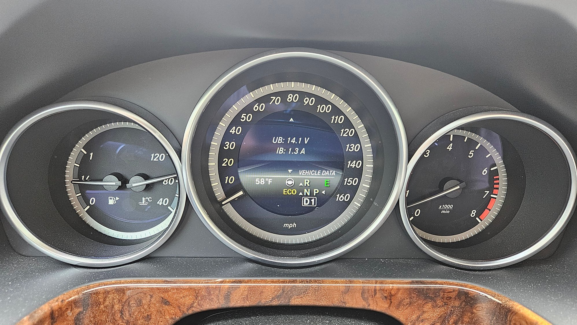

Originally Posted by Leland Bowen
Question raised because of my 2007 SLK 350 owner's manual page 162.
The difference is astounding.
E-mode defaults to 1st gear
Starting in 2nd gear runs longer...
