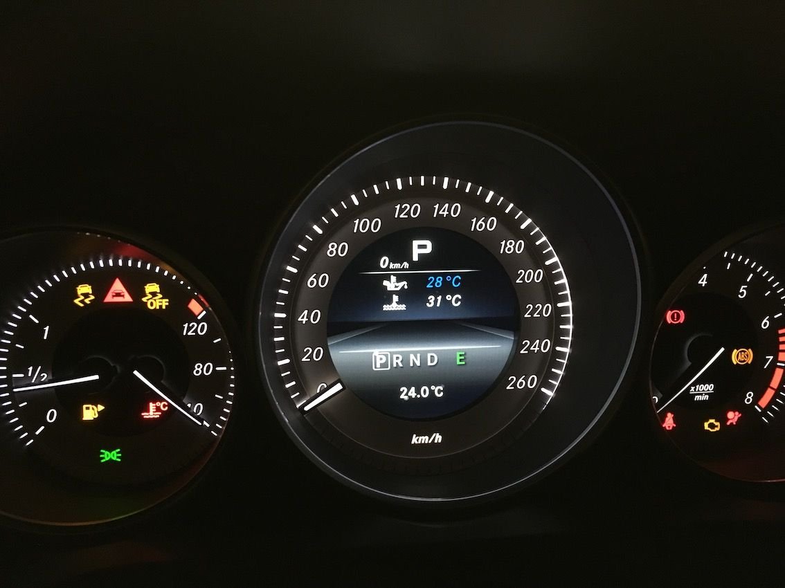

One of several features from Vladimir's TuneOBD software hack is the AMG menu which includes temps. We have some frequent destinations that are relatively short distance away so I'll take a longer route until the indicators are white. Does it help in the long run? I don't know but I feel better...

Also, it's important to understand what operating temperature means. Most normal cars only show coolant temperature in the instrument cluster and it's mostly an idiot gauge that hovers around 50% regardless of what the actual coolant temperature is, unless the engine is overheating. However, it's the oil temperature that matters and the oil warms up slower than the coolant. If the oil doesn't reach operating temperature, then the trip is too short.
