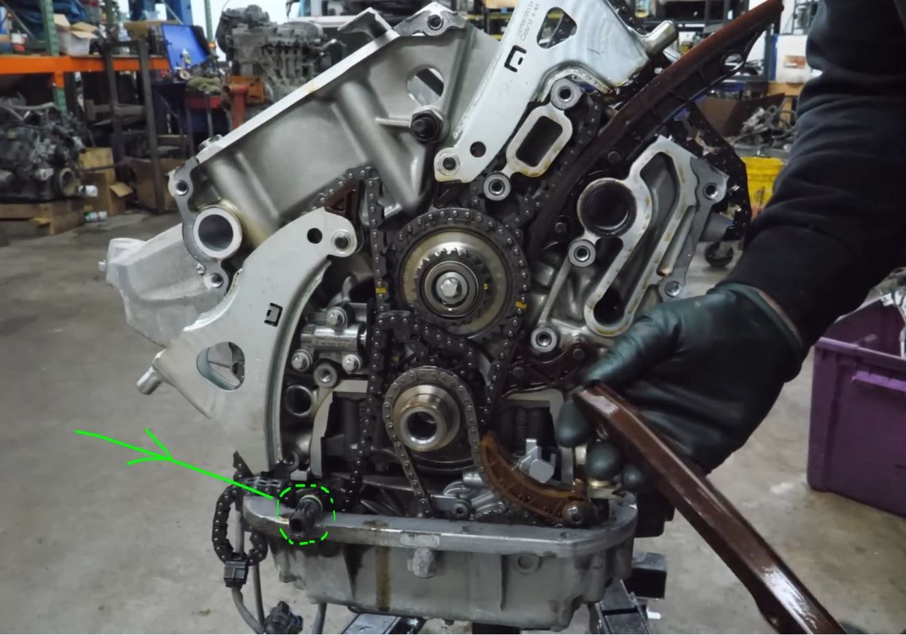

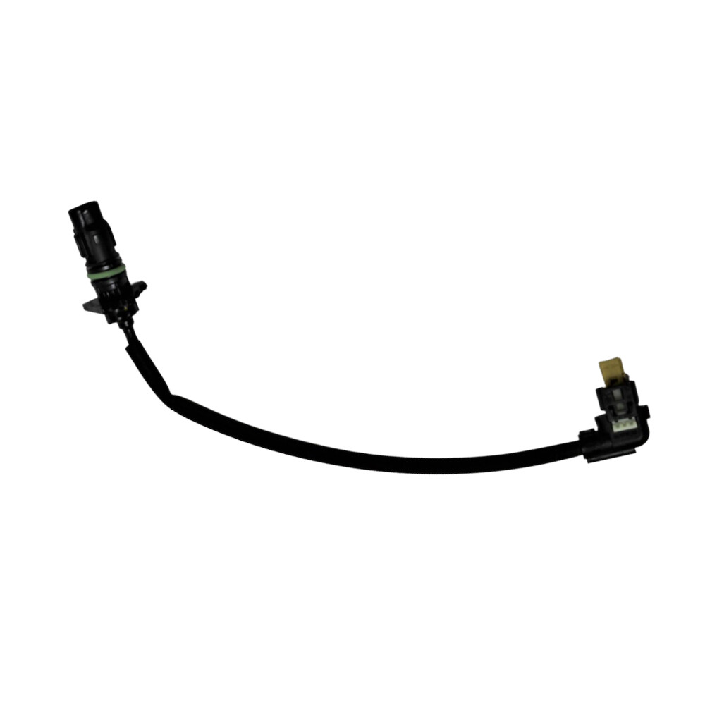

Yes yes yes... that is the oil pressure solenoid female side connector near vibration damper pulley.
That one has extra wire and connector to the actual solenoid and sold as a kit.
Something like this : https://www.pelicanparts.com/More_In...-150-86-02-MBZ
or

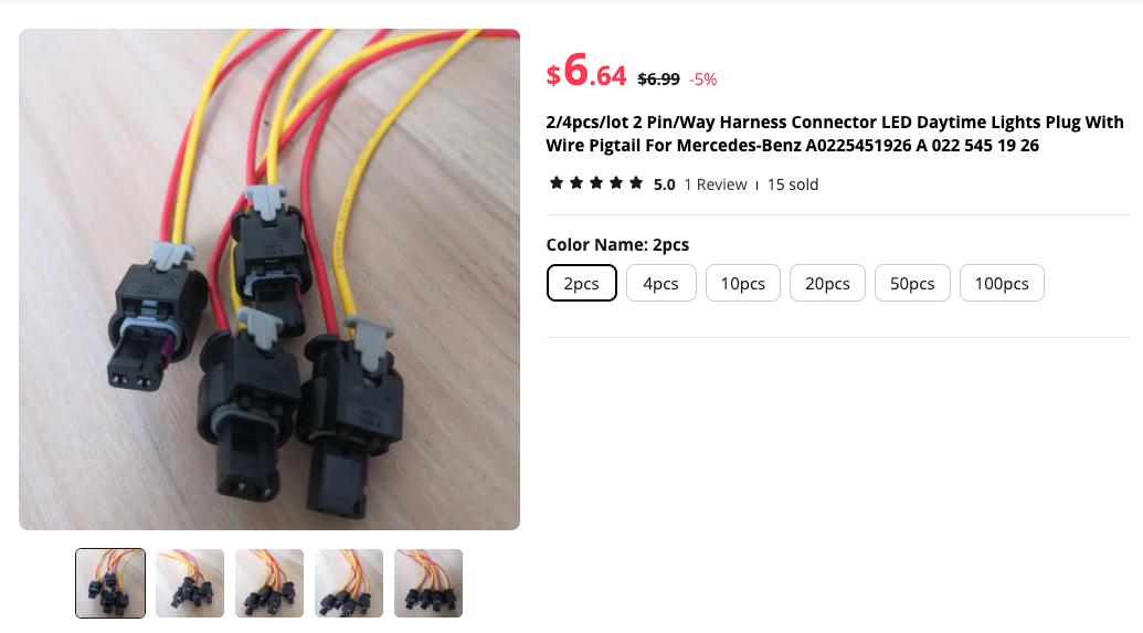

I would spray that area with degreaser or brake cleaner and "plug" it with a matching connector. I got mine for AliExpress and just trimmed the wires. Just search on the part number.

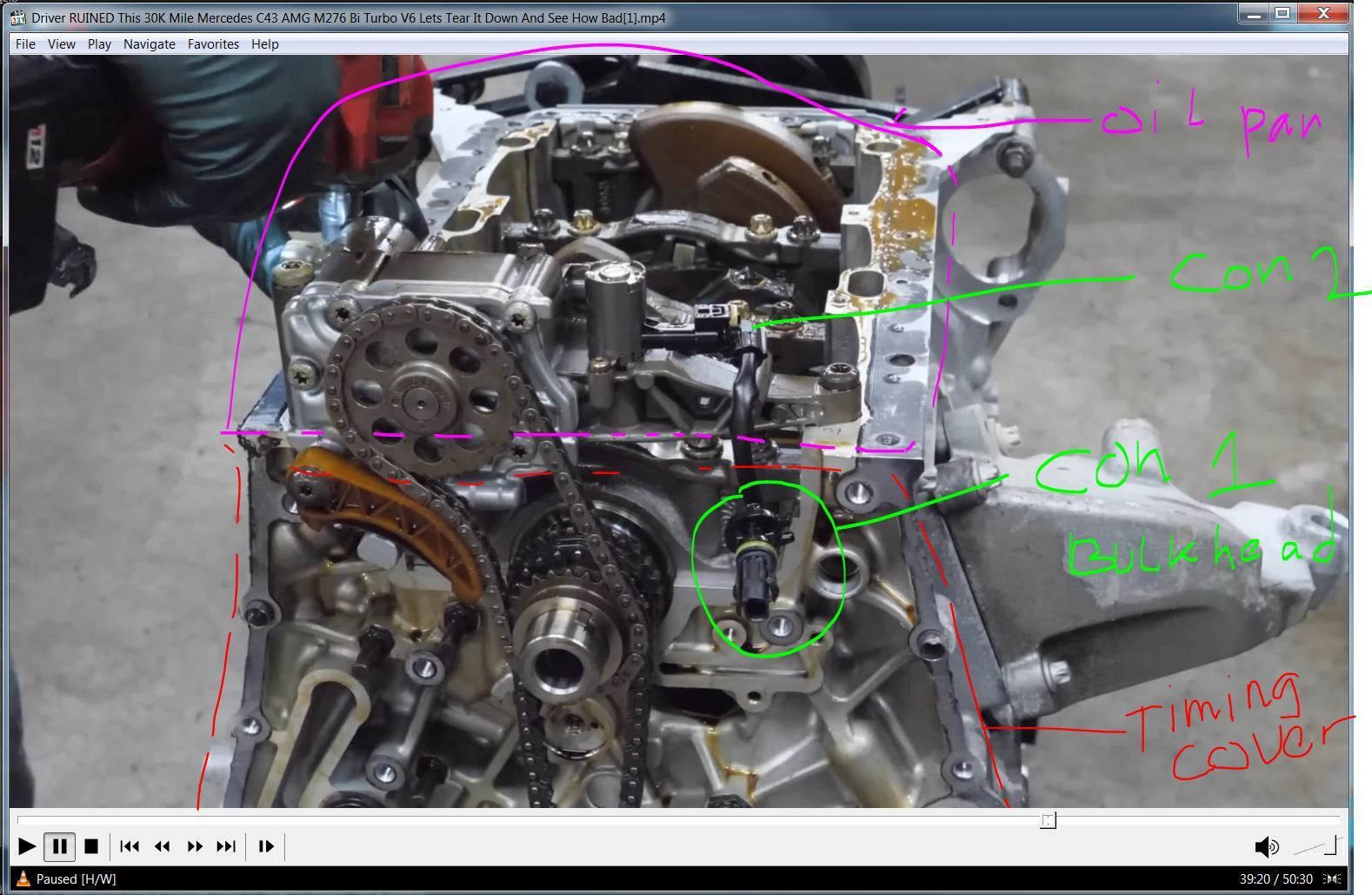

4-matic to drop oil pan is A NIGHTMARE.
You must drop front sub-frame and hang engine using support bar. No joke.....
I suggest clean the oil traces, if that female bullkhead connector is not leaking oil out, it is then OK.
E350 M276 wont get CEL when the oil solenoid is connector is disconnected and engine response will be better as no more lowered oil pressure on purpose by engine computer.
See Jetta's link on the MOD
Watch this and start at 33:00 minutes. M276 3.0 Turbo and M276 3.5NA is the same for the oil solenoid connector location and arrangement.
Aside from removing the oil pan, because the oil solenoid is IN there and the other connector is there too......
Timing cover must be removed too...dang !!!! That bulkhead female connector is housed at the timing cover.

Leaving it disconnected seems to be best and I will do that but I have a lingering concern with the broken connector and oil leaking. We broke the connector fairly easily so I question its integrity. I’d feel better replacing it, not the solenoid, if not too painful. To replace the connector, it would seem all that is necessary is to remove the timing cover. Can the connector then be attached to the solenoid with the timing cover off? My guess is it can’t but seeking confirmation before abandoning the idea of replacing the connector.
Old May 8, 2024 | 11:14 AM
S-Prihadi's Avatar
Joined: May 2018
Posts: 6,633
Likes: 6,575
From: Jakarta-Indonesia
You guessed right..........
.Your damaged one is the Connector 1
