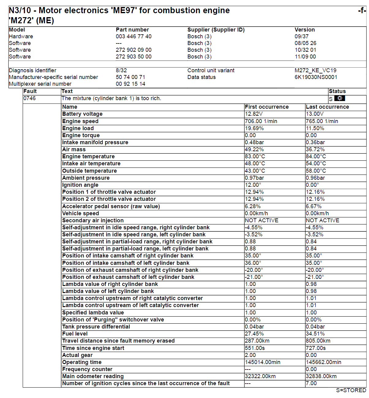

Here is the quick test log I managed to get from my mechanic:
If someone can point me in the right direction I will appreciate it very much. If any other data is required I will be able to get it from my mechanic although that guy wants to just replace the whole engine intake manifold. Note that intake manifold was already replaced by previous owner one year back (May 2023) and driven 15000km since then. Currently the odo is at 133,000 km

Aha..sorry I missed the information that the intake manifold been replaced in may 2023. Was it a genuine unit ??
The Xentry showed 32,838KM as last occurrence, how the hell now the car is a 133,000 KM ?
This is a STORED code. Don't tell me over the MANY years it has never been deleted ?
Or.....It could be that the engine ECM is newer than the car.
I know Xentry sometimes has mileage difference between modules, but usually less than 1,000KM

Quote: Aha..sorry I missed the information that the intake manifold been replaced in may 2023. Was it a genuine unit ??
It was not a genuine MB unit, it was Pierburg (7.00246.33.0).
I owned the car since 130,000 and I myself got the fault code cleared about 5 times, so not sure about the last occurrence odo reading.

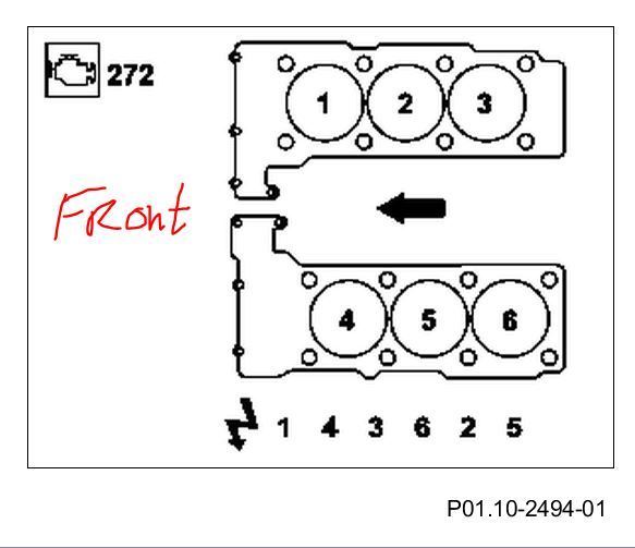

Your COP Ignition Coil is a 4 wire version and has the driver inside the COP.
At the least try swapping the COP and spark plug of Cy 4 to Cy 1 and vice versa, I mean to different bank and is in front of engine, easier access.
If misfire follows the COP & Spark Plug, you have reduced the suspect/s.
U can if you want swap COP only first, up to you.
Attached 2 files, your engine computer wiring diag. M272
Cylinder position/number and ignition firing order for M272
Reply 1
Jun 10, 2024 | 08:56 AM
Wait wait wait........
Dont swap Cy4 to Cy1. They are too close to the firing sequence 1-4-3-6-2-5
Sometimes ECM can detect wrong misfiring cylinder too.
Swap the COP & spark plug of Cy4 to Cy2
