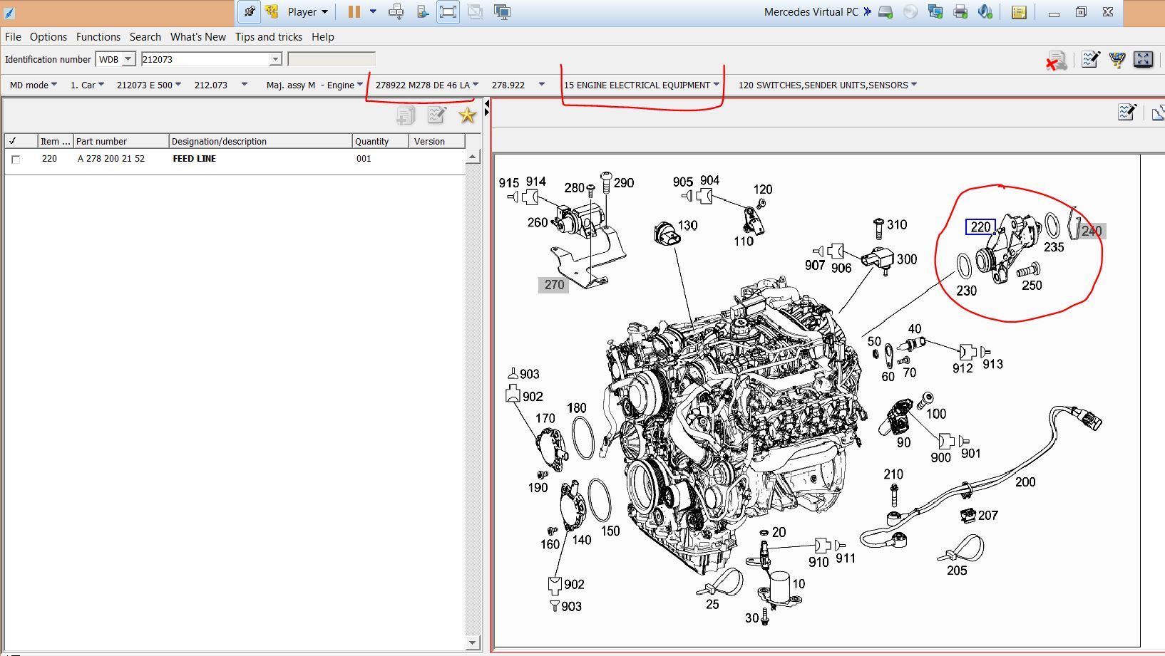

That leaking region is a plastic pipe assy called heater valve.
Depending on your M278 variant, where older engine does not have the small aftercooler coolant reservoir bottle, newer model has it.
See red arrow below : From https://www.benzworld.org/threads/m2...rvoir.3081144/
The plastic pipe with electric valve in discussion is this one : Version where it is directly bolted to Bank 2 ( LEFT )
If I recall correctly, newest Part A278 200 21 52 will no more have the electrical connection or basically no more valve, just plastic straight thru.
See here : https://www.autohausaz.com/pn/MB-2782002152
The video still showed older Part Number A278 200 08 31 where it has the electric valve and it is discontinued.
You can use the lastest P/N but your HVAC coldness will be reduced, as hot coolant from your engine will forever be circulating inside your heater core and only separated
from the EVAPORATOR cool side using air-flap. Where the old plastic pipe with water stop valve simply does not allow hot coolant to flow inside your heater core, which is the best way.
