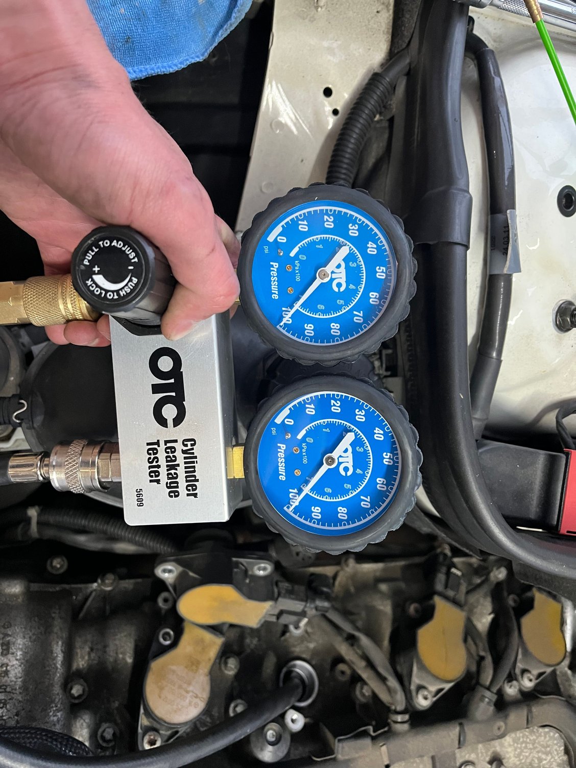

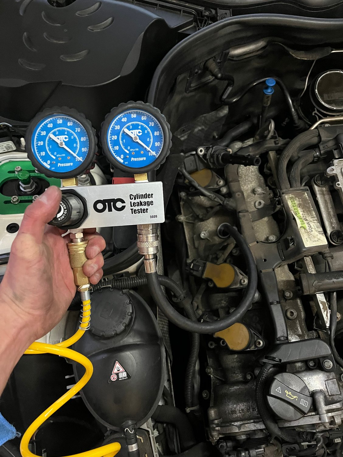

About to start the third of my 8 cylinders and the first and second I did both scored 99%+
Did not warm the engine first.
Am I on the wrong stroke to be getting such (too good to be true) results?

test procedures
I am not a leak down tester...
double check you shut off inlet air before concluding nothing is escaping through old valves and ring set.
...more help's on the way ✌️
Have had a look inside your cylinders wall now plugs are out ??
No worries, thank you for your response.
I don’t know what inlet air means?
I have not looked inside the cylinders yet, but I will buy a boroscope after finishing this test and post the results.

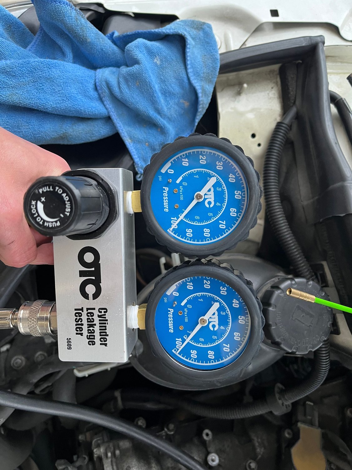

inlet air comes from shop air tank
"inlet air" comes from the air compressor.
yellow inlet supply line... outlet is black line to cylinder
I am not much of a "leak-tester" but noticed you have both gauges maxed out...
I think you'll want to dial the tool pressure regulator towards half.
In case this is your personal vehicle, don't risk blowing off the rear cam-cover plugs ✌️
