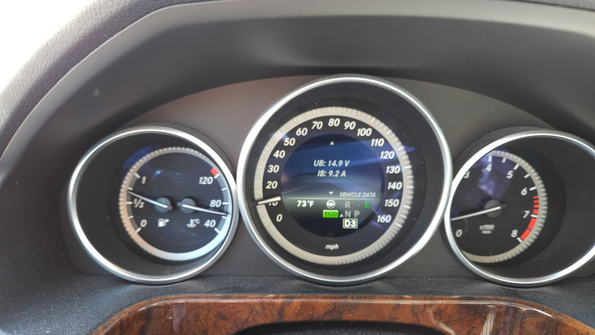

The "X-Mas Tree" fault is a rocky road that can become dangerous when chassis quits while driving...
I think it is a safe step to keep an eye on "volts + Amps" displayed while driving... I always do !
IC displaying
IC displaying "volts + Amps" from BATT Sensor
This display lets you appreciate if low voltage chaos is coming your way.
