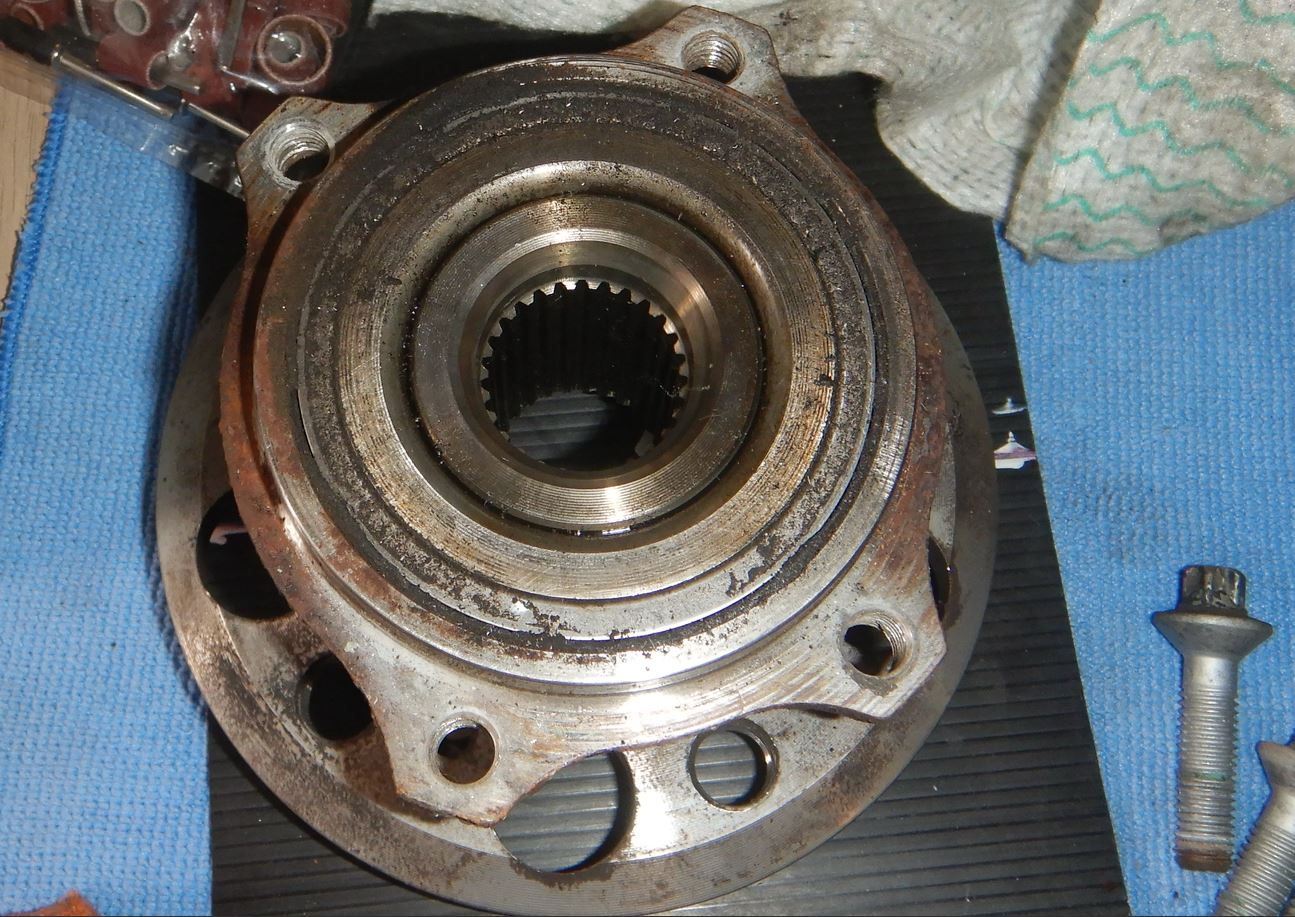

Got the new sensor today, replaced it and... no change...
Spikes still showing in the wheel speeds and the noise is still coming from the engine bay, I belive it's coming from the ABS unit.
I had cleared the errors, but they came again.
I still find it hard to belive that the ring is damaged, but I guess it's no way of knowing unless to remove the
bearing and knuckle and having to buy a new bearing, right?
I've no idea how to go on from here. :/

Murphy's grade...
MB tone rings are Mr. Rusty... stainless steel is for premium cars from Japan.
If your car has seen road salt, don't scratch your head...
perhaps silicone spray could help early stage.

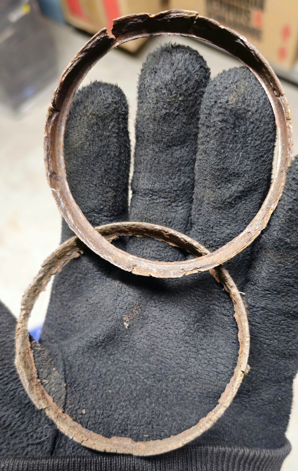

I finally managed to fix the dreaded ABS lights.
It turned out that both of the ABS rings were severely rusted and cracked on the right side.
I removed them both and placed one new ring on the axle.
Also cleaned the water lane between the knuckle and hub/bearing.
Also replaced the bushings since I was starting to replace the whole rear arms and bushings on both sides.
One of the rings.
And the other one.
Here you can see both of them...

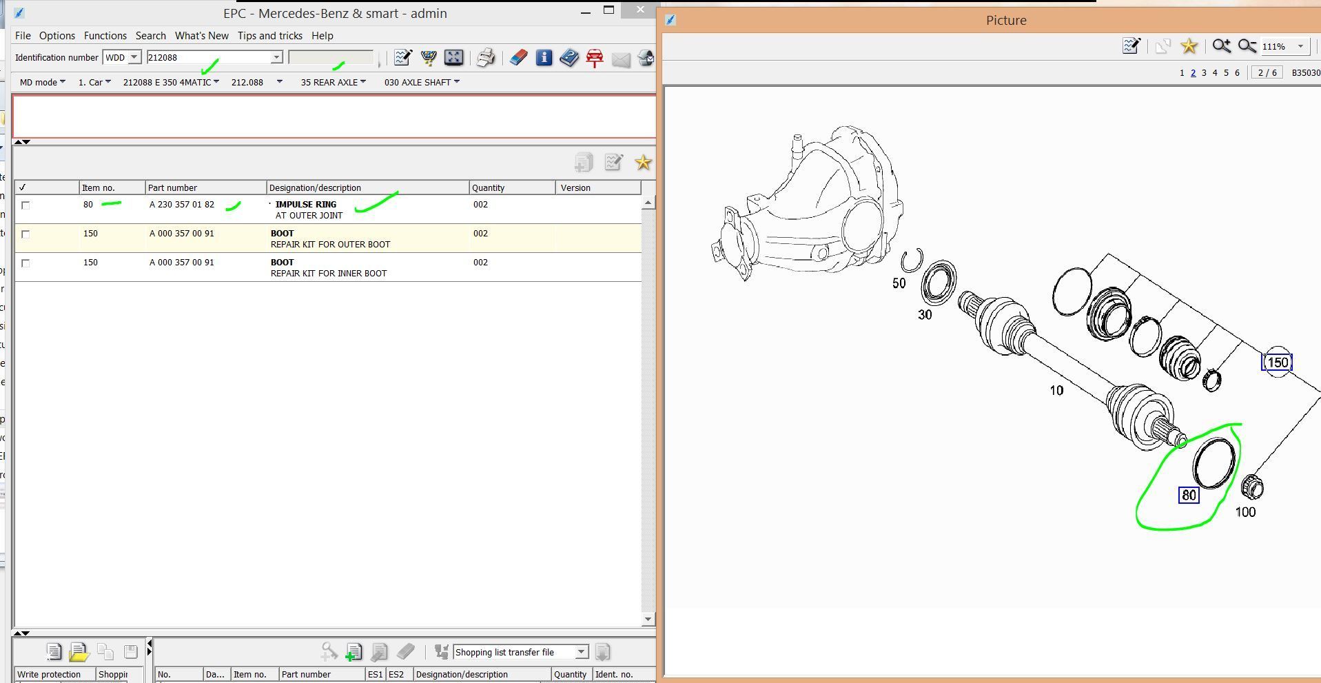

RWD or rear drive shaft magnetic ring can be bought stand alone, I saw EPC for 4-matic front side, you must buy boot repair kit, like the one below , is that the case ?
https://www.autohausaz.com/pn/MB-2043300585
If rear
Condition of my magnetic ring ( RWD ), late last year.
I didn't look at EPC back then, if I known that is the magnetic/impulse ring, I would have provided better rust protection.
It was the rear ring I just replaced, haven't thought of the front ones yet, might look into that next summer.
I'll be sure to get the kit.
Thank you.

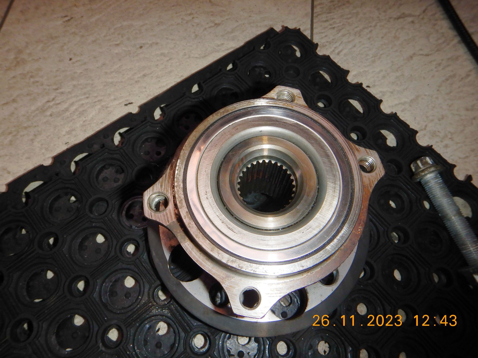

Did the magnetic ring split its lower and upper part into 2 pcs ?

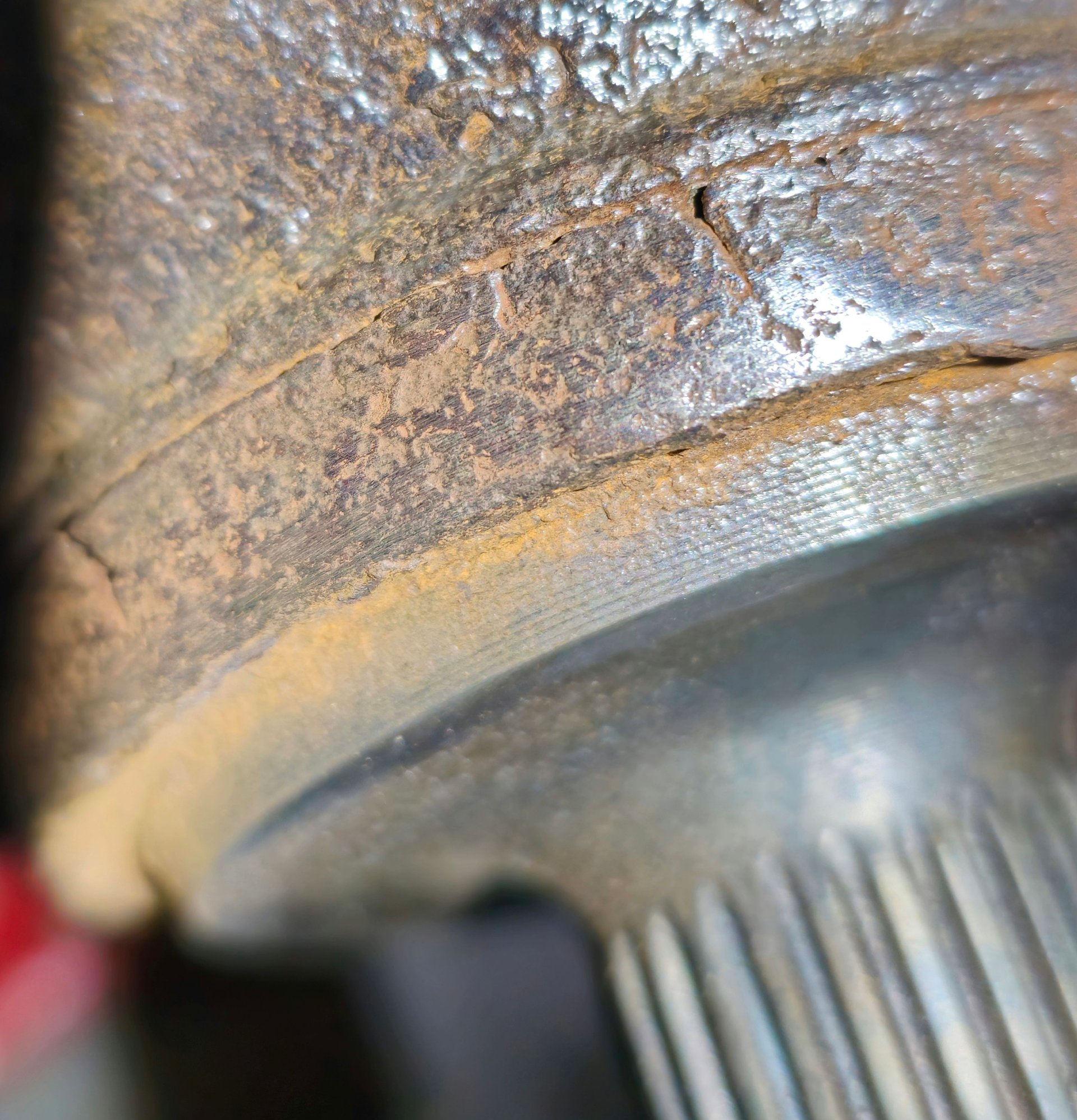

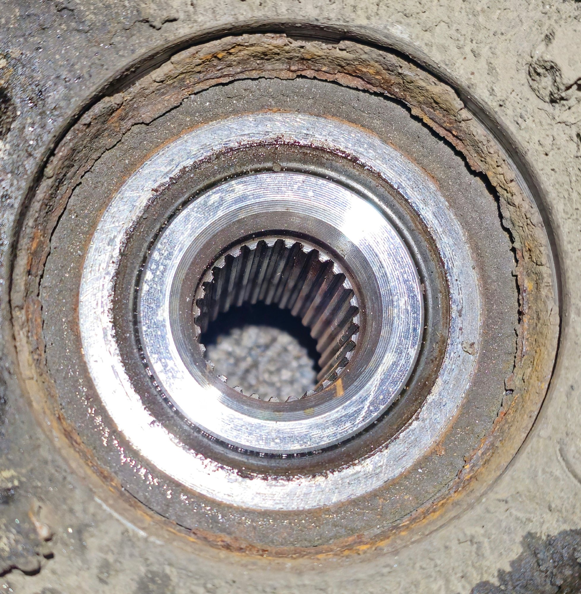

That is what I thought seeing 2 of them. One below seems smaller diameter than the upper one.
This is the wheel bearing remove-able hub.
Mine
Your shaft end corrosion is quite bad. All the way to zone C
