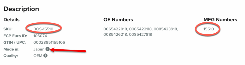

Interesting the Bosch rear sensors are also made in Japan, like the NTK ones.

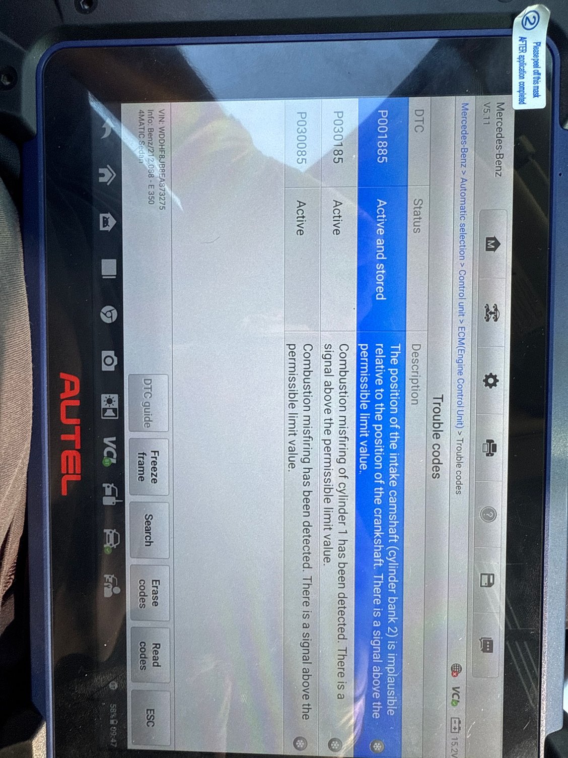

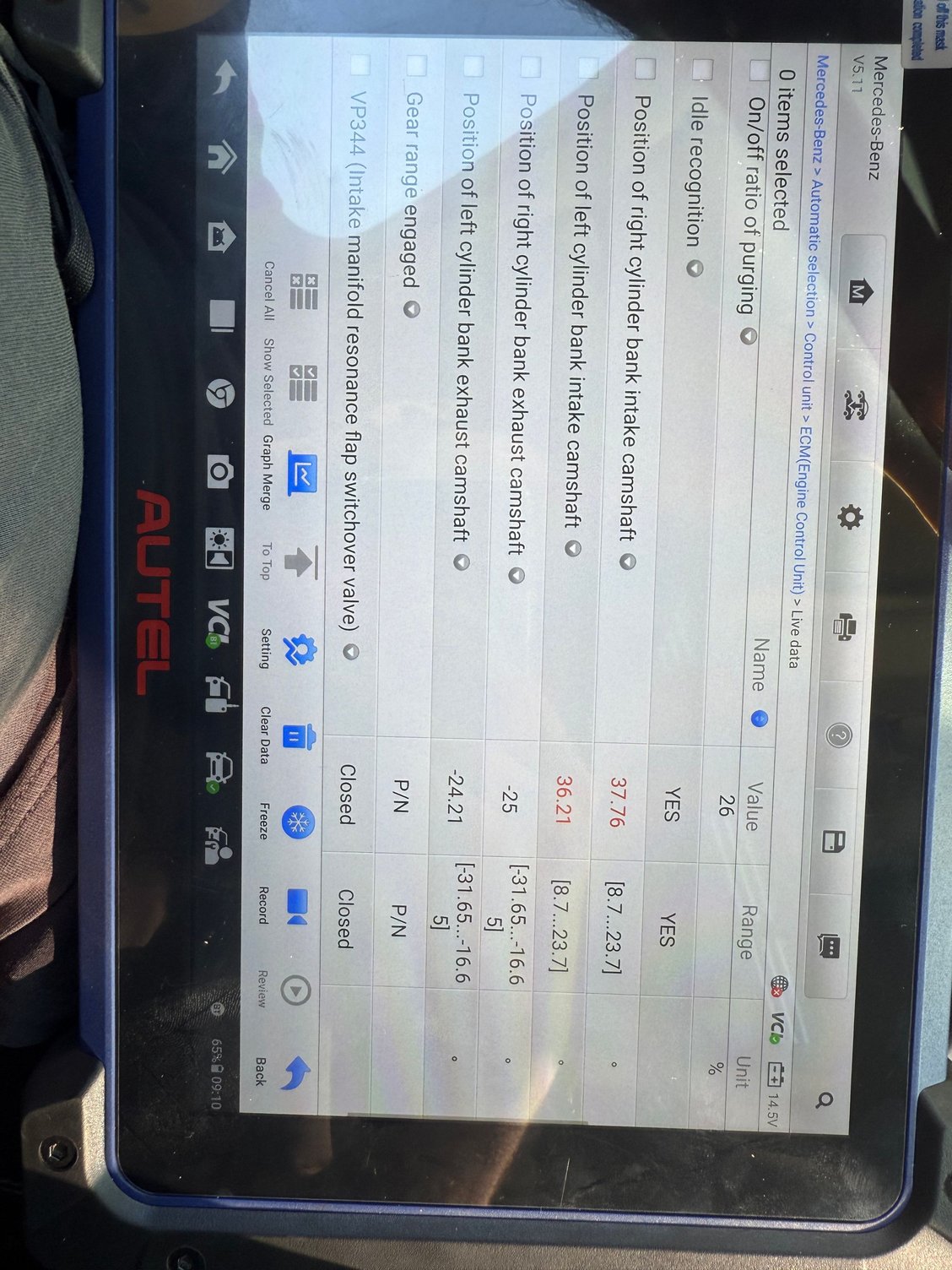

I went to grab my actual scan tool from work and found both my cam readings to be off. Is this my issue? Could the car have just jumped out of time? Or is the misfire causing it?
Old Oct 24, 2024 | 01:20 PM
CaliBenzDriver's Avatar
Joined: Apr 2019
Posts: 11,963
Likes: 6,804
From: Silicon Valley
W212 MY'14 M276-3.5NA @75kMi
misfire don't cause timing issues on these engines
but the other way around...
timing issues do cause misfires, guaranteed they can.
here both intakes are shifted
for only one misfire...
Is that with engine running now???

Dam so I’ve got a timing issue..? What exactly would I need to replace…? Or is this sucker going back to the auction
Oh you’re saying I need a new CPS and lambda? I’ll check for any oil.
is this with engine idling or engine off ??
Check Cam sensors for oilyness.
Engine idling. New codes…
looks like I need a need a timing/cam adj job. Thoughts?

any rattling at all then ??
Extreme No say intake VVT Gears are not locked.
check cam sensors at least the one easily accessible from Bank1 intake:
oil galore in sensor?
Without ratlling and extreme position + extreme Lambda is textbook... "oil in harness".

Tdavid1's Avatar
Joined: Oct 2024
Posts: 69
Likes: 10
that's when you start firming plans...
DE cars eat parts!
US cars drink gas!
JP cars drive Miles !
All based on Bosch engineering goodness.
+++ Still not checked yet ...
before rushing into Intake VVT job...
Check that VVT gears pins are unlocked
or CPS are telling jokes to ECU.
or both VVT+ CPS.
We are trying to minimize your efforts not inflate the tab.
So the whole timing cover doesn’t come off? So I’ll be removing valve covers and mainly changing the cam adjusters along with the small things while I’m in there?
How many adjusters do I replace and how can I tell which one is bad?
They’re pretty expensive..
im confused.. what would cost me zero and save me time?
How do I check the VVT gear pins?

the free no-parts option uses proper oil pressure to hold VVT gears at idle without using the lock pins... presumed bad in your intakes (need visual check).
The M274/6/8 engines use a clever pump solenoid to disable half the oil pressure below 3500.Rpm
When you unplug pump solenoid, engine is allowed to run on normal oil pressure that can then be increased by way of viscosity to offset the "under rev'ed" pump.
Here MB uses a low Max pressure of 60psi while GM uses 90Psi. The oil pump has lazy output to "save gas".
You can turn that around with better viscosity in the W50 range.
Beware your 100kMi piston rings are jammed with soft carbon from gallons of burned oil deposits.
Feeding 10W50 directly without any cleaning steps *may* help cause LSPI self-ignition piston damage.
Normal oil pressure remains a valid experimental option with working VVT a lot of us are using. You don't need bad VVT... in fact good VVT's benefit from not overworking lock pins with reduced oiling.

Tdavid1's Avatar
Joined: Oct 2024
Posts: 69
Likes: 10
This M276/8 uses a clever pump solenoid to disable half the oil pressure below 3500Rpm
When you unplug sokenoid engine is allowed to run on normal oil pressure ypu can then increase with viscosity to offset the under reved pump.
Here MB uses lower Max pressure of 60psi while GM uses 90Psi. The oil oump has lazy output.
You can turn that around with better viscosity in the W50 grades.
Beware your 100kMi piston rings are jammed with soft carbon from burned oil deposits.
interesting… would that help my misfire/out of time as well?

My m278 Bank 2 (passenger side US). I only replaced the intake adjuster (right side one in picture, nearer center of motor)

If you manually rotate engine by crankshaft, you will hear/see a click and a jump if the VVT gear is faulty. You will know it when you see it, and there are videos online too
