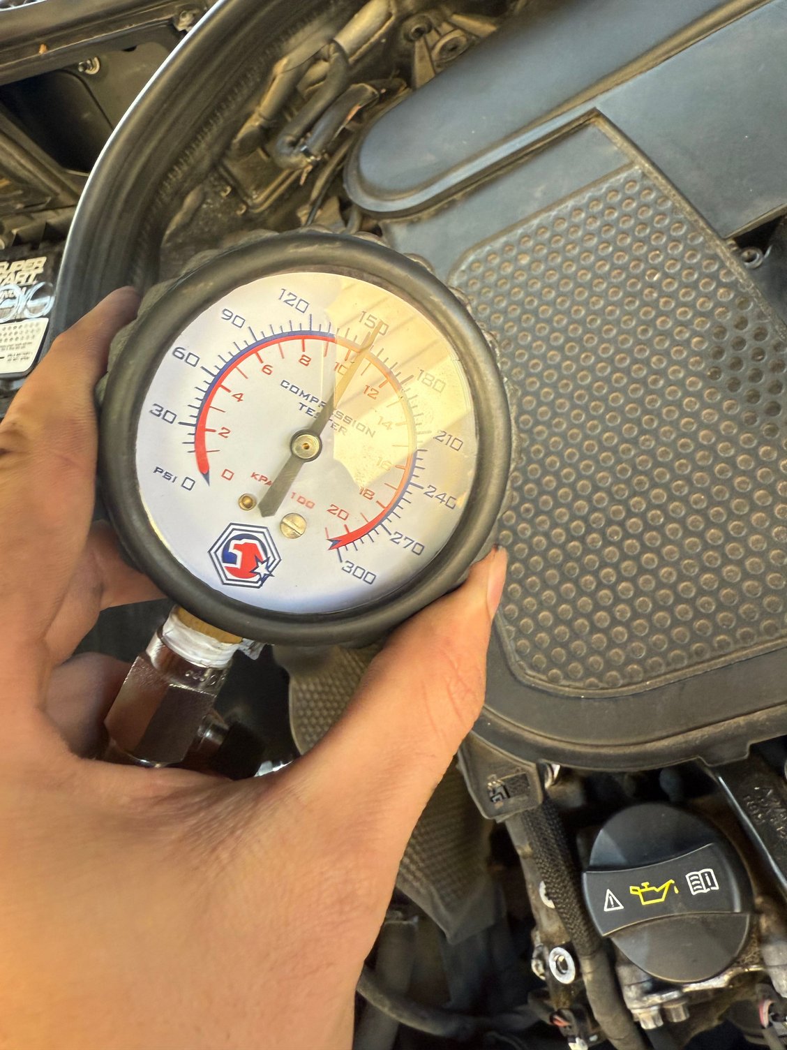

Tried it, ran fine for about a minute and then started misfiring again.
I did a compression test too, seems ok?

Your Cyl.1 is now reported good:
  • bore scope fine
  • compression fine
  • new plug
  • Replaced injector
  • (coil/boot?)
Your engine condition qualifies your chassis to stay on the road for another 100kMi.

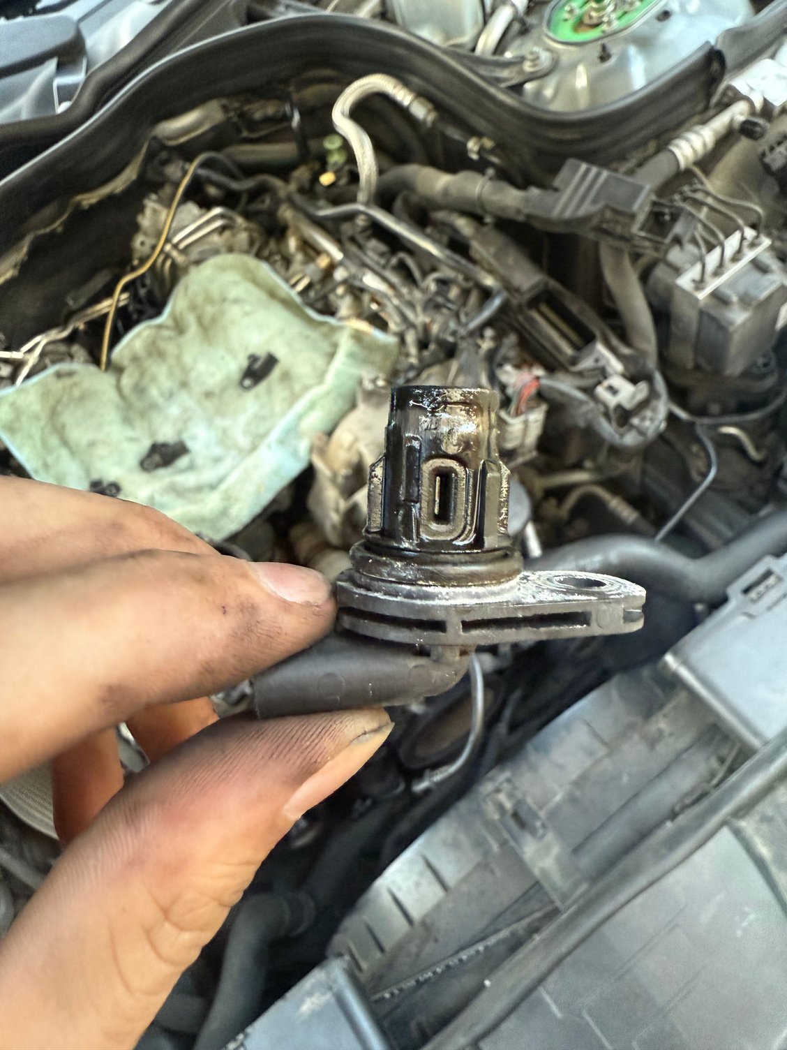

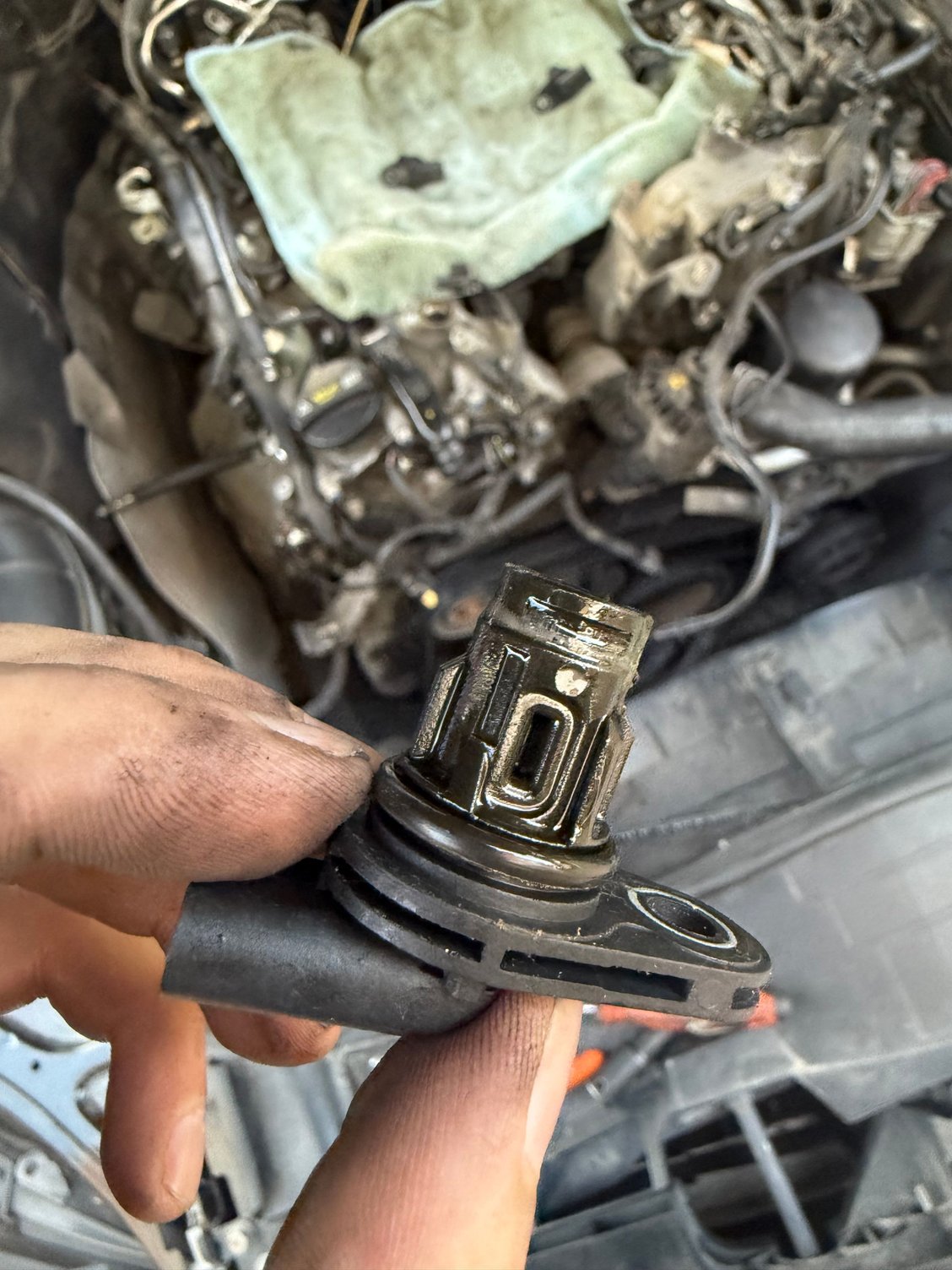

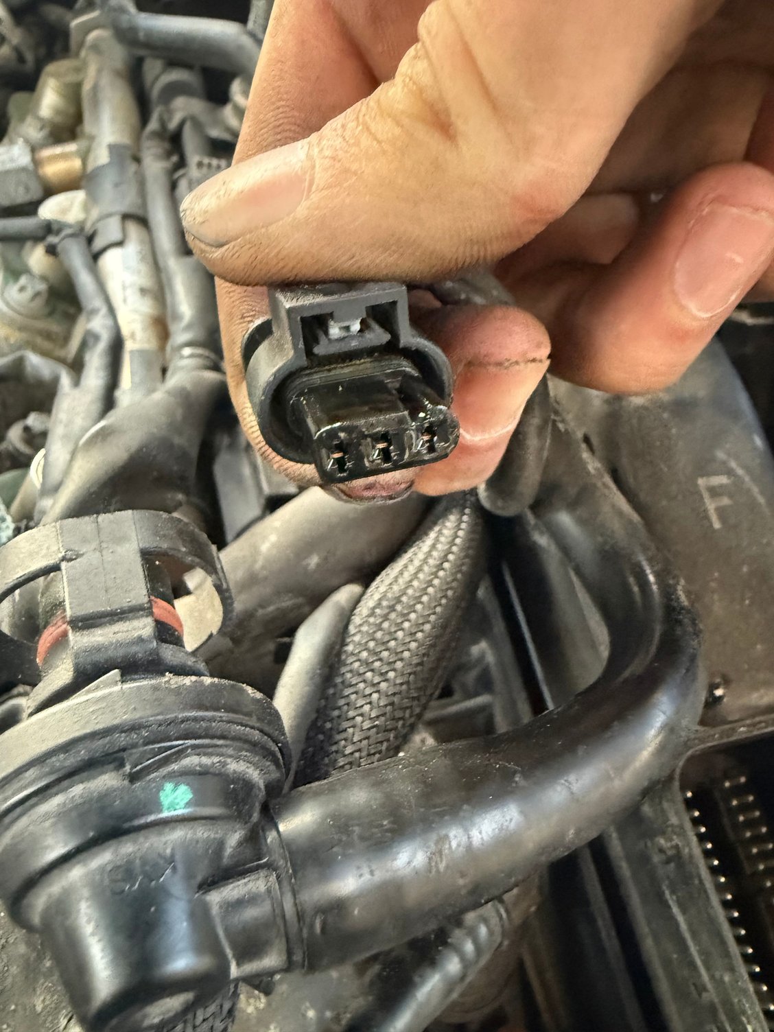

Ok, found oil in 2/4 CPS connectors and these sensors itself seem damaged.

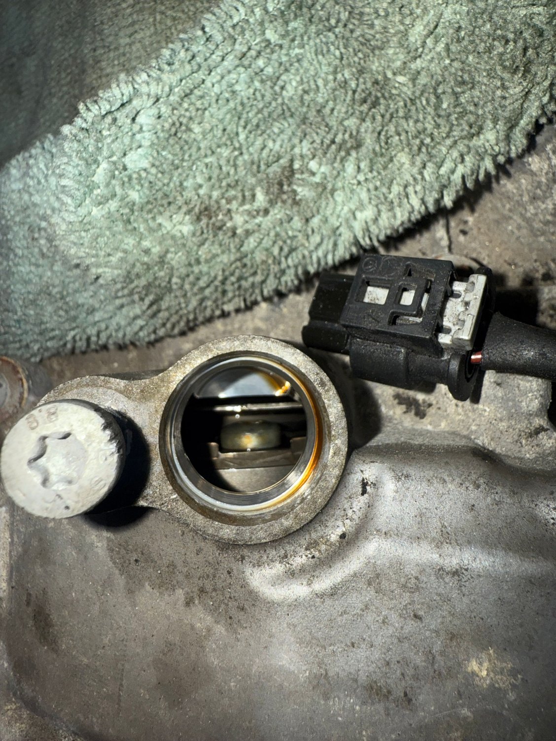

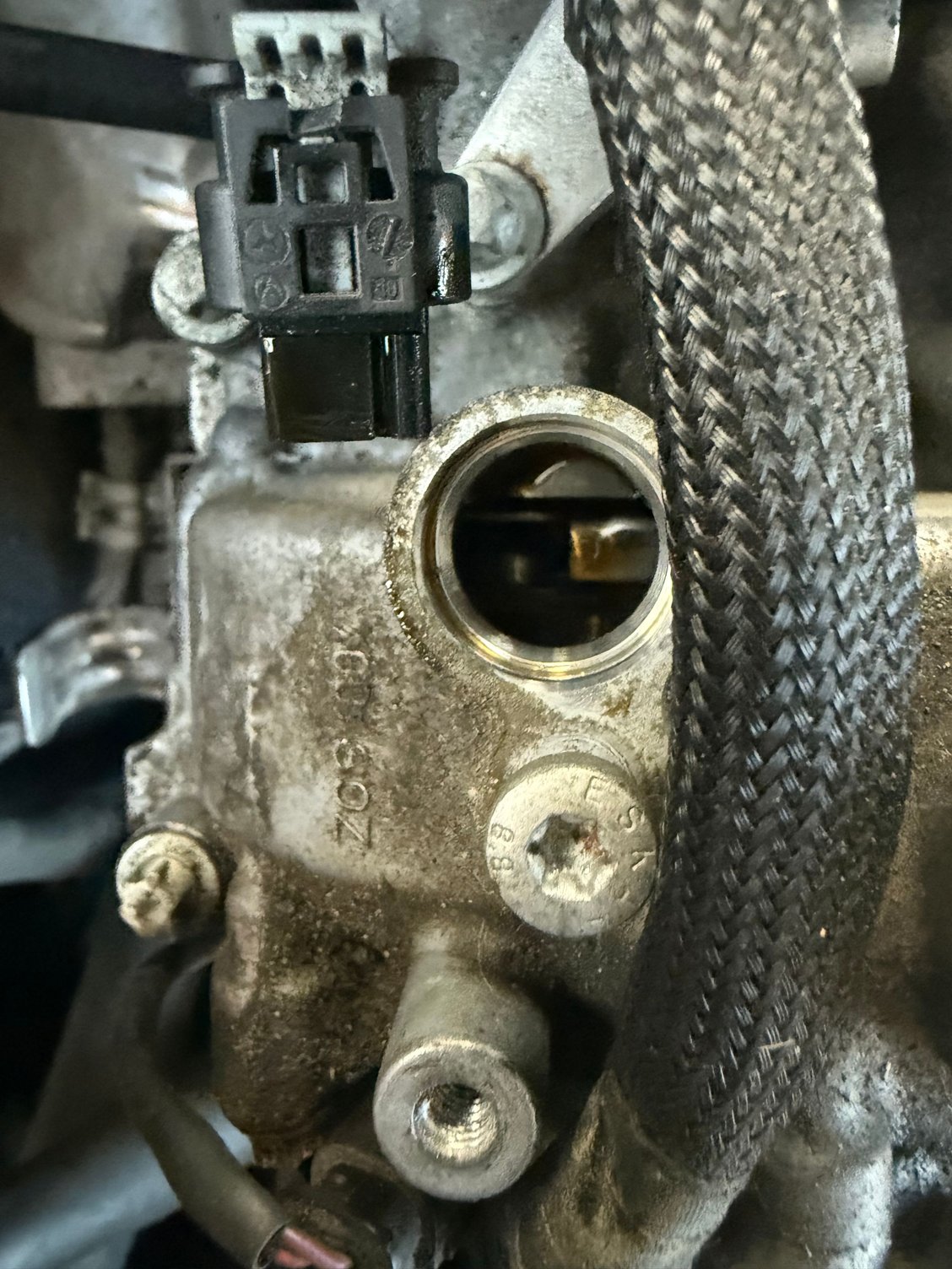

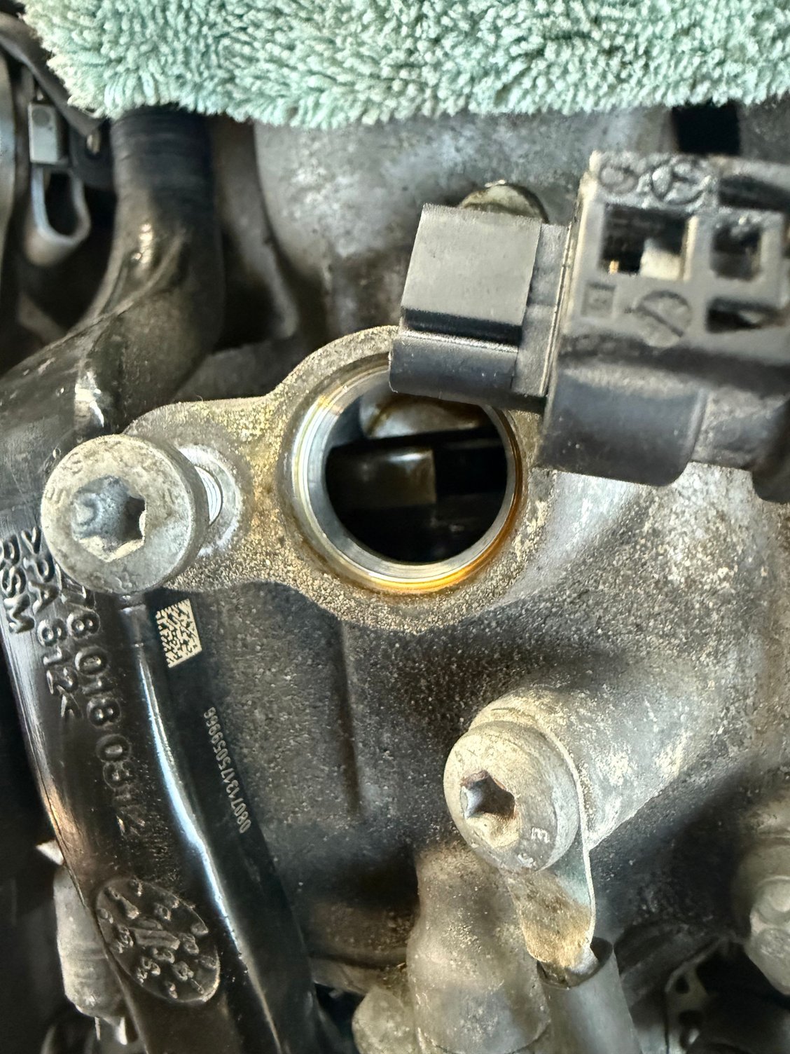

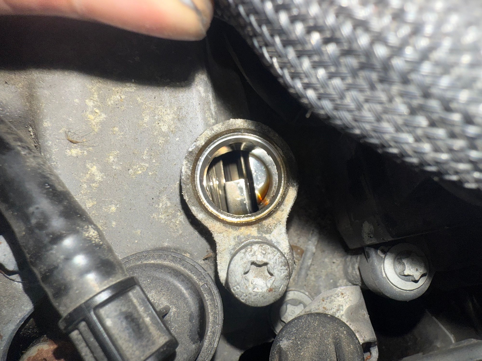

No clicking noise heard, put it at 53 degrees and checked. All seem to line up except bank 2 intake side, possibly why I have that code for the bank 2 CPS..

I see... you have confirmed oil in CPS Harness...
> Next go open upstream Lambda connectors to inspect oily plug.
> Next go open ECU connector to inspect oily plugs
--> then you'll know what's in your cards.
(We may have free fix for no harness needed)
There is a good chance your failed CPS are telling stories to ECU
meaning VVT Gears may be ok - Not proven bad so far.
Next go open Lambda connectors to see if oil made it down there...
Next go open ECU connector plugs
No oil in lambda connectors or ecu..
Just both exhaust side CPS. Could that be why they were reading so high? Or is that vvt actuator jumped?
Very Nice!!! You've saved a big PITA + $10k cash.
Answer is nope because it was your intakes reading wild.
Meaning you likely have bad VVT Grar lock pins because the intake CPS are not wet.
Now spin crank CW to hear "clunk" on intake sides

No clicking noise at all. So do I replace the CPS and test it? Or do I also do that one VVT actuator that seems to be jumped? But that actuator is on bank 2 and I was getting a cyl 1 mis…
This does not add up... let me think.
Your wild VVT timings is on both intakes and locks preliminary checked to sound ok.
Camshafts reluctors shifted... both intakes??
You can visually check for weird timing marks through CPS holes. ($$$ camshafts?)
That's entirely possible given rattling was ignored long enough.
> SOMETHING ELSE does not add up:
Can not have bad camshaft reluctors with good VVT!!!
Either both items bad or VVT only.
physically Inspect timing marks though CPS holes,
youll see them skip forward while rotating crank.
++++ RECAP-02 BEING:
  1. Confirmed good Cyl.1
  2. Conf. bad oily exhaust CPS
  3. Likely good VVT (prelim. "no clunk")
  4. Dry Lambda + ECU

yes, inspect 4x camshafts static timing marks right now.
There's a YT video or...
simply rotate FWD only until cams reluctor mark + crank are all lined up (Rwd will use sloppy chain slack... no-no!).
We're almost done pounding all the nails on this thing - - So far a good auction deal

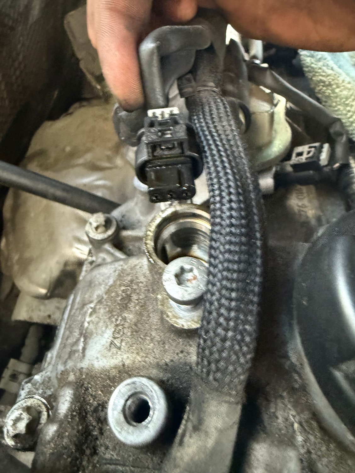

The CPSs are going to be oily because they sit in the valve cover and there is oil thrown around by the cams. I don't think they are damaged but replacing them may not be a bad idea. Please, please, please, get Genuine CPSs. I swapped mine out with Delphi brand, which is usually good, and had a 50% failure rate. I put the old ones back in.
I recommend you get these and use them between the wiring harness and the CPSs and Cam solenoids.

Will do tomorrow..lamee ik lol. I have to remove both those cam covers to see timing marks right? Are they yellow marks? All the yt videos are guys checking them from CPS ports but I don’t see anything.
Yes only CPS ports nothing else.
Forget popping any covers... nooo!
at least you can see if camshafts skip forward loosely yes/no.
If cams are not loose then GREAT
timing marks may be missing: no problem.
So far none of this fixes LTFT...
