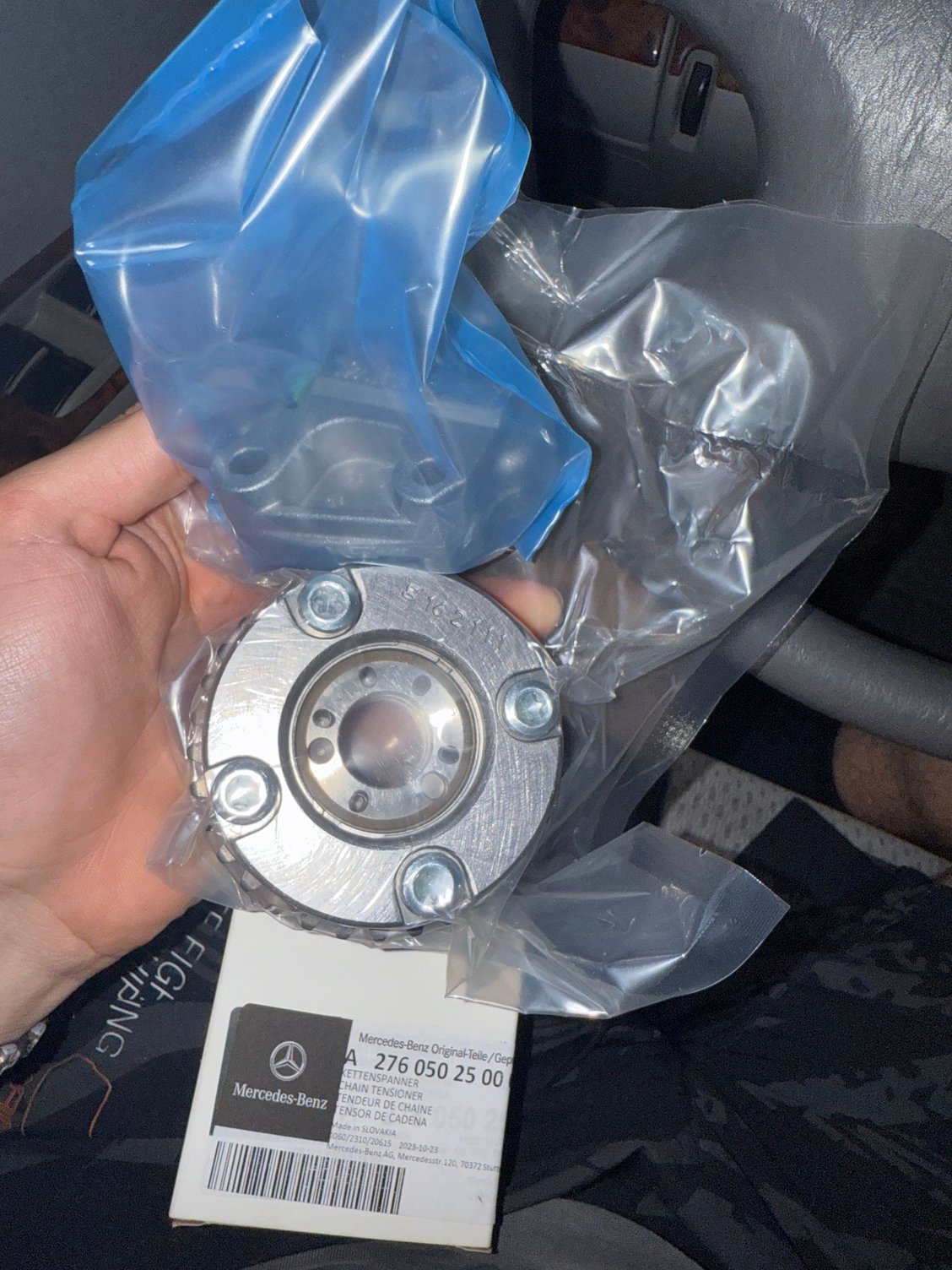

Originally Posted by Tdavid1
So now I need to replace that b2 vvt gear.. could this be causing the misfire as well?
I guess I’ll tackle the job, any idea of parts needed so I can order before doing anything?
Here is your part list:
  1. VVT intake gear(s)
  2. Tensioners B1+B2 (diff. PN)
  3. ​​​​​​fasteners kit with RTV
  4. 4X CPS.
  5. 4x CPS pigtails
  6. 4x VVT-Solenoid pigtails
  7. ...

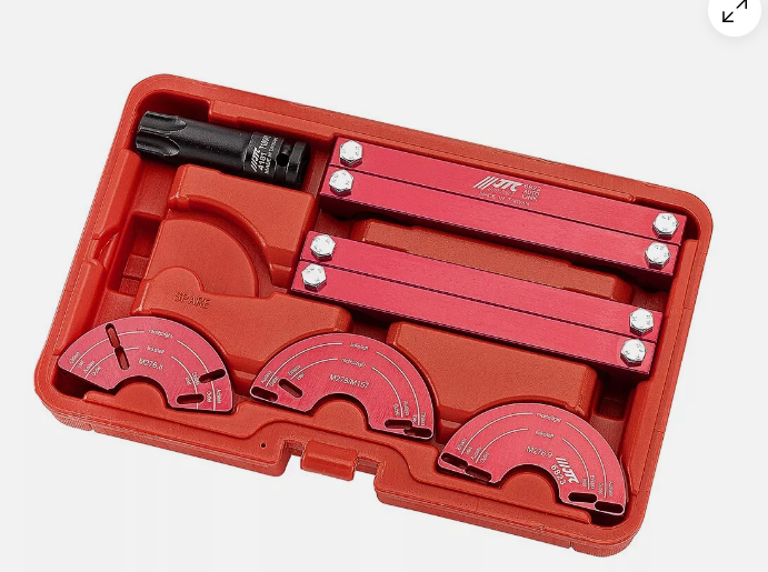

That bolt holding the vvt gear requires a special tool?
Proper tools: T100, camshaft holding tools, and camshaft reluctor alignment tool
An example, I do not own it
https://www.amazon.com/Yuesstloo-Alignment-Camshaft-Adjuster-Compatible/dp/B0CWNNSH77/ref=asc_df_B0CWNNSH77/?tag=hyprod-20&linkCode=df0&hvadid=693747049168&hvpos=&hvnetw=g&hvrand=1781546004893551948&hvpone=&hvptwo=&hvqmt=&hvdev=c&hvdvcmdl=&hvlocint=&hvlocphy=9059132&hvtargid=pla-2304210131417&psc=1&mcid=f98dd21778903020a6a0ea99268b5952 https://www.amazon.com/Yuesstloo-Alignment-Camshaft-Adjuster-Compatible/dp/B0CWNNSH77/ref=asc_df_B0CWNNSH77/?tag=hyprod-20&linkCode=df0&hvadid=693747049168&hvpos=&hvnetw=g&hvrand=1781546004893551948&hvpone=&hvptwo=&hvqmt=&hvdev=c&hvdvcmdl=&hvlocint=&hvlocphy=9059132&hvtargid=pla-2304210131417&psc=1&mcid=f98dd21778903020a6a0ea99268b5952
Here is another tool I had not seen before for the M276 (seen it for other engine though), but it was mentioned in a Facebook group recently
It locks the gears in place while the tools is bolted on the chain tensioner location.
https://www.aliexpress.us/item/32568...yAdapt=glo2usa
Another tool
https://www.aliexpress.us/item/32568...Cquery_from%3A

Parts canon is being loaded boys!

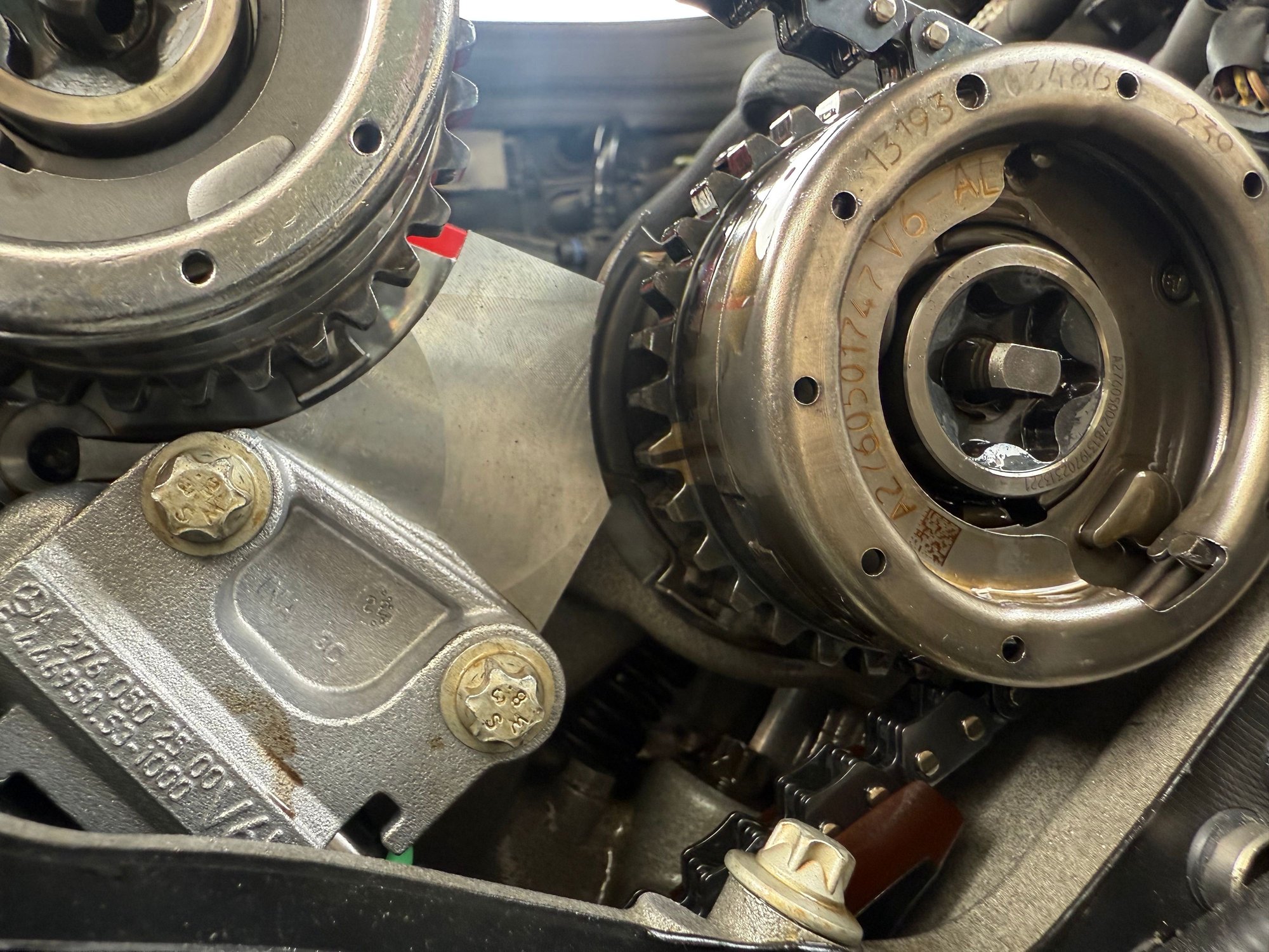

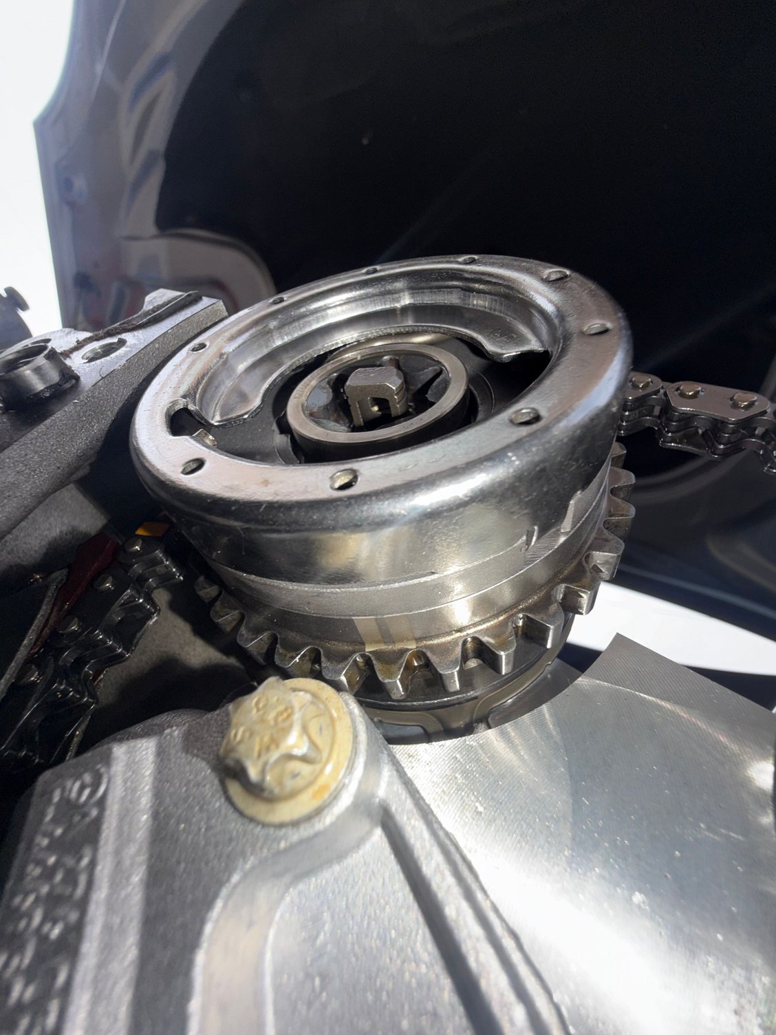

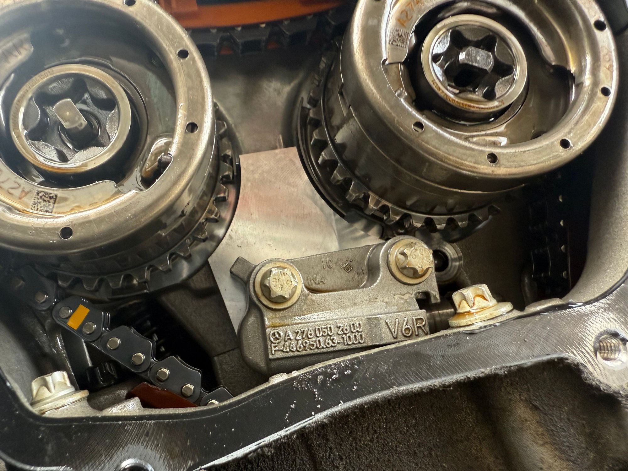

I just put the cam adjuster in but not very confident in timing. Everything seems to line up but I tightened the tensioner and noticed the crank moved a little past 40 degrees. I turned the crank a few times and the timing marks are still in the same position. How does it look to you guys?
Old Oct 28, 2024 | 03:36 PM
  #137
CaliBenzDriver's Avatar
Joined: Apr 2019

setting VVT timing...
the marks are ligned up +/- 1 tooth from crank position - - It must be right but is about 1/8" exact...
VVT Gears timing marks
Your valves cleared during 1st initial turn
Bk1: I honestly don't see marks...
Your valves cleared during 1st revolution
So I should be fine?

I can’t see the tooth mark on the left adjuster in the top pic…is it just the lighting/angle?

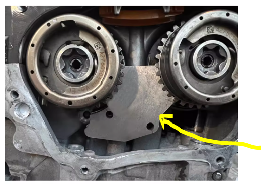

Old Oct 28, 2024 | 03:47 PM
  #140
Tdavid1's Avatar
Joined: Oct 2024
Posts: 69
Likes: 10
here’s a better pic

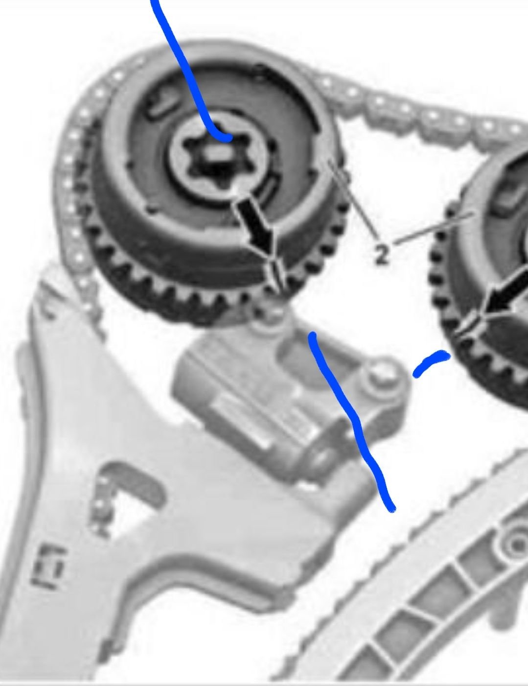

TIMING MARKS...
Bk2 intake alignment
Bk2 intake VVT on time
We're only setting Bk2 intake, other timing marks can be used as witnesses.
comparing drawing with picture...
looks good from here.
triple-check for the sake of engine cost.
Q: did you take a photo of the camshaft w/o the gear? To see if the laser marks of the tone wheel were aligned with the cam?

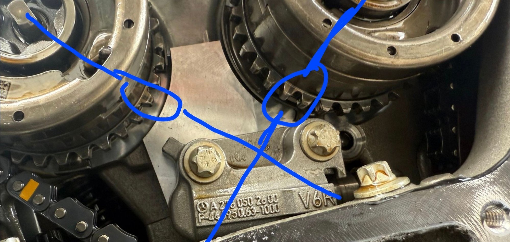

NOT TIMED
Bk2 exhaust.... looks off !!
exhaust marks
You know camshaft can get forced by valves... you had chain tension released during intake gear out... I think your exhaust camshaft walked fwd (that's exactly why engine needs new tensioners not limping!)
Go to town on your Bk2 timing marks.
I think exhaust should point at the nearby tensioner nut, right?

think is Bk2 exhaust.... looks off !!
exhaut marks
You know camshaft can get forced by valves... you had chain tension released during intake gear out... I think your exhaust camshaft walked fwd (that's exactly why engine needs strong tensioners not limped!)
It seems timed for Bk1, i.e. pointing to the opposite bolt of the chain tensioner.

Bk1... WALKED OFF TIME ?!?!
It looks like Bk1 exhaust a little late as well as intake, as if crank not exactly on marks, right?
exhaust should be lower...
B1 intake may be seen on time: ok
B1 exhaust I can't see it being on time...
+++ Meaning exhaust camshaft may very well have walked when it was worked on during the previous ownership...
now is a good time to fix this it right.
