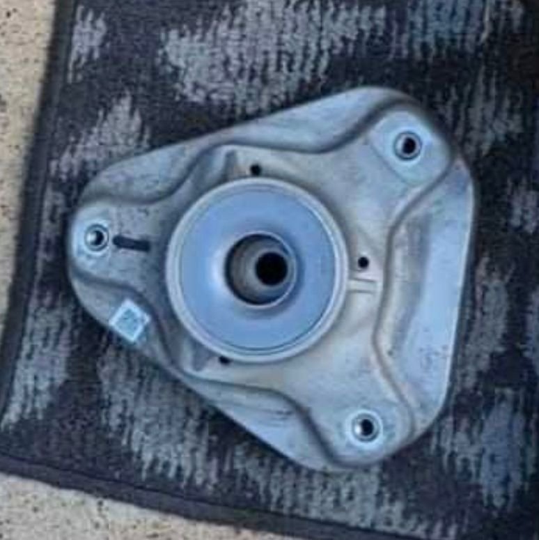

Here are two parts of strut assembly...
the main suspension bushing...
spring bearing race holder
Both of these parts work, live and die together.
A bad main bushing looks almost as good as new... replace assembly, obviously both sides L+R only.

Ok, placing order this morning on Corteco main suspension bushings (strut mount/top hat / A2123230020) from RMeuropean as they will ship it today and I should be able to install on the coming weekend. Will update the thread on the results. Thanks

Thank you @CaliBenzDriver. It had been raining here in Houston and finally got around today to swap out the old strut mount assembly with a new Corteco one and voila the noise is gone. Now, I need to get the alignment checked. Thanks again .

BACK TO ROCK SOLID....$60 x2Pcs 👍

The strut mount does not mess up the alignment, quite the opposite.
It will make your steering stable just like new condition. The result will make your smile!
The gas filled strut is likely built as a 100 to 115kMi item.
