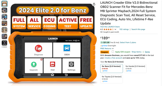

Get a Mercedes specific scanner and scan for codes. Make note of them and then clear them. See which ones come back.

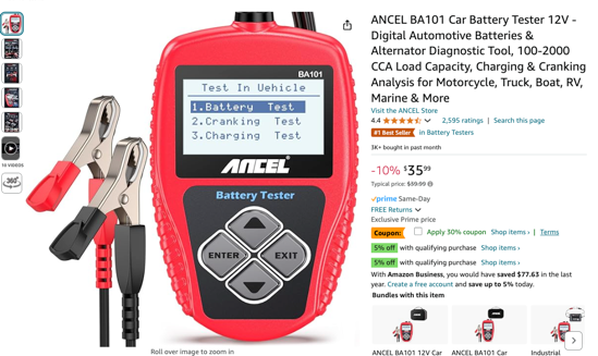

As @trigital mentioned, it could be the alternator. When either a battery or alternator goes bad, it puts an extra strain on the electrical system. Mercedes are particularly sensitive to voltages. If your 10-year-old batter was failing, that could damage the alternator, which supplies regulated voltage to the car once running. You may want to get some tools if you want to DIY. You should get both. Be sure to apply coupons. They will cost you less than a trip to the dealer to tell you that you need to replace the alternator.
