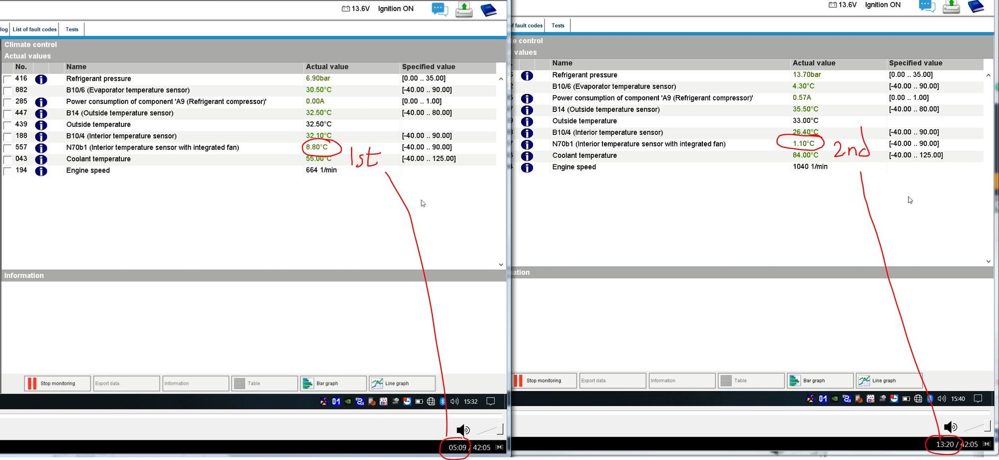

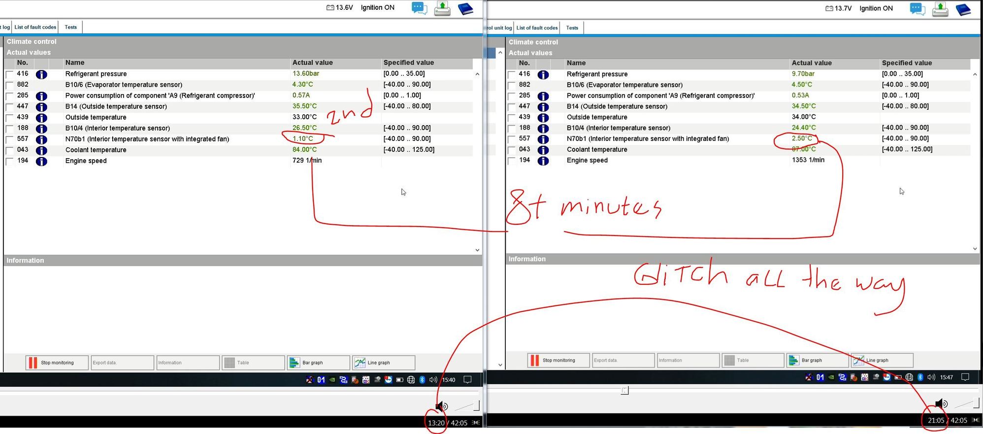

Depending on model year and car options, n70b1 can be via LIN or CAN BUS.
WITHOUT CAN BUS
I used to have erratic reading from N70/3-b1 <<<<---- take note I wrote N70/3 and not N70.
Tested the thermistor, it was OK.
Clean all the connector into N70/3 modules, and all then normal.
So bad contact I suppose.
Read here on N70/xx , post 52 : https://mbworld.org/forums/e-class-w...ml#post8411067
What scanner are u using ?
This is if using Xentry and XTool and my N70/3 is a NON CAN BUS module. This is when it was erratic.
This is using Xtool. When no more glitch.
Measuring the sensor/thermistor
