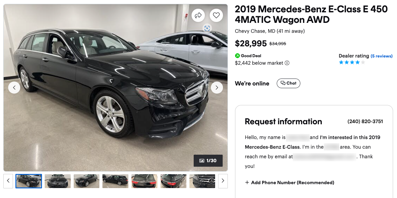

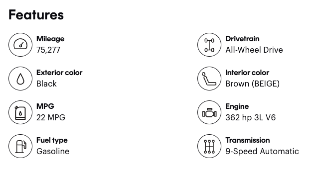

On the east coast, but give you an idea of what's available.
This is a 2019 with 75k miles, but it is also an E450, which has the superior M276 engine.
https://www.cargurus.com/Cars/invent...4/NONE/DEFAULT
