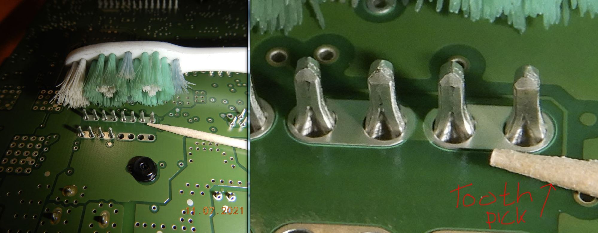

By soldering modules and cleaning GND, I have shown that every module with "pressed pins" had poor performance and impacted their peers by way of wasted network bandwidth.
The various module normally tolerate gracefully disrupted networking conditions expect the Bosch ECU in charge of ALT remote control.

The SOLDERLESS meant by OP is this one : The one at the PCB
You speak of the common connector with wire and crimped terminal, which will be below :

Thanks for the clarification. I've seen this press-fit assembly technique before -- it's supposed to form a gas-tight contact between the connector pin and the PCB's plated through hole, and remain integral. Has there been moisture intrusion into this assembly module? I'm sure there's been testing on this type of assembly technique, but I would be reluctant to use it in applications subject to shock and vibration, such as automotive. I once experienced an intermittent relay in an automobile that was soldered into a single sided PCB, where the solder was expected to form both the electrical and mechanical bond -- bad idea.
Old Dec 5, 2024 | 10:49 AM
S-Prihadi's Avatar
Joined: May 2018
Posts: 6,600
Likes: 6,547
From: Jakarta-Indonesia
The press fit is not gas tight, it is just faster than soldering and less solder use overall.
With those lead-free solder which is more brittle, I guess its a welcome technique by modules/electronic manufacturer.
Since we shall solder using lead type solder, and better with a solder having a 2.5% silver, the soldering will assist the press-fit to be better long term and less chance of oxidation.
Water intrusion NO, but surely overtime all press-fit contact do get oxidized, depending on where the car is being used.

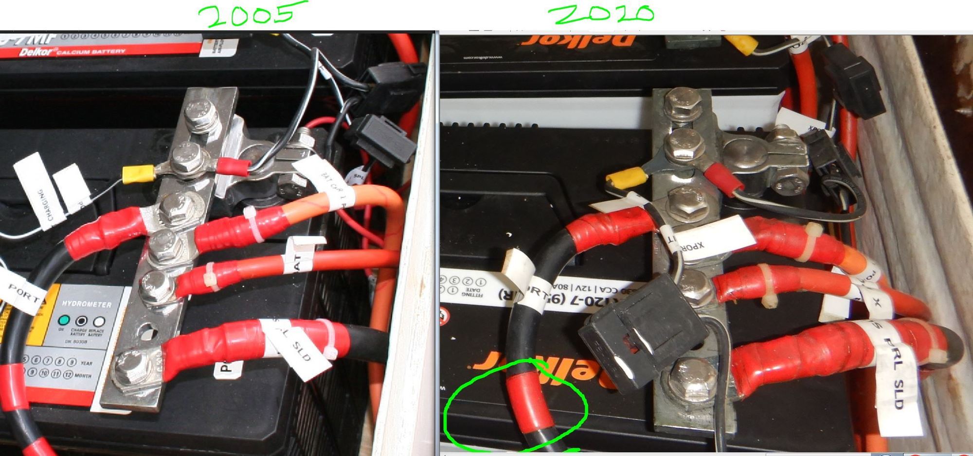

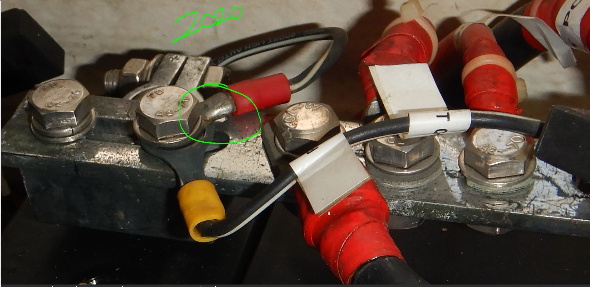

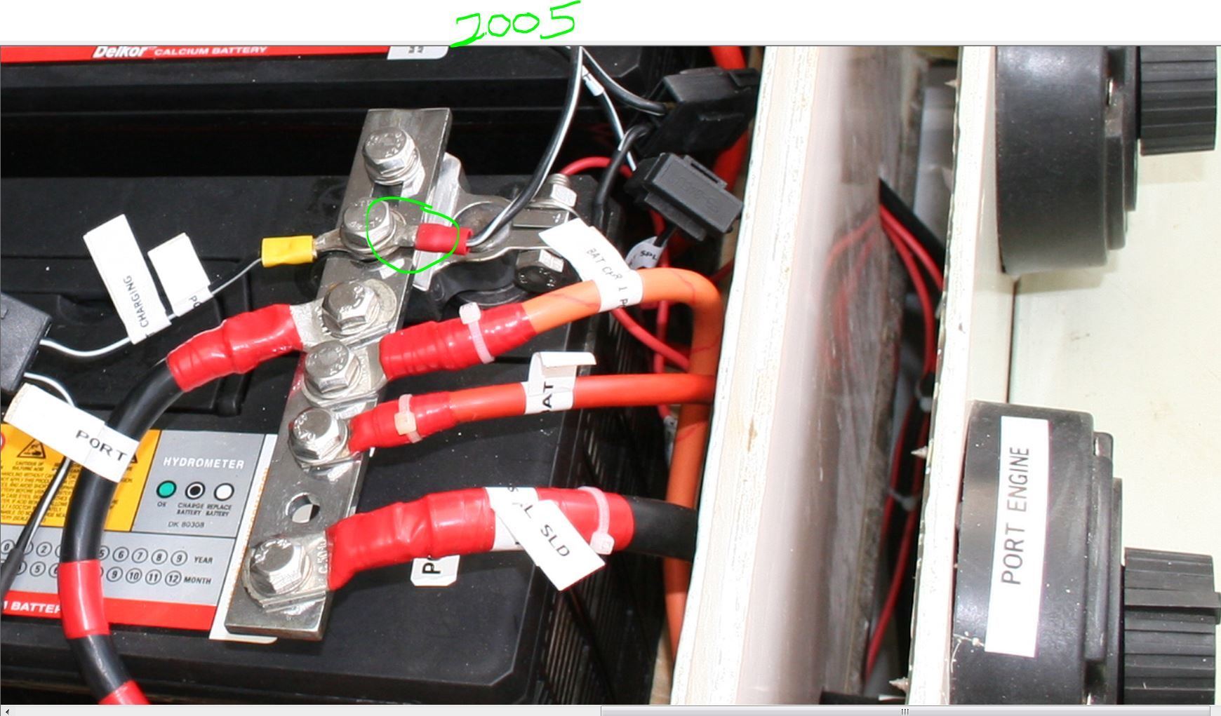

On my boat, I crimp and then solder each and every additional connector I use.
Its very salty and humid air on the boat and it has survived well.
I only use this solder since the 90s, from Goot, the one with 2.5% Silver : https://www.amazon.sg/SE-0AG08-Solde.../dp/B001PR1L46
It is very reliable long term.
Below : If Bare copper bar, and brass shunt. This is only 12 months on the boat.
All big cables are original Suzuki engine main power wires, except 1 with white mini cable tie.
Nickle plated copper bar for battery, when new in 2005 vs in 2020
Nickel for coating and silver for soldering is great. I custom order these from high purity copper and the battery terminal is also custom made, I copy high end audio battery terminal design,
but uses 99.XX% high purity copper. My partner for this boat has all the tooling like wire cut, CNC machine and etc etc, because he has a factory making home appliances
