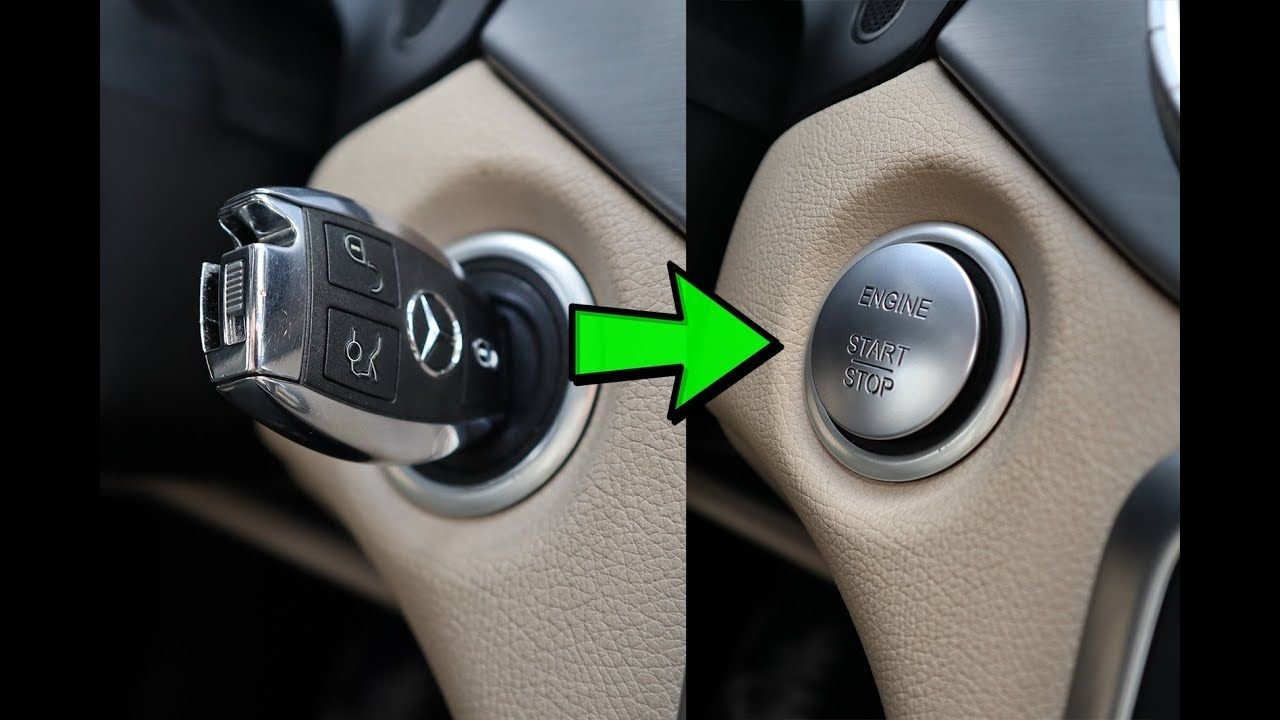

does your car have a keyfob like this that you insert into a hole in the dash and turn ? If so, you're missing the push-to-start button that fits in that same hole, .
this button can be had for liek $25 on fleabay, it fits all 2014-2016 (at least) Mercedes. Note however, your keyfob has to have a good battery to use this. it will start the car in the hole manually without a battery.
