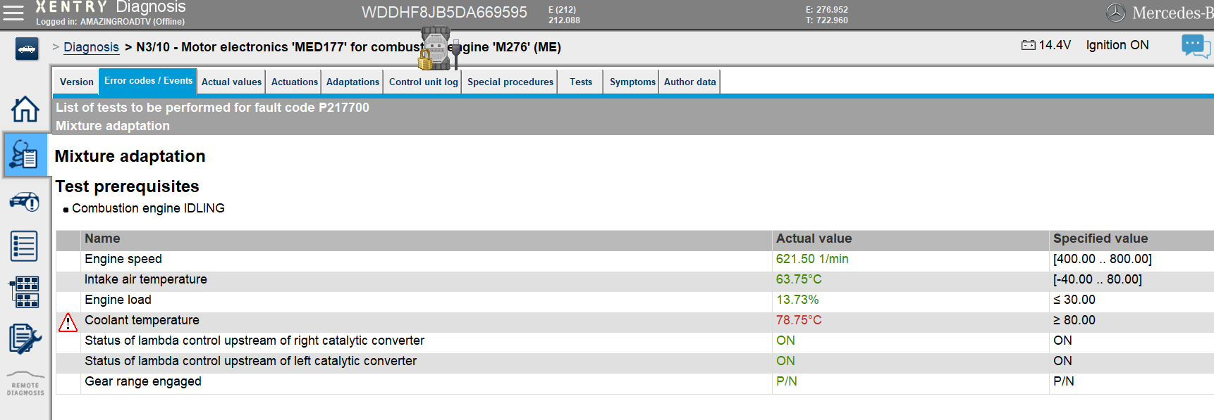

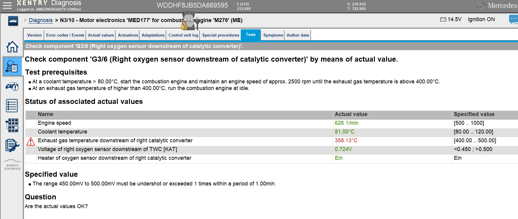

I just installed Xentry in my new notebook and got few diagnostic result.

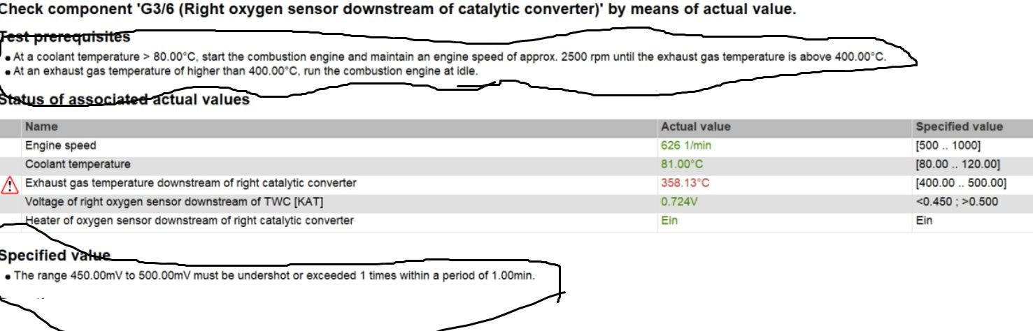

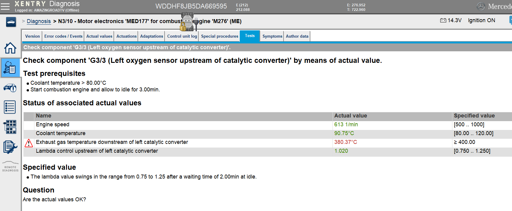

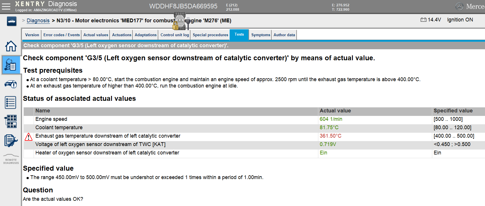

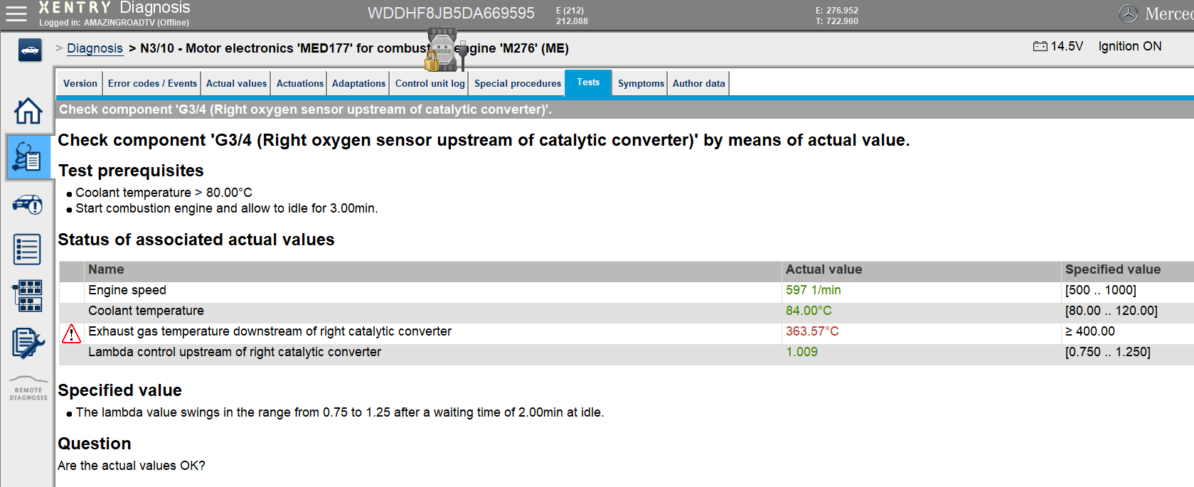

PART 1: O2 Sensor
Reply 0

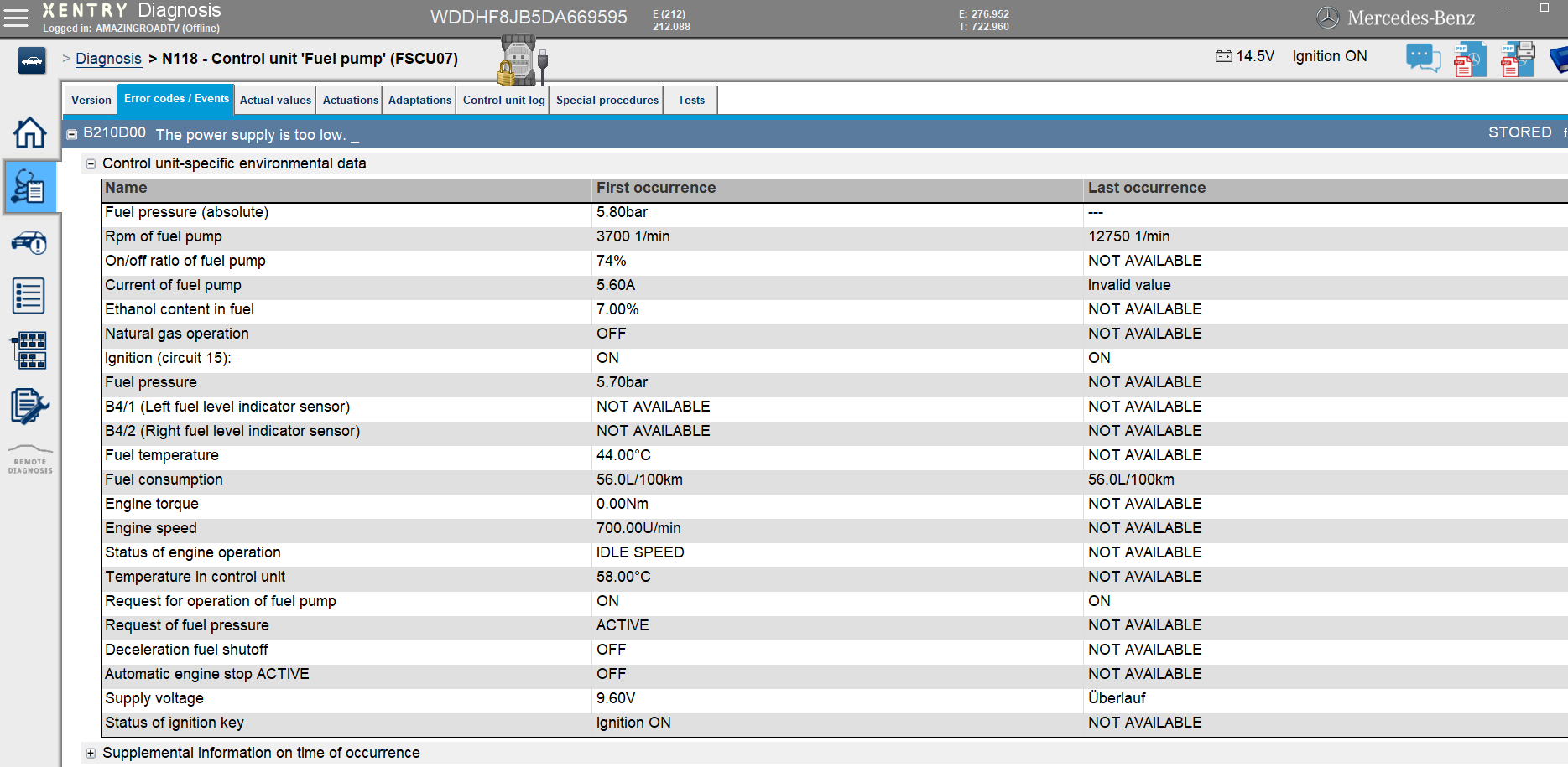

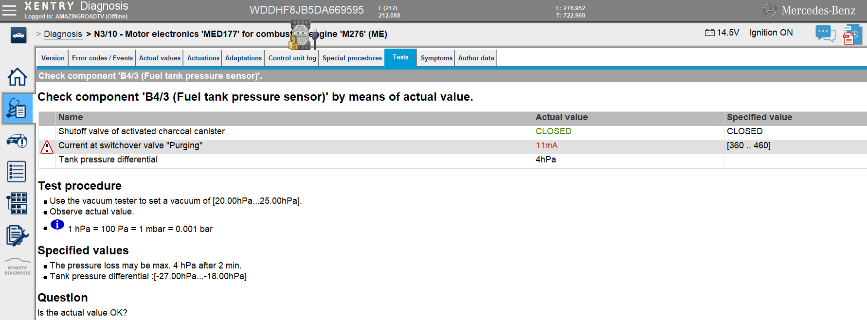

Dec 24, 2024 | 04:52 PM

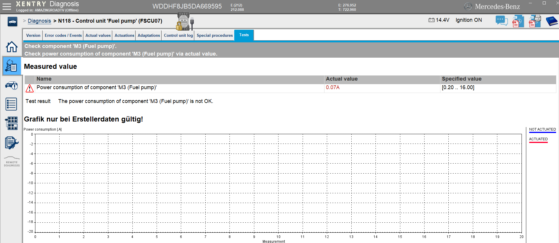

Result Part 2: Fuel Pump
Reply 0

Look like Fuel pump current is so small it could be connectivity, or the pump need replacement considering I had 208K miles now.
Do I need to replace all 4 O2 sensors or something else cause temperature is under the range for all O2 sensor near catalytic converter.

@mercyfan , I would start again the test trying to meet the "Test Prerequisites"
As you may observe, in some test or Actual Values readings you have a bolded text like "Test Prerequisites", meaning that for conducting the test the following conditions should be met before continuing the test or before getting any conclusion.
This way, the red values it's not errors, it's just parameters that had to be waited to become...green.
Anyway, Xentry is the most advanced diag system in the entire automotive industry and you can start from the very beginning, like click on the each fault code and just press "continue'...the steps suggested is based on MB experience and will take into account many parameters in the background at each step.
For Example at the Oxygen sensor test, first you have to wait till coolant is more then 80C, after you have to maintain the engine speed of approx 2500rpm....and so on till all the "Prerequisites" will be ready...
