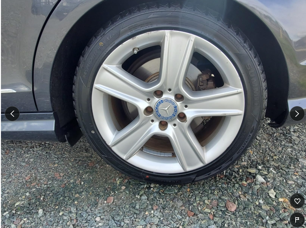

Old Dec 27, 2024 | 09:26 PM
TimC300's Avatar
Joined: Aug 2023
Posts: 3,689
Likes: 1,111
From: MA Coast
I replaced my tires earlier this year with Summit Ultramax HP A/S. Bought them off Amazon for $310 then paid $100 to have them installed, mounted and balanced. Plus I had two new tire sensors installed and the other two rebuilt. So far i really like these tires. I have yet to drive in snow so cant comment on that. But highways, backroads, rain, they are great. very quiet and the ride is smooth even with having the sports suspension.
The previous tires were new when I bought the car 5yrs ago, I only replaced them due to cracking, the tread was still ok.
I have always been buying the lowest price tires with good reviews for all previous cars. Never had a flat, never needed a tow truck, never drove off the road due to tire issues.
