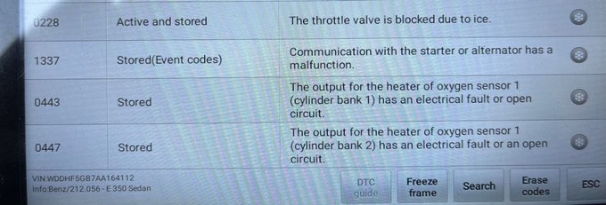

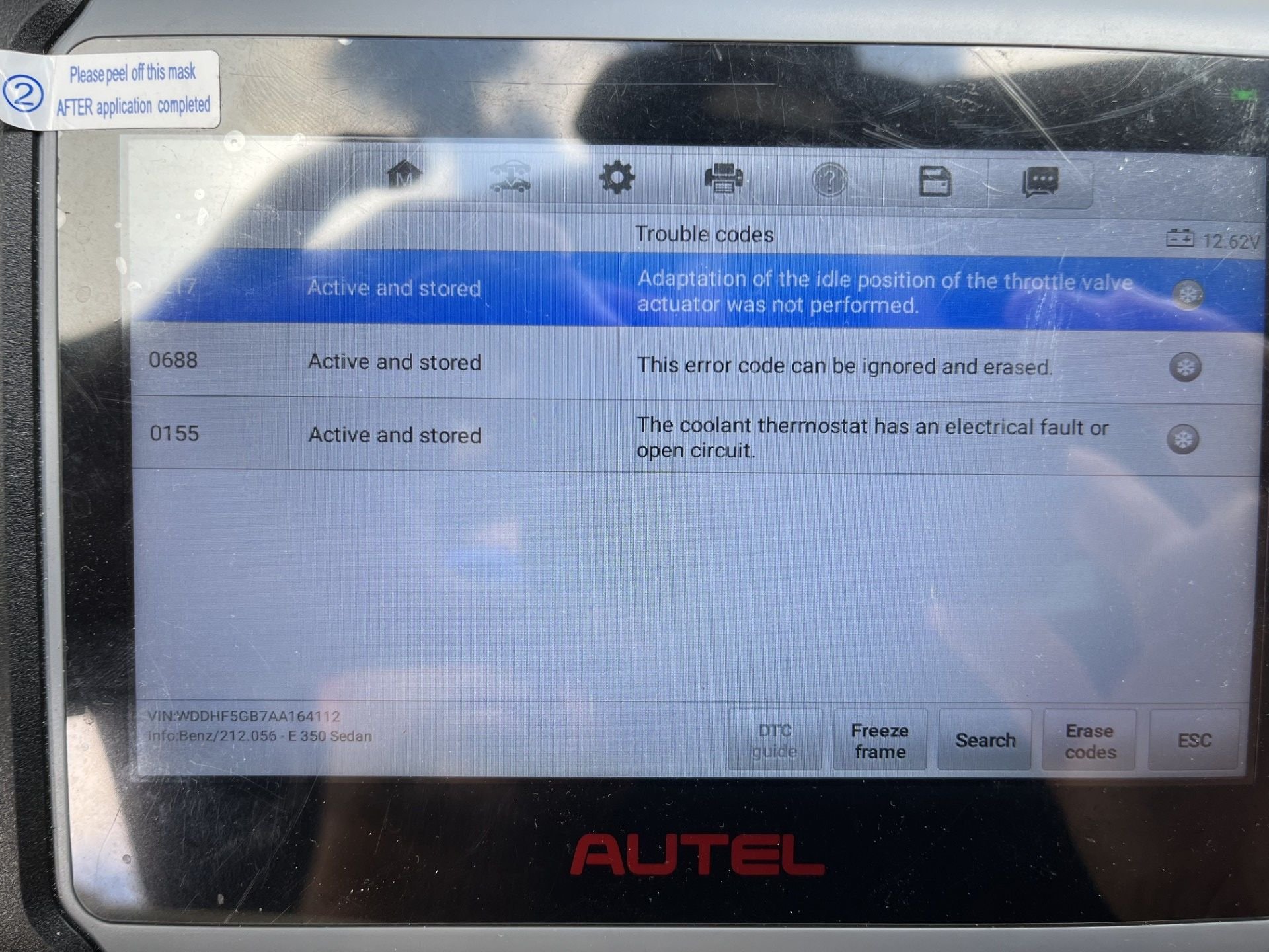

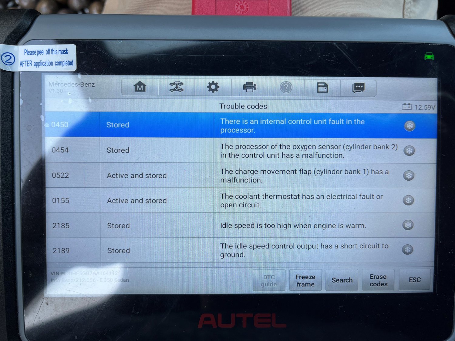

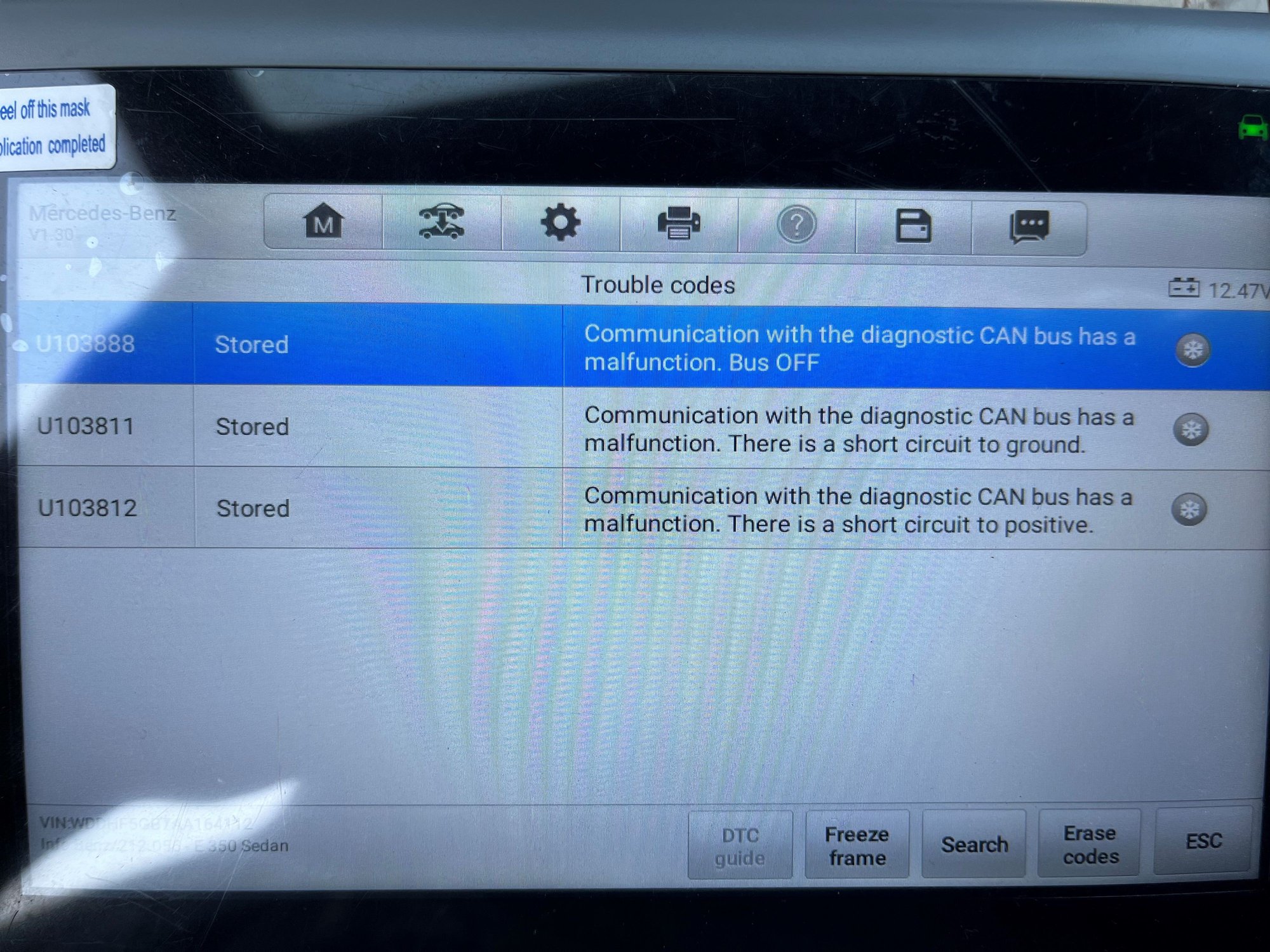

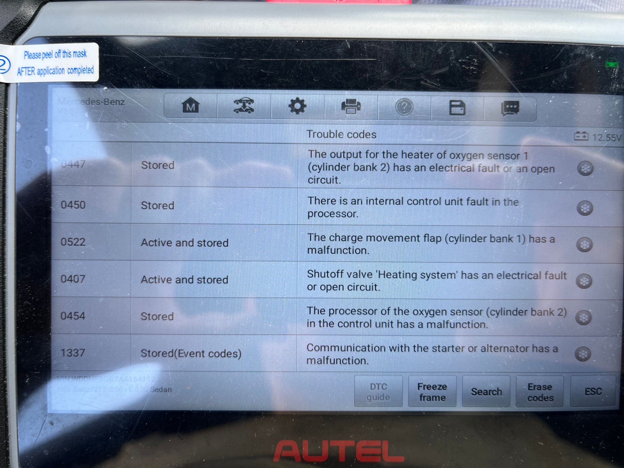

Roger that CBD. I checked the fuel pressure. It was ~60psi I forgot to include a few other codes which I thought were irrelevant, but I will explain why.
U103888 – Stored – Communication with the diagnostic CAN bus has a malfunction. Bus OFF
I overlooked this one.^
0522 Active and Store – The charge movement flap(cylinder bank 1 has a malfunction
I purchased a manifold from 1A auto and changed the entire manifold in February 2023. The code persisted so I thought maybe it’s a faulty connector – so I ignored it.
0155 Active and Store – The coolant thermostat has an electrical fault or open circuit
I accidentally broke the thermostat housing connector.
0407 Stored – Shutoff valve ‘Heating system” has an electrical fault or open circuit
Perhaps this is related to the broken thermostat housing. Perhaps irrelevant to my issues.
>> I see.
>> yes, this is scanner disconnect issue. ok
>> Fix issues as they come👍
>> Yes, without working Tstat control by ECU it's max heat opening only.

Thanks Cali, I forgot to mention that when I took the car around the block to fuel, my dash lit up with ESC and other flags. See cluster pic
Prior to not starting the car in a month, I had fully charged the battery. As a matter of fact, I have a charger/tender on most of my vehicles/boats. Not to mention the battery is less than a year old. It did get cold( by Florida standards - freezing) down here. Hence code 0228 - I assume
Moving forward, the battery is charged. I cleared the faults. I'll drive it around the block this week.

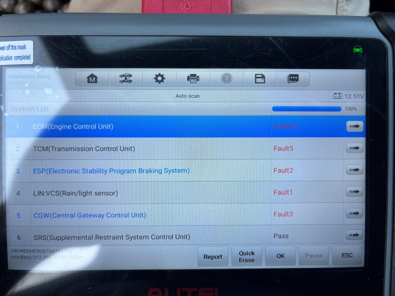

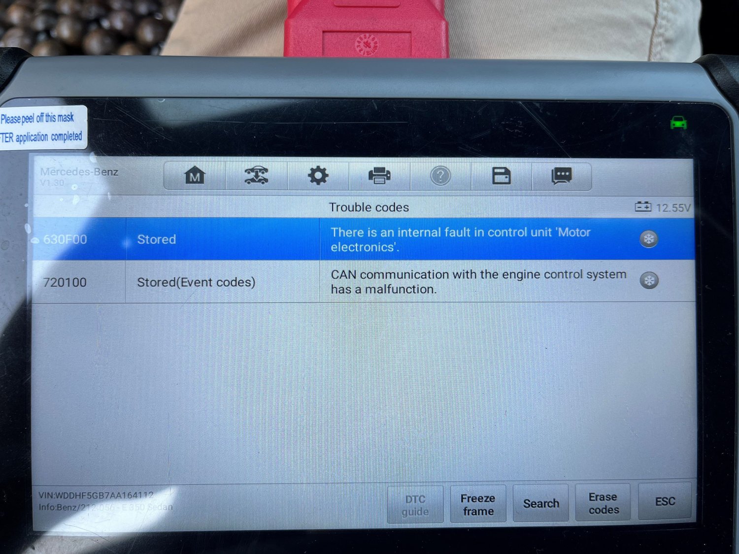

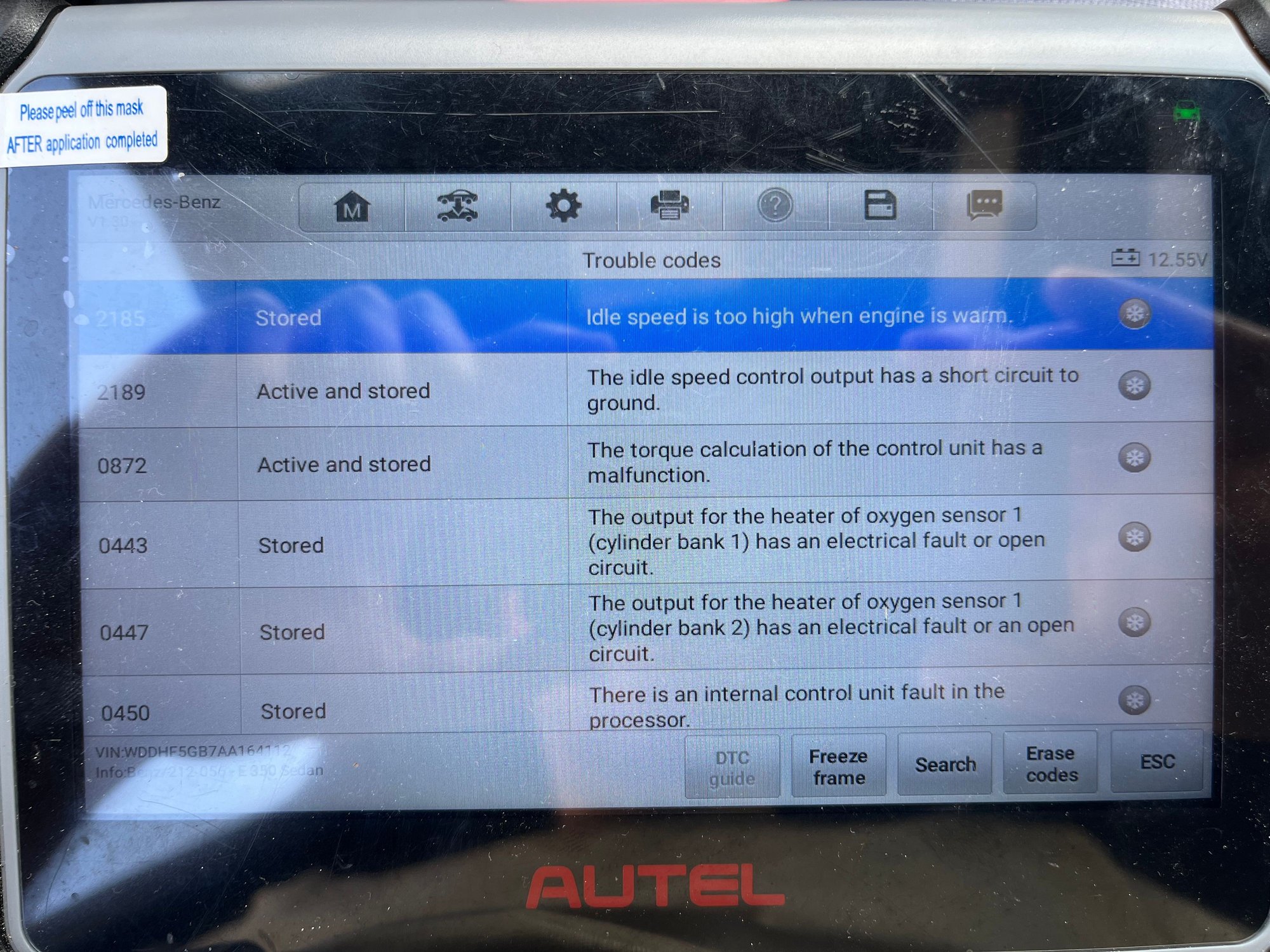

In any case, I posted the ESP and CGW scan results. Any pointers with respect to the CAN/CGW codes?
It would be a major breakthrough if we can pin point this to a module!
Thanks in advance.
Right when car went into limp mode.
Overall scan view
Overall scan view
ECM codes Page 1
ECM codes Page 1
ECM codes Page 2
ECM codes Page 2

After reviewing your fresh collection....
ECU's in the lake
ECU's in the lake
it becomes evident the primary suspicion is a defective ECU. The top reasons being either: oil swamp or voltage chaos.
Not the tranny at all.
> How so...
Compare the ECU faults with orher module faults.
Then you get the idea of which is first.
Disruption is unlikely external to ECU.... ie. its internal disruption.

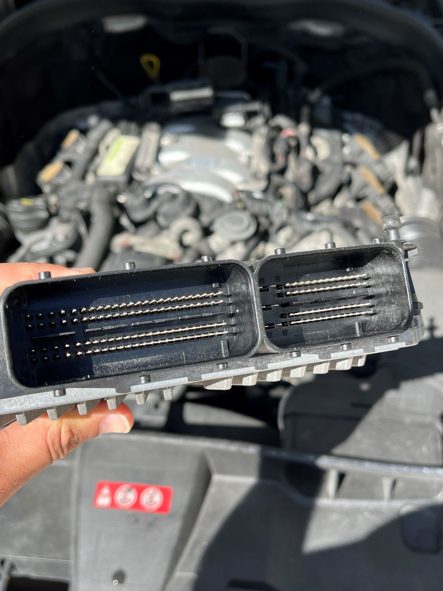

Cali, thank you for borrowing your time. I removed the ECU. I didn't see anything out of the norm. In my past when ECU's are having issues, the car generally doesn't even turn on. Anything else we can do pin point the issue to the ecu? Do the CGW errors mean anything?

I inspected your pics. they show what looks like brand new Mal/Fem connectors
