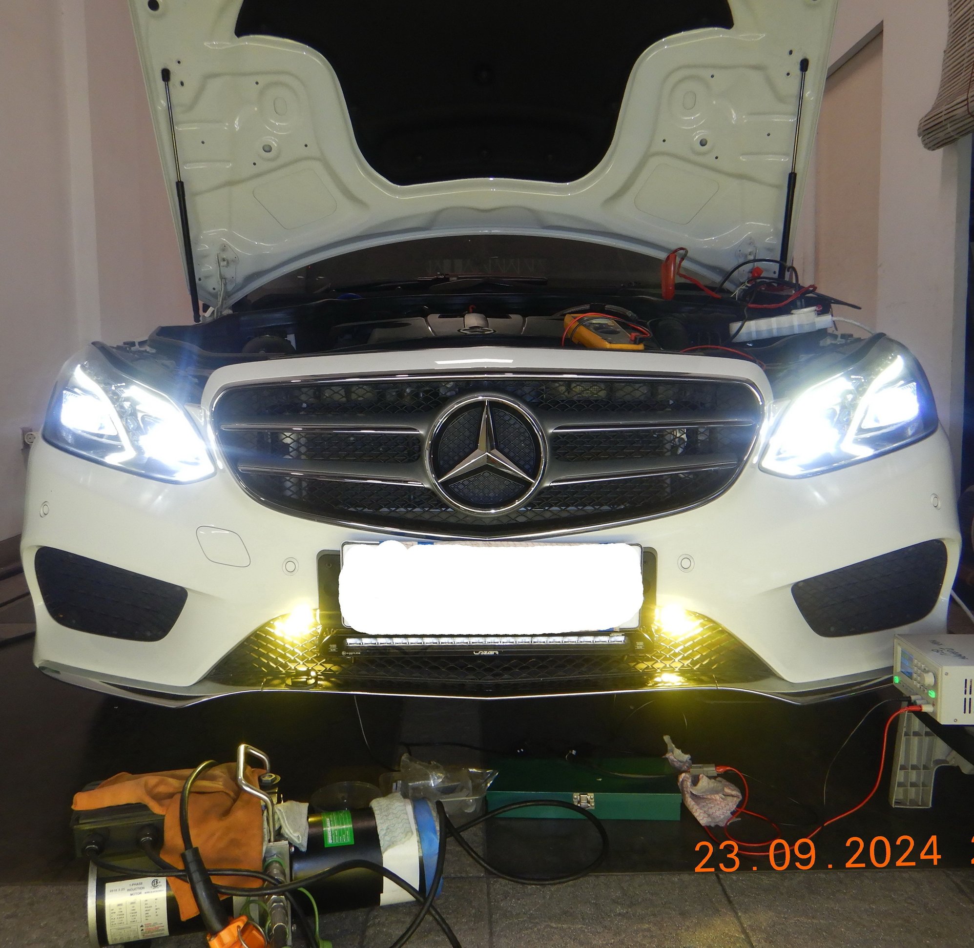

Gents,
I was studying my last trip where my installed extra AUX lights were tested well, these lights : https://mbworld.org/forums/e-class-w...-fog-lamp.html
The trip is this one : https://mbworld.org/forums/e-class-w...wide-road.html

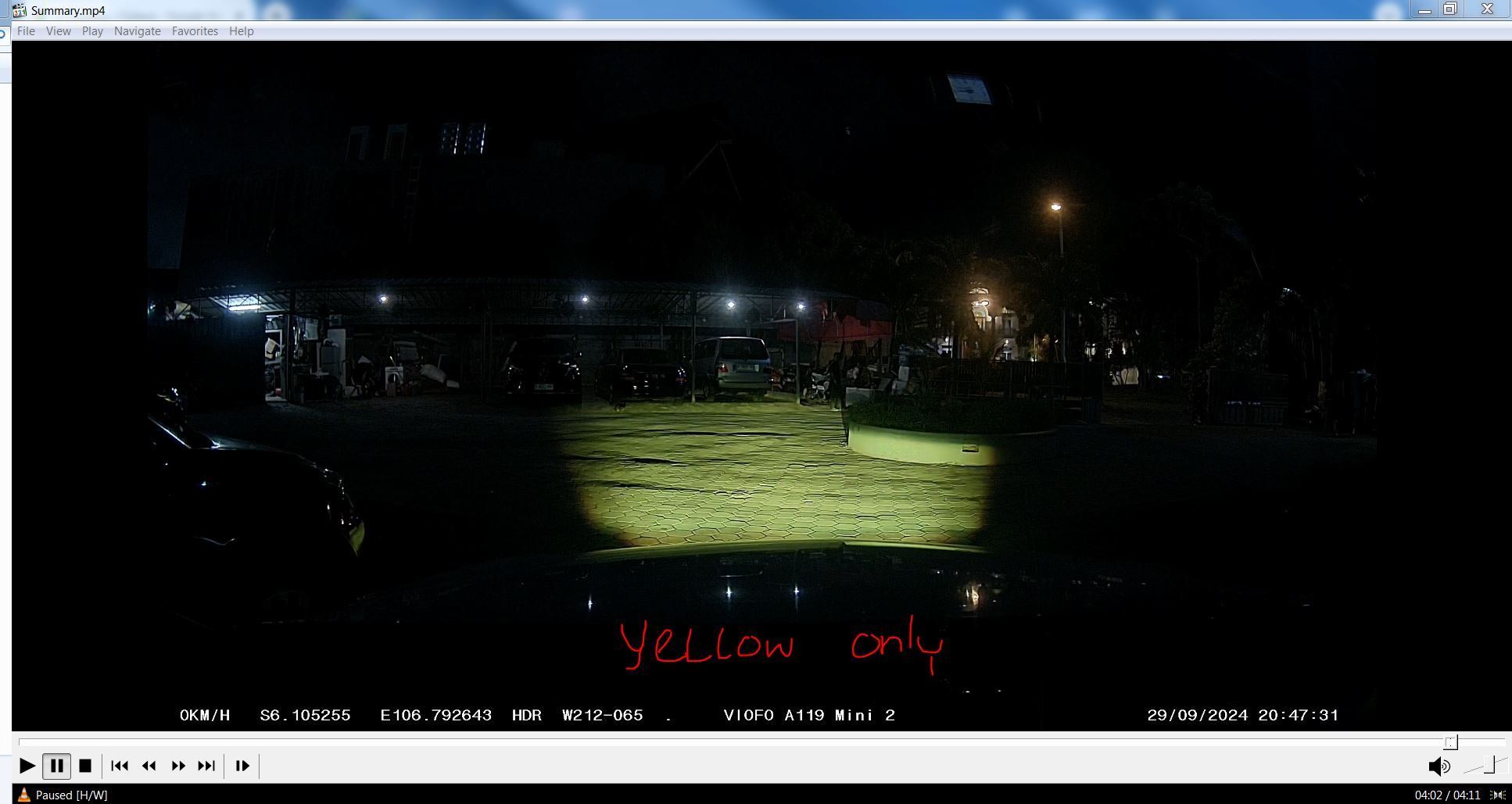

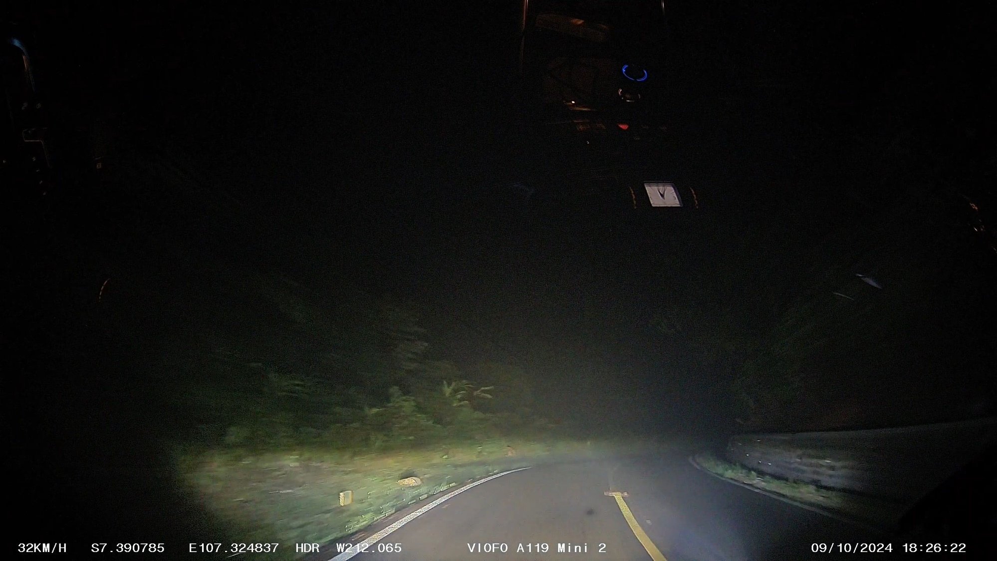

My yellow fog lamp came handy, but it was not bright enough and not wide enough beam spread.

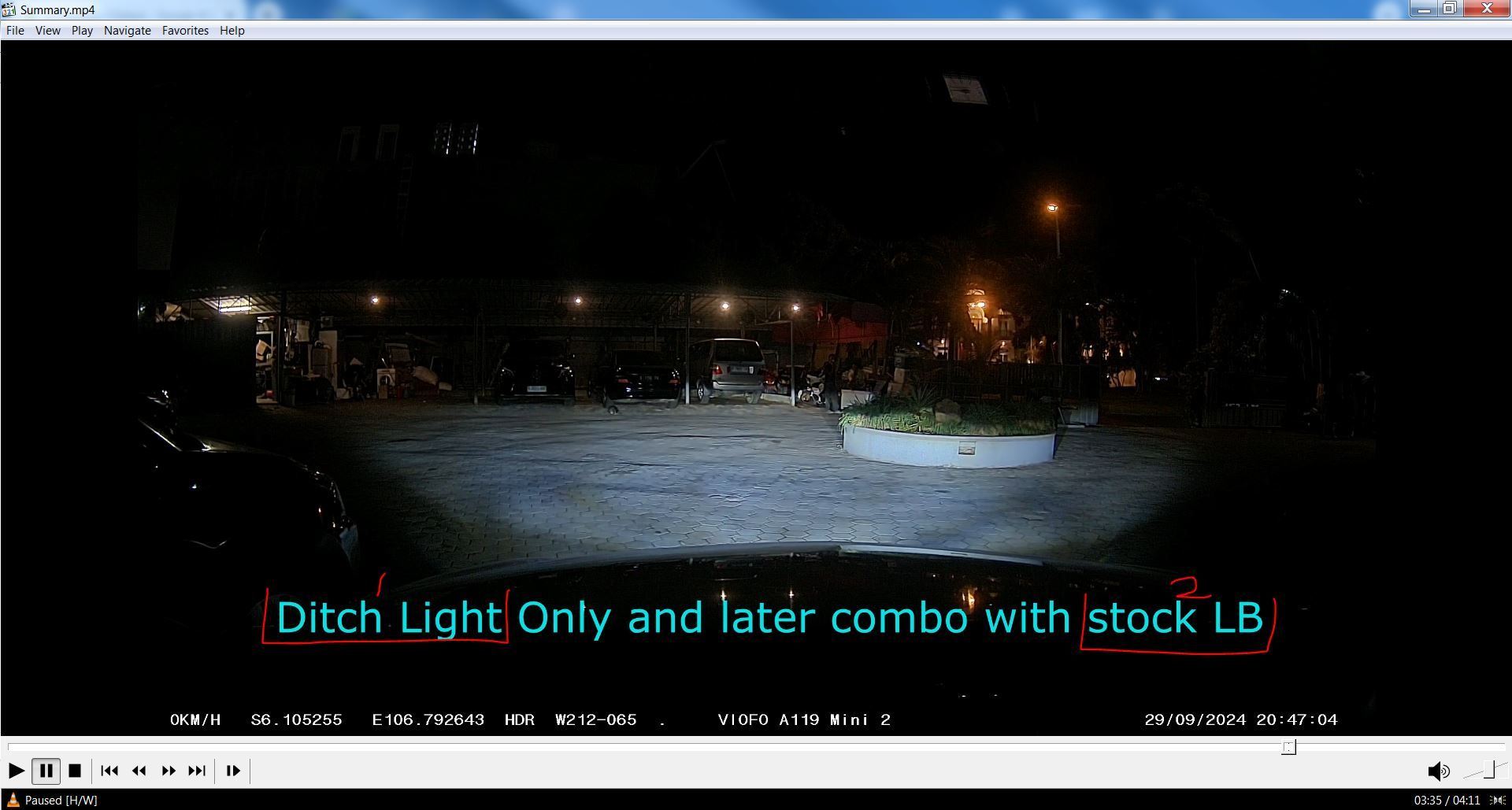

The "ditch light" came handy too.
Extra Low beam ( center of road target illumination ) is not of much use on the snakey road, as there is no pot hole.

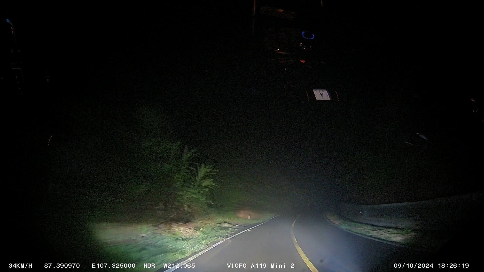

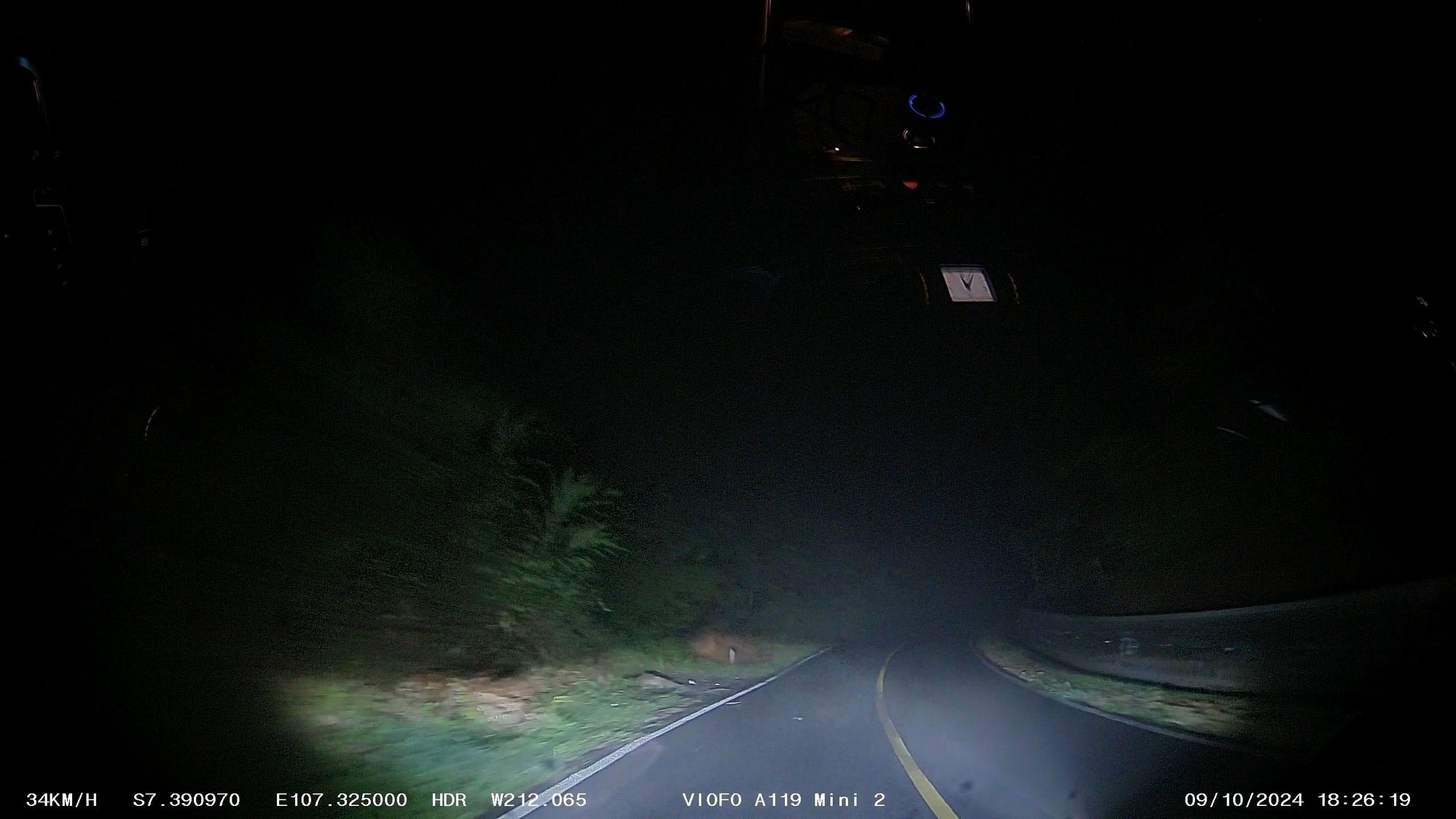

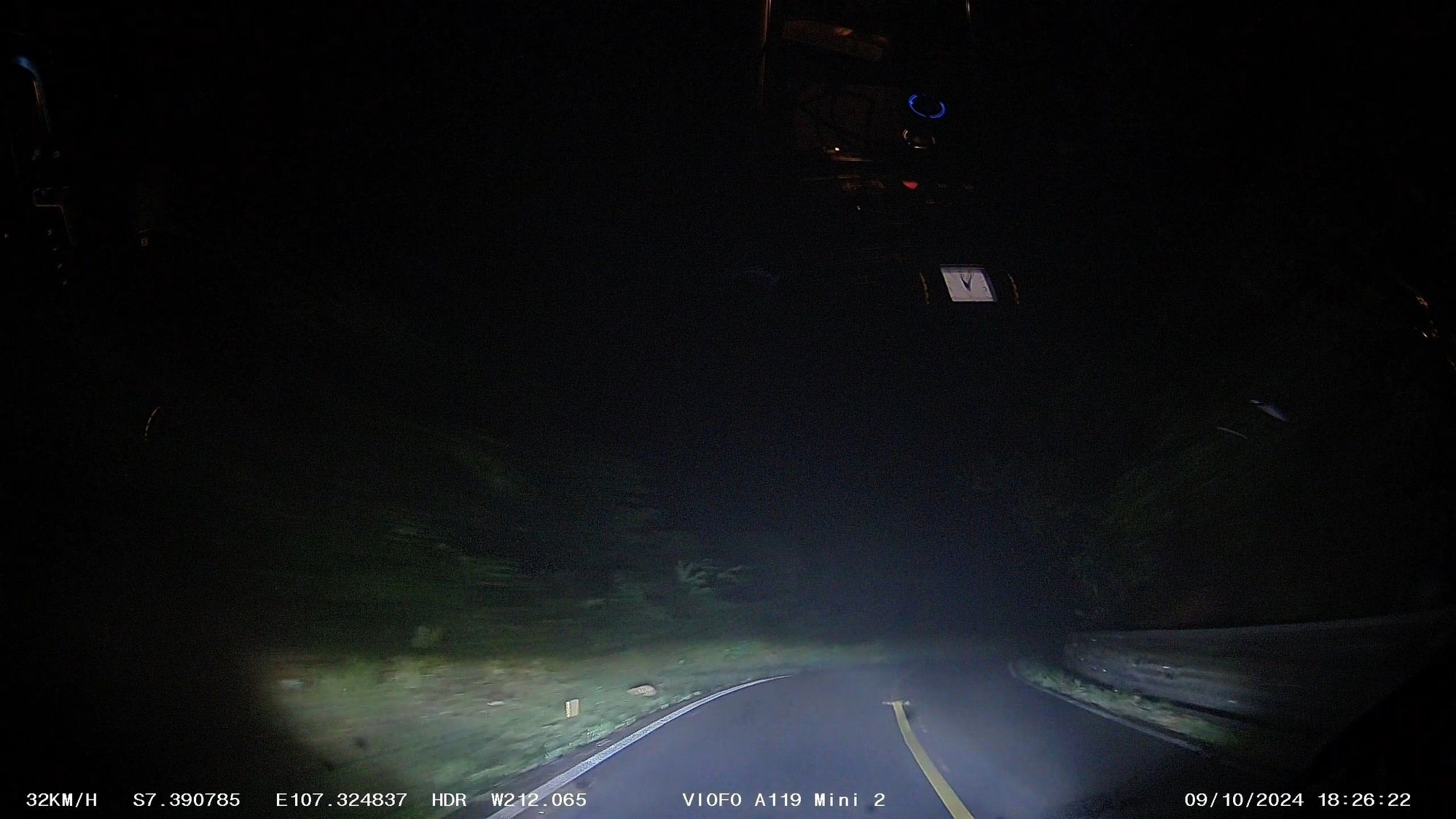

Car stock low beam + Ditch Light
Car stock low beam + Ditch Light + YELLOW LIGHT.
A bit better to see the greenery and the red soil/earth.
Again : A bit better to see the greenery and the red soil/earth.

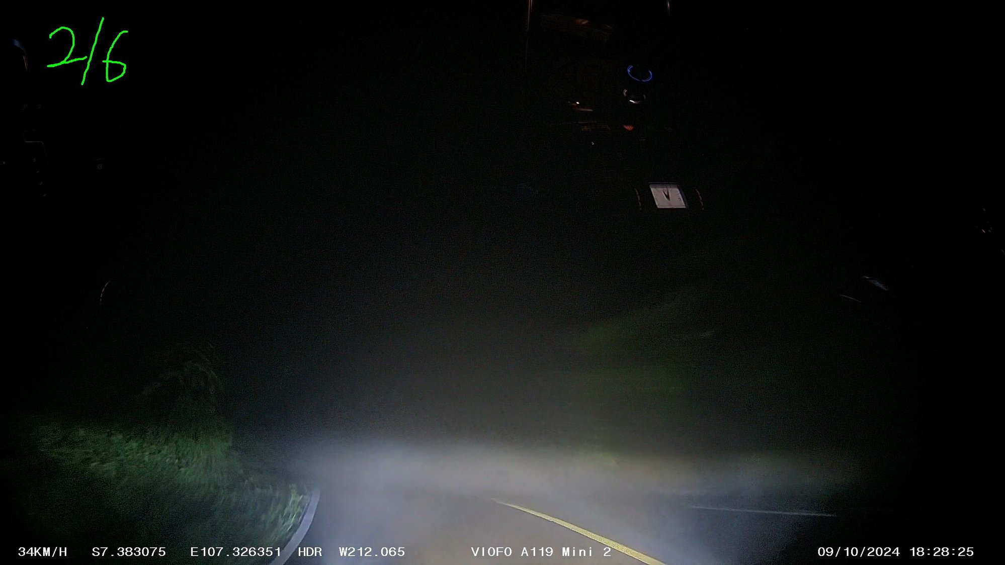

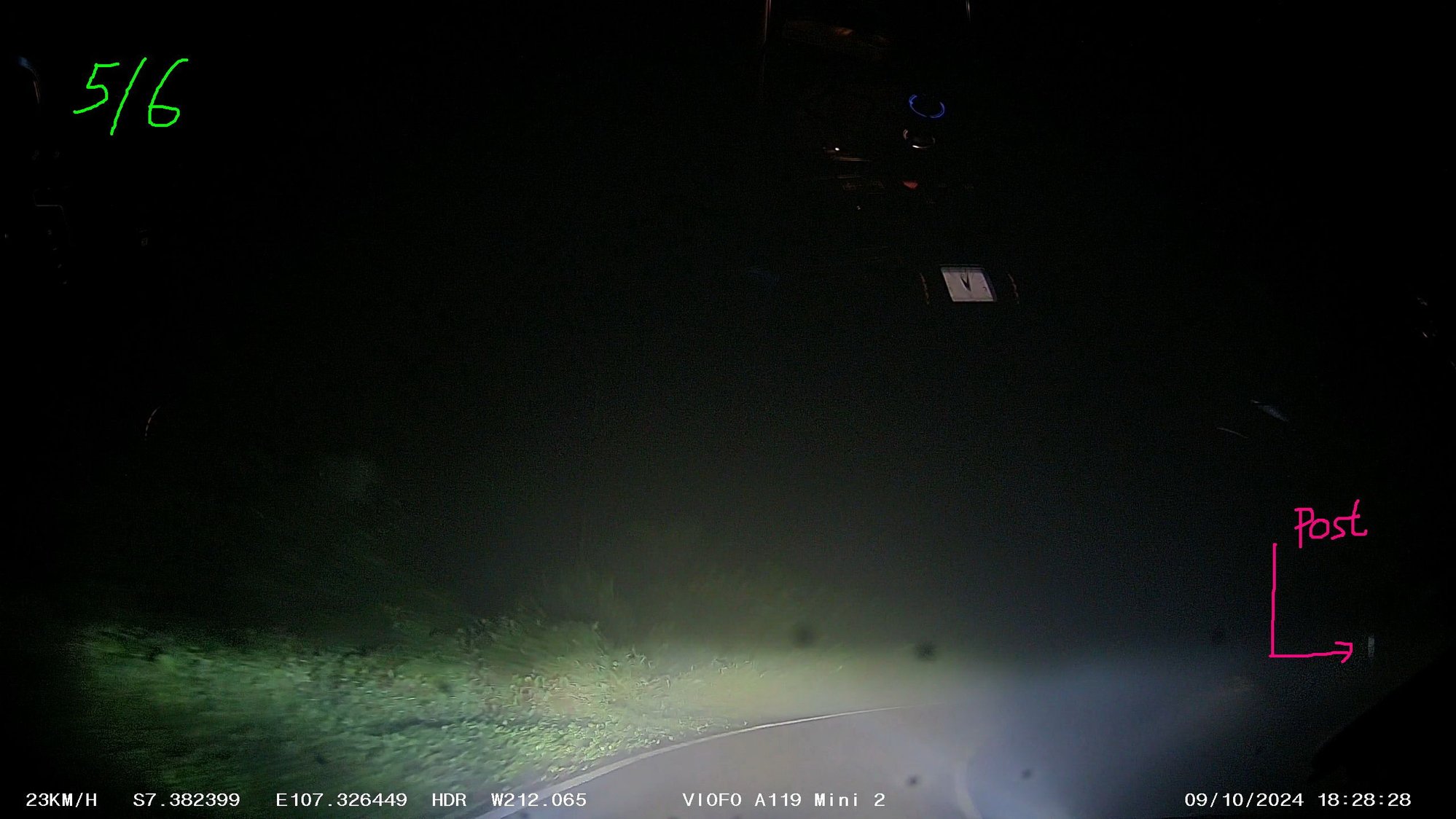

Very low installed yellow fog light is good, it produces less glare.

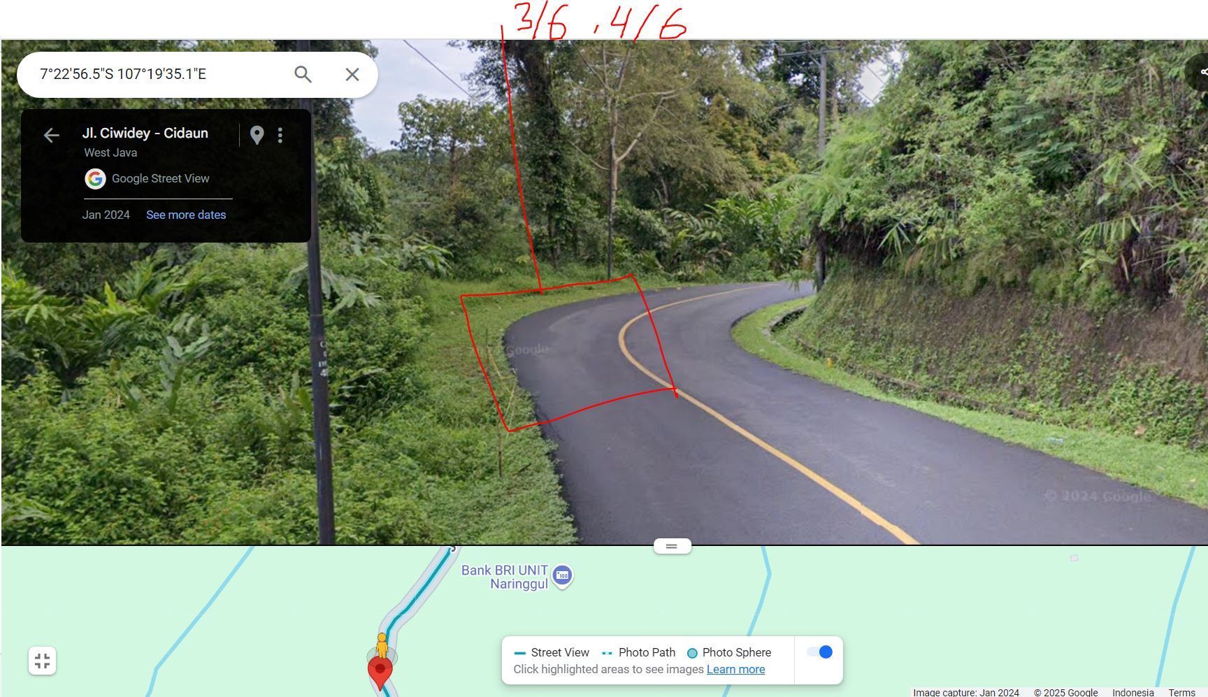

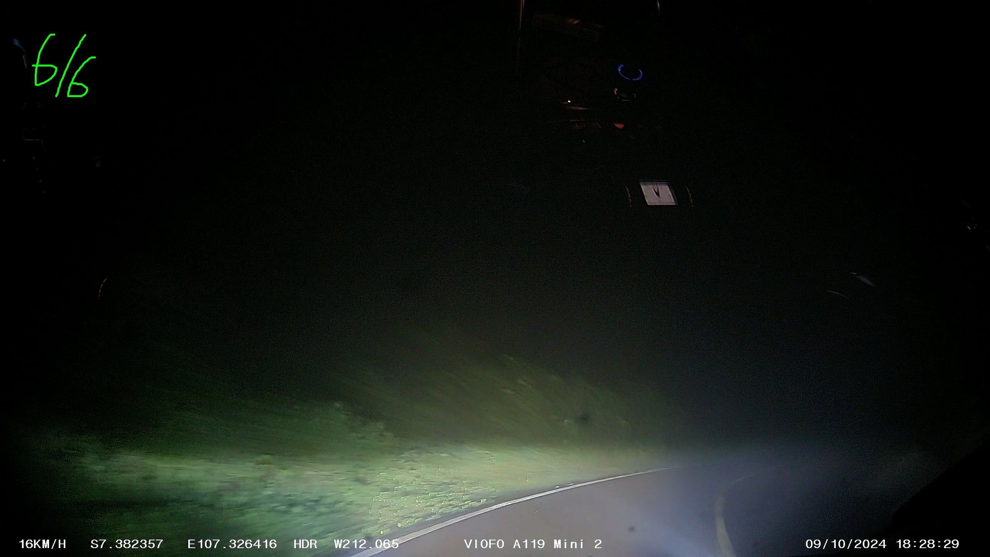

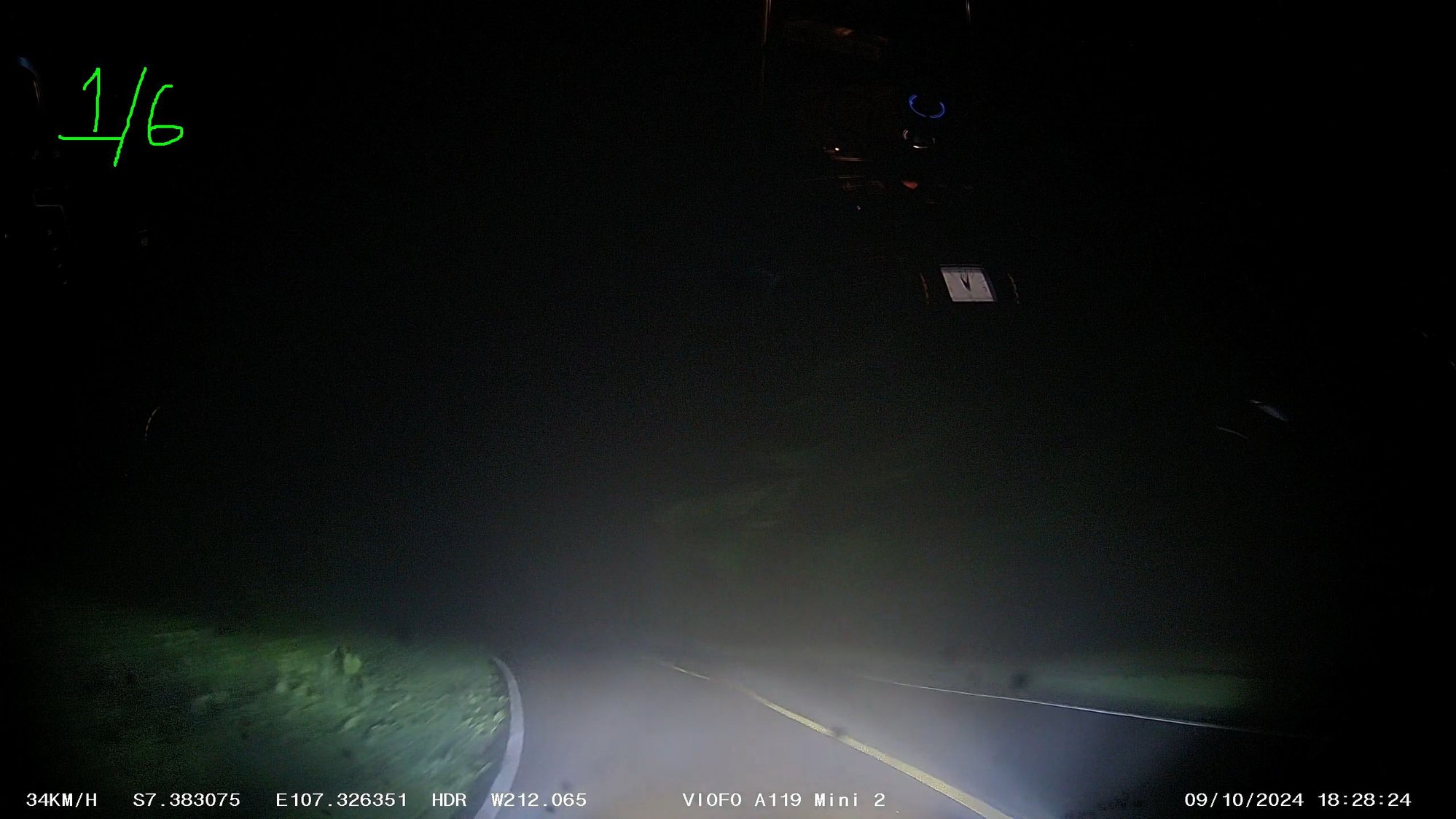

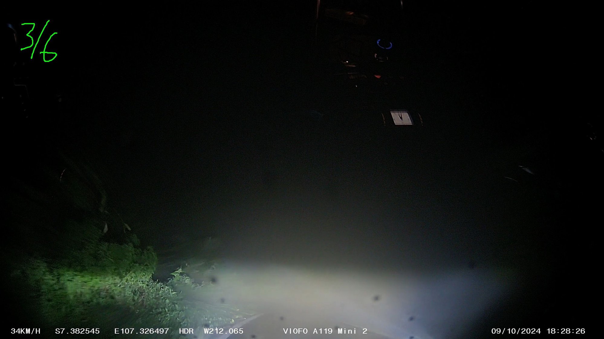

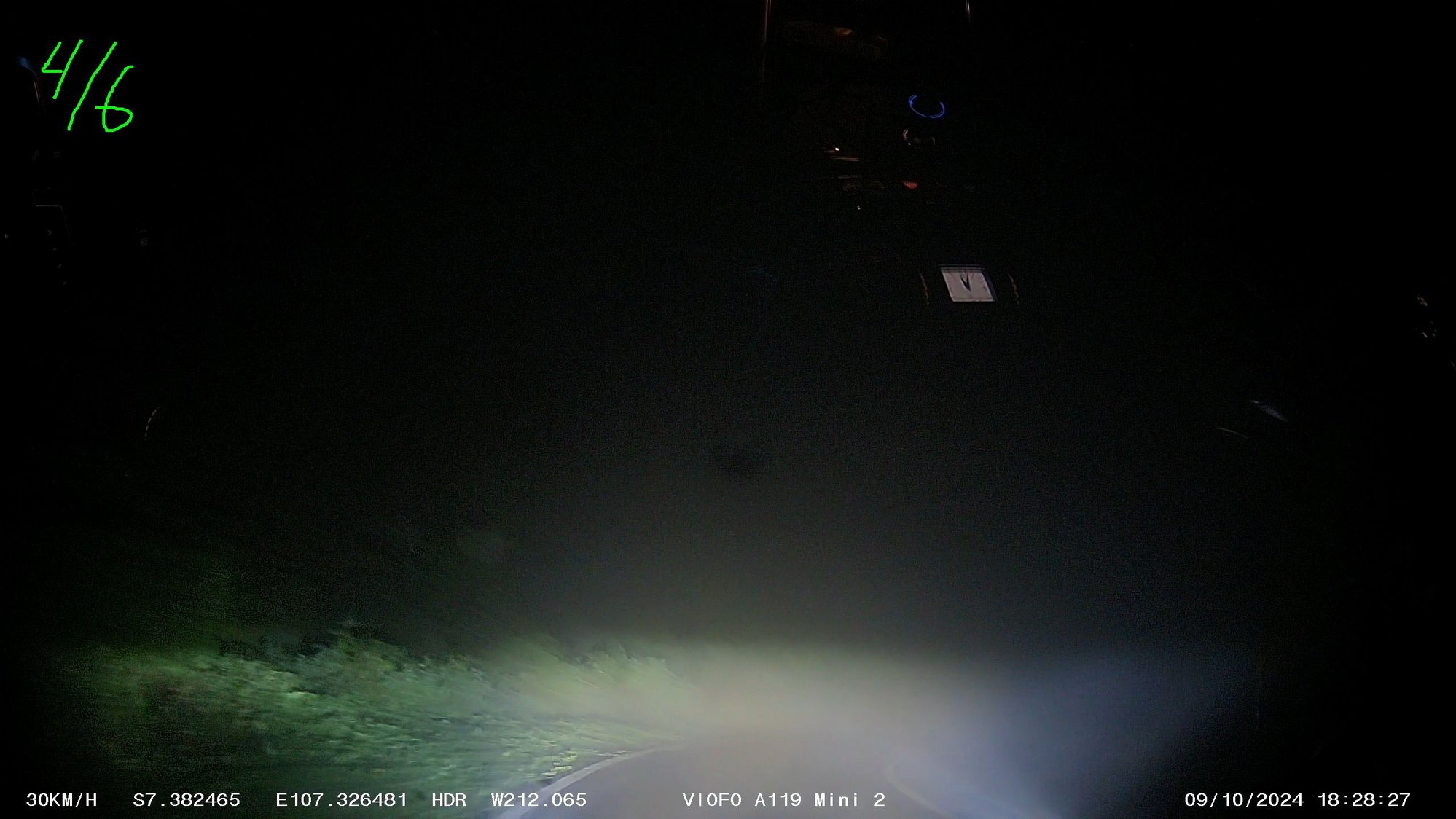

Small crest on the road, made stock low beam spray high and glaring in the fog.
Image 3/6 and 4/6 shows the low beam became very glaring once car is not level, while being on a minor crest.

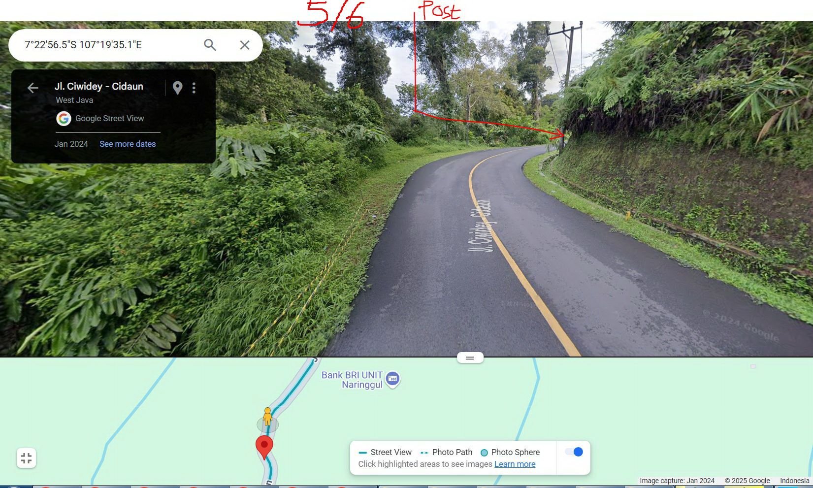

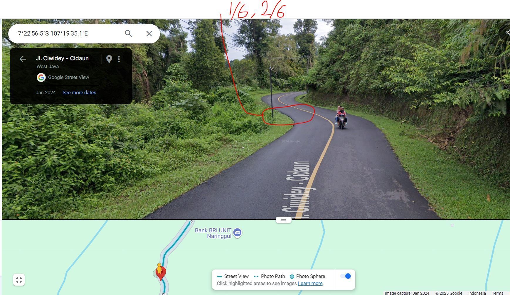

I never expected this right hand turn to be this sharp.... almost 90 degrees.
I can't turn OFF my stock low beam, as the yellow fog lamp is too weak for its brightness and not wide angle enough in that fog.

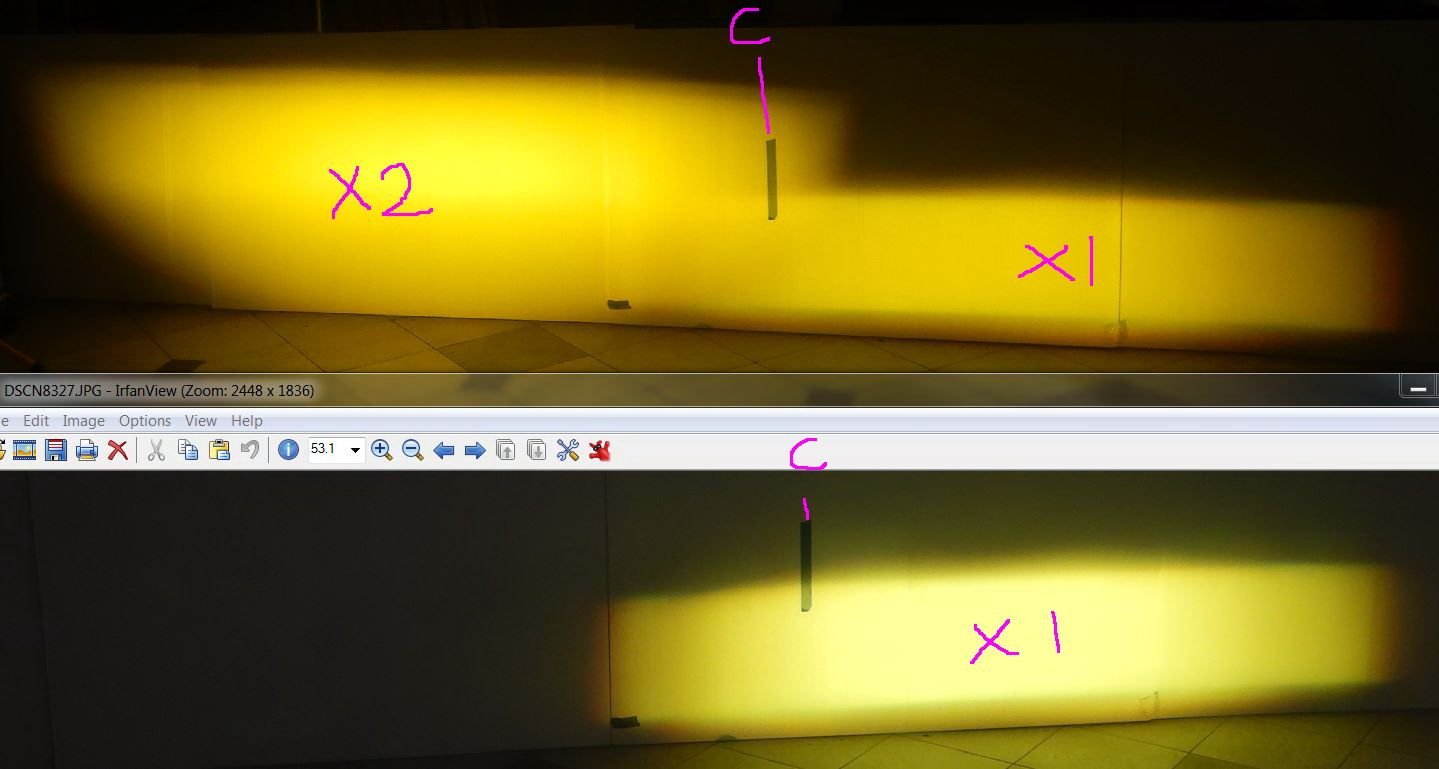

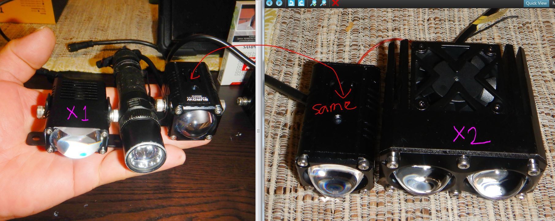

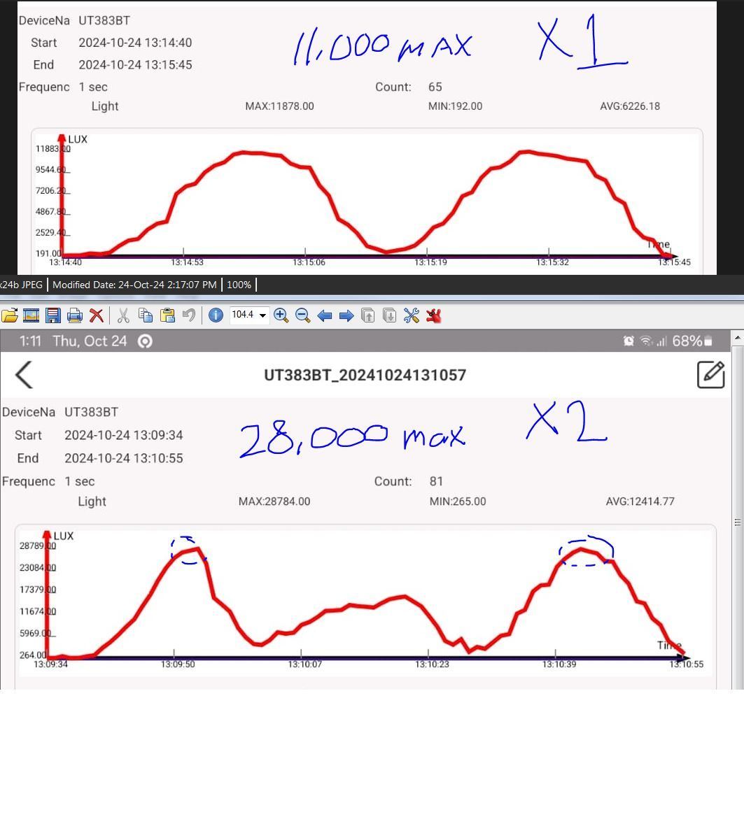

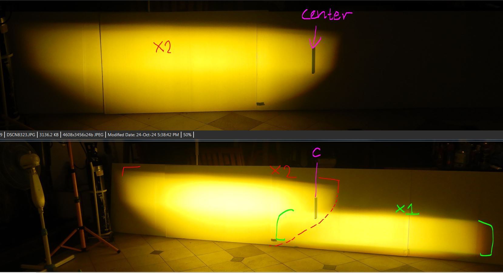

I bought a twin module ( X2) yellow fog, but have not install it yet. Single module I call it X1.
I have done some test.

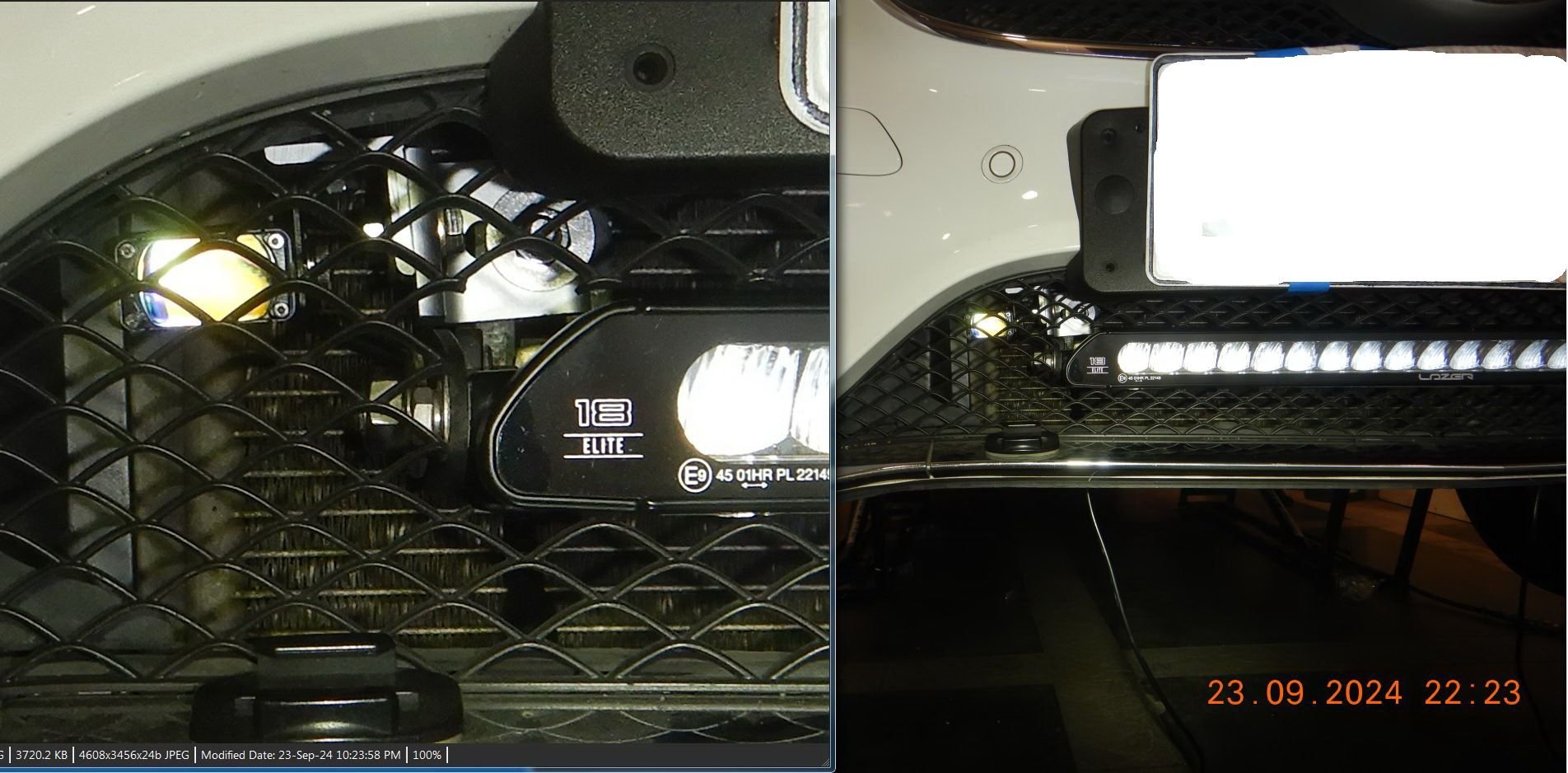

Size comparison X1 vs X2. I do not know if X2 will fit X1 current position or not.
X1 current position
