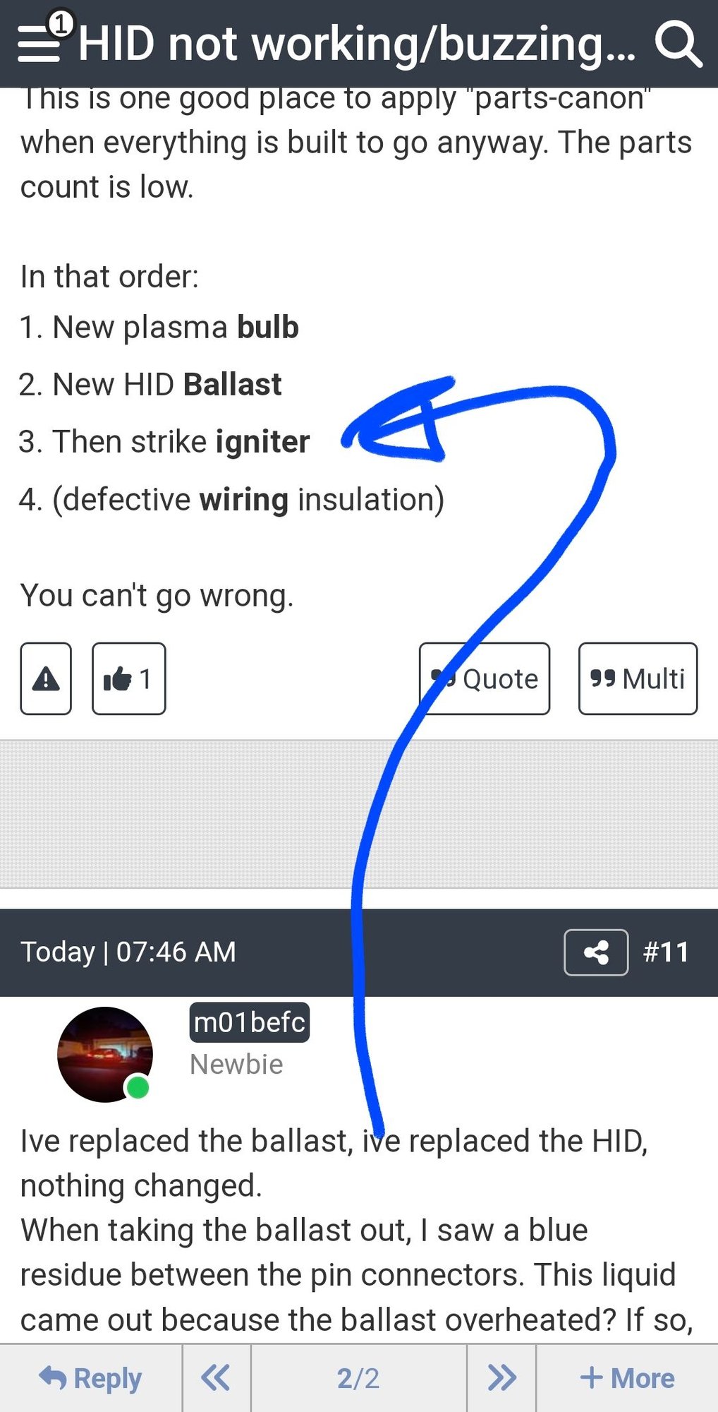

This is one good place to apply "parts-canon" when everything is built to go anyway. The parts count is low.
In that order:
  1. New plasma bulb
  2. New HID Ballast
  3. Then strike igniter
  4. (defective wiring insulation)
You can't go wrong.

Ive replaced the ballast, ive replaced the HID, nothing changed.
​​​​​​When taking the ballast out, I saw a blue residue between the pin connectors. This liquid came out because the ballast overheated? If so, what could it be? Its unlikely that 3 ballasts have failed.

​​​​​​​The IGNITER...
the bulb igniter
the bulb igniter
located in the socket where you spotted blue residue... presumably electrolyte from a leaking capacitor.
