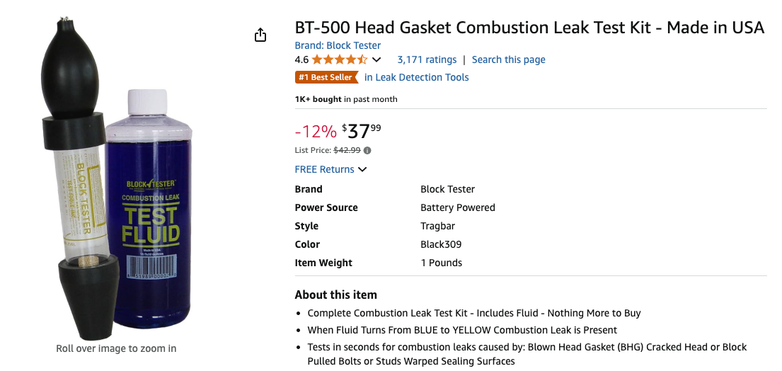

Rust in the cooling system? I had a 2004 SL500 that was 17 years old when I traded it and had no rust. Confirm you DON'T have a head gasket problem by doing a block check. This test kit absolutely works if you have any kind of leak.
(LOL! It's not battery powered.)
