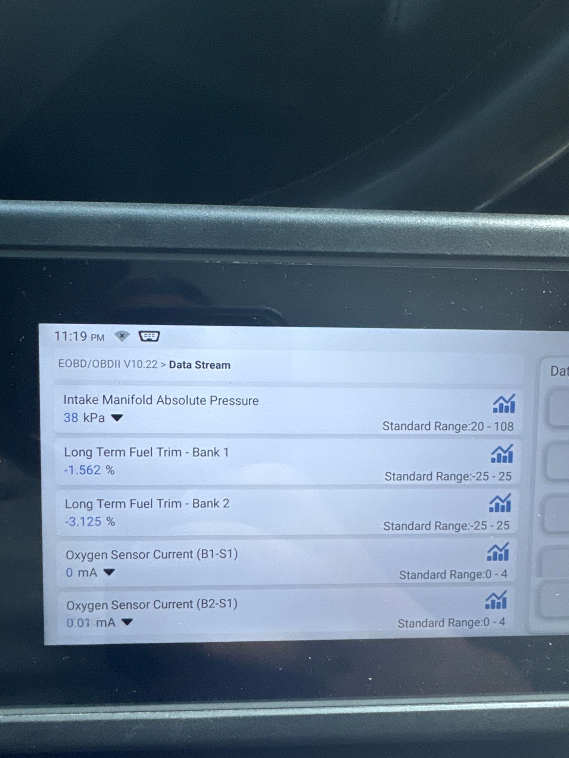

When the car is idling it’s always between -1.5 to -3
when car is moving it’s around 1 to 7

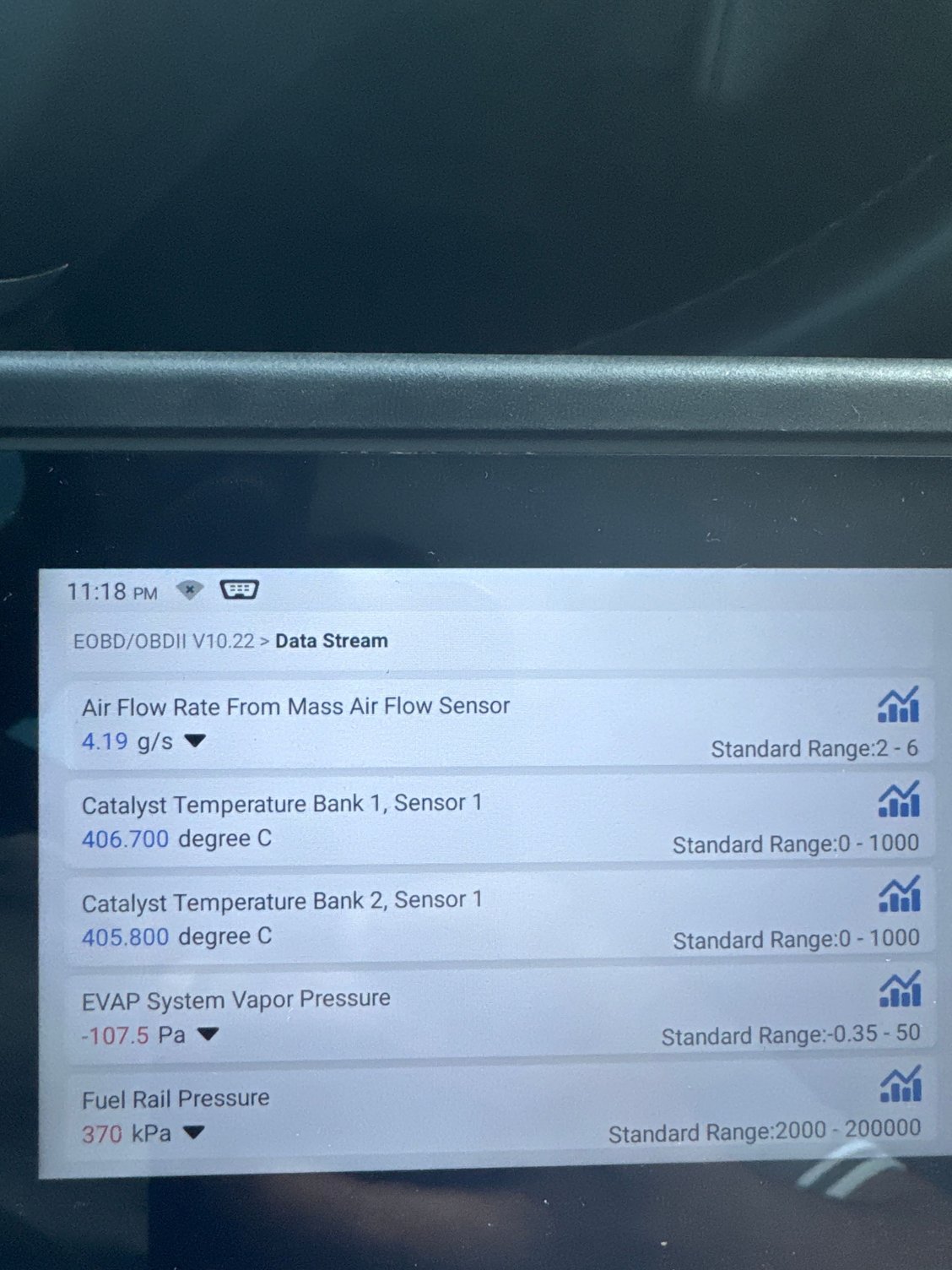

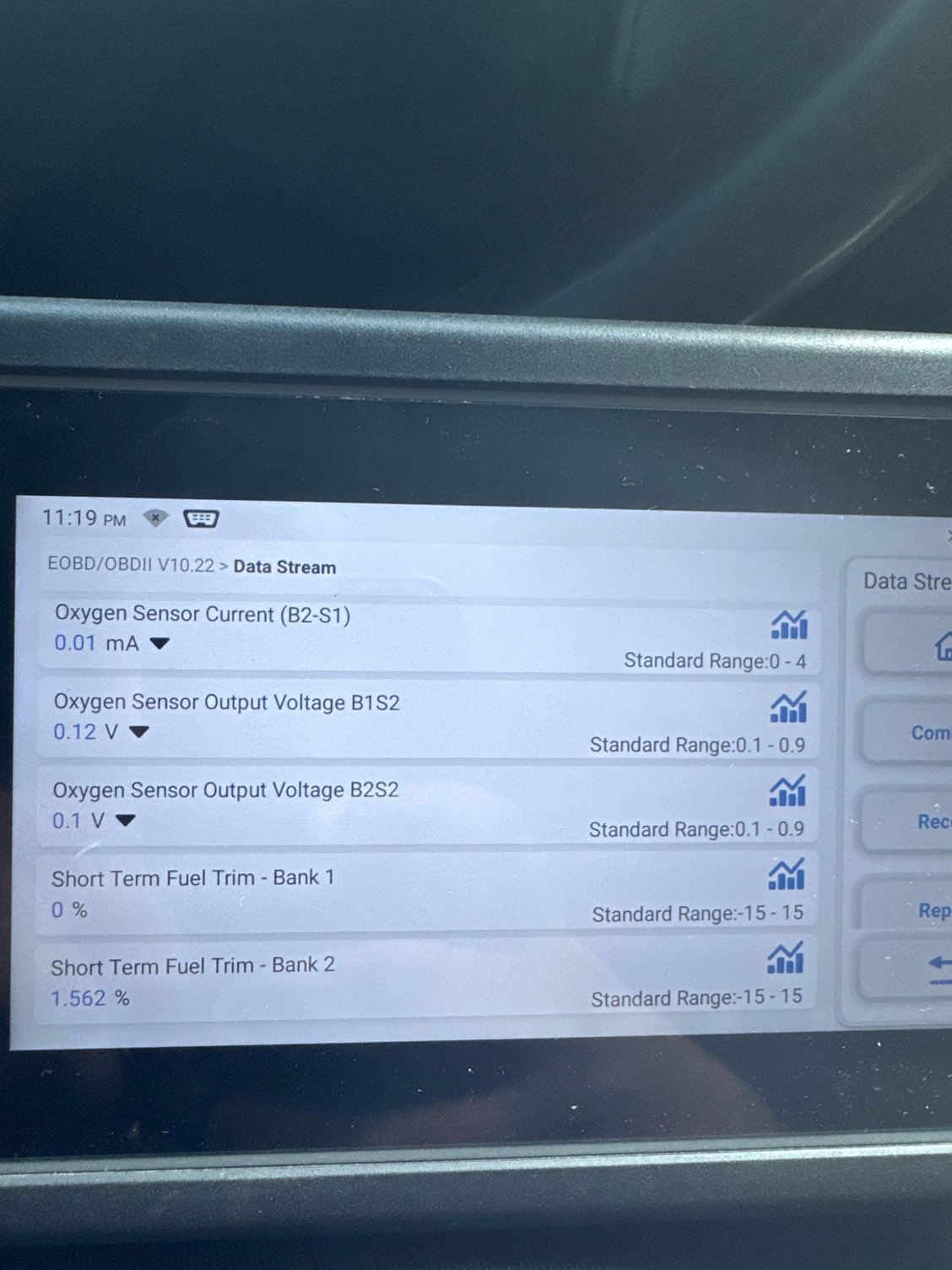

attached below is the live data after 140 KM

live data collection showing as normal.
LTFT slightly lean.
Does your engine have secondary air injection pump ?? test your air pump mgt valve with your scanner or for air leaking through.

So this is M272 engine.
Anyway, your rear oxygen sensors the narrowband ones, the B1-S2 and B2-S2 is reading wrong or very lean if at 0.12 volts and stayed there.
Could be bad sensors, but both at the same time is uncommon, but can happen.
Narrow band curve/voltage - Pelican Parts Forums
Can your scanner produce Lambda value for the front wideband 02 sensors ?
So front and rear 02 sensors Rich/Lean values compared.
Playing with the throttle from idle to 3,000 RPM should produce rear sensors reading up and down rich/lean, if that does not happen, very high chance your rear 02 sensors are already bad.
The ECM tells you if the CATs are BAD , is from how the rear 02 sensors responding.
Sure you can have BAD CATs, but it/they will not pegged an 02 sensor to 0.12 volts all the time.
