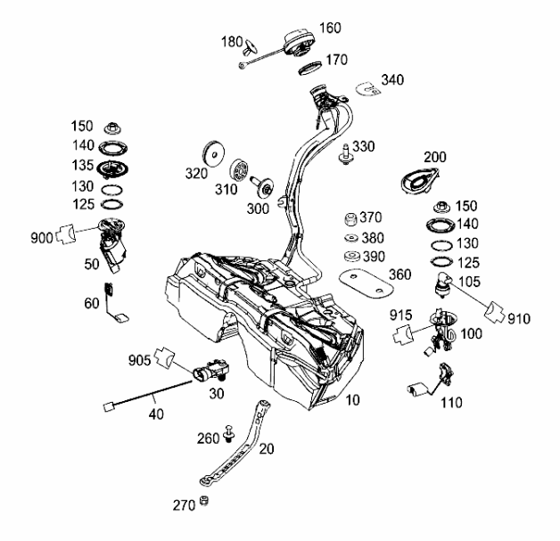

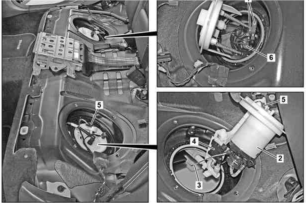

I, too, am leaning toward the fuel pump or fuel filter. They are located under the rear seat, so if there is a leak, you would smell it strongly in the "bottom middle of the car". I believe your car has a saddle tank that goes over the drive shaft. The pump is in one side and the filter is in the other side. If there is a leak in the fuel line (maybe due to corrosion) and air gets in, it will cause fueling problems. I recently watched a YouTube video where the fuel delivery was blocked by a clogged filter and caused all sorts of phantom issued. There are folks with an E-Class like yours that can probably offer more informed help.

I replaced both in-tank modules recently:
https://mbworld.org/forums/e-class-w...l-modules.html
I had a code for low pressure fuel system pressure implausible and one of the modules was leaking fuel. I would suspect that if you had a low pressure fuel line pressure problem, you would also have this code, but it's probably worth checking if one or both of these is leaking. I would replace them both at the same time if anything is off.
