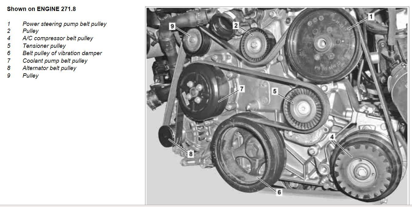

This problem has been driving me nuts for the last 3 months or so. Only started happening around November last year. Car drives absolutely fine otherwise, plenty of power, shifts fine, everything is working as expected.
The issue is a whine noise as the engine is revving, especially noticeable from 1500-3000rpm.
So far I have changed both idler pulleys, the tensioner, power steering pump and the noise is still there. I don't think its the alternator or waterpump but I'm getting close to taking it into a local indy to diagnose.
Video here:
Any idea what the noise might be?

You can poke around with a dowl rod or mechanic's stethoscope to better pinpoint the source of the noise.

I did try that which is why I thought its the powering steering. But will give it another go

NOT QUIET YET...
Still winning...
  • new/rebuilt steering pump
  • new serp idlers
  • new serp tensioner
what gives??
-- double check pulley alignement ... MB uses a "walking pulley" on the water pump.
-- Any foaming by steering pump (inlet seal leak)
-- Do replace CONTINENTAL belt !!
-- Check accessories for freeplay
-- flush steering system oil for all fresh.
Last get a better quality steering pump.

I think it is the water pump.
Water pump pulley is getting the smooth side of the serpentine belt, not the ribbed part ( V groove ) which has better friction.
Also make sure your serpentine belt is good one if not genuine.
I read somewhere, some belts are not good when loaded on the smooth side, must be loaded at the ribs or V groove.
Take a peek at the water pump pulley, see any sign of abrasion from extra friction ?
Shake2 water pump pulley too.

did you ever figure out the issue? I have the same thing

Yeah I made a video about fixing it actually, its the air con compressor pulley

thanks - I actually have the m272 engine but I thinks it’s the same replacement procedure
