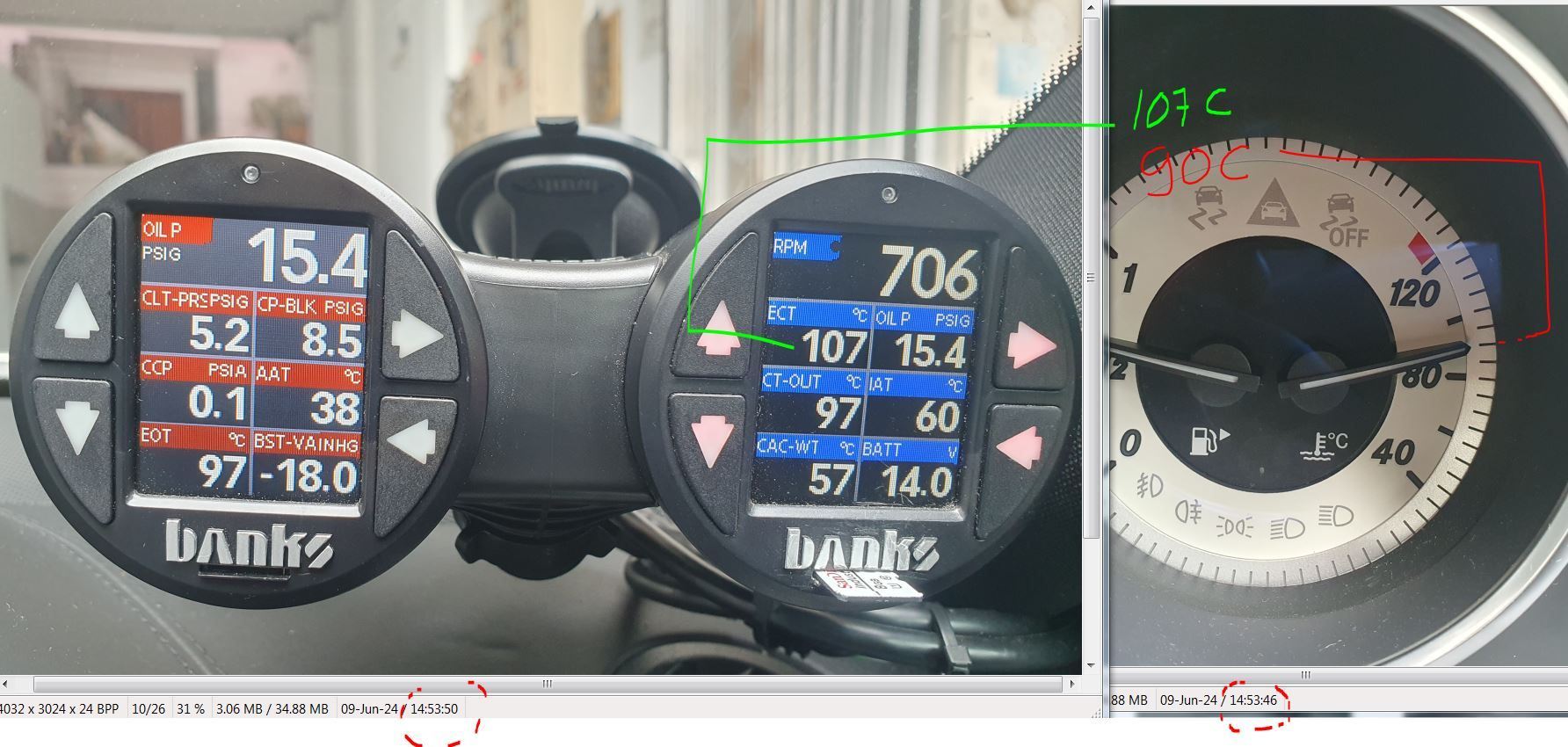

Get OBD2 based gauge, it will have the honest engine coolant temperature data which you may freak out
Old Feb 26, 2025 | 10:57 AM
W205C43PFL's Avatar
Posts: 32,525
Likes: 6,352
https://cimg7.ibsrv.net/gimg/www.mbw...2dd8830fdf.jpg
https://cimg8.ibsrv.net/gimg/www.mbw...547c1de6df.jpg
I still remember back in the days people complained about something is wrong with their vehicle when the coolant gauge kept fluctuating, it is actually not a bad idea for the average customer to see a doctored gauge
: ) but we are no average consumer : )

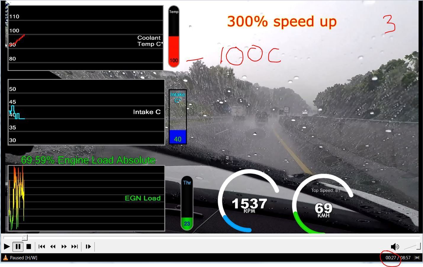

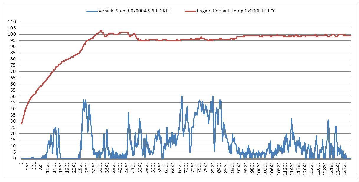

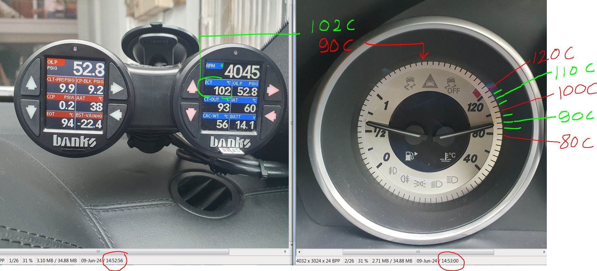

We can't learn anything about our coolant temperature when the white lie value is up to 25 Celcius at certain region of needle value.
90C needle means actual is 80 to 115C , at least 90C is indeed betwen 80 to 115C
95C needle means actual 115-120C , where does 95C belongs to ? 95C is 20C lower than 115C ...Holy Moly , the white lie shifting its angle ...LOL.
Only when a true 120C or higher is reached, the needle will show honest 120C too....duggh, the cylinder head would warp by next 2-3 minutes if we are unlucky where indeed
a true overheating is actually in progress.
Having a true honest coolant gauge ( via OBD ) is the only way you can undertand your engine true coolant temperature at various operating condition and climate.
Having a true honest coolant gauge ( via OBD ) give us ample warning when and if cooling system is declining in its performance, be it by neglect or by bad luck.

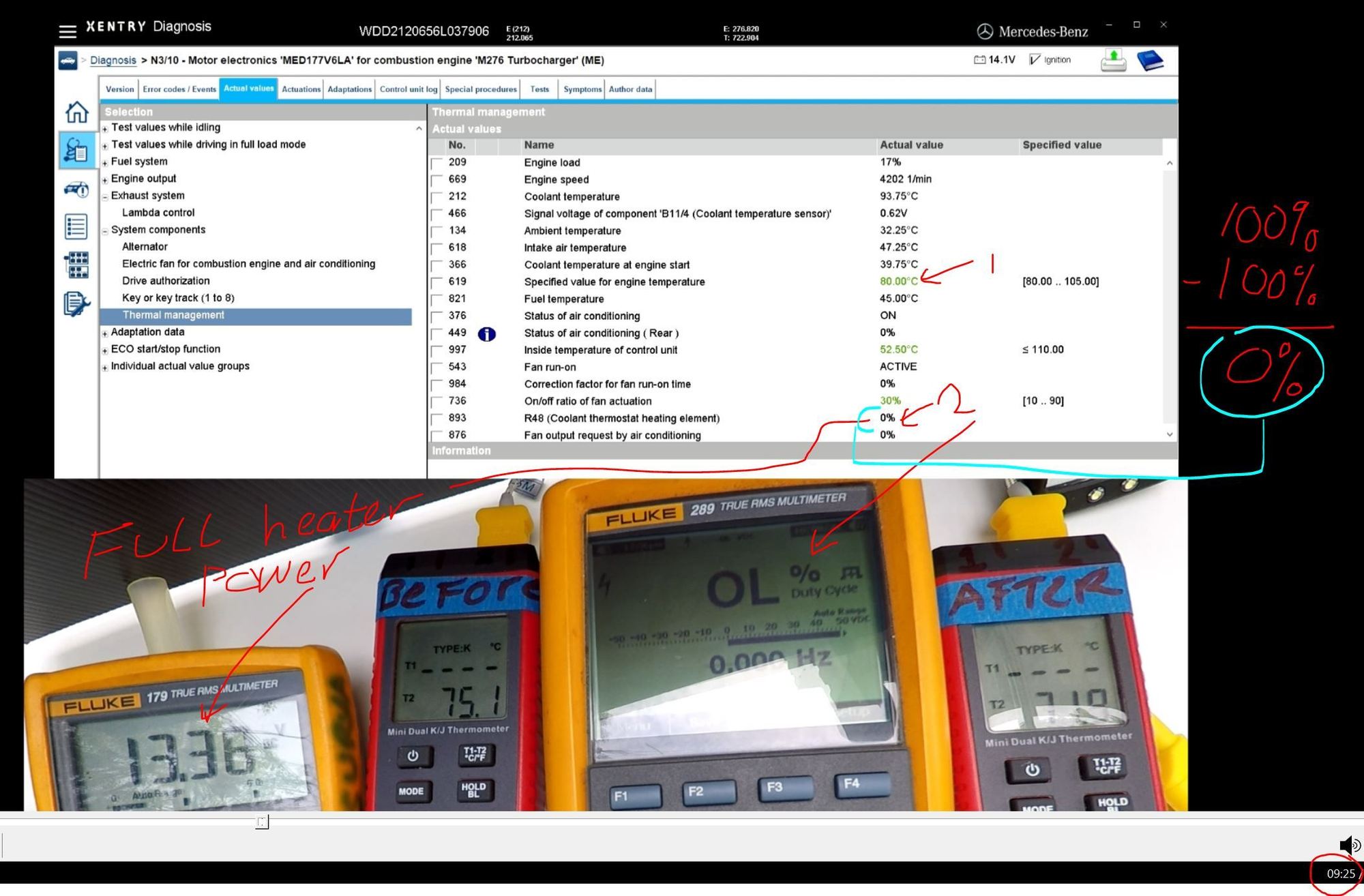

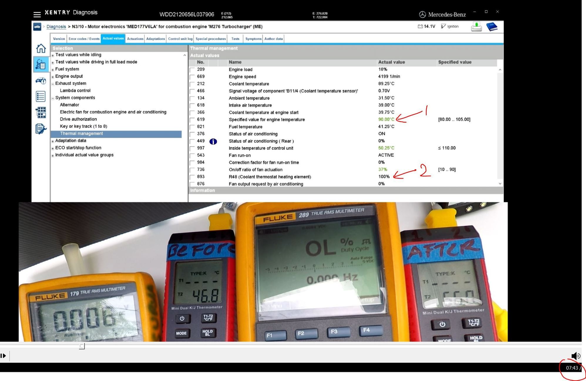

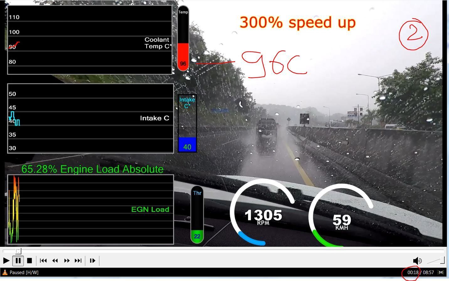

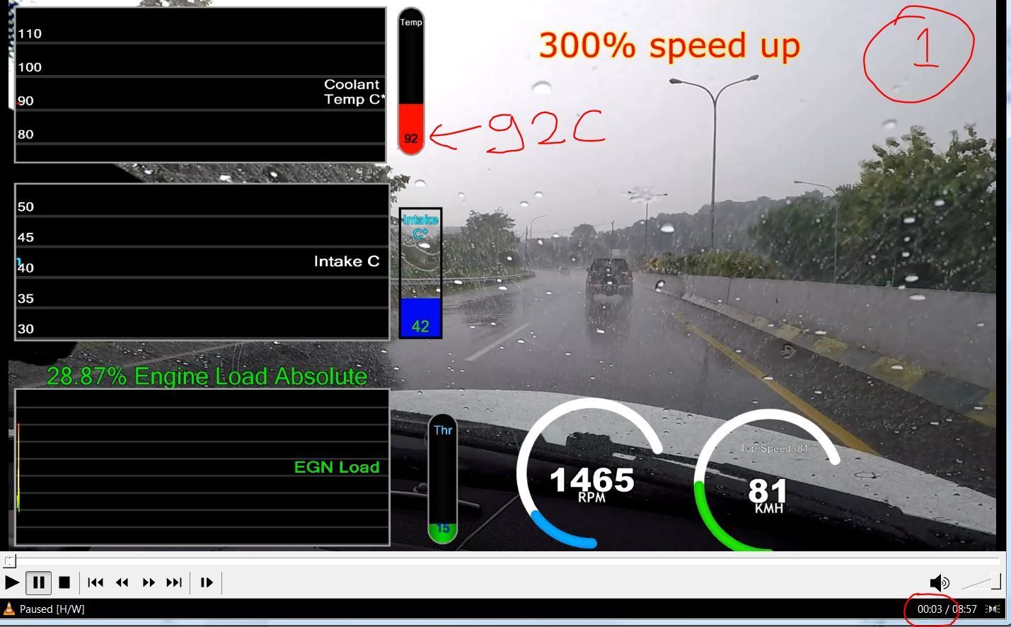

One more thing about Mercedes engines with heater in its thermostat, aka MAP thermostat.
It will want to hit 105C at some point in its engine operation when driven. Mine is MED177 ECM, M276.8xx my engine, I would think M278 would be the same strategy
M272 / M273 I do not know.
The ECM is an opportunistic bas-tard when it comes to hotter is better ( up to a point ) for fuel efficiency.

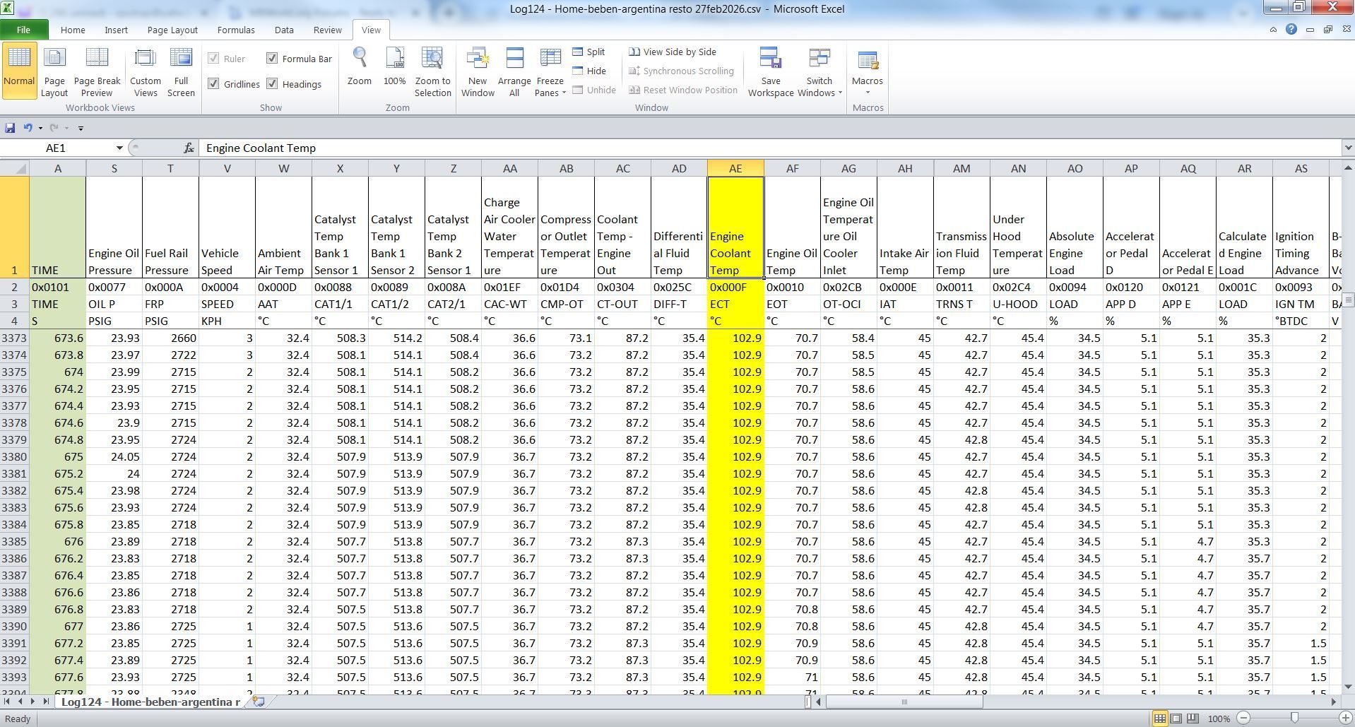

Get a Xentry and see the engine ECM live data, there it shows the temperature target the ECM wants the engine to achieve for some point in time.
Your will see 105C as one of the target. Just in case you are non-metric, 100C is pure water boiling temperature.

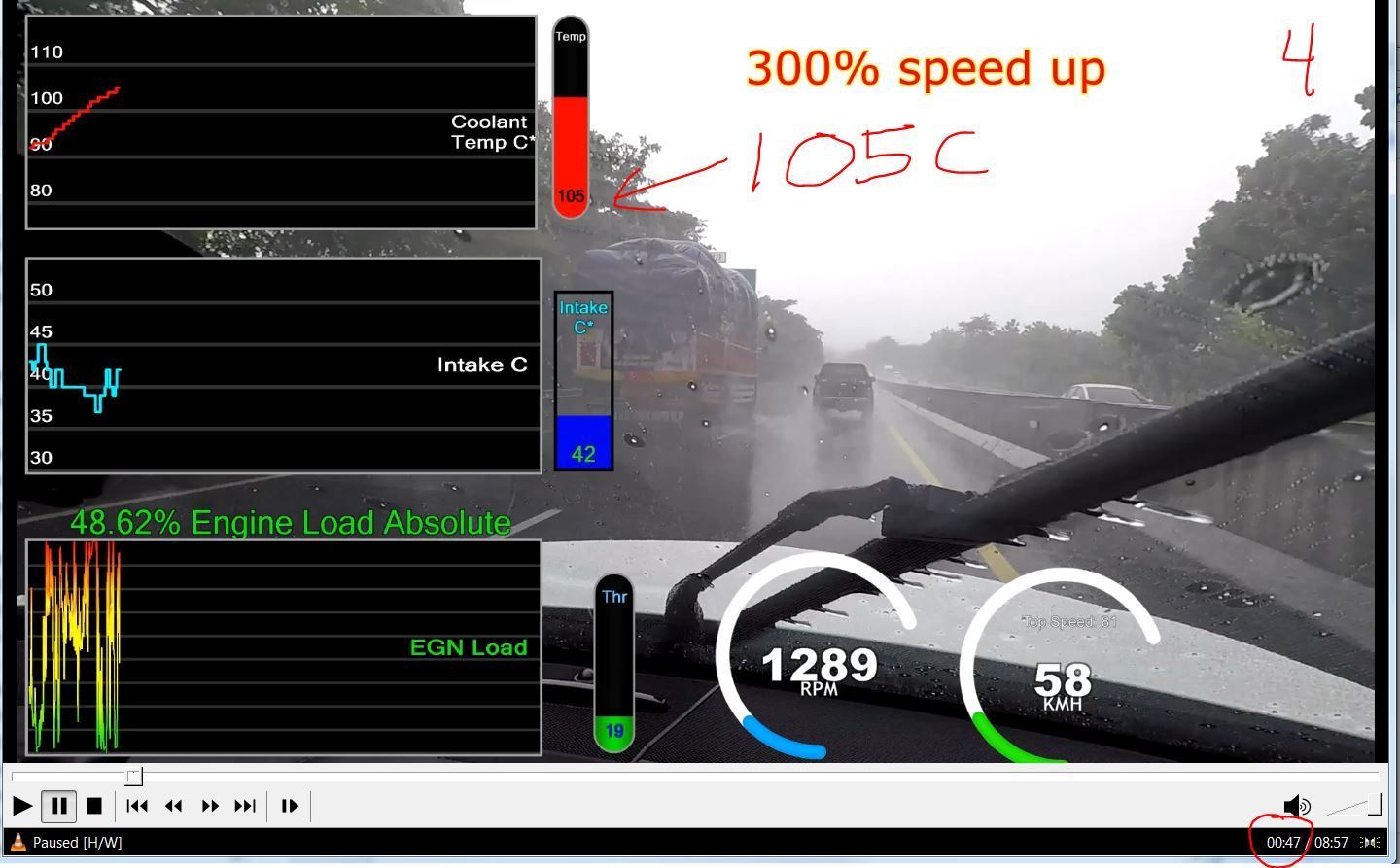

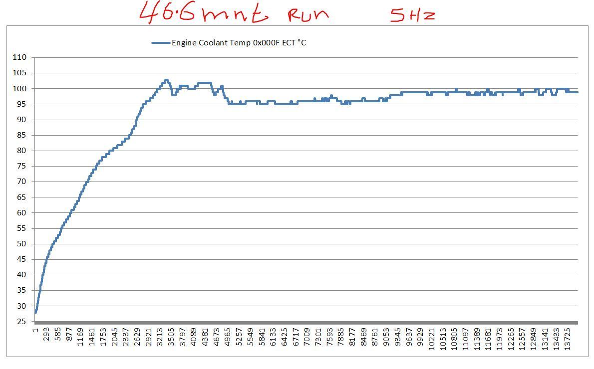

Today's log. See the 102.9 Celsius
102.9 Celsius
With speed data.

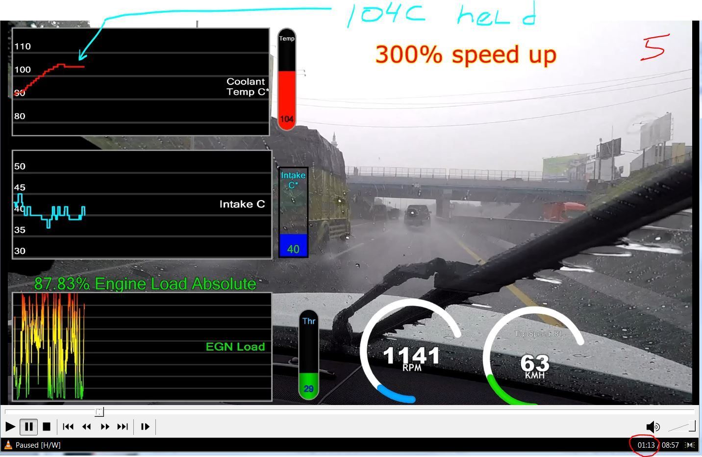

ECM info using Xentry
105C target
90C Target
80C target

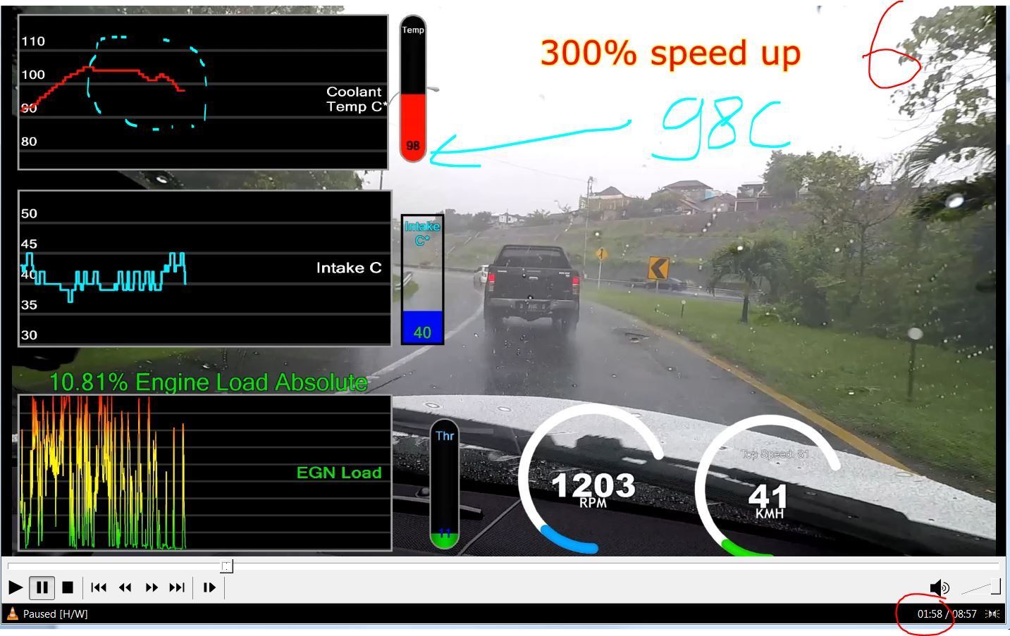

The cooler the ambient temperature is or during rain, the more opportunistic bas-tard the ECM will be to hit 105C.
Before this video time frame, it was not raining and coolant was 92C there about, when the rain comes , you can see the intake air ( aftercooler ) drop from 45C to 35C at image #4 below.
ECM then decided abundant cooling capacity is AVAILABLE when rain happen, and let's do 105C !!!
Since the video is 300% speed up, each video minute counter multiply it by 3x.
Even at 34C ambient temperature, for me to see a true coolant temp ( via OBD ) maintained at 115C to 120C is because I was at the track having fun.
No way in normal driving I could hit above 115C sustained.
But at the least I know what's happening towards what kind of load I do to my engine at the current ambient temp.... thanks to OBD
If I did not use OBD at this point in time, I would not slow down after lap 2 and perhaps my engine may suffer or be damaged when and if overheat warning is only to appear at 130C .
Ignore the TRANS temp, it is a wrong data PID.

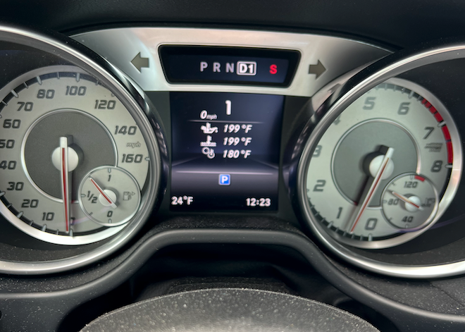

I have in my S550 with the 278 engine a AMG special cluster that allows me to see engine coolant and oil temperatures. When fully warmed up the engine coolant temp settles to 198 deg (92C). With constant speed driving the oil temp comes to the same.
My cluster temperature gauge shows very close to the same 90C or slightly above it.
My E550 with the 273 engine runs a little higher at around the 95C mark. I do not have any other temp display in that one.

Yes, the 95C needle is scarry : The 95° indicated corresponds to 115-120°
Our radiator/pressure cap is a 1.4 BAR rated, thus MB has the ba-lls to allow 130C as OVERHEAT warning temperature, based on poper 50/50 coolant mix.
I can't find the table anymore, but 50/50 coolant and at 1.4 BAR is about 136C boiling temperature if I remember right.

Mine, too. This is my normal reading. Occasionally, the oil temp hits 212°F (100°C), but rarely. Maybe the coolant temp might break 200°F, but I don't remember seeing that except for the time my coolant hose came off. I've never seen the tranny temp get above 180°F.
Steady driving gives me the following:
