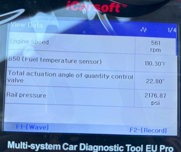

Old Mar 7, 2025 | 10:17 PM
e350_W212's Avatar
Joined: Jan 2024
Posts: 18
2013 E350 base
I got 2 values of fuel pressure from my scanner at Idle (560 RPM) with a warmed up engine
Fuel pressure (from tank fuel pump "Kraftatoffdruck"): varies between 71-88 psi at idle. Is that much variation normal???
Fuel Rail Pressure at idle: 2176psi
Fuel temp seems very high to me 110F? Ambient temp outside is 60-70F.
Old Mar 7, 2025 | 10:45 PM
CaliBenzDriver's Avatar
Joined: Apr 2019
Posts: 11,923
Likes: 6,776
From: Silicon Valley
W212 MY'14 M276-3.5NA @75kMi
Pressures are ok at idle.
Have someone confirm tank pressure nearly unchanged underload while you're driving.
Fuel delivery will be tested as A-Ok.
