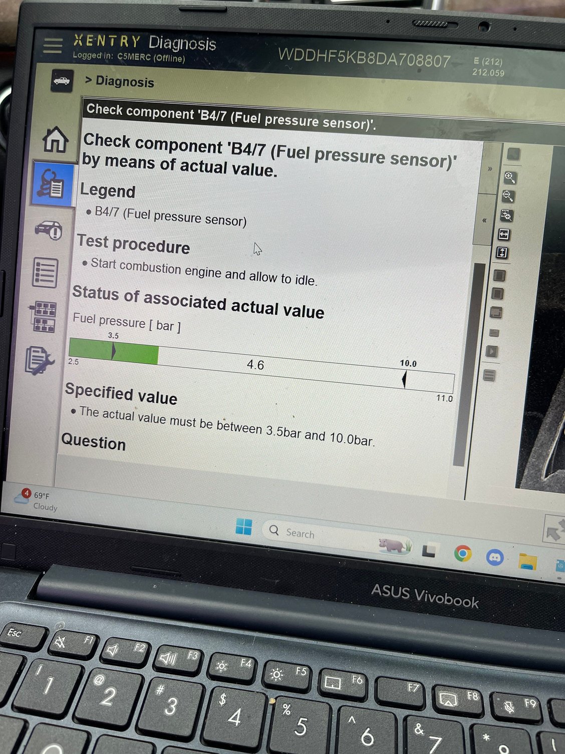

hello again guys a little history I had made a previous post because the care wouldn’t start after changing fuel filter and pump turns out one of the hoses was getting disconnected upon vehicle crank so I had to put a clamp on it and haven’t had any issues since after the changes I noticed my fuel tank would click before it showed fuel on the gas gauge it would only fill up about 90% so I figured it would go away after a few days which it didn’t then I noticed how terrible my gas mileage has been so I decided to buy xentry so I can get to the bottom of this above are pictures of the code and value levels if anyone has any idea what it could be would be greatly appreciated stay blessed

Do you understand what the Xentry screen says ??
You either have low pressure or bad sensor.
not at all tbh brother I just got it
it says your below normal pressure snd flags that with a fault.
below range
below range

xentry says "check component b4/7 (fuel pressure sensor) by means of actual value". To do this, you would hook a meter up to the B4/7 output, and ideally also hook up a fuel pressure meter so you can confirm the actual pressure vs what the sensor reading says it is.
Do NOT just randomly start changing parts.

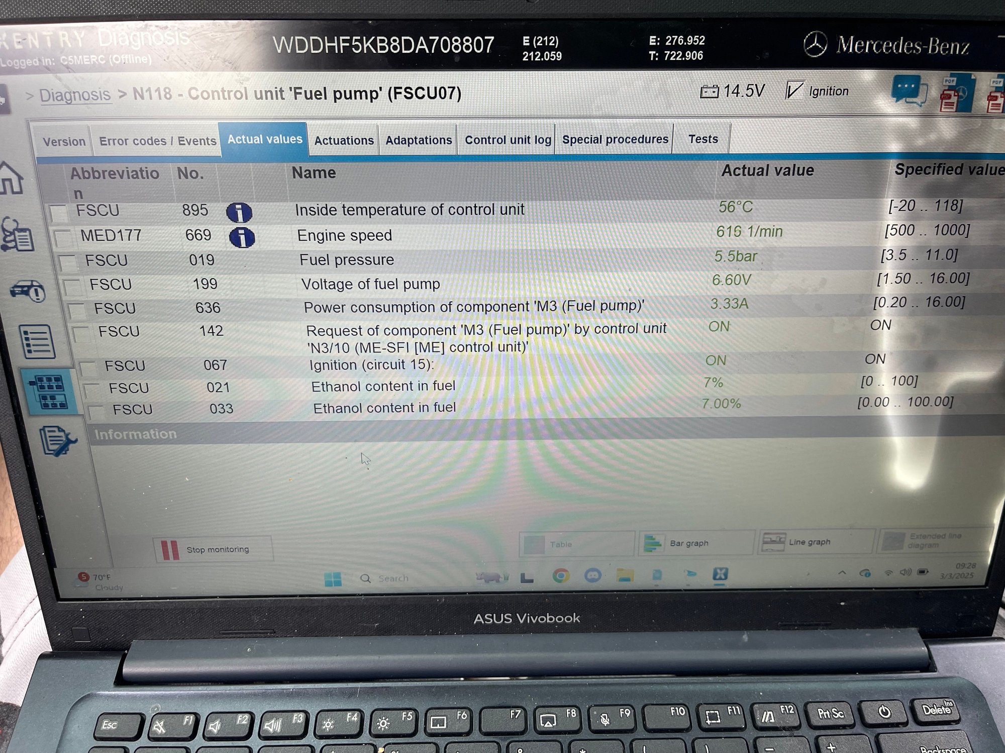

In the bottom picture of the first post it shows fuel pressure at 5.5 bar. Range is 3.5 - 11 bar.
Why are forum members saying pressure is low? Just because Xentry says so?
The actual value by the picture says otherwise.
You're right... 70psi is perfectly right

Wonder if the low pressure is on the high pressure side. The one shown is the low pressure from the pump in the tank.
Low pressure at the sprayers would explain bad fuel mileage...
This could be a glitch in Xentry...?
Would be nice to see what the high-pressure side reads.

injection pressure on a DI engine is sky high, like 1000s of PSI, regular fuel pressure meters can't touch that, its diesel territory.

There is a pressure sensor for high side pressure too. I have read it many times using my handy iCarsoft MB II reader. And yes, it is high pressure at up to 190 bar if I remember correctly. This is the pressure that matters for atomizing the fuel for correct burning. Pressure from pump in tank is only to feed the high-pressure pump(s).
