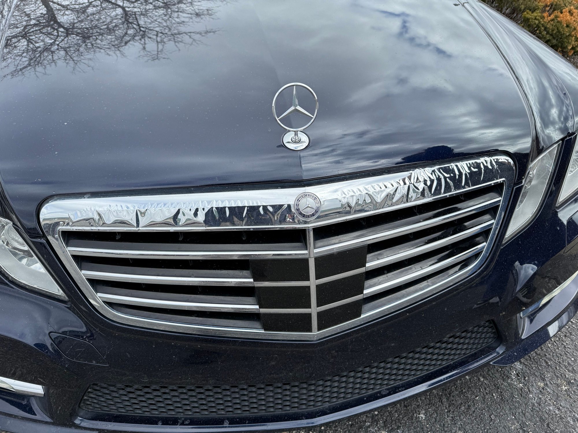

Grill Replacement for Distronic Plus/Radar?
I have seen a million W212 replacement grills for sale but none for one with distronic plus/adaptive cruise. Can anyone help me locate compatible grills or let me know if the radar cover just attaches to a standard? See the bubbling coming from this 50k mi. 2013 E550 4Matic. Thanks!
W212 E550 Damaged Grill w Distronic Plus

I have this exact same setup: comfort-trim DistroPlus.
The radar module is attached to a bracket behind the plastic grill that has a dark plastic lens to hide the boxy module.
Our square lens is equivalent to the large round plastic star on sport-trims.
Your new grill must be "DistroPlus" compatible.

Wow, that's not "bubbling", I would call that "total surface preparation failure". If that actually came from MB, I would complain loudly about it, warranty or no.
I have seen only a small number of aftermarket grilles specifically say that they are "compatible with distronic". EVEN IF they do, I wonder if they would need recalibration due to thickness differences, ABS plastic differences, and so on.
I put in an aftermarket "Panamerica GT" grille on mine some time ago, one of the reasons I did it was to preserve the OEM grille from rocks, peeling, etc. So, after about 2.5 years, the clearcoat on the black and chrome started to peel in a few spots (I have a 2013 50Kmi. 350) You can't buy anything actually good anymore, no matter what you spend. My aftermarket grille was relatively inexpensive (80, the star was maybe another 30) but I put a lot of blood sweat and tears into it, putting a mesh grill behind the main grille. I bought a new one and put on another mesh, awaiting install this spring.

Yeah, it's pretty terrible. It appears the part number is 212-880-19-83, and while you can get it for non-distronic for like $70, it's 10x for that version with not really good options on eBay either. Hmm…

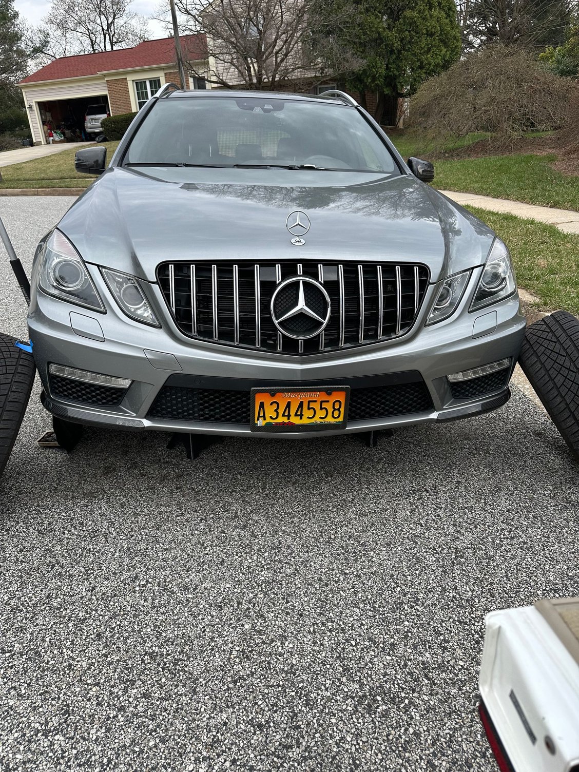

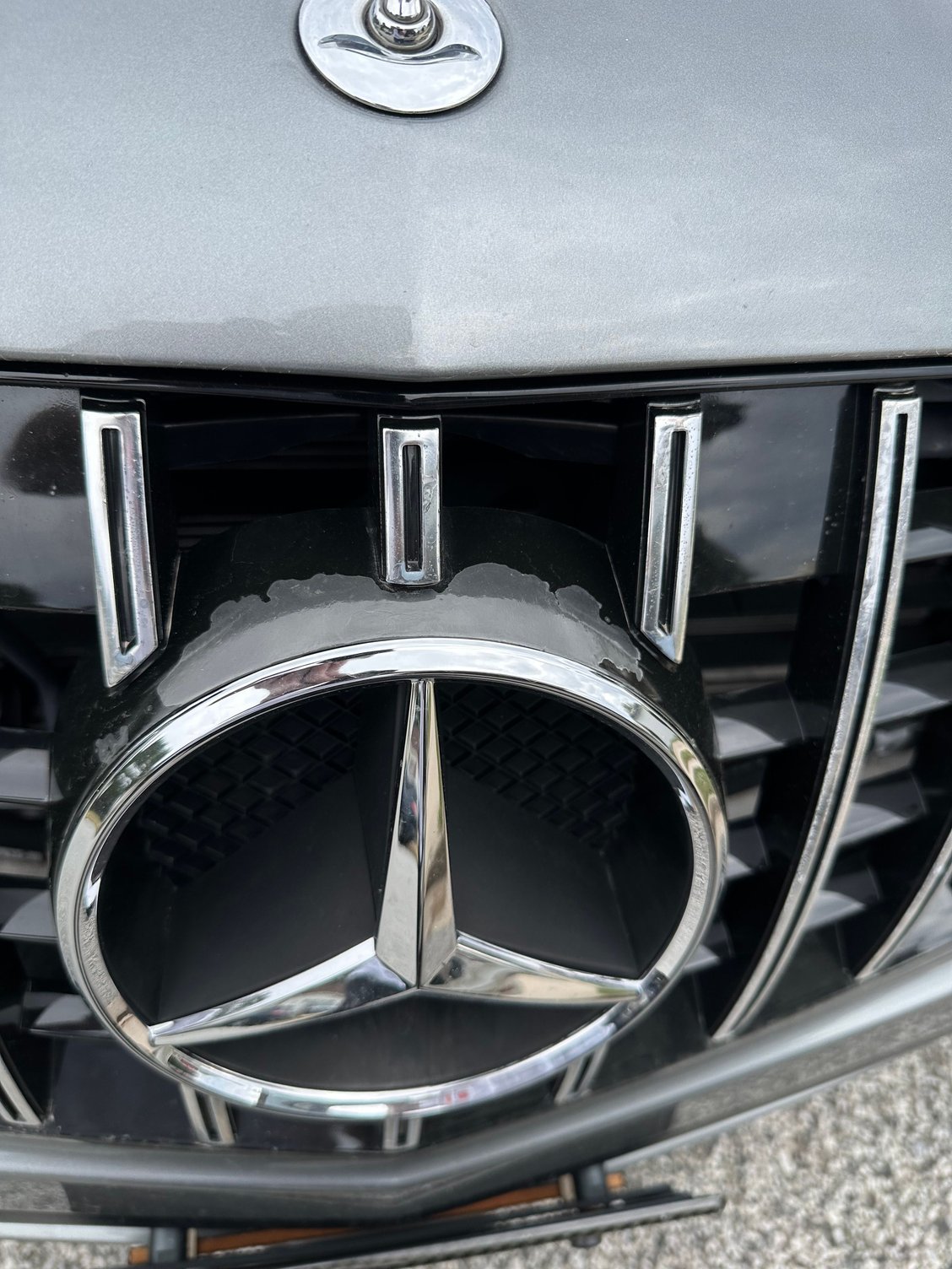

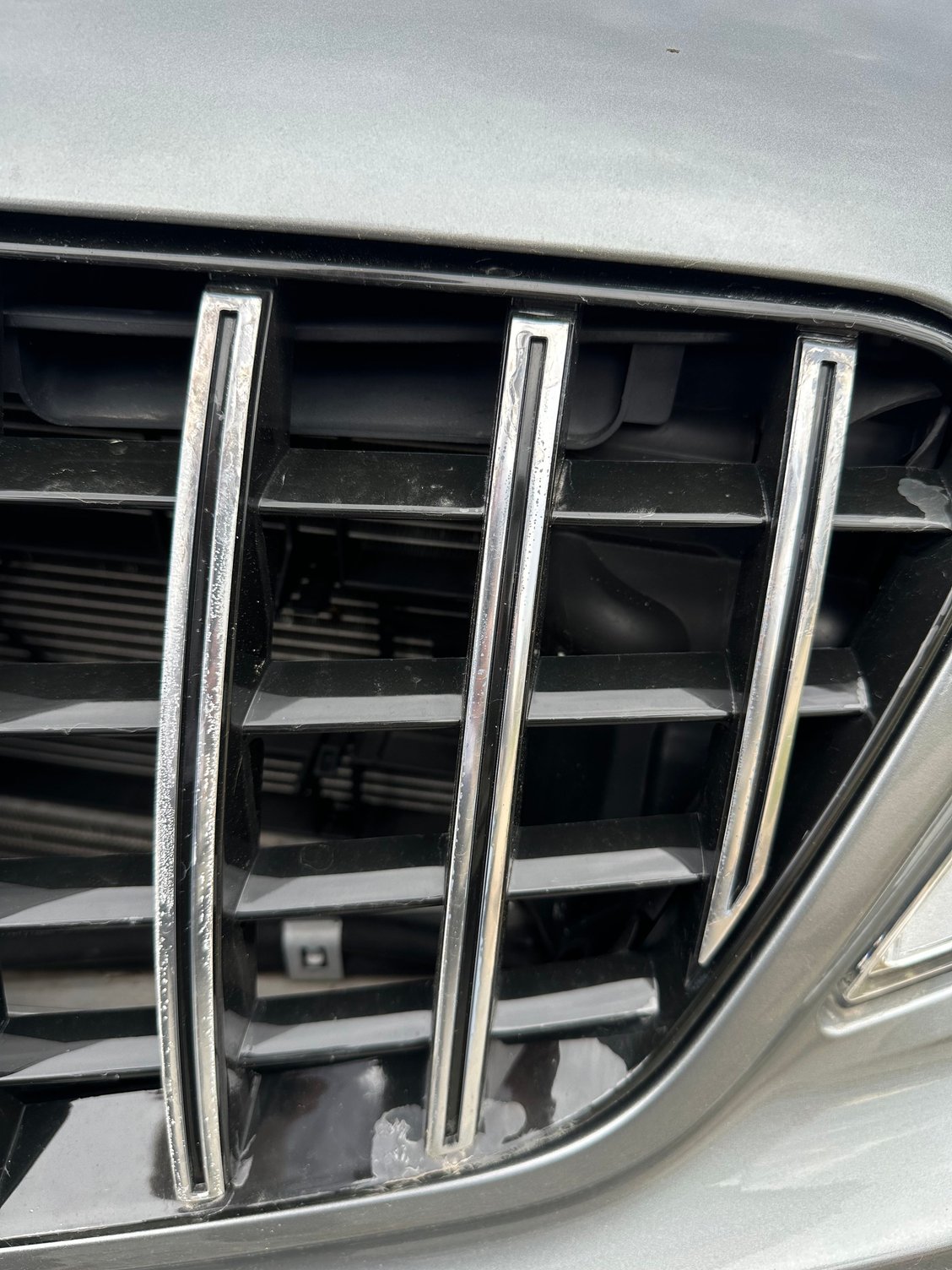

I have a 2013 E 63 wagon and I put a panamericana grill on mine. It doesn’t have the smooth star, but it worked fine for DisTronic. It just gets more debris caught in the recess and you might have to clean it more. I’ve had 55 tech and ckm in the panamericana style. 55 was junk. Ckm, slightly less but is delaminating after 2 years. Ive gone through three aftermarket grills. They look good but definitely not the same quality. Ckm fits better as well.
Let me know if you have any questions or need a picture.
this after two and a half years.
Super dirty, other projects underway.
The first one I had did not delaminate like this. Not sure if this is to be considered pandemic quality, or just the world we live in..

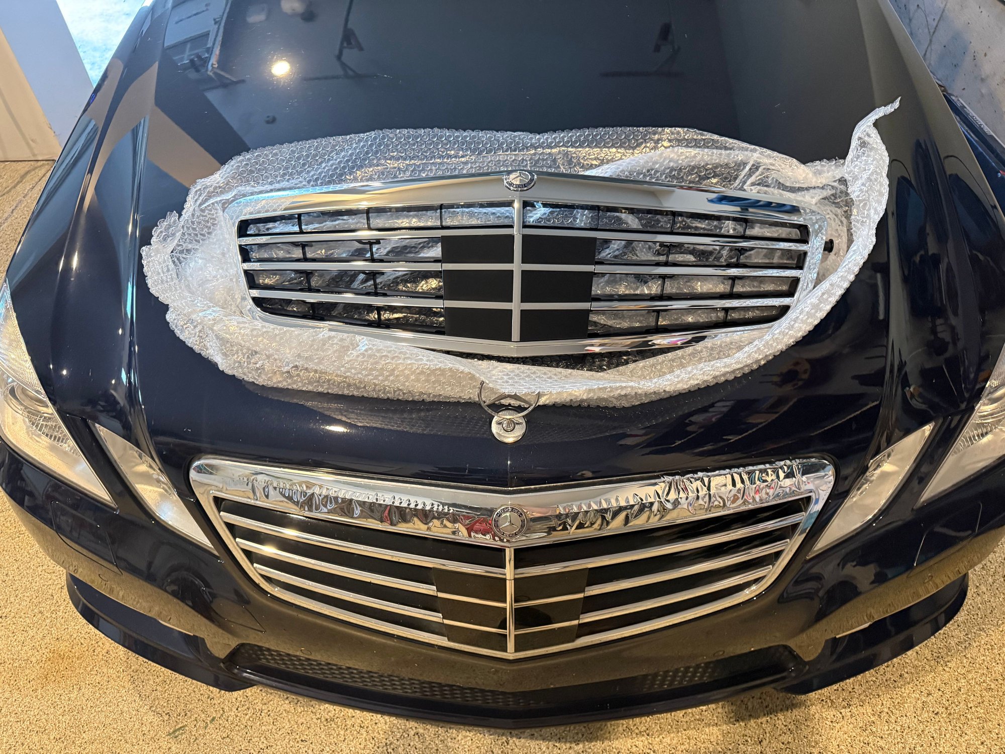

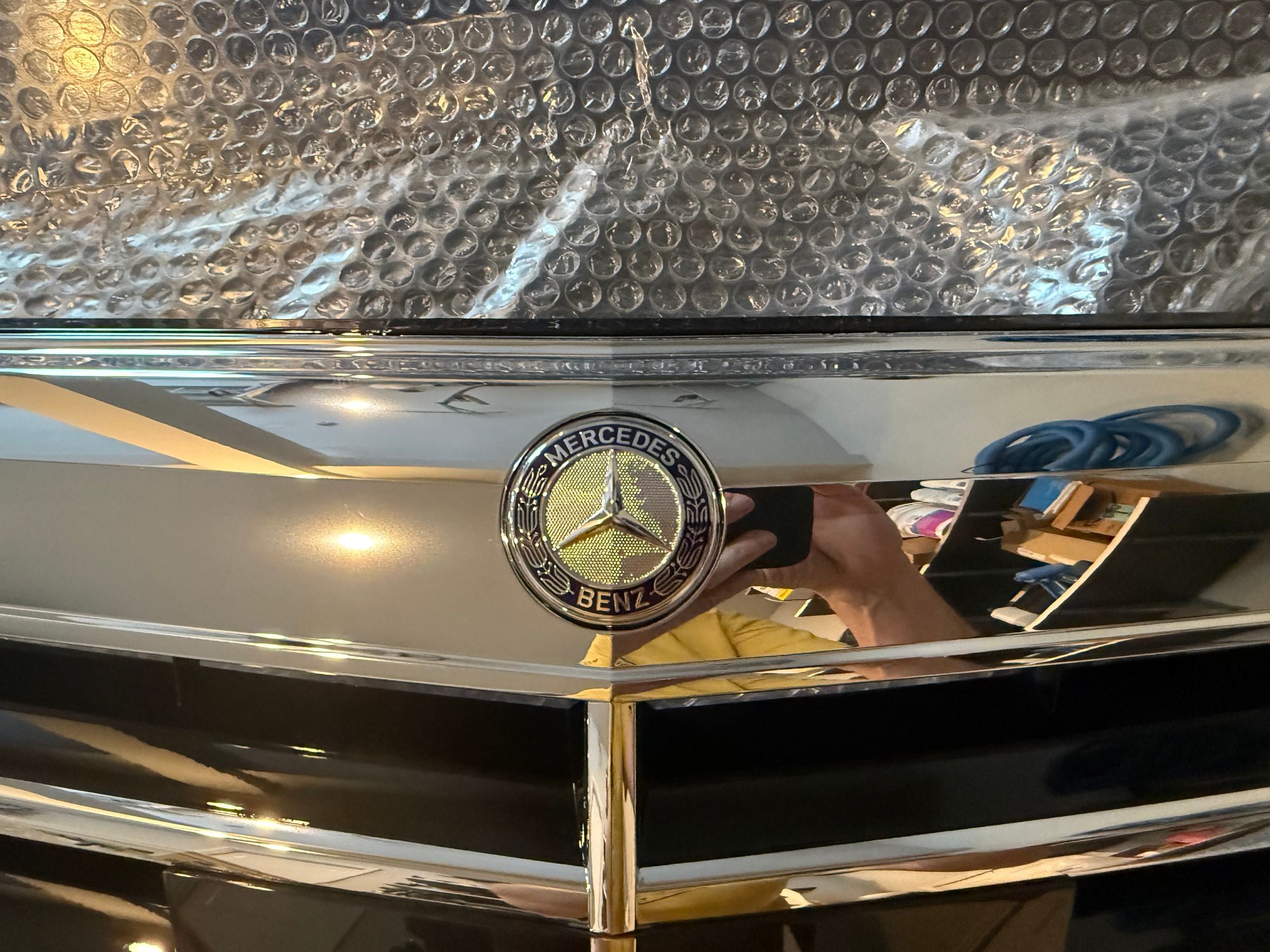

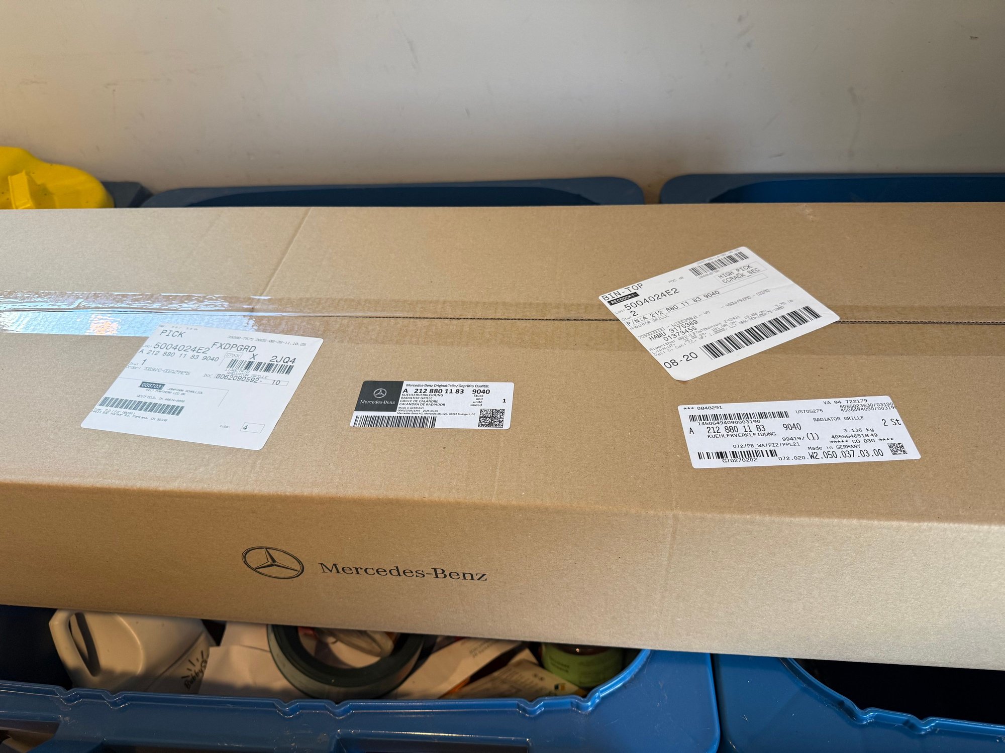

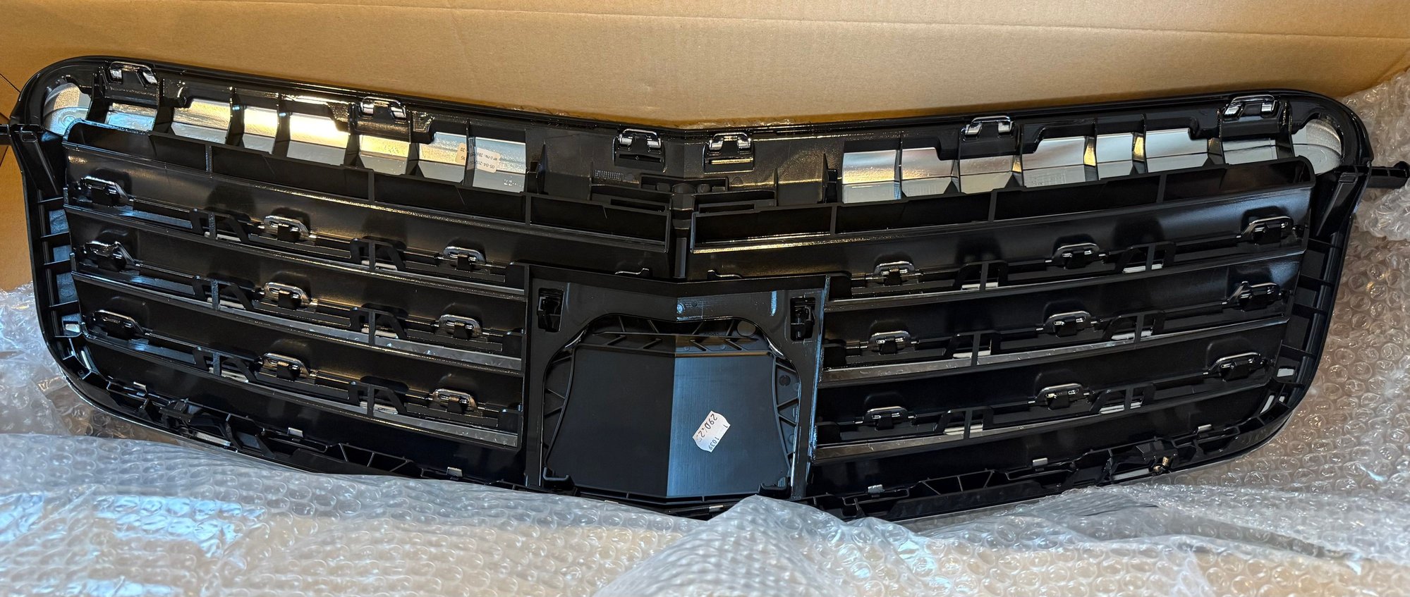

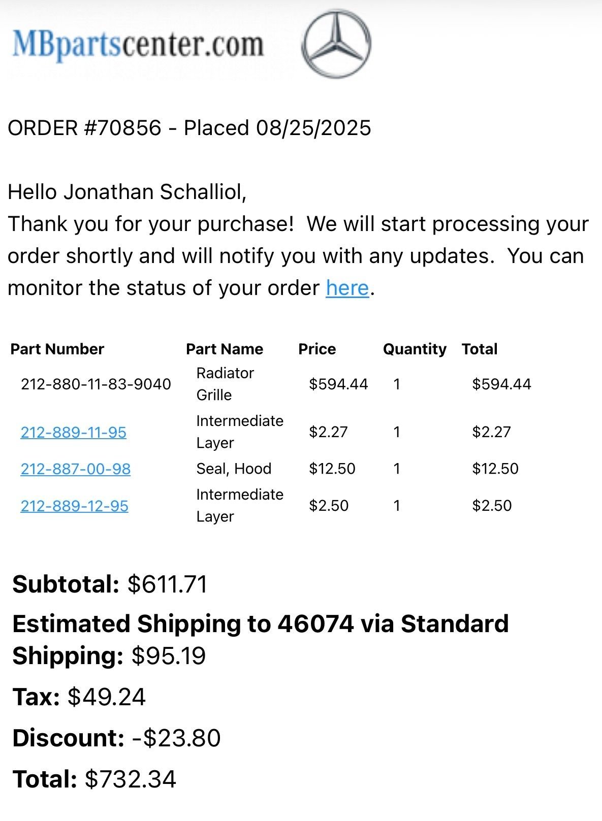

New Grille Incoming!
This car has about 60k miles and has been extremely well cared for. Unfortunately I couldn’t find something very cost effective, but after talking to MBpartscenter.com, I was able to get something I felt was acceptable. My local MB and third party tech said you’d have to buy the new part for $1,070 plus shipping/tax. Originally the part came in at a higher shipping cost than the part itself(!) but we got it down as pictured as the end. I went ahead and ordered some seals/interfaces that weren’t much but seemed like they’d be a good add.
THe part numbers I went with and photos are below. The new one certainly looks perfect as you’d expect.
We’ll install next week.
MB E 550 W212 new and bubbling “luxury” grille
MB E 550 W212 new rear “luxury” grille
MB E 550 W212 new “luxury” grille

Thanks for sharing, what a difference
Old Sep 3, 2025 | 03:30 AM
schalliol's Avatar
Joined: Sep 2021
Posts: 17
MB E550 '13, Rivian R1S Quad '23, Volvo XC60 T8 Ultimate '23, Honda Odyssey TE '16
Glad you enjoyed! I thought so too. Part of me is amazed to see a brand new cosmetic OEM part for a >10 year old vehicle, and I was glad to share that. I’ll report back when installed.
