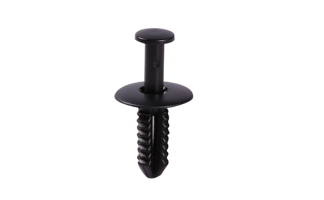

This reply is to late but will help the next person...I just replaced mine on my 2014 E350 wagon with the heated windshield was fluid tank which leaked at the seam.
listed are the part # including are the grommets # since you are there just replace them and for good measure in case you destroy the rivets when removing the plastic
fender cowl I listed the part for it...you may have to wrestle that heater out of the tank a bit...but be gentle.
GROMMET for PUMP #A0009989001
GROMMET for SWITCH # A 203 869 00 98
WASHER RESERVOIR (FOR HEATED WASHER FLUID OPTION CODE 875) # 204-869-02-00
EXPANSION RIVET RIVET # A 124 990 04 92

I bought a bunch of the plastic MB fasteners cheap on AliExpress though have yet to use them. I have good luck using a mini flat head screwdriver to pry out the pin first then the body of the fastener pulls right out.
