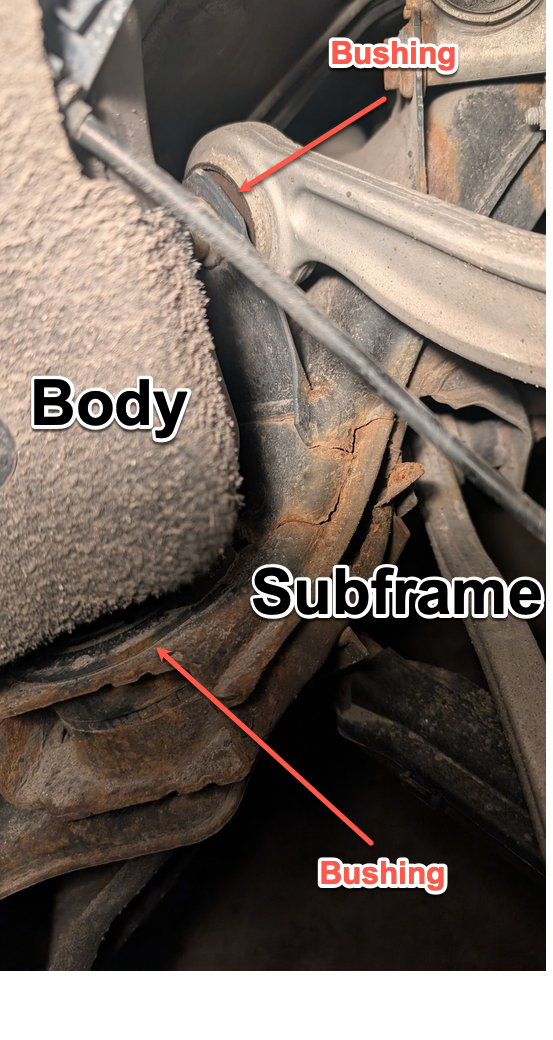

Been getting a knocking sound from rear driver side. I thought it was a loose golf ball rolling around but after cleaning out the trunk I was still hearing the knocking sound. Finally got a chance to take the wheel off and take a look at suspension and I found this crack. I'm sure this is causing the knocking sound or has something to do with it. Is this even fixable? Time for a new car?
2010 e350. 161k

That looks like the crack is in the car body. The warranty is for the sub-frame, which seems quite rusted too, but they probably do not warrant the body.
Fixable, I think so with a good body shop.

Pretty sure the crack is in the subframe. The body has the undercoating and the control arm and subframe attach to the body.
I think you are right so this is under the long (20 years?) warranty.

I got my car back from dealership earlier. Car spent about 2.5 days at the dealership. Process was pretty smooth. The service agent was nice about the whole thing. They had to replace 2 rear springs bc they cracked. They didn't charge me for the labor since the subframe was already being taken off. Cost for the 2 springs was about $380.
When I went to pick up my car the SA was saying he had two more guys come in over the last couple days with subframe replacement requests. Hahaha
