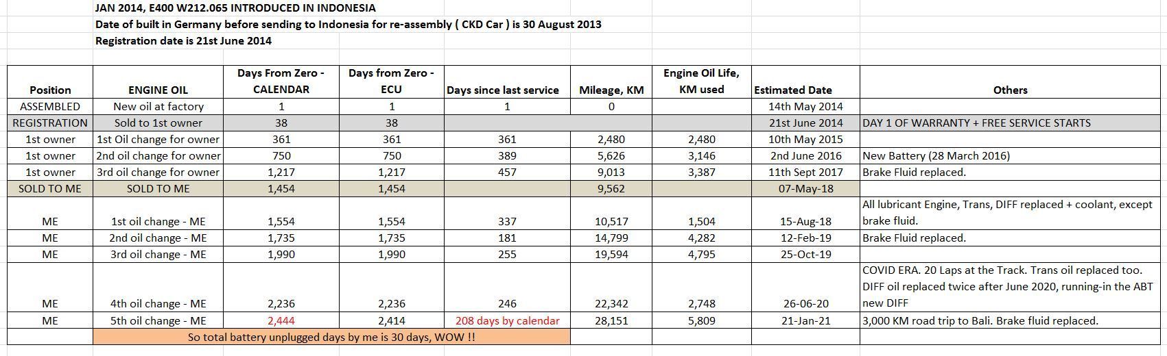

The ECU can count days.
Here is what I found out in 2021 when I checked service days per ECU, vs actual car ownership.
After 2021, there are many more days when I disconnected the battery in 2022 and 2023.
I will update it next time.
