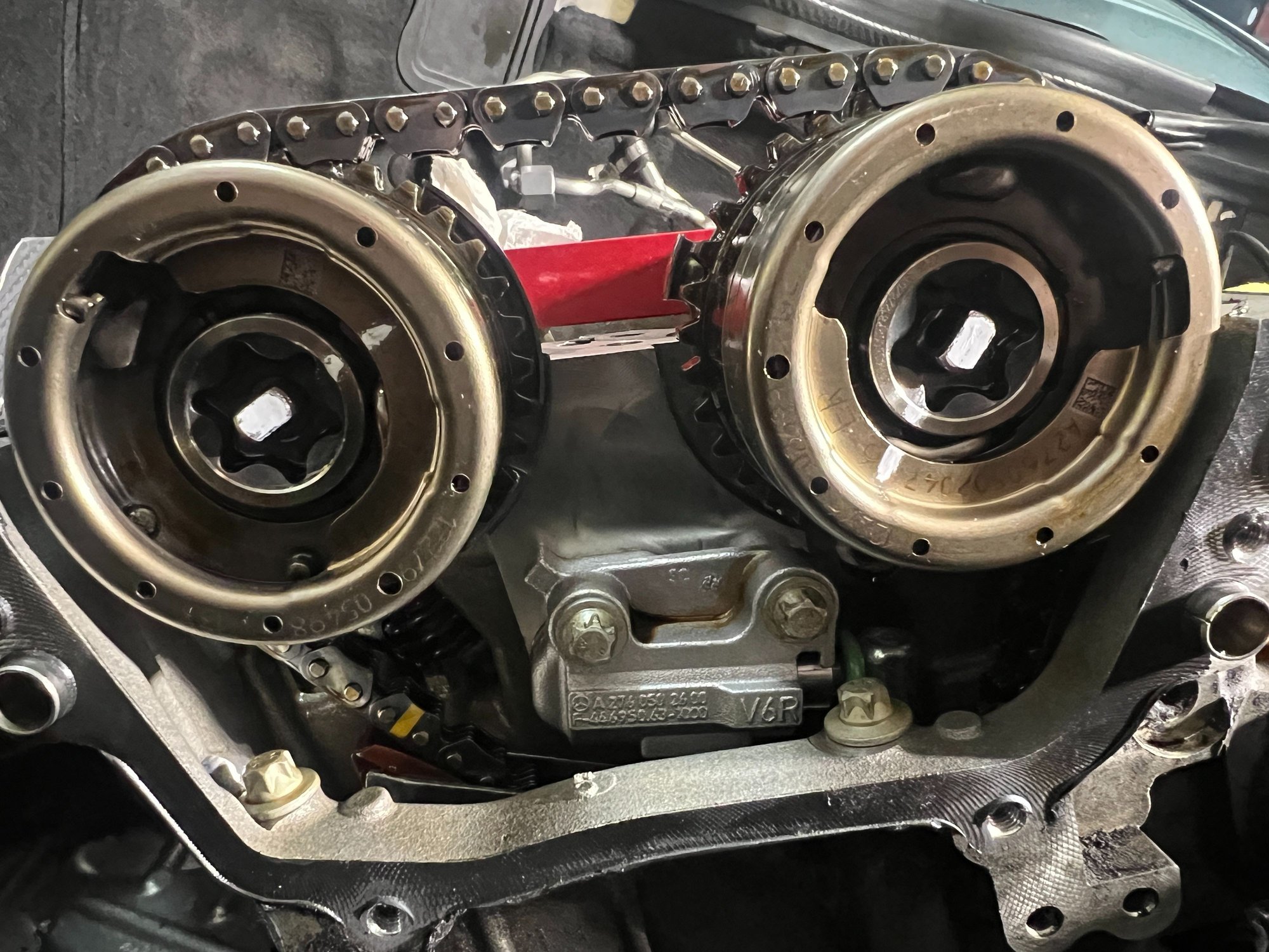

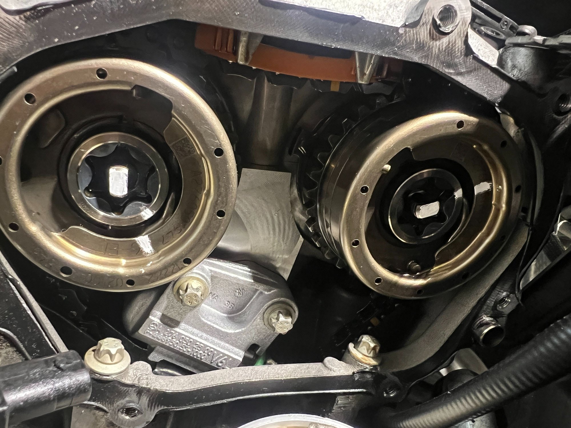

QUOTE=mdzukunft;9131012]Replacing the Bank 2, Intake VTT per the official manner and to check tone rings/shaft. And fix the upper guide rails.
Bank 1
Bank 1
Bank 2
Bank 2
An important point: When you hear the click, you should test by visual inspection each of the camshaft adjusters. I could have sworn it was one of the Bank 1 VTTs but it ended up being the Bank 2, Intake VTT which is the usual culprit on the M276. And that would explain the P0346 code, which also correlates to Bank 2.[/QUOTE]
Spoiler
