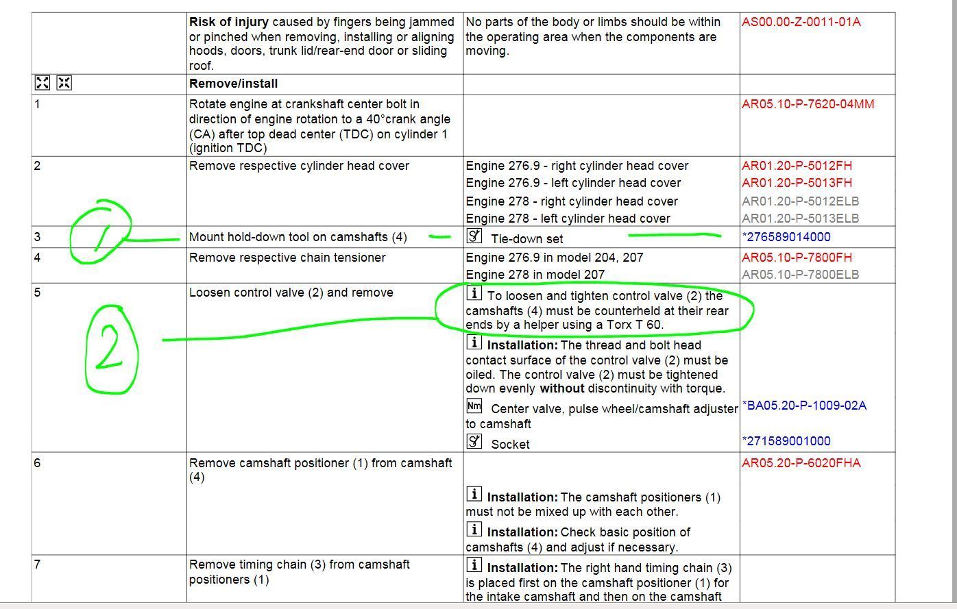

The center piece inside the VVT is the oil valve. That is 130Nm tightening torque, approx 100 lbs.
The rear azz of the camshaft has T60 torx built-in female thread ( internal ) for us to use a T60 torx male as a way to hold the camshaft when one torque or remove the VVT oil valve.
Yes, cylinder head cover has to be removed, injectors too and all the supporting obstacle/s.
Many who does not have access to WIS or lazy or BOTH ....thinks the timing chain is good enough as camshaft "holder".
130Nm is our (mine) wheel bolt torque.
If chain is still good, probably you wont break it doing 130NM, but maybe you will strech it.

I’ve done this job. It’s not easy, but very doable as DIY IF methodical and follow instructions as S-Pri advised above. I didn’t have any timing issue following VVT replacement, though I was certainly nervous of that happening

Vice grip on un-used portion of the cam is also acceptable. But cylinder head cover ( which is also camshaft journal ) + injectors has to be removed too....which is the most troublesome job.
Each injector seal kit is US$35 and the injector seal kit tool combined ( 2 types ) is US$400 ish. I am speaking proper tool as per WIS.
In fact M271 engine cam hold down is a true cam LOCK DOWN tool on special portion of the camshaft for the very purpose, no azz T60 female on this camshaft.
But M271 cylinder head cover is plastic and injector at the side, very easy job and no need DIY sealan, it is all gasket and o-ring.....unlike M276 a real DIY gasket making using the reccomended loctite sealant.
