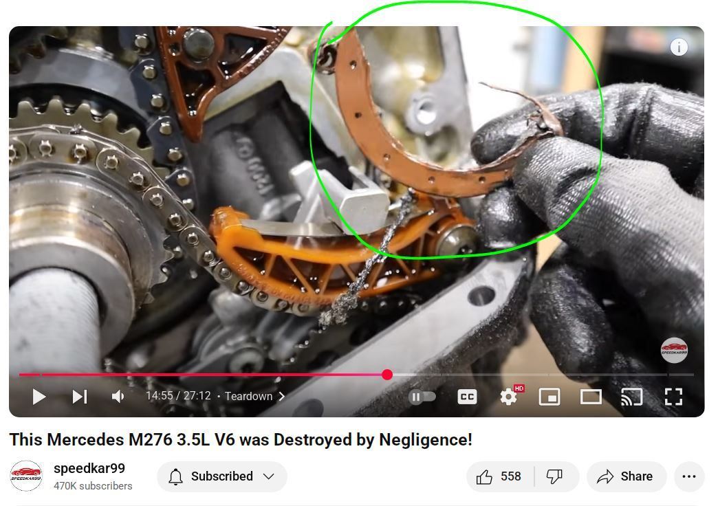

This 276 engine swallowed its serpentine belt.
Shredded pieces plugged up the oil pick up.
Oil starved bearings got overheated and spun...
game over.

I still wonder why video guy said it is serpentine belt debris
There is no way serpentive belt can enter our oiling system.
There is no data what mileage and what type of MB this engine comes out of, except it is a 4matic.

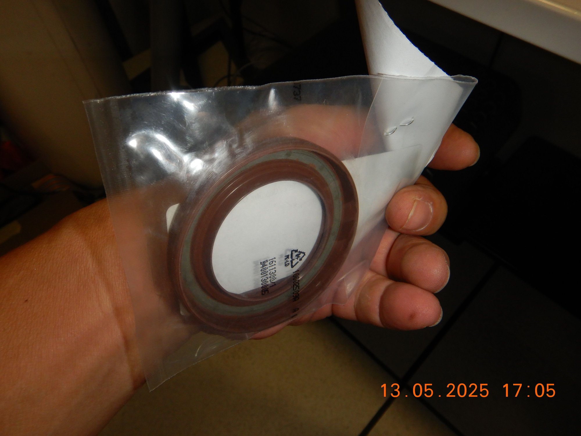

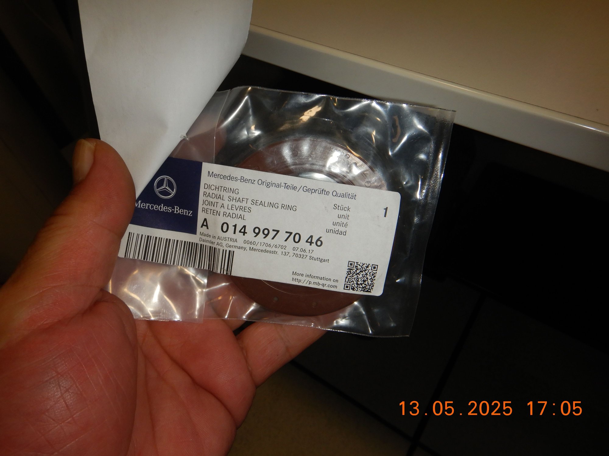

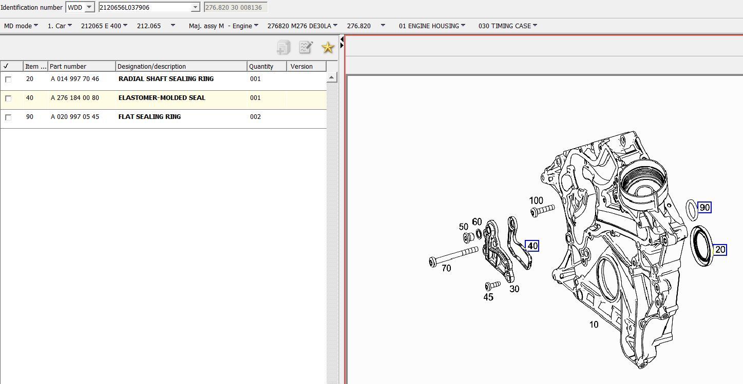

This is the front crankshaft seal, brown color
Item 20 is crankshaft seal. Item 90 (2pcs) is the dumb-azz o-ring for coolant.
I have this seal for future use where I will need to replace 2 dumb-azz coolant o-ring #90 at this main timing cover to engine.
So the sepertine belt somehow accumulated at the crankshat behind the main pulley and it get fatter and fatter and push into the crank oil seal,
landed at timing chain region

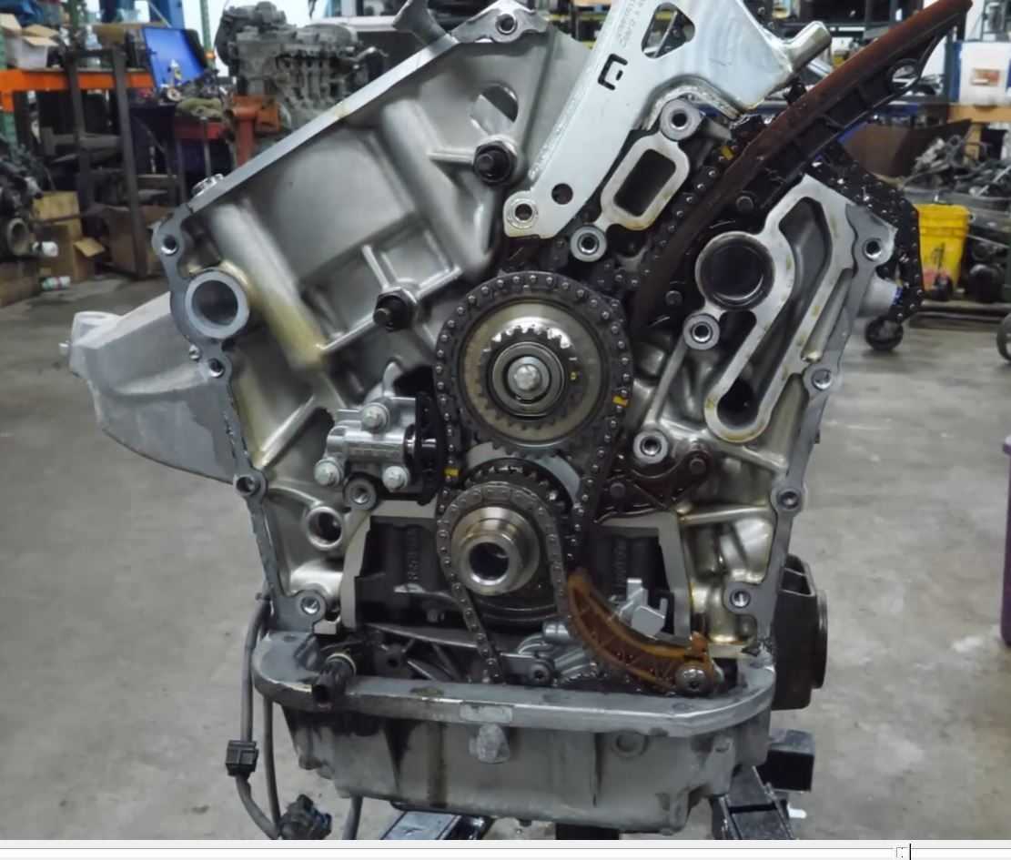

This timing chain region has opening to oil pump/oil sump
This is M276.8 upside down, oil pump is up. M276.9 is identical for this region.

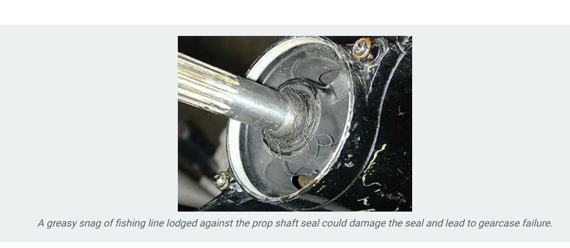

This reminds me of outboard motors, its tranny or lower case we call it, IF fishing line stuck on .....it can cause the oil seal to leak and water enter the oil holding region of the
lower case and bye bye lower case ( tranny ). This is small but tough nylon fishing line....imagine a serpentine belt

Quote:
That made so much sense, thank you.
https://cimg6.ibsrv.net/gimg/www.mbw...cf02d7e692.jpg
https://cimg8.ibsrv.net/gimg/www.mbw...efd127c991.jpg
https://cimg9.ibsrv.net/gimg/www.mbw...d2b0038e37.jpg
https://cimg0.ibsrv.net/gimg/www.mbw...1473b41634.jpg
https://cimg2.ibsrv.net/gimg/www.mbw...c4b4c7869b.jpg
https://cimg3.ibsrv.net/gimg/www.mbw...af67319541.jpg
https://cimg4.ibsrv.net/gimg/www.mbw...2109eec21e.jpg
