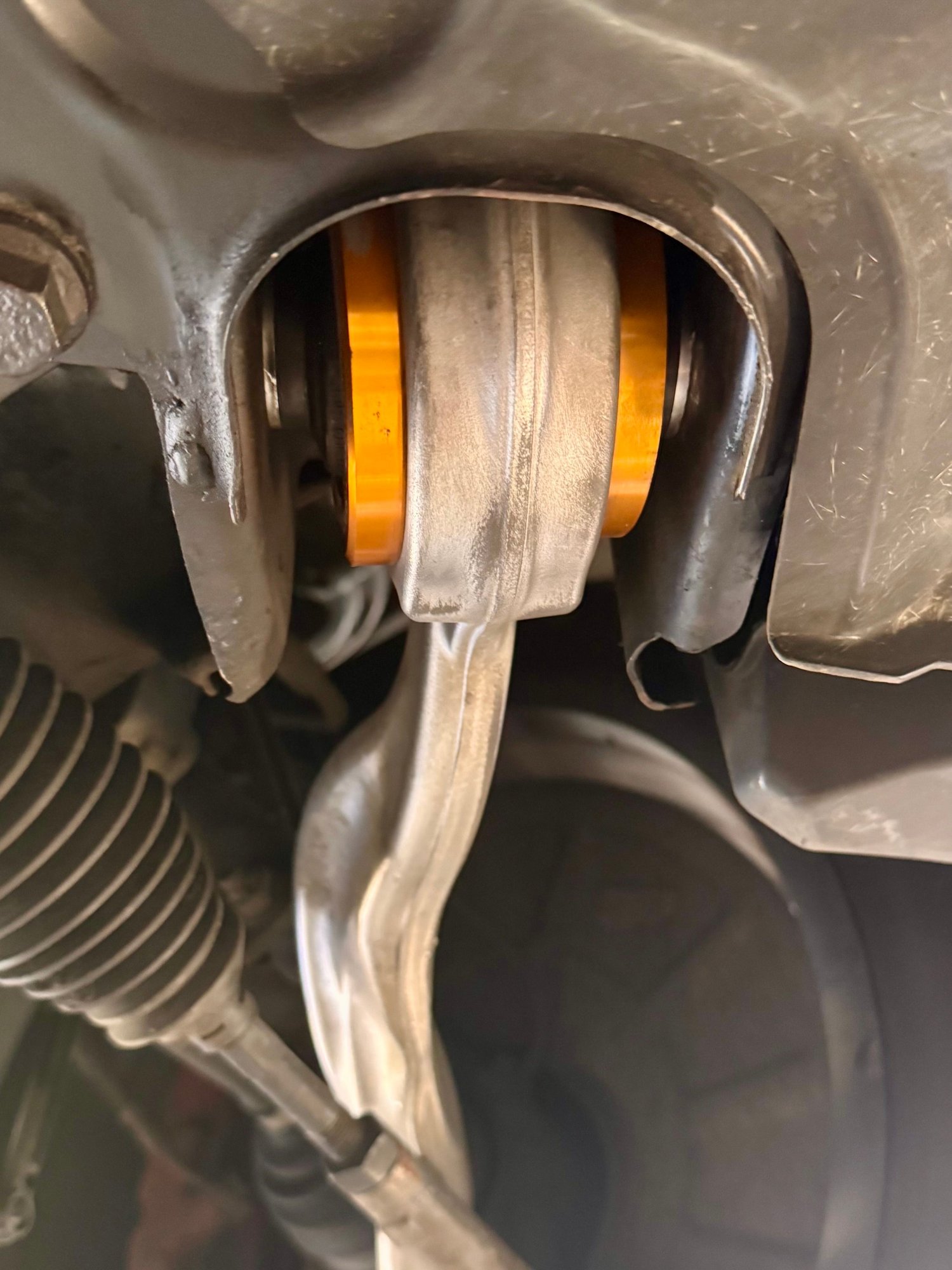

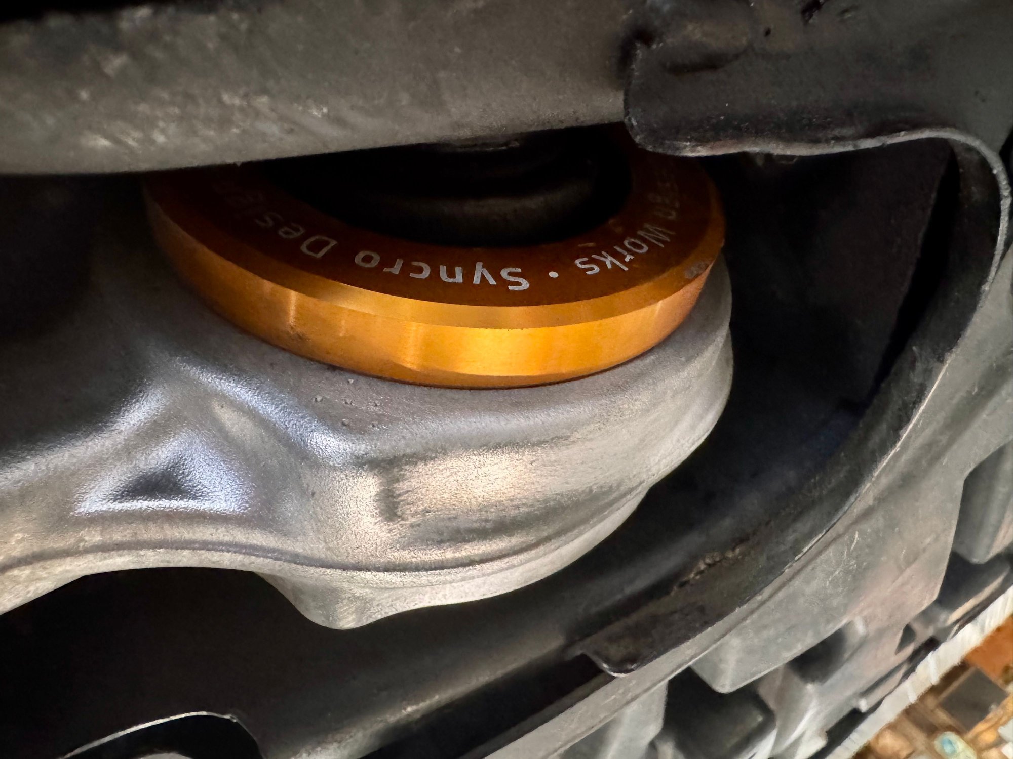

I use synchro design works lower front control arm bushings on my 63s wagon. Significant improvement over stock.
