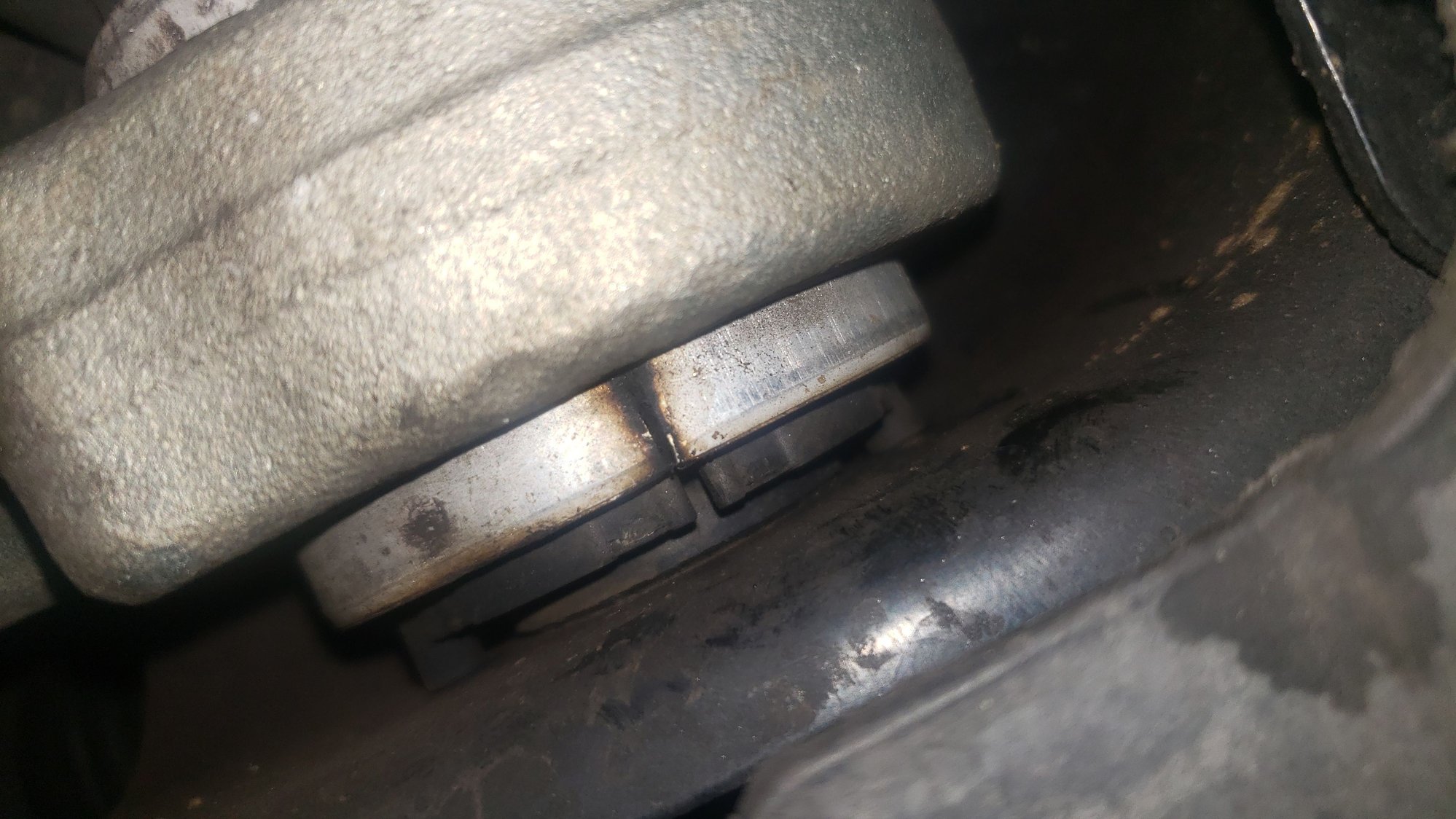

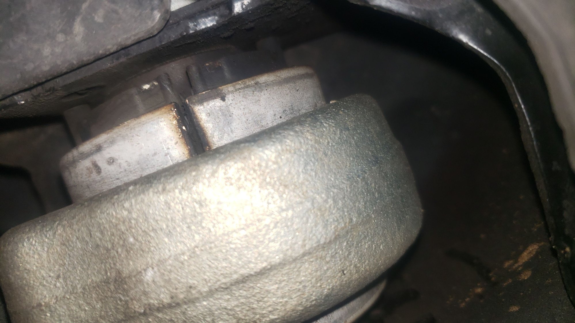

Hello,
Replaced the left cross strut to eliminate the dreaded suspension squeak. All was good for a time. Now less than 10K miles here we are again. Any ideas on how to actually fix this?
Pics below are for the left and right respectively.
Thanks,
Joe

Yup, funny timing, my driver side is also the exact same faith, with about 10K miles of non agressive driving and roads, the arm has slide off the boot. This will be my second one since new, 24K miles. Really disappointing.

I replaced mine with a Movtech part, its much larger on the bushing. At 3000 miles on it currently no issues. Obviously thats about 1/10th of the regular failure rate (30k miles) but so far no issues.

Dealer arm 3x my 4th arm from RockAuto
So far it has out lasted the dealer arm. It was under 50 bucks. Dealer was out of stock.
When I have time I am going to take the OEM part and center the bushing and weld the bushing too the arm it self.
Yes Yes...arm was tighten under load not on a lift. Its a simple installation and if need it will also be a rockauto arm going forward.

Seems like the two best options are:
1. FCP Euro the part. Life time replacement, just pay shipping.
2. Weld the outer housing to prevent it from shifting on the arm. It's what I did on mine.

I kind of feel option 2 would be the way to go. Can you elaborate on the process? I assume rubber pressed out first? Any other advice on welding process?
Thanks!
Left the bushing in.
low voltage.
clean the area.
tack and let cool. rinse and repeat.
I didn't do it completely around, just in five or six spots so the sleeve wouldn't move within the arm. Also, didn't want to ignite the bushing.

I tack welded beads on either side, mine never moved again.
