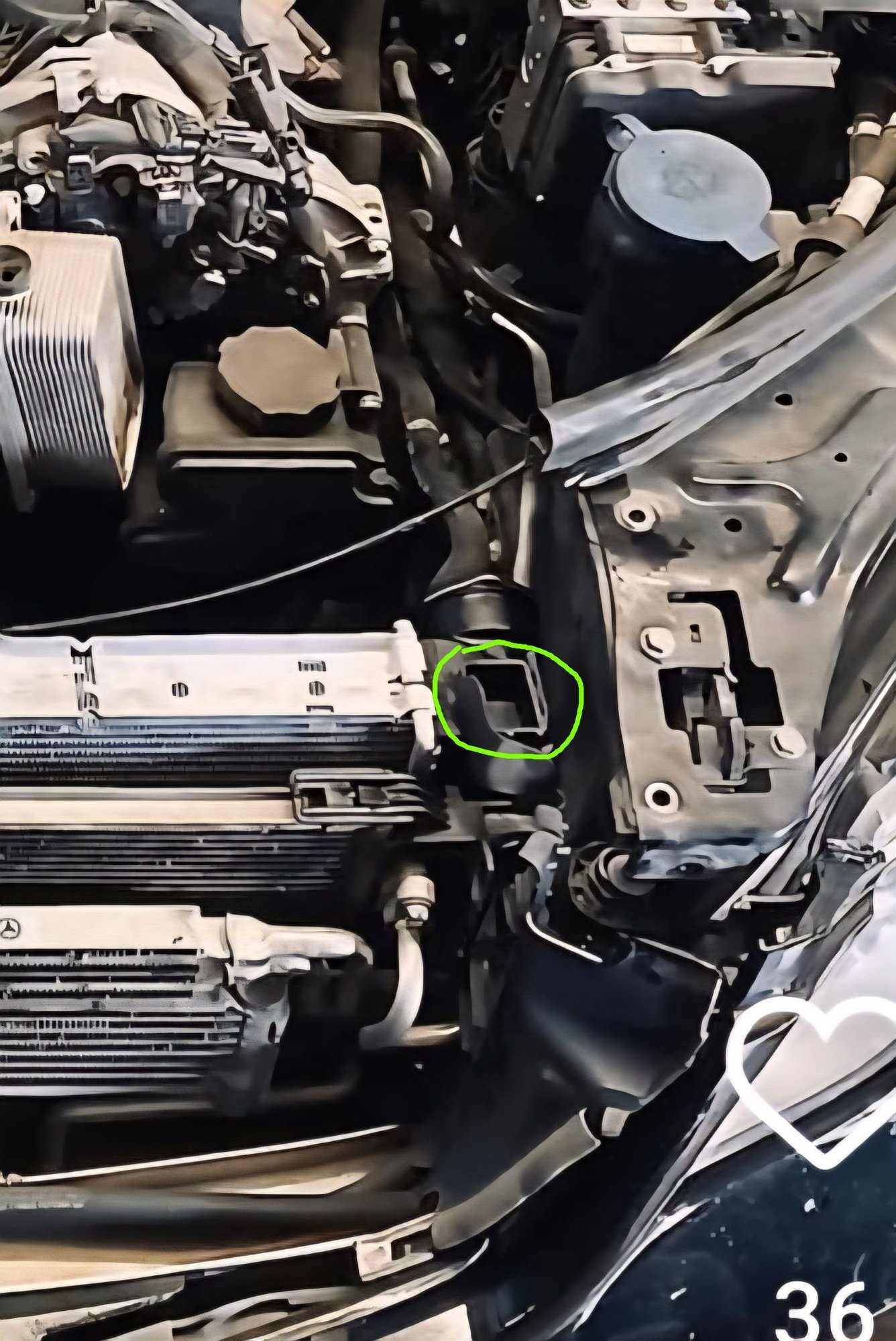

I've been having a slow leak in the cooling system and having to top up frequently.
I've located a leak but it was not easily noticeable. The leak is from a heater hose that goes from the firewall to the washer fluid reservoir.
There is another hose that is in close contact to it but I haven't traced down to where it goes yet.
In the pict, the leak is circled in green. The location of the picture is on the drivers side between the brake fluid reservoir and the strut tower behind the 'fake' firewall (where the heat shield keeps engine heat from spreading.
Has anyone changed either hose ? How involved did you find it ?
I've changed a similar hose behind a V8 BMW engine years ago. It was tight but doable. I needed someone who had smaller hands than mine.
Any experience dealing with this is appreciated.

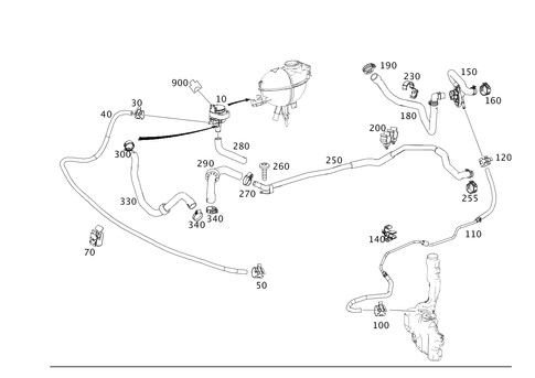

replace these two super hot hoses
these hard plastic elbow pipes 150 + 180 like to leak and brake off on hot engines mounts that shake a lot.

The coolant drips down, and becomes visible on, item #110, but I can almost guarantee that it's item #150 that is your issue. Replace everything you can while you're in there.

Ordered items #150, #180. I don't want to go in there again.

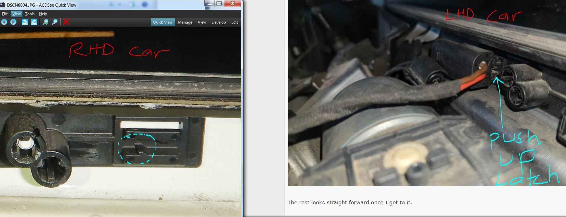

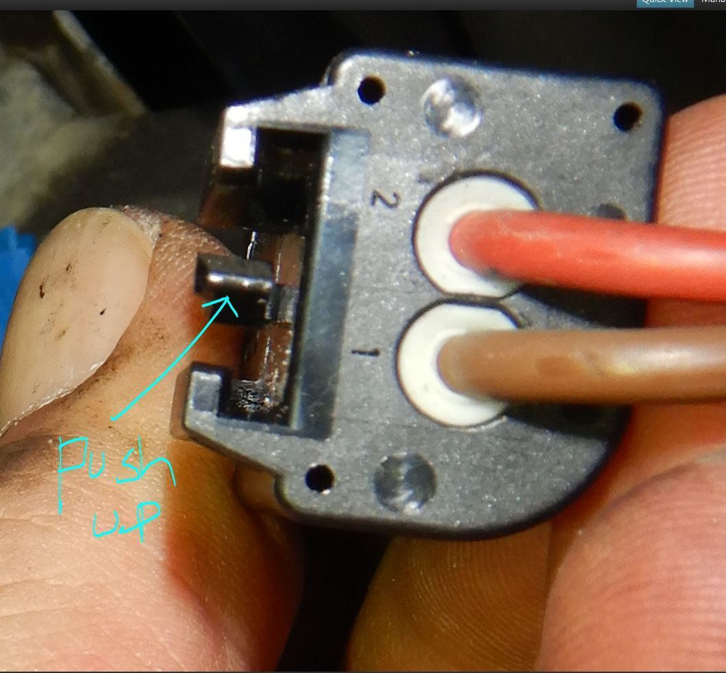

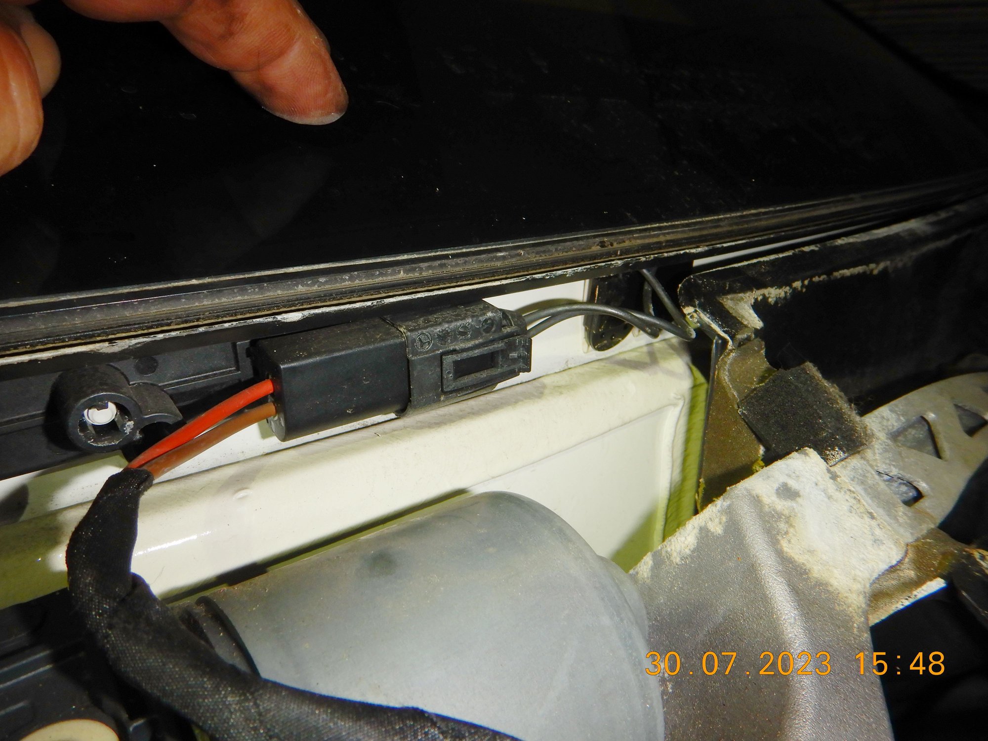

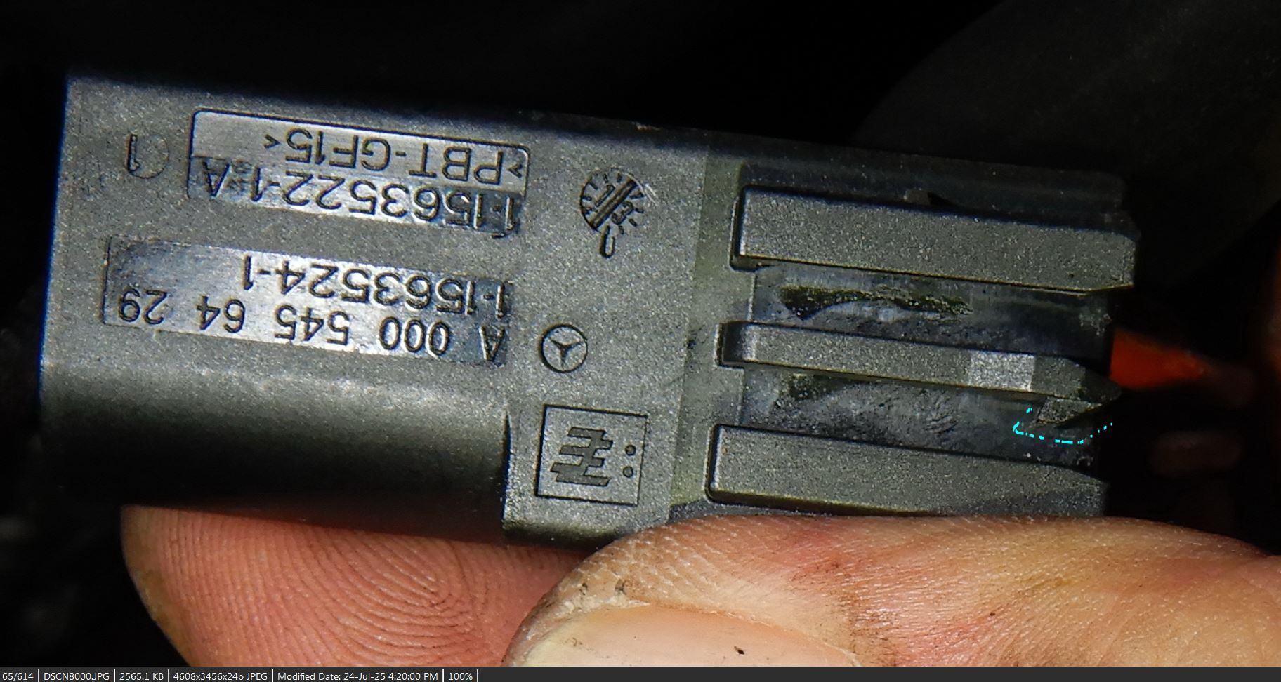

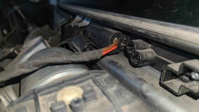

I couldn't for the life of me get one of the electrical connectors uncliped from the firewall. See below. After spending a few minutes on it, I stopped.
Stripping it down to this point doesn't take long at all. I had to be somewhere later in the day so I popped on the cowl again without bolting it down,
Does anyone have any idea of how to unclip this from the firewall ?
I know its from the back end of the connector where the coloured wires enter the connector. I just couldn't trip it to release.
The rest looks straight forward once I get to it.

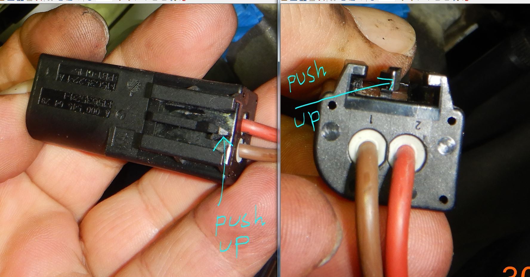

Old Jul 24, 2025 | 05:33 AM
S-Prihadi's Avatar
Joined: May 2018
Posts: 6,611
Likes: 6,561
From: Jakarta-Indonesia
Here u go.....
I think for LHD car, I should have wrote PUSH DOWN the latch. Your brown wire is on top, for mine being a RHD intall orientation my red wire is on top.
If the connector is the same ( which I am sure ) , the locking latch teeth is pointing down to brown wire, thus it has to be pushed to RED color wire and DOWN for you and UP for me.
Let me know how it goes, small thing like this is often irritating...I know.
My install version, RHD car.
Old Jul 24, 2025 | 09:01 AM
- Mover -'s Avatar
Joined: Jun 2017
Posts: 127
Likes: 31
E550
Originally Posted by S-Prihadi
Here u go.....
Thank you !!
Excellent explanation and pictures !

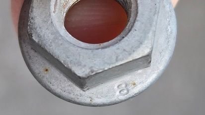

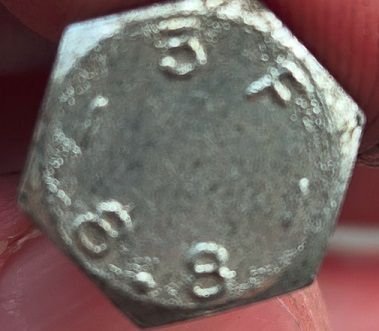

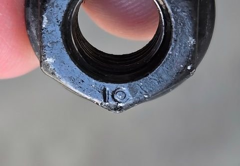

For those of who like to torque things down properly.
3 Wiper arm nuts - M10 Class 10.9
Wiper motor - 2 nuts 1 bolt - M8 Class 8.8
Support arm - 1 nut - M10 Class 10.9

Thanks. The M8 nuts are pretty much at class strength
The M10 nut for the strut support looks like they have REVISED DOWN to close to a class 5.8 torque value. Same applies to the M10 wiper arm nuts.
Without access to WIS the only thing to go on was diameter and class.
