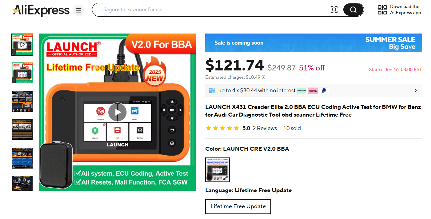

Originally Posted by mike10E350
Awesome thanks for the info I will order it today.
Just in case
http://I just found this on AliExpress: $312.68 | LAUNCH X431 Creader Elite 2.0 BBA ECU Coding Bi-directional for BMW for Benz for Audi Car Diagnostic Tool obd scan Lifetime Free https://a.aliexpress.com/_mtIisQx
Old Jun 13, 2025 | 03:32 PM
W205C43PFL's Avatar
Posts: 32,222
Likes: 6,281
Originally Posted by JCM_MB
Just in case
https://a.aliexpress.com/_mtIisQx]http://I just found this on AliExpress: $312.68 | LAUNCH X431 Creader Elite 2.0 BBA ECU Coding Bi-directional for BMW for Benz for Audi Car Diagnostic Tool obd scan Lifetime Free https://a.aliexpress.com/_mtIisQx
That works too but the other scanner is cheaper, if you don't need the functions of the Launch no need to spend more. For the full deal, get XENTRY.
Old Jun 13, 2025 | 03:36 PM
JCM_MB's Avatar
Joined: May 2021
Posts: 2,524
Likes: 2,041
From: US
2008 E350, 2012 ML350, 2014 E350, 2015 ML350
AliExpress links are a mess these days. The link lists full price, but in the app, it shows a heavy discount.
For example, a snapshot instead of the link,
