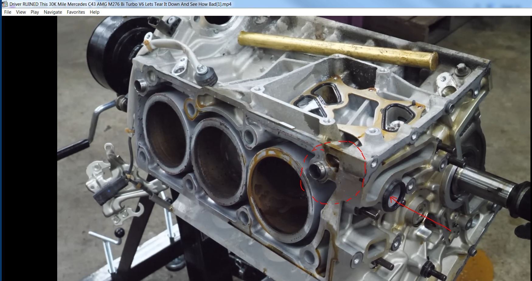

Originally Posted by S-Prihadi

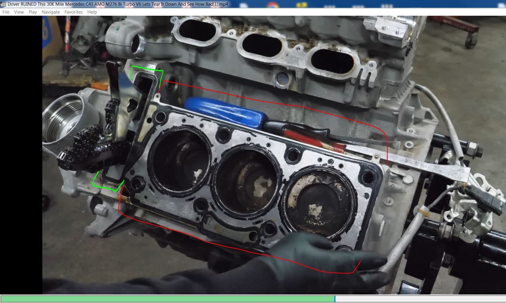

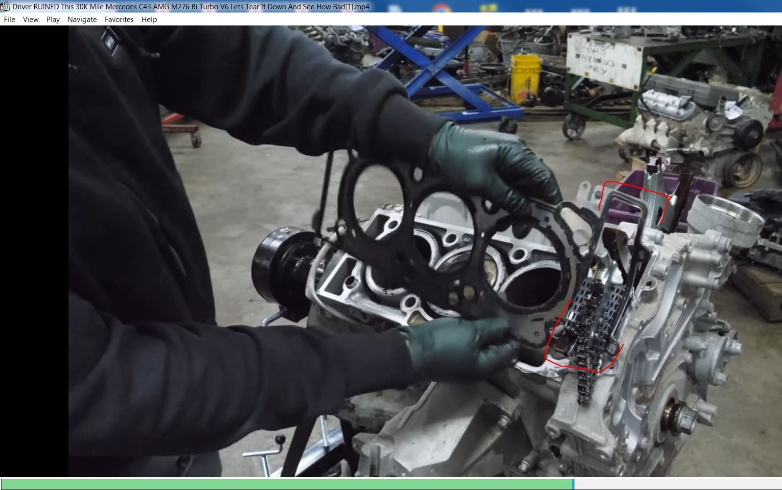

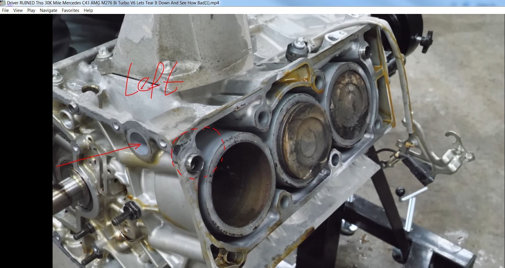

The timing cover removal is engine out job.
I tracked its procedure and cylinder heads must come off.
The cylinder head gasket is sandwich-ded by cylinder head and surely engine block, but a bit of it is also sandwich-ded by timing cover.
Green zone is timing cover, red zone is cylinder head only, the gasket is shared using cylinder head gasket.
The oil pan also sandwich-ded the timing cover and using loctite sealant.
Since sealant is used on oil pan, I can not slide in the timing cover stand alone, it has to be first installed and then sandwich-ded by oil pan with new sealant,
and then install cylinder head. I mean sealant is for shoe box style closing and not slide-in like a drawer.
As for oil pan, I done measurement for engine intact-in-car and lifted up a bit, there is a chance oil pan may not be able to be removed due to lack
of clearance.
So engine out job is best + additional refreshed parts target for 2028, which I may move forward sooner, depending on how good I can clean engine block this session.

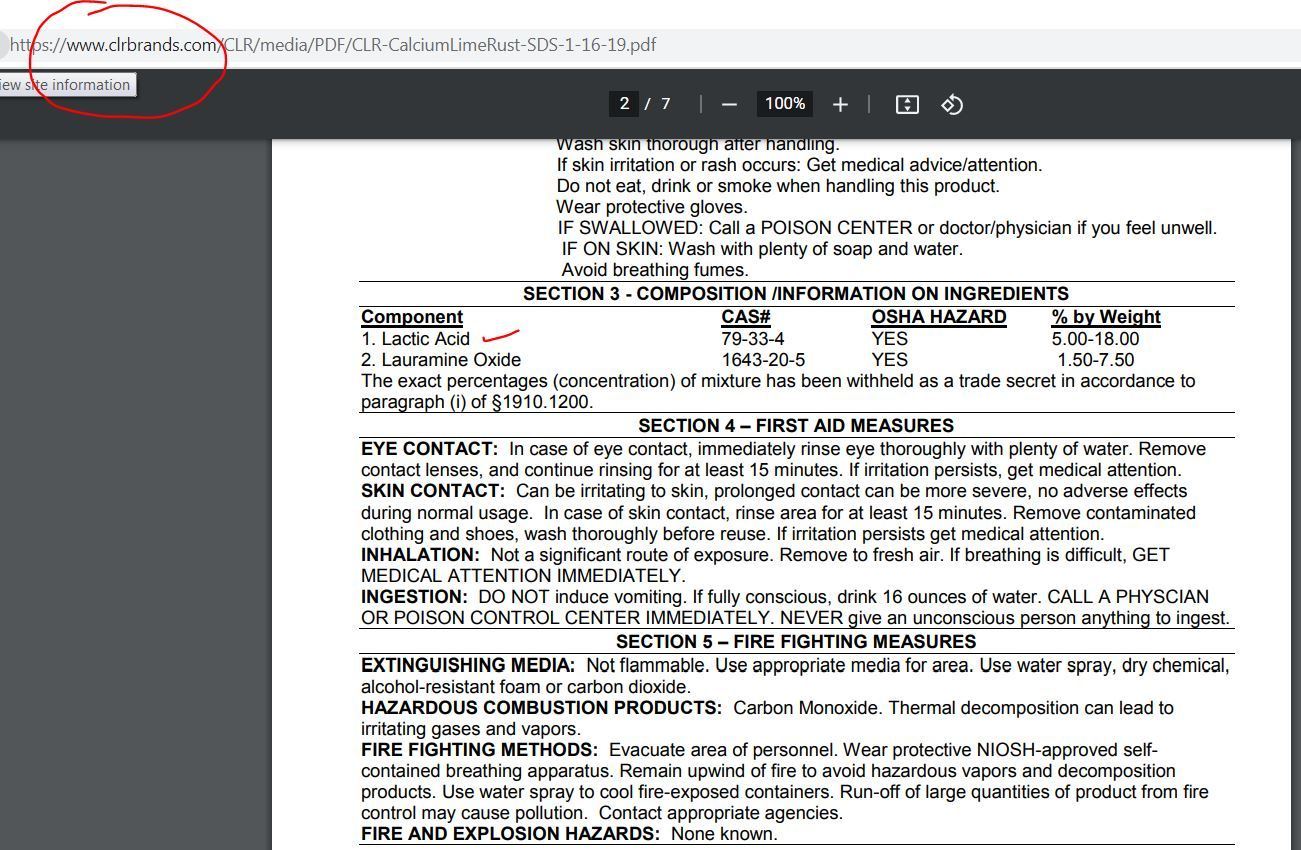

I look at coffe machine descaler .
and CLR msds

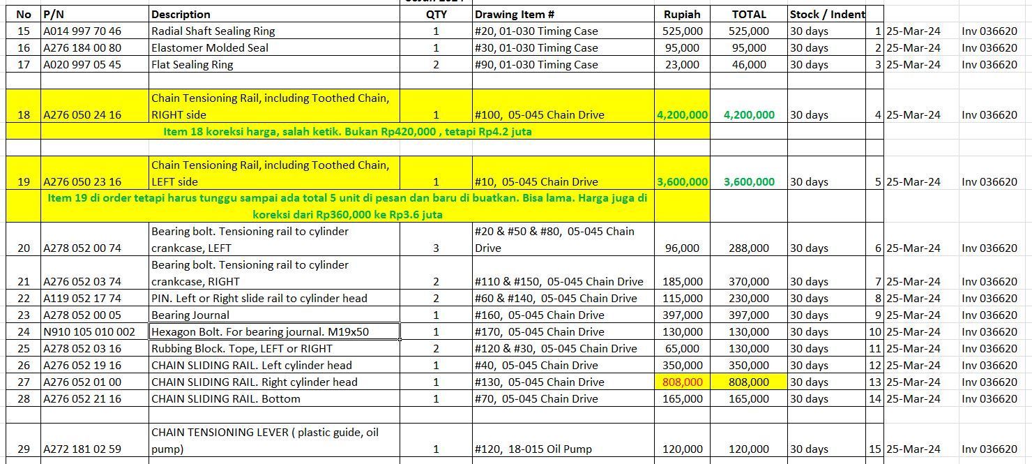

Originally Posted by MB2timer
That timing cover area, that is an area of concern for me. It looks like the timing chain housing is open to any type of contaminants falling in there. Contaminants in that area, while the engine is running is catastrophic. Are you doing anything to keep that area clear and sterile? No matter how careful any mechanic is, around an open hole, sooner or later something will fall in there.

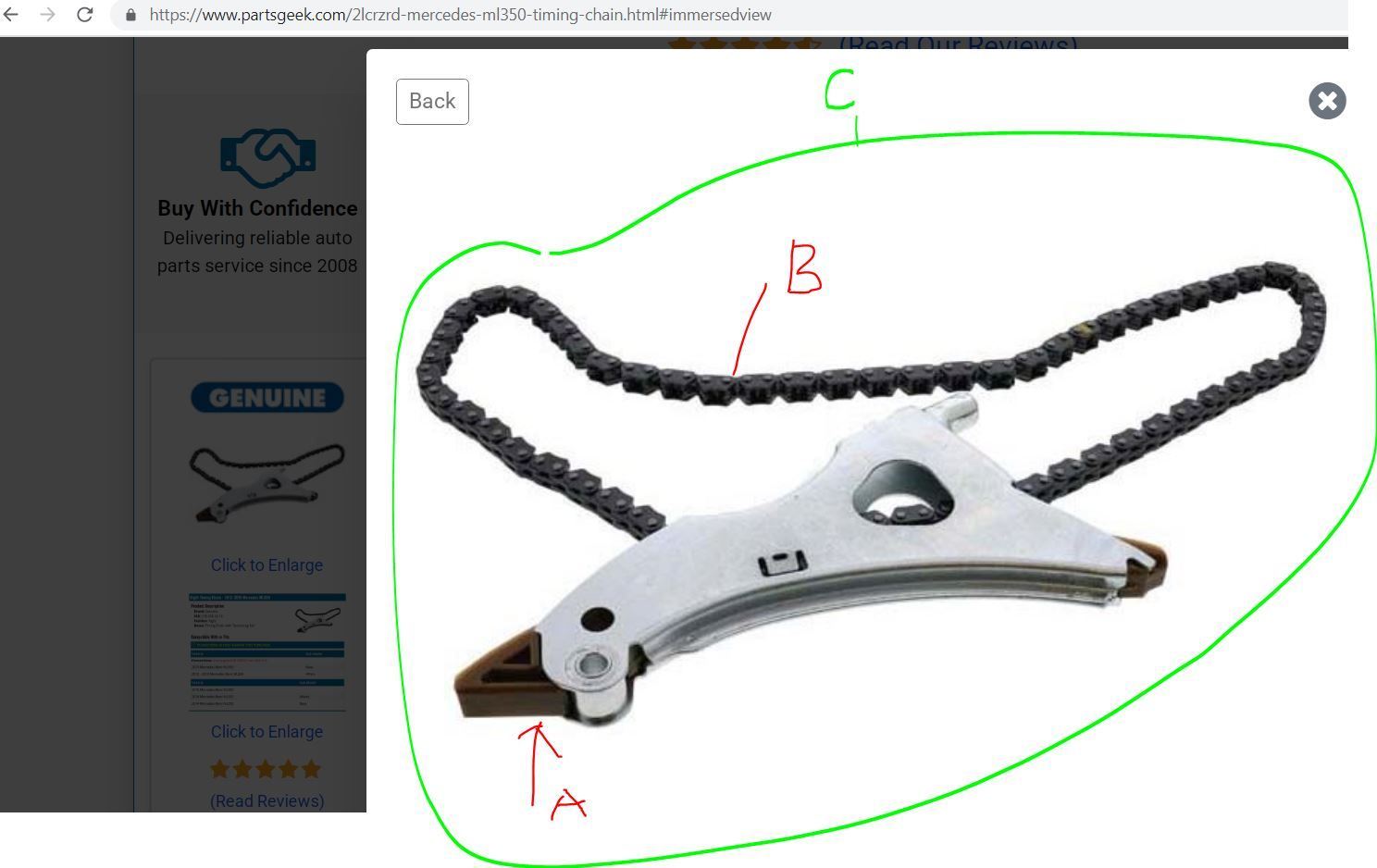

Also, if the timing chain area is easily accessible, have you considered replacing it? Cloyes gear and products makes very nice timing component replacement kits. Of course there are a number of other products other than OEM in the same category.
This session I will not touch the timing chain region.

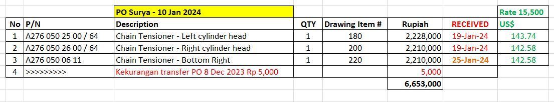

I have all the parts already and will replace everything timing chain related by 2028, due to the plastic guides worry.
Timing chain tensioner also will be replaced all 3, 3rd one is oil pump timing chain.
There is one plastic guide which is not sold separately, instead I must buy the timing chain.... so I bought new timing chains L and R side.
So I must buy C to get A , and get B too.
All above is timing chain region stuff, but not yet including the 3 timing chain tensioners.
Divided by 15,200 to 15,500 you get the US$ price of March 2024, where my Rupiah was still better at 15,200 gets me 1 US$. Today its 16,300 ish to get 1 US$.
The 3 chain tensioners

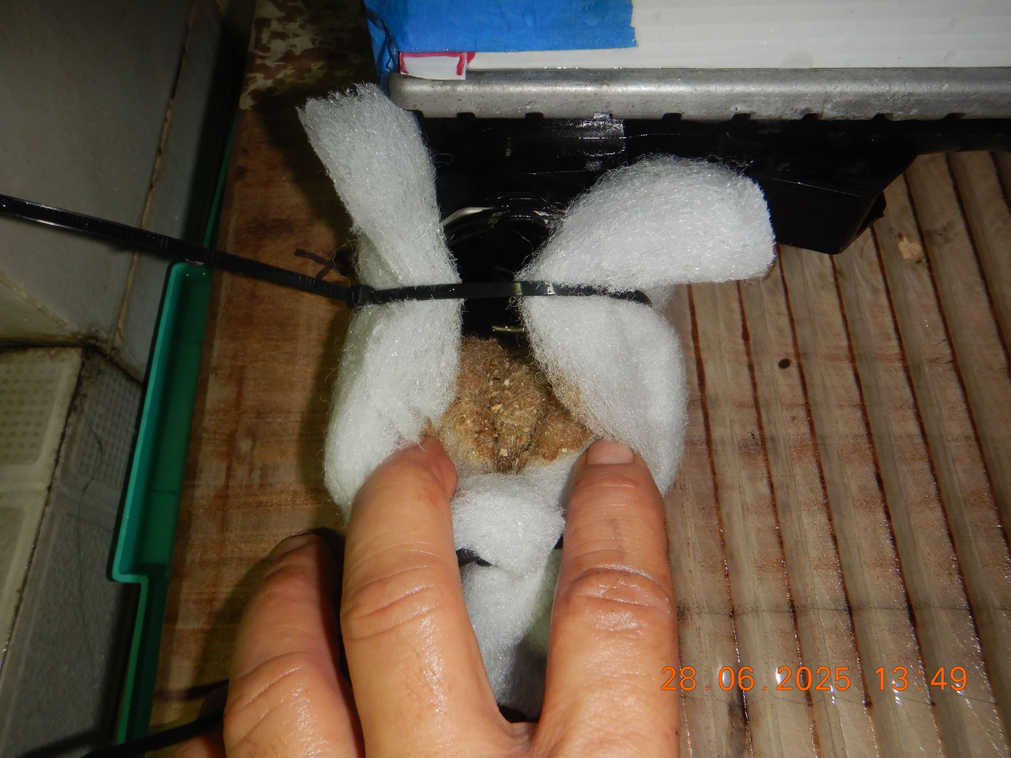

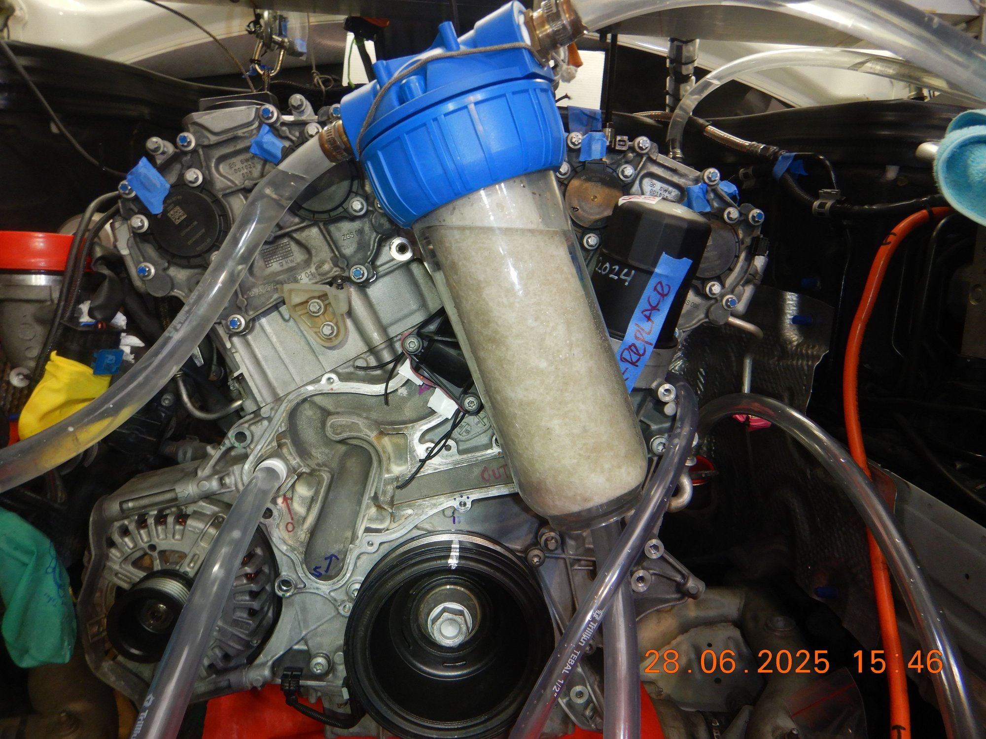

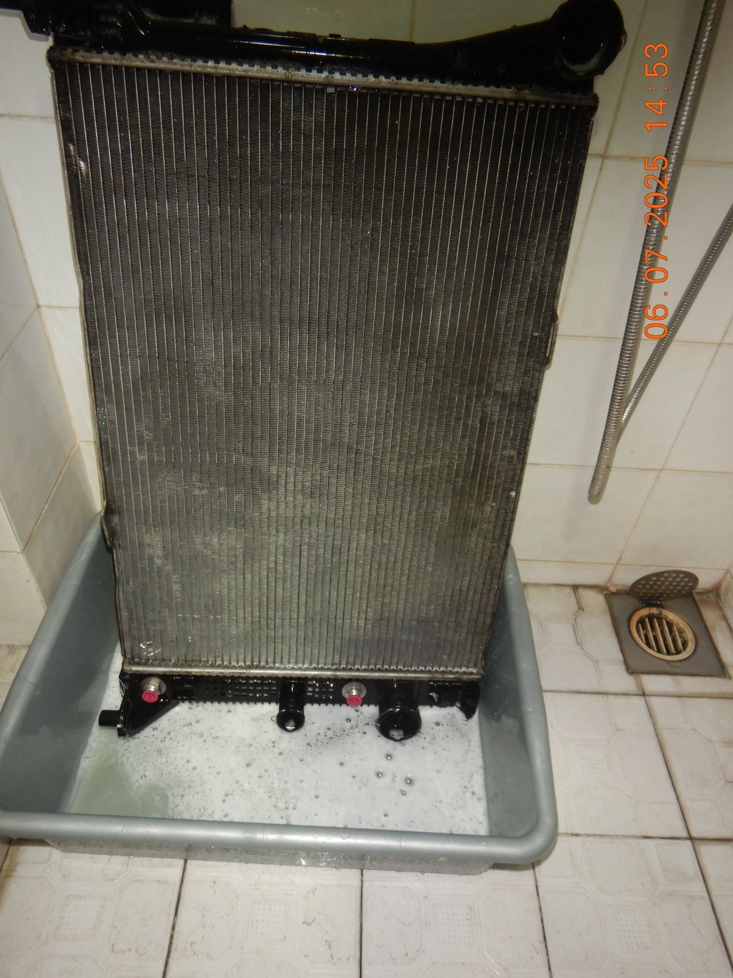

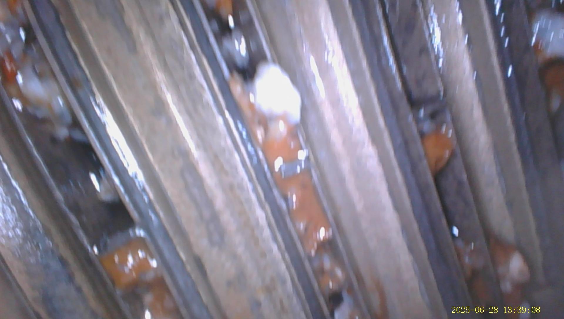

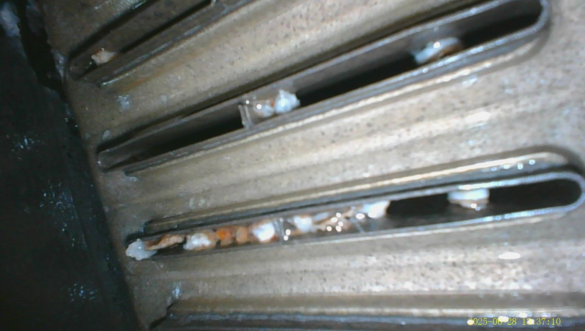

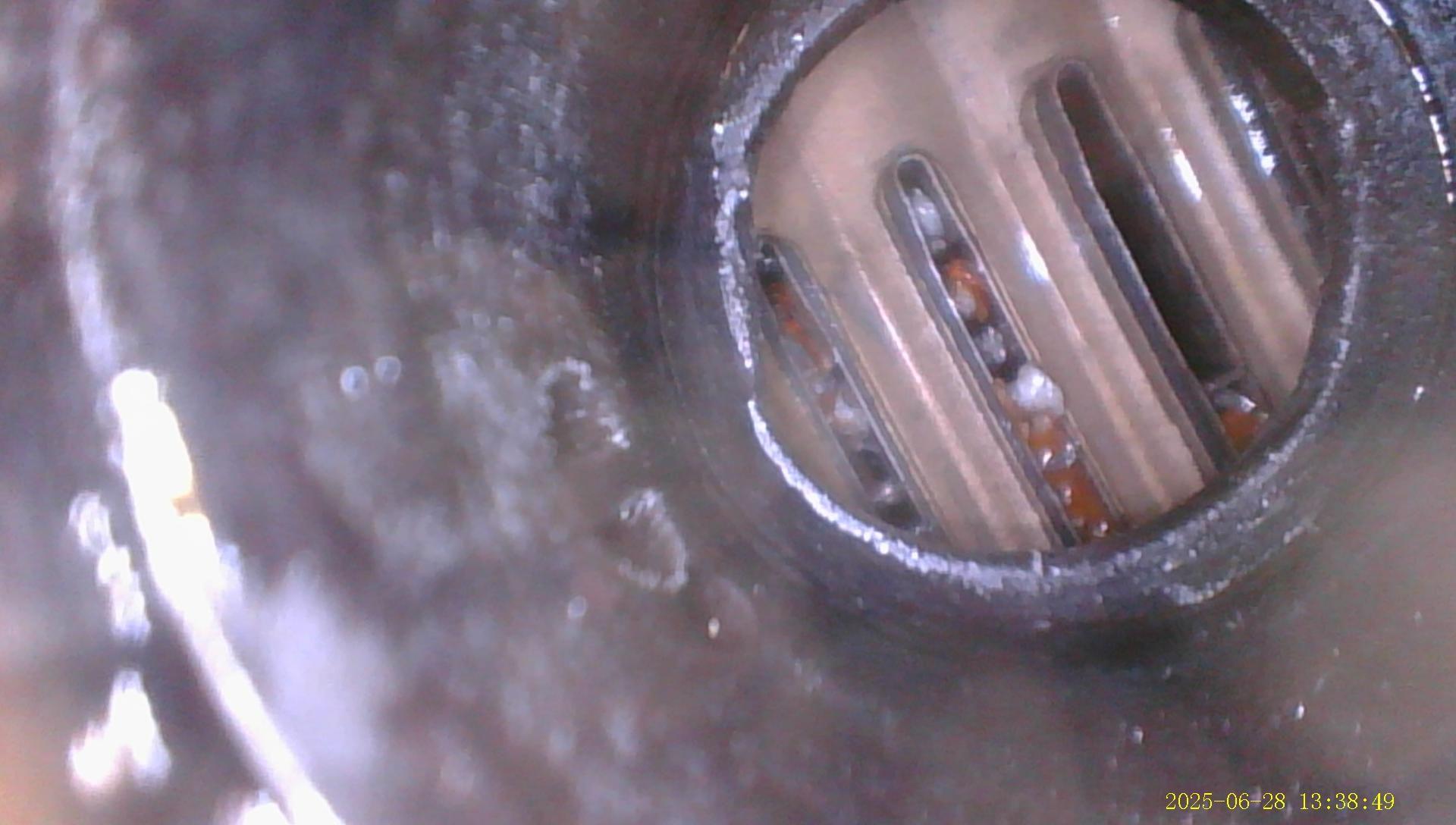

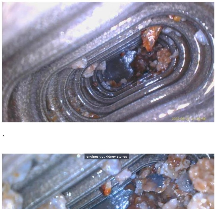

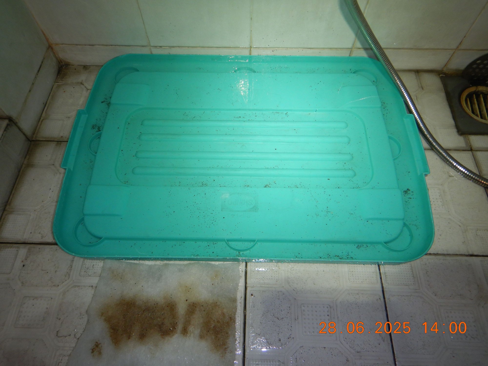

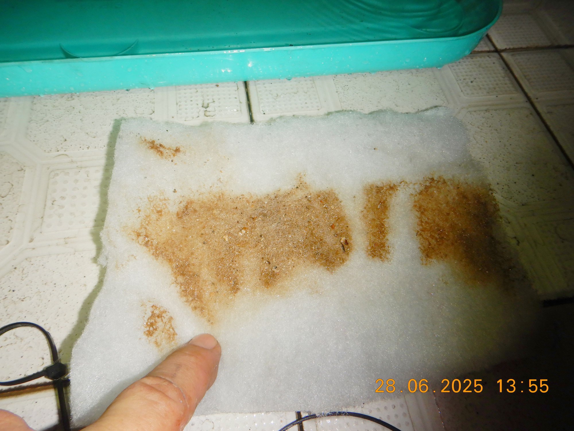

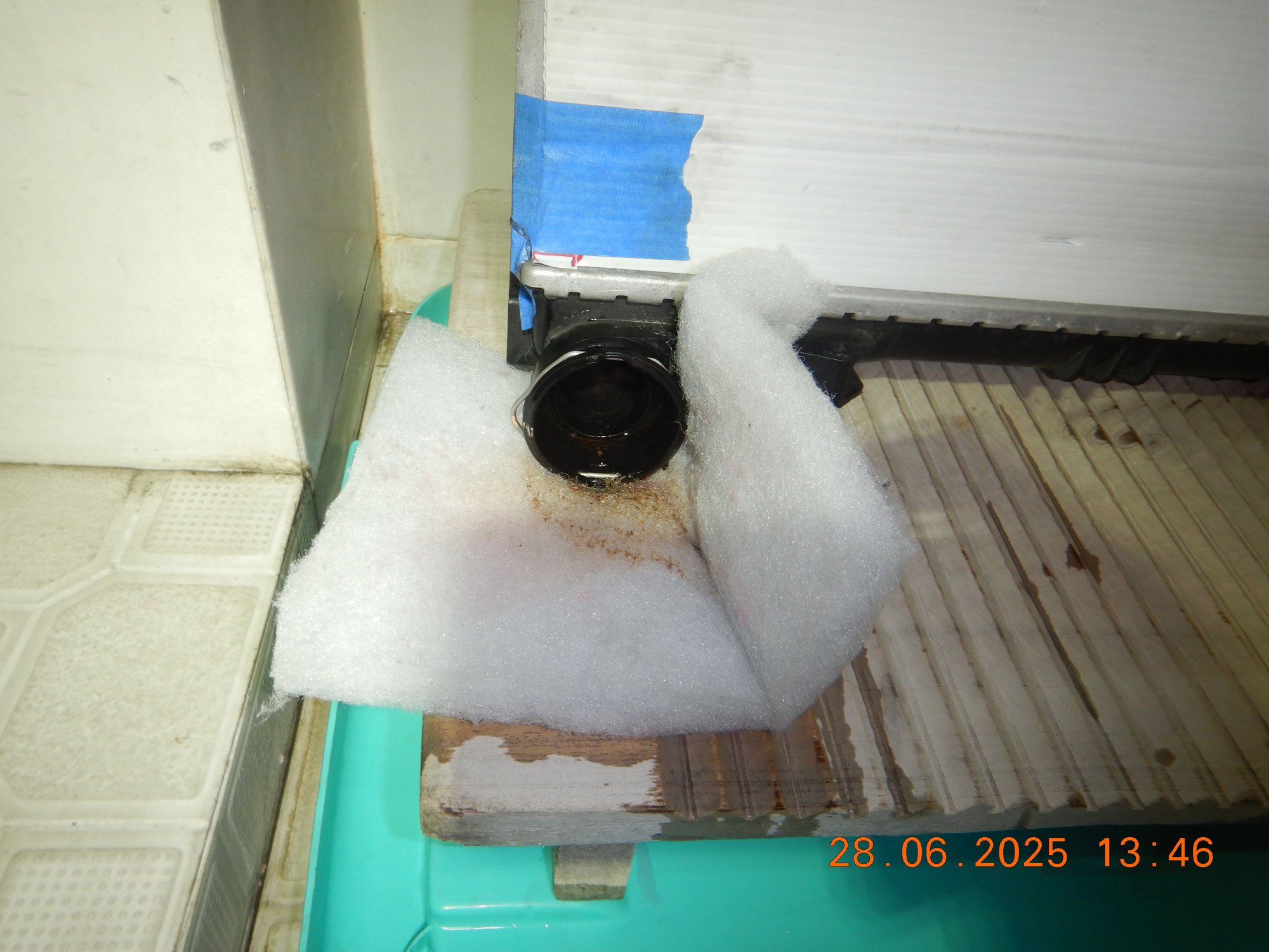

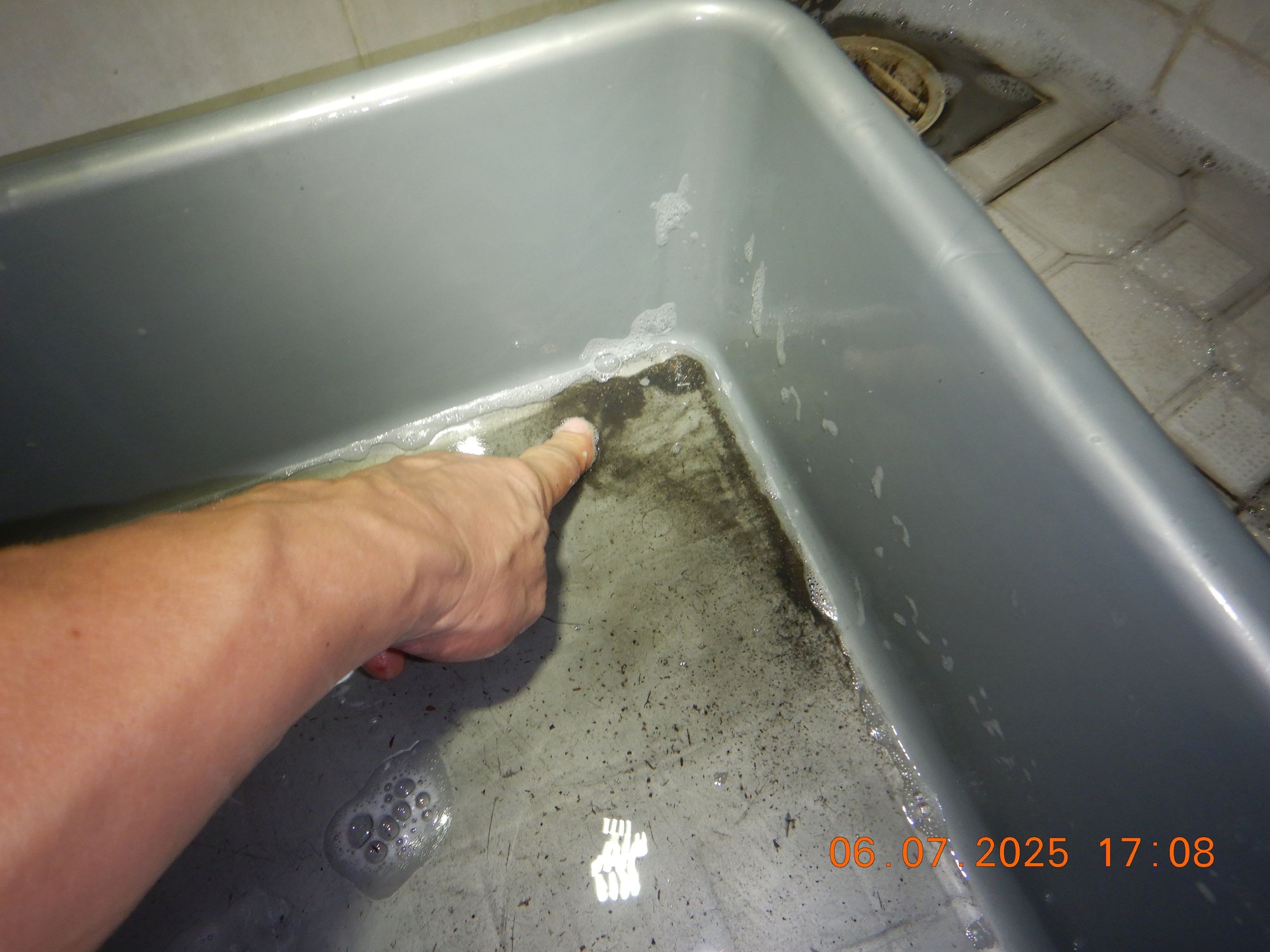

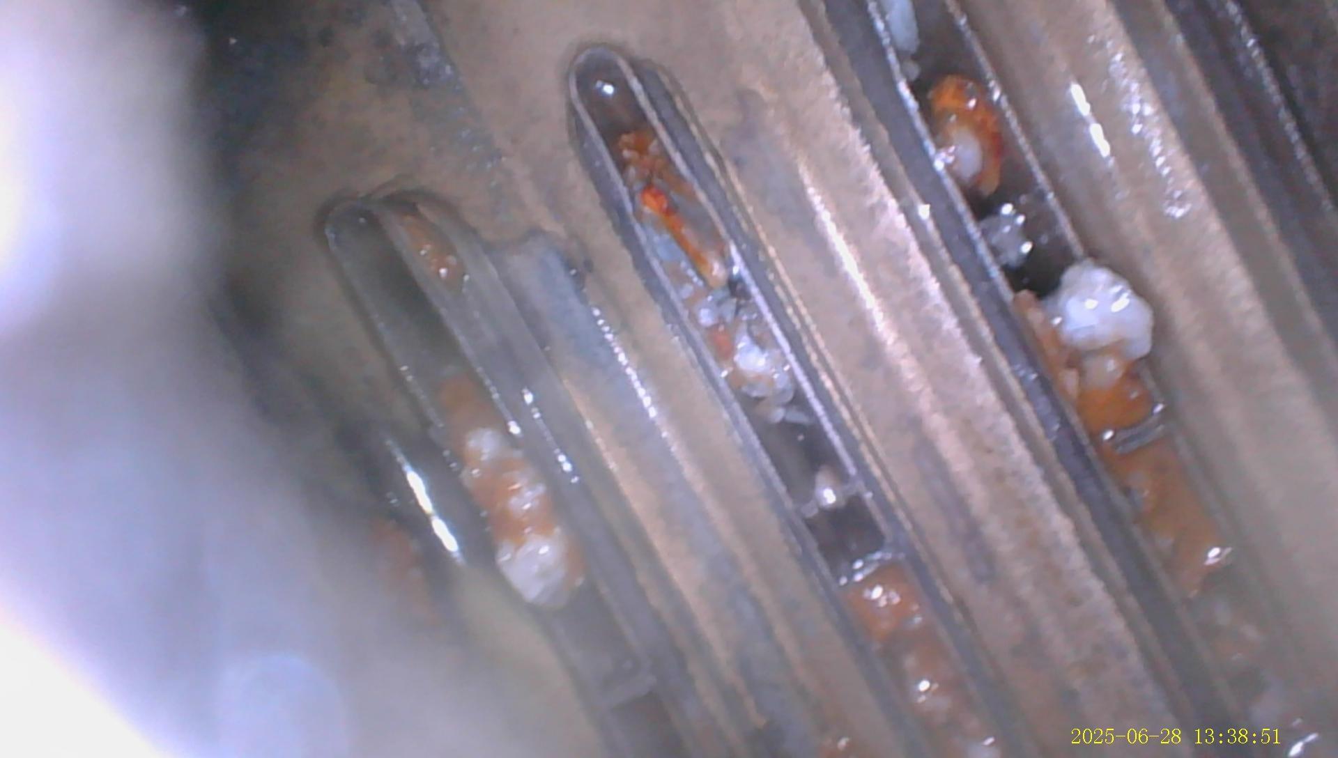

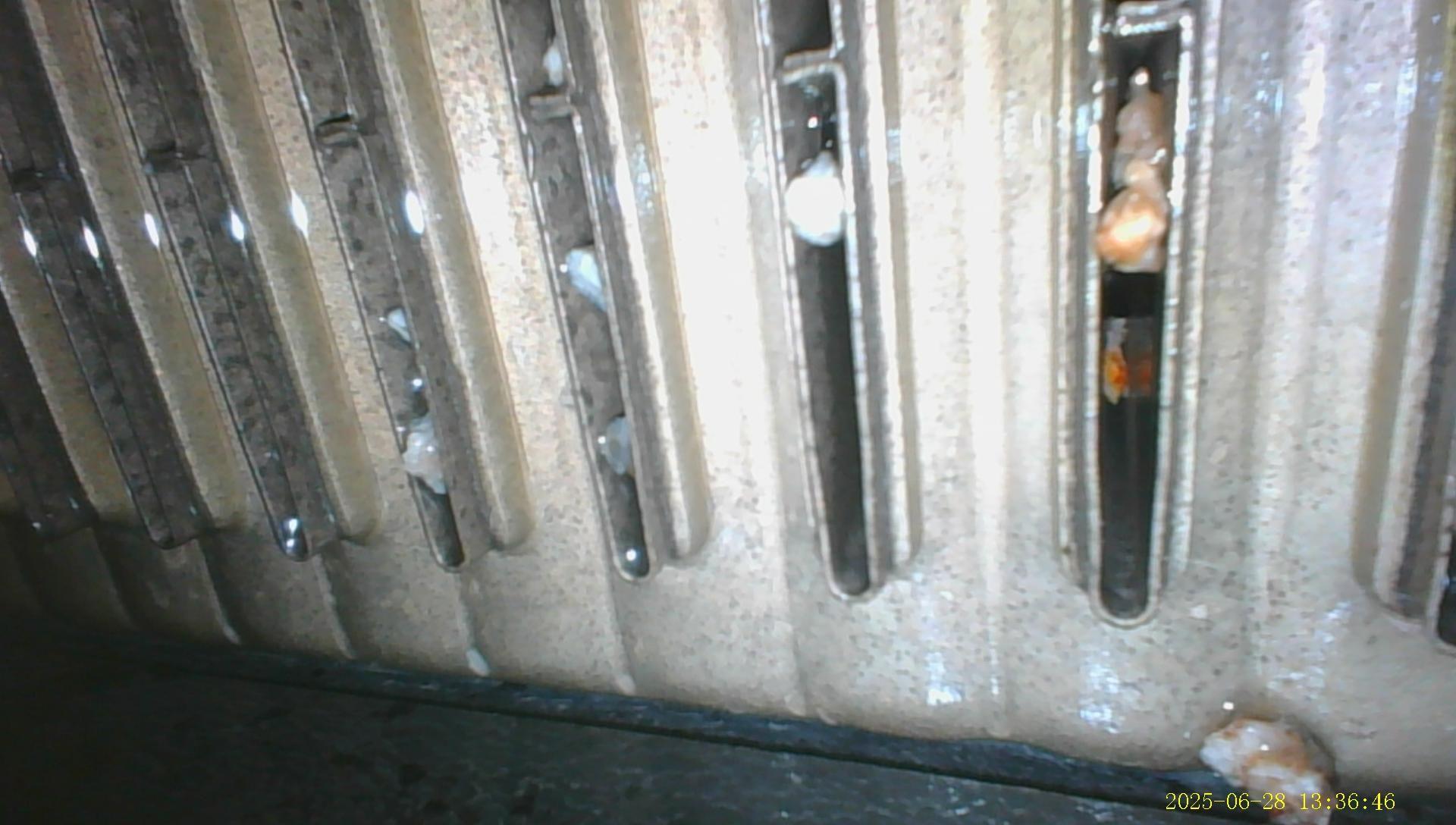

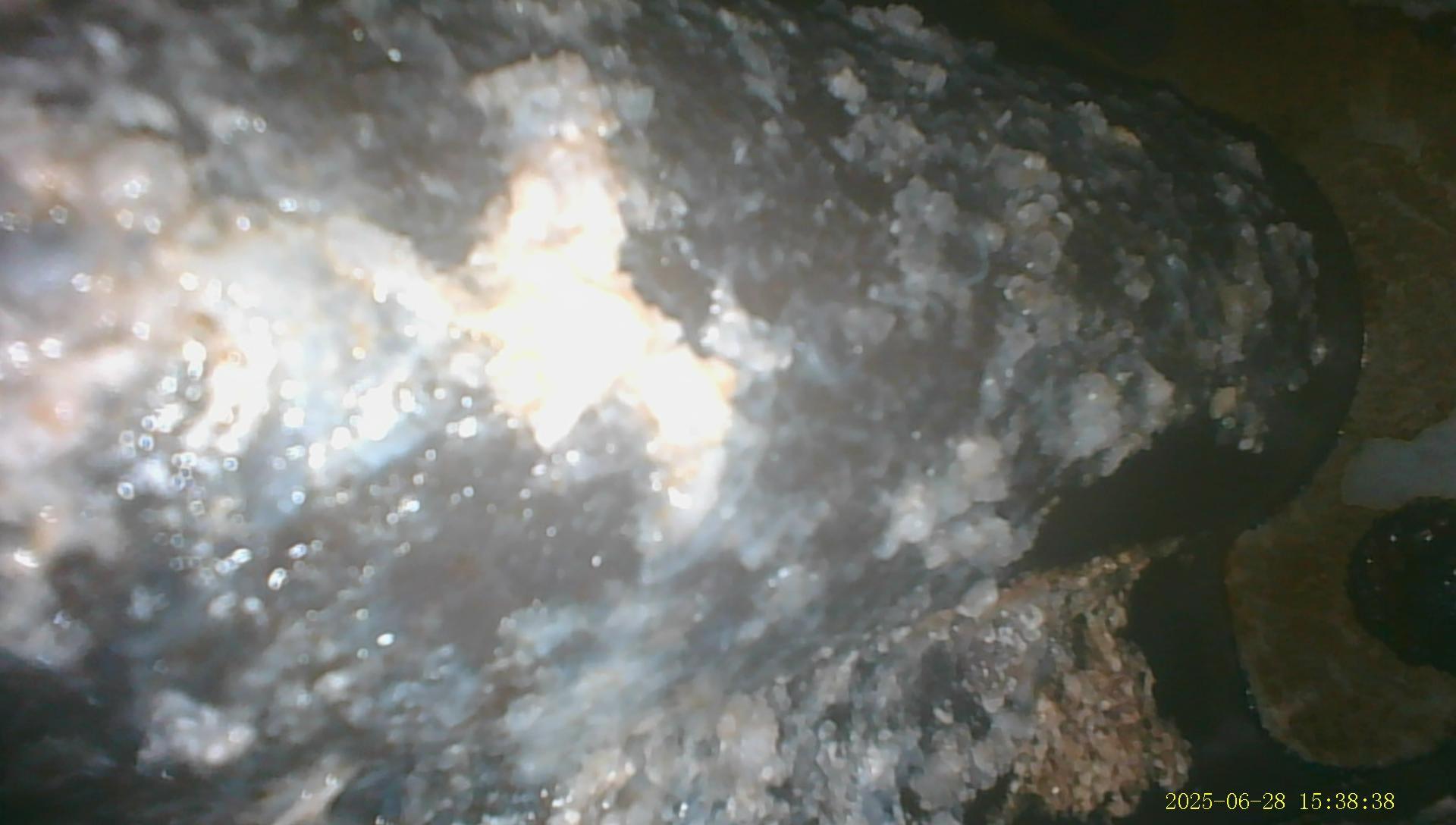

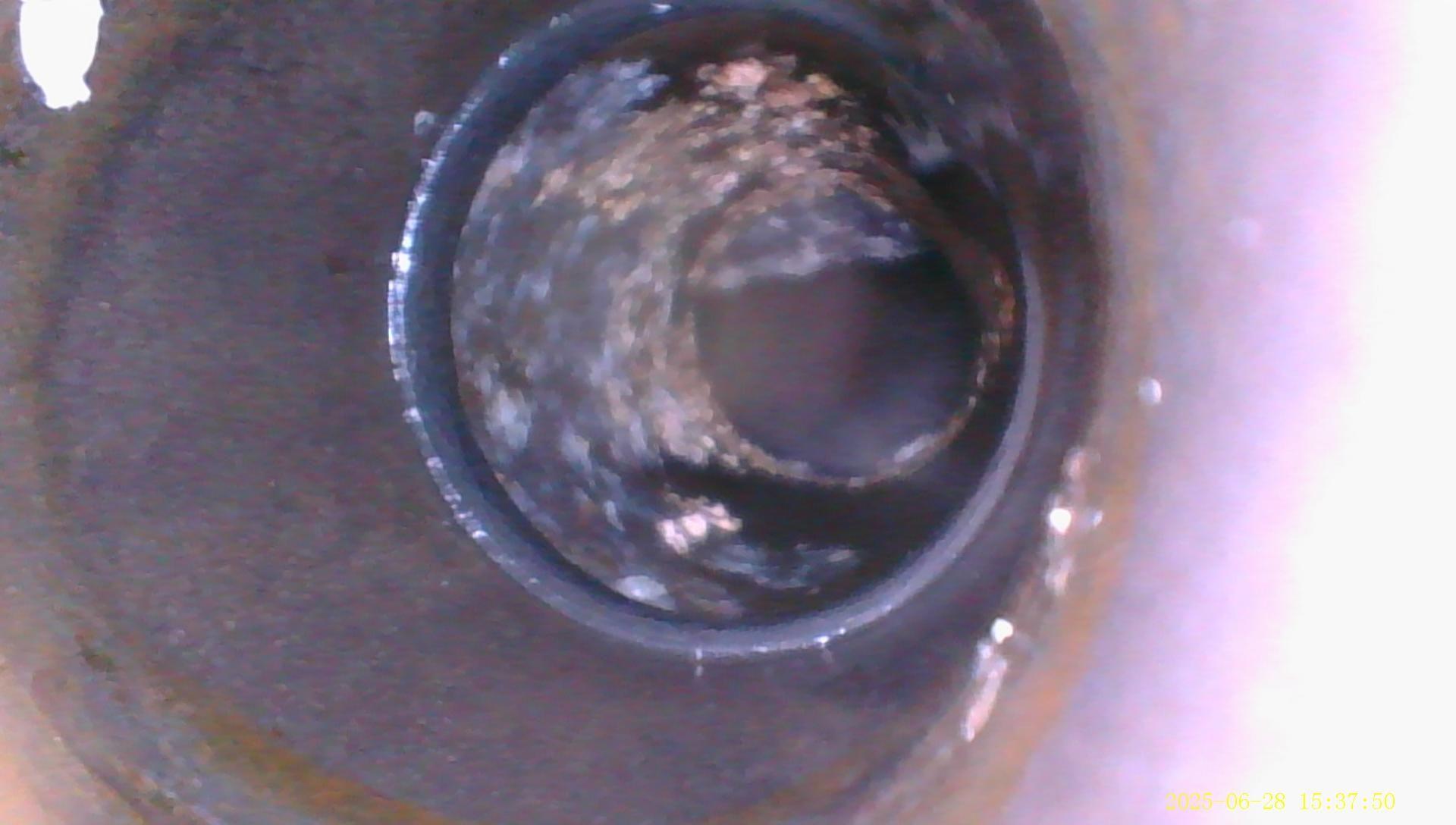

The first time circulation without any chemicals, the dirt trapped at filter is below :
More like sand.

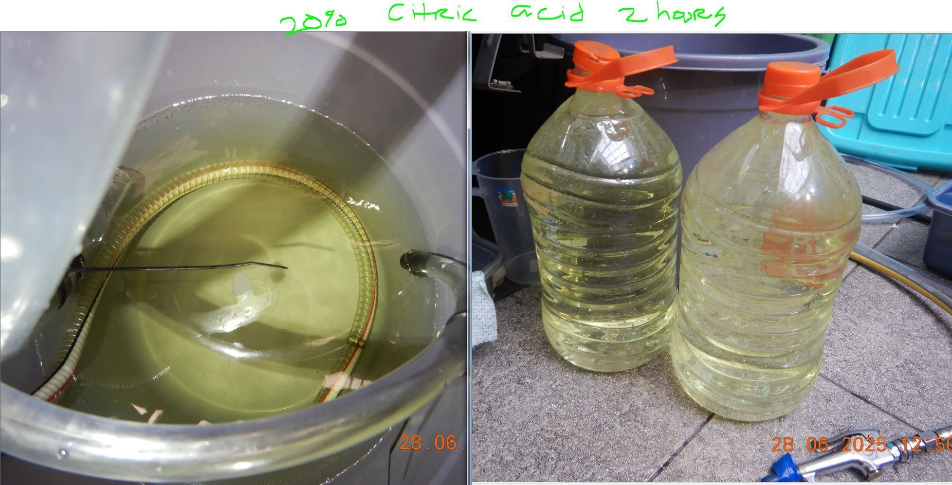

2 hours on 20% Citric Acid, does not work..............water temperature, hottest 30C.
First 30 minutes on 10% and then next 90 minutes on 20%.
But the water does becomes a tiny bit yellow by the time I am done at 20%.

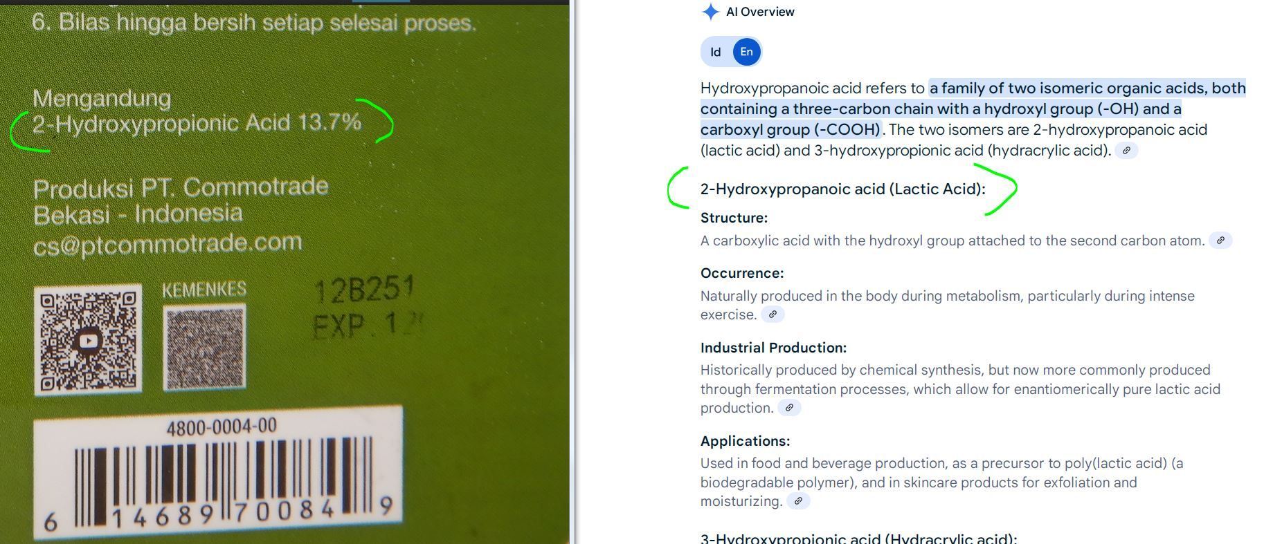

Next I tried Lactic Acid at 13.7% of 1 liter bottle cleaner, diluted with another 12 liters of water I added.
Lactic acid is so foamny and kinda slipperr, only 45 minutes I run the ciculation.
Ciitric and Lactic did produce a bit dirtier filter element, but nothing too remarkable.

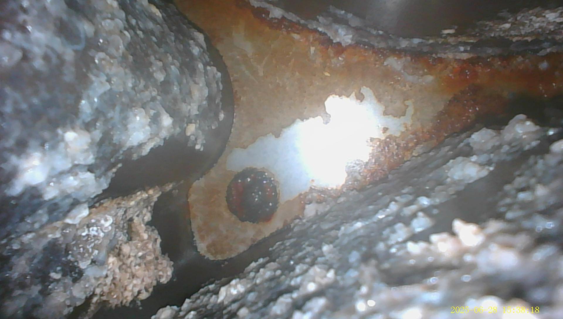

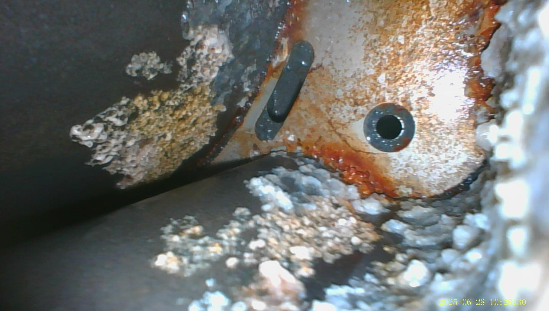

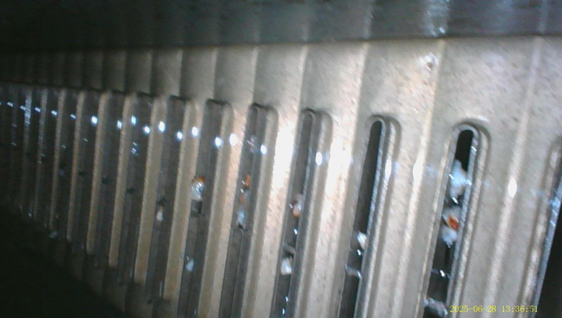

Bank 1 coolant port after Citric and Lactic acid treatment.
Still plenty of gremlins.
Bank 2 coolant port
Radiator backwash only, no chemicals.
Radiator INPUT side......... still a mess. Camera movement is from top to bottom.
If from bottom drain hole/plug.............and camera movement upwards a bit..........
WILL CONTINUE.......................

If that is sand, which is primarily silicon, no acid will dissolve it before the rest of the cooling system is dissolved.
Old Jun 28, 2025 | 10:39 PM
  #61
S-Prihadi's Avatar
Joined: May 2018
Posts: 6,607
Likes: 6,554
From: Jakarta-Indonesia
The loose one trapped in filter seems like sand, the sticky ones I don't know, but probably some are also sand family.

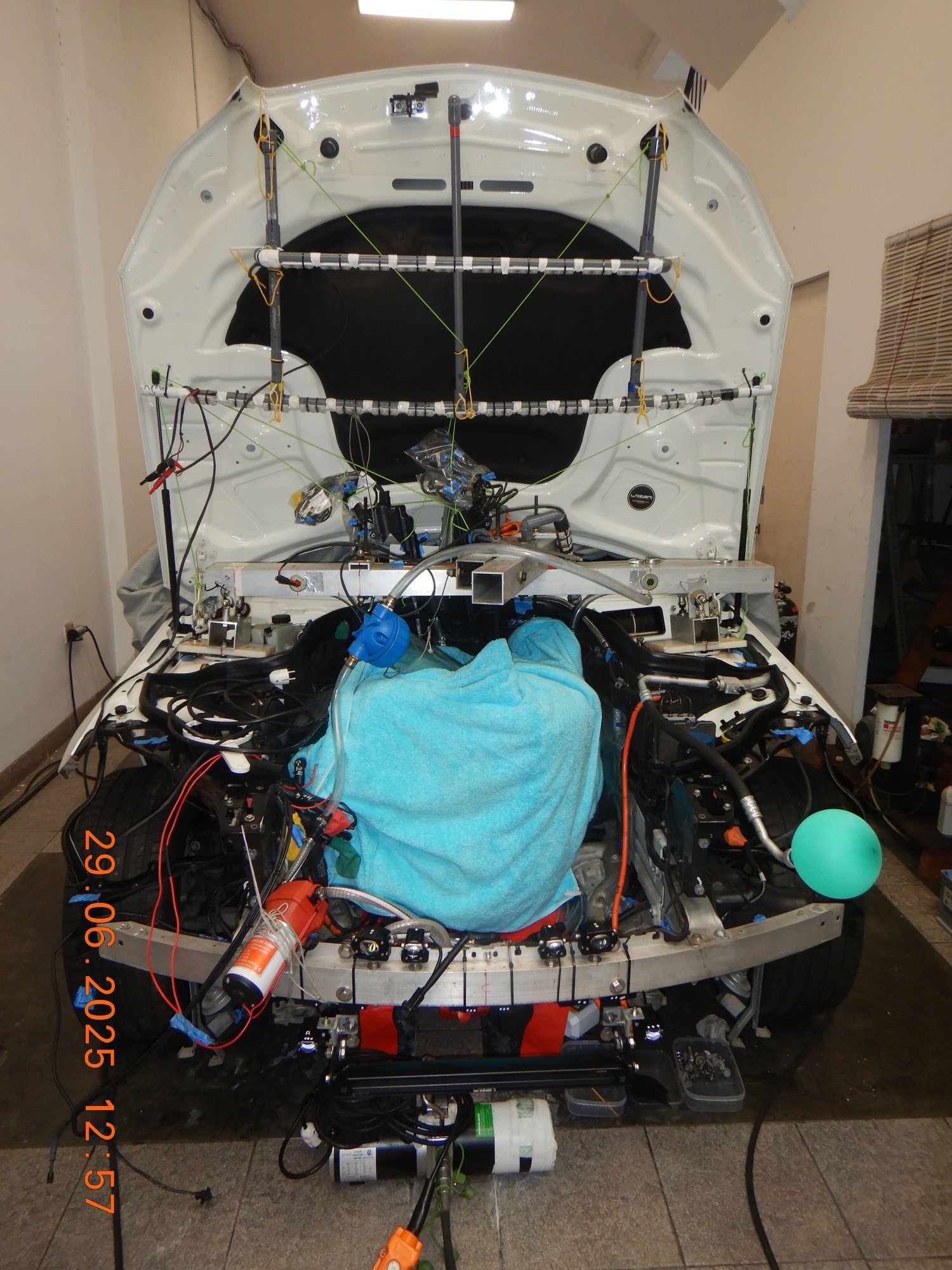

Taking a break for 1 week. I want to run to Bali. It is 22C there now, getting wind from Oz winter.
At that temperature at sea level, for me a Jakarta based dude, is like heaven sent weather....I know its lame for a 4 season country guy...
I also need to take a peek at my friend's recently procured mega yacht. I want to "jerk-off" inside the engine room .
I love mega yachts engine room. The cleaner they are, the more I drool.

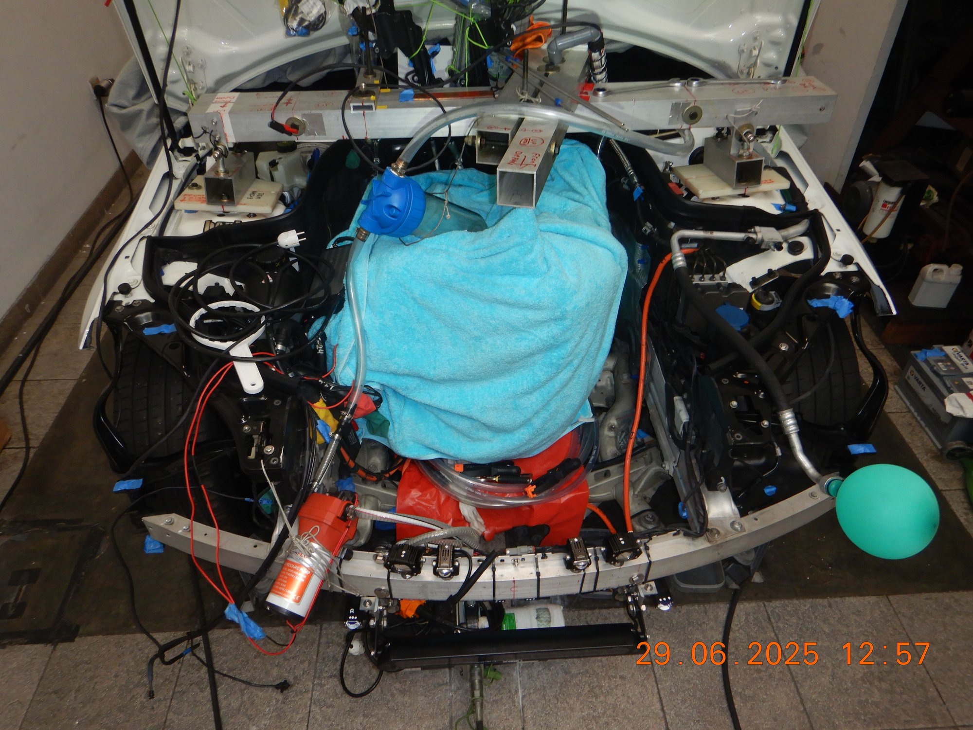

Towels to keep dust off my engine bay. My car cover can't cover the car with maximum open hood.
I am demumifying the interior now. Its up to 70% RH already, not good.

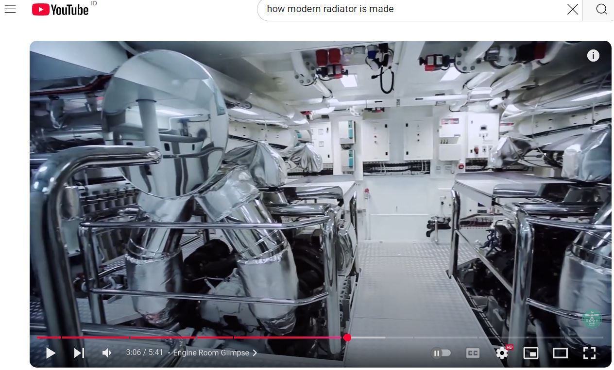

enjoy your time away from this project.
Van you show us what sort of engine room controls they have.
Is that 2x diesels to propeller or to generators with electricly driven props ?
Old Jun 29, 2025 | 11:38 PM
  #66
S-Prihadi's Avatar
Joined: May 2018
Posts: 6,607
Likes: 6,554
She uses Catterpillar C32. Its a V12 diesel and would be the long range duty tuned/rating, only 1,320HP each. In normal yachts tuned/rating this engine is 1,900HP.
Only 140 feet or 43 meters. The hull family is this one : 460 Expedition , https://www.sanlorenzoyacht.com/uk/superyacht/x.asp
This is pure diesel and not electro-diesel like Paul Allens ( Microsoft ) M.Y Octopus which is 414 feet. I would beg to be able to see Paul Allen's M.Y Octopus engine room.
The SanLorenzo Exp 460 sistership engine room is below :
This is production yacht made in Italy and not fully custom yacht like M.Y Octopus, which is built by Lurssen in Germany.
I bet the instrumentation is not as insane as custom long range yachts.
I will take lots of photos of engine room and command bridge for sure.

M276.xx is open deck design, so cleaning the gremlins physically is possible.
The red zone is what my boroscope can see.
Decent working space to send in cleaning brush :
I was looking at cleaning brush :
This is supposedly mild abrassive, 120 grit, 240 grit and 340 grit.
I think this two type of cleaning rods can work.
I should also clean all oil galleries when engine torn open.

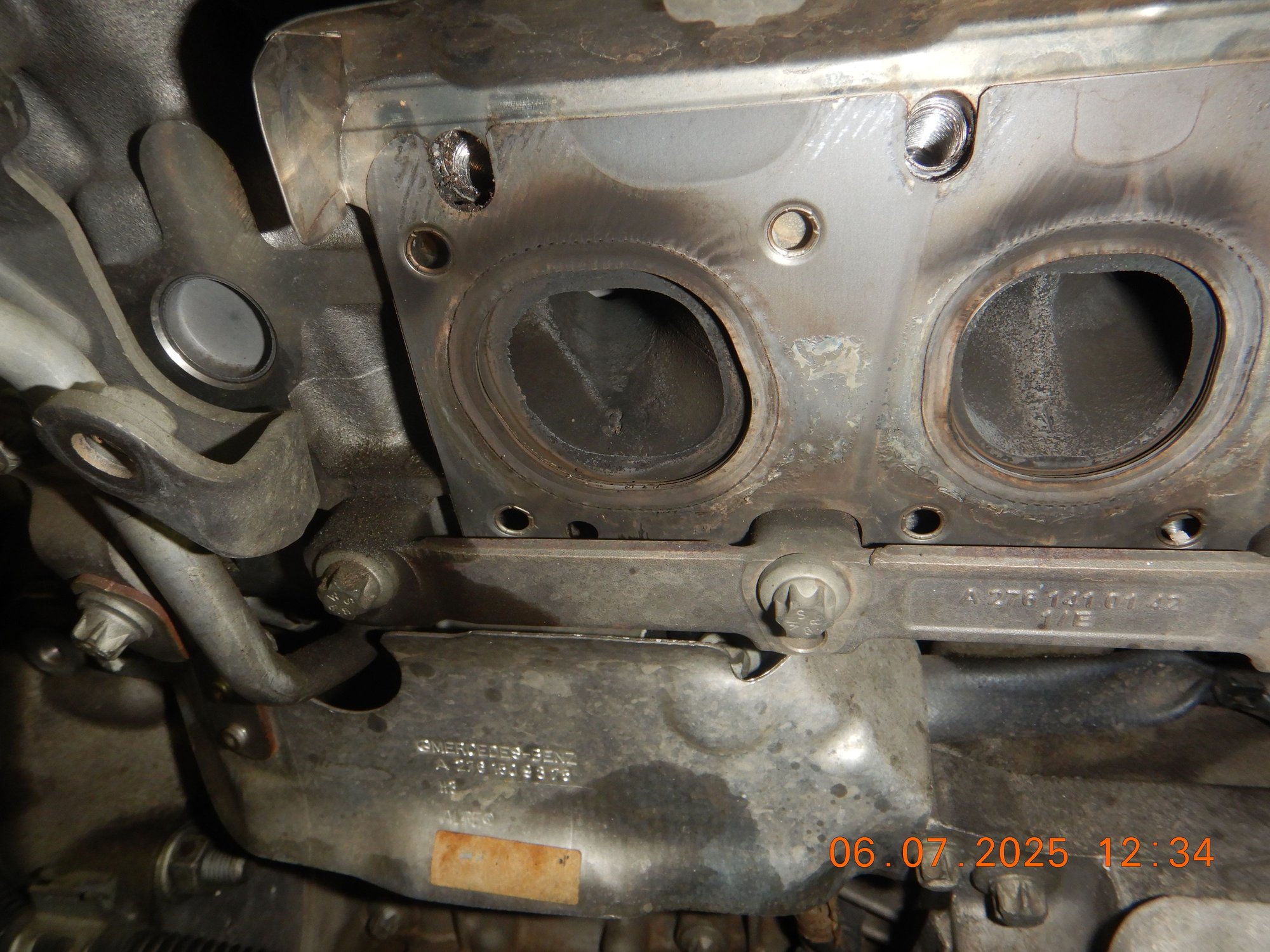

I decided to NOT use the sulfamic acid.
It will damage aluminum, so I read.
Right side turbocharger is out today, so that I can inspect the coolant port corossion better.
This time, 4 of the exhaust stud, 2 decided to stay put and surrender its nut to me.
Because I have removed the LEFT turbocharger, now I know better the preparation to smoothen the process for RIGHT side one.
QUICK WARNING :
If anyone wants to replace only the top side ( INPUT) oil lubrication hose for the turbo and RIGHT SIDE or Bank 1, the hose will never be able to be removed away from the turbo due to space limitation and
the fixed steel shape of the hose ends bends. You need to remove the turbo, or at least loosen the turbo from exhaust manifold to make extra 5-10mm clearance.... DAMN !!!!
The coolant ports on turbo not too bad, this RIGHT side turbo
Clean it with this type of wire brush

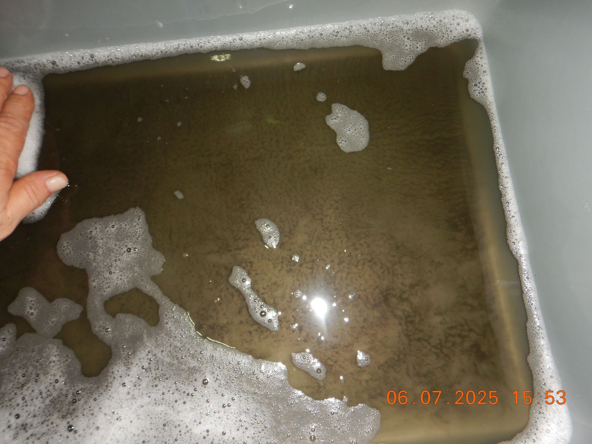

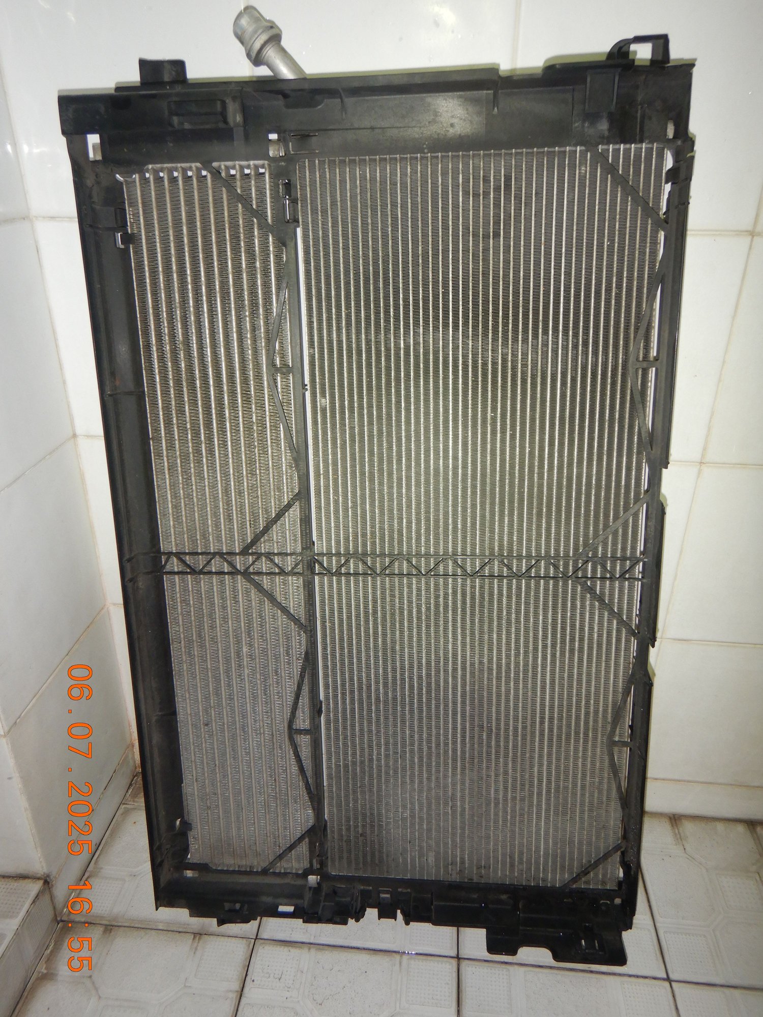

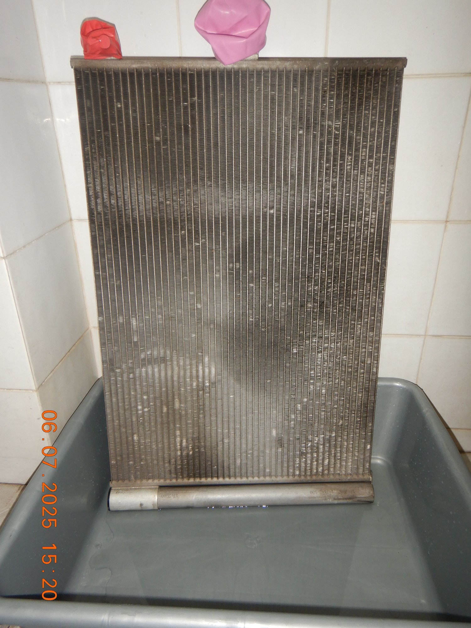

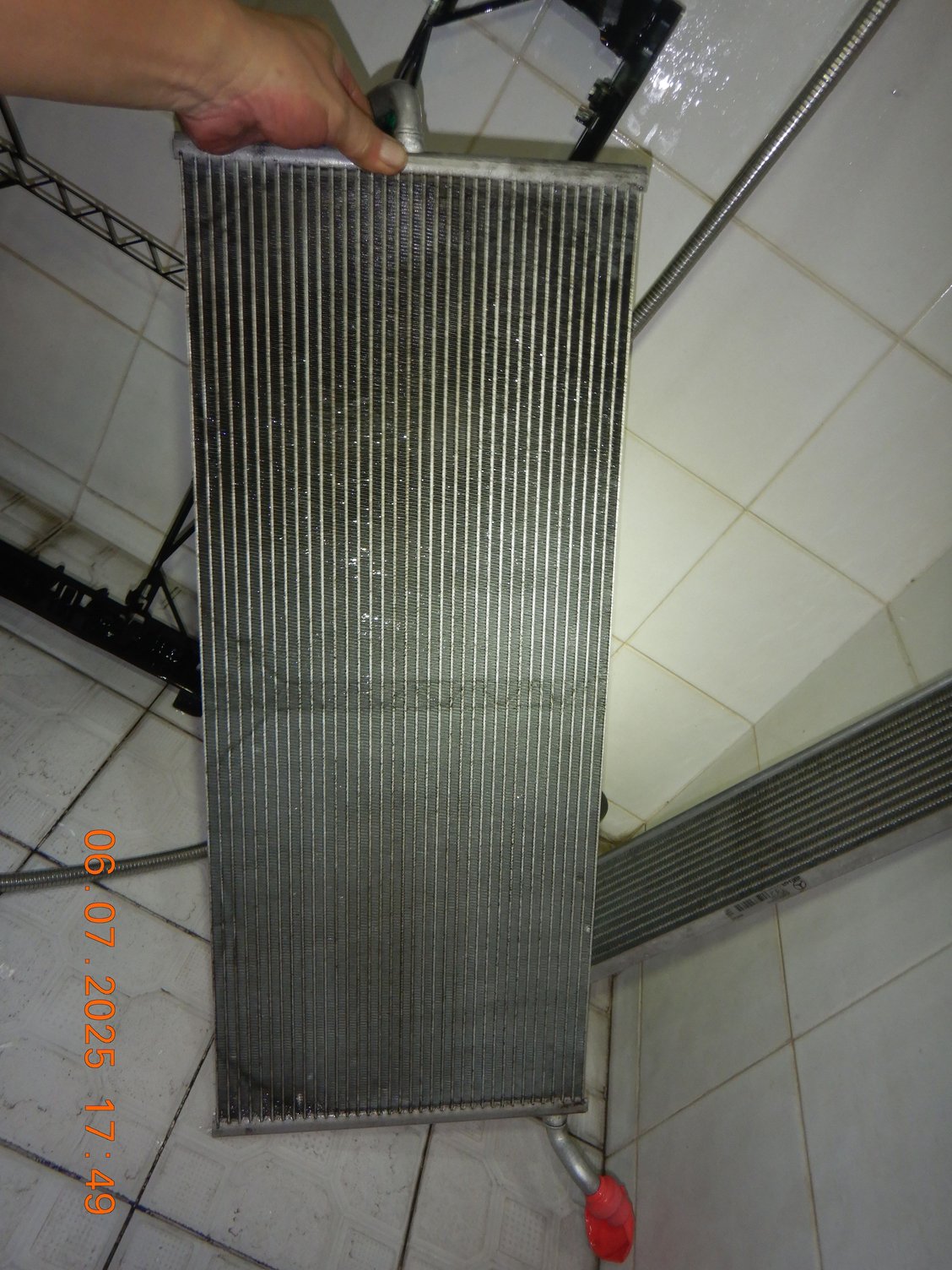

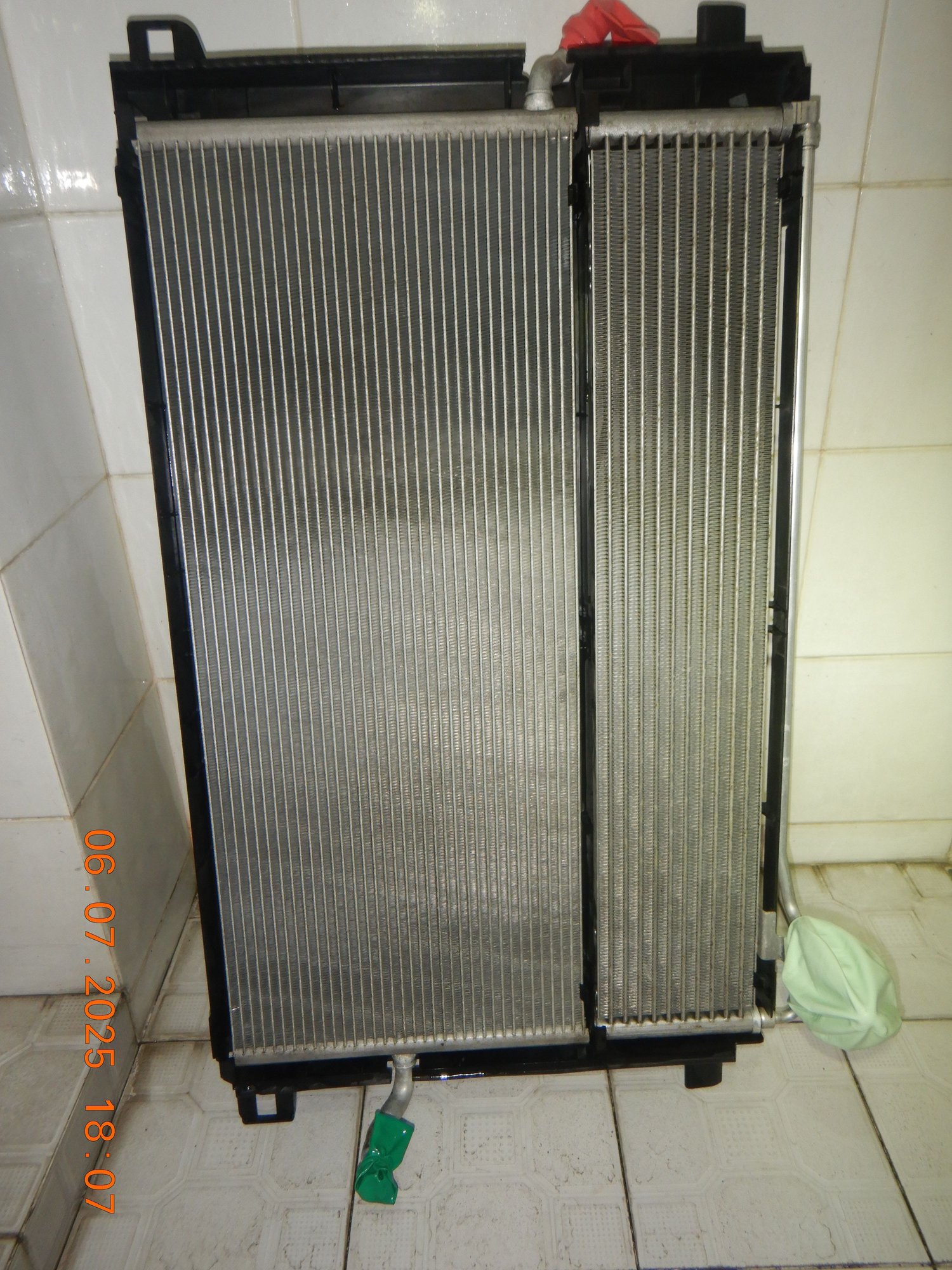

I ended up cleaning the EXTERIOR of my hvac condenser, tranny oil cooler and charged air heat exchanger.
Albeit they look clean, they are not really clean.
Condenser. Simple Green + Dishwasher liquid soap
This brush is very gentle, not bad
Tranny Oil cooler and charged air heat exchanger
Below is round 1# cleaning, another round produced also this much sand/dirt.
Tranny oil cooler
Charged air heat exchanger
CLEANED
I think per 5 years is good to clean all them above and surely the radiator too.
Bugs smashing condenser allows their fats/oil to accumulate at condenser.
Condenser is firts layer, charged air heat exchanger and tranny oil cooler is 2nd layer.
Engine radiator is last layer, the 3rd.
If your engine bay is dirty from leaking VVT mini window and whatever other leak, your radiator can be oily at the fins.
Before I cleaned all above, I was practicing with a a used ( not leaking ) radiator of W204 C200 which I told my friend to retire it at 15th years old.
Tranny oil cooler leak fear. Its a combo unit. Below :
This radiator external is so dirty, it does made it a good practice unit.
The internal of this radiator is so clean, free of gremlins....I am so jelous....why me so bad luck
End of today's report.

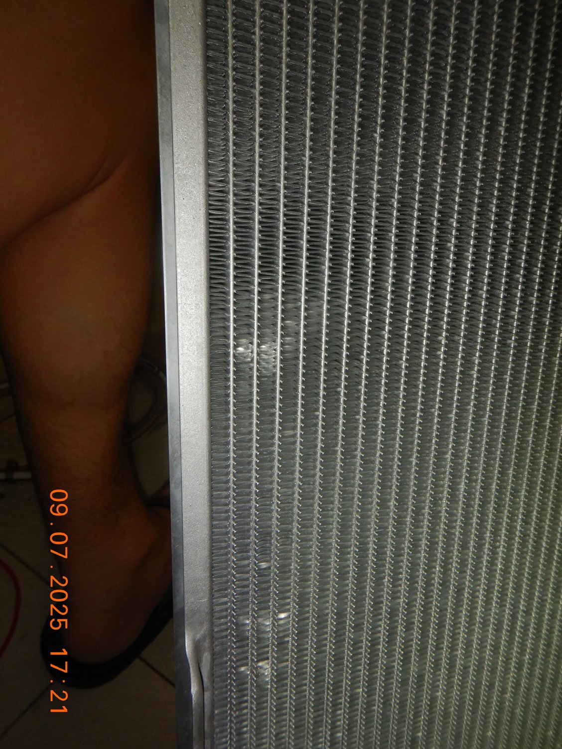

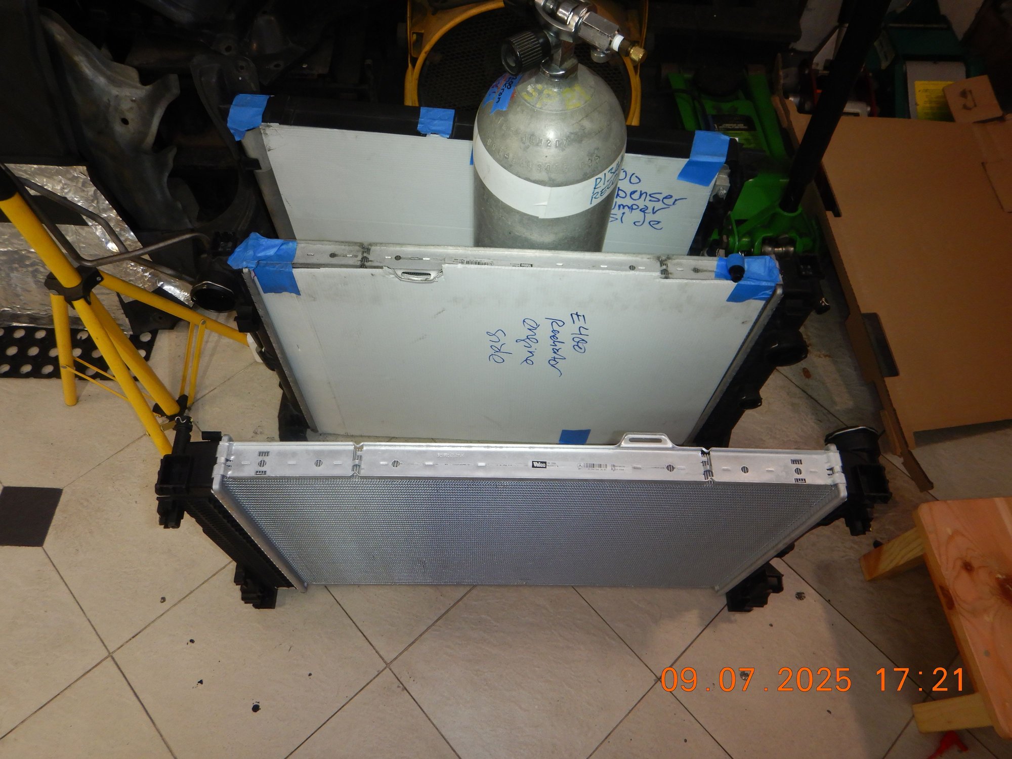

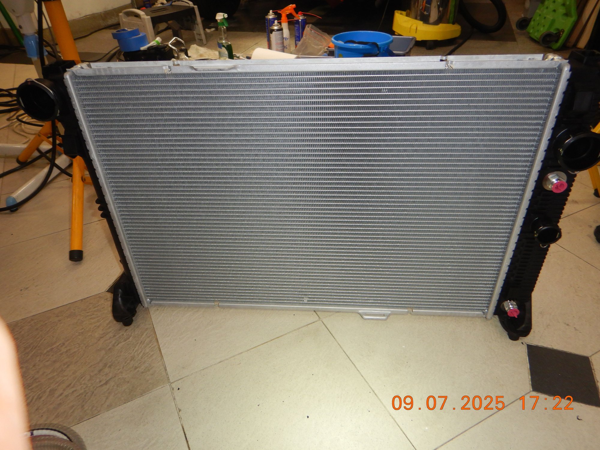

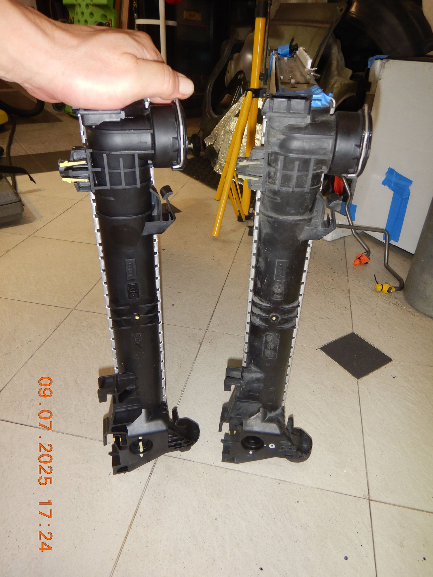

New radiator arrived today, but engine oil cooler not yet, coz I ordered 23rd June and its a 30 days wait.
Radiator was 18th June order.

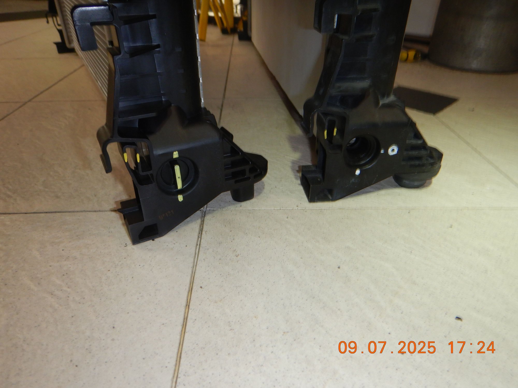

The P/N of the new Valeo radiator matched the EPC and UNFORTUNATELY I got the radiator with tranny oil cooler built in....no choice.
Still there is a mystery as to why my original readiator drain plug female port has no latch .
The new radiator has drain female port has the latch as expected and the drain plug is so easy to spin and automatically pops out 1 cm or so, unlike my radiator which I need to pull the drain plug.
Here is what I mean by latch : ( maybe my latch broken on the old one ??? ).
Even though new, still slight mishandling during manufacturing.

Ugh. The materials that make up the radiator cooling fins are so delicate. It’s almost like breathing on them will bend them.
Since your new radiator has provisions for transmission cooling, will you consider refitting your system to a modified transmission cooling system ?
