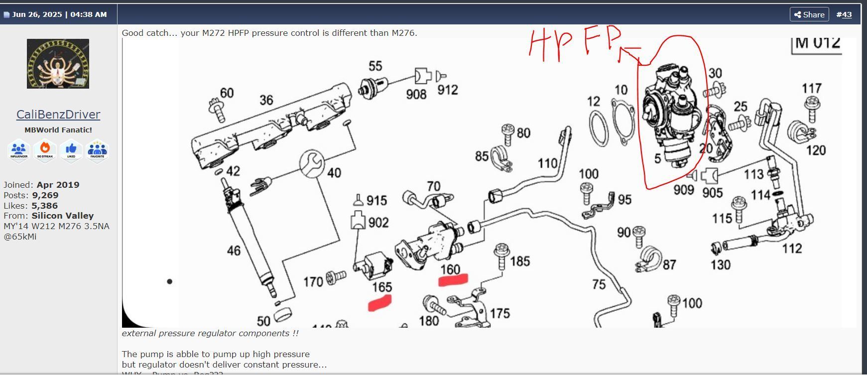

I need to check the values as you said. I was thinking about number 165
https://nemigaparts.com/cat_spares/e...asis=20745769C
Old Jun 25, 2025 | 05:38 PM
  #43
CaliBenzDriver's Avatar
Joined: Apr 2019
Posts: 11,964
Likes: 6,806
From: Silicon Valley
W212 MY'14 M276-3.5NA @75kMi
Good catch... your M272 HPFP pressure control is different than M276.
external pressure regulator components !!
The pump is abble to pump up high pressure
but regulator doesn't deliver constant pressure...
WHY... Pump vs. Reg???
Old Jun 25, 2025 | 06:11 PM
  #44
Dokus's Avatar
Joined: Apr 2018
Posts: 496
Likes: 42
From: Sweden
W211 e500 (Sold), w204 c180, w203 c180, w201 190e, W219 CLS 55
I will contact the Indy tomorrow and ask for a diagnosis with xentry.
Something I do not understand if this is the problem:
Why don't I notice any power loss at full throttle?
Why doesn't I have any real change in pressure when the rpm fluctuation occurs at steady speed, it stays around 20 000 psi +- a few hundred.
Why did the car work ok for a while after I fixed the bad o ring and had the battery off? The problem came back totally random when driving on the highway at around 130 kph for about half an hour.
Is it common for high pressure pump to fail at this milage? Car only has around 62 000 miles. Always serviced at MB.
Let's hope for the reg if anything of those. Even though the reg is ridiculously expensive as well.

20 000 psi is way too high.
The rail pressure needs to be regulated so fuel can be metered precisely: Not +/- 1000.Psi range
It can still be many other things to do with ignition and computers.
The fuel pump normal lifespan is longer than 60kMi.
You do have a fault that points to fuel delivery - That's were this issue landed you.
What's making your rail pressure so wild:
the HPFP pump or it's M272 external regulator or the sensor ??
M272 GDI fuel rail
M272 GDI fuel rail
Bad sensor would allow a well regulated pressure to be reported as bad.

You are getting it....
rail pressure pegged at 3000Psi 30% too high!
pressure regulator sits at 0%
WHY is that...
How does this regulator work, with a diaphragm??
Everyone can jump at the bad regulator but maybe the pump is poorly controlled and killing its regulator with a high output.
I don't know this particular pump + external regulator.
Try to figure what controls if any are on the pump itself.
Basically the working ECU control is unable to regulate down the rail pressure.
