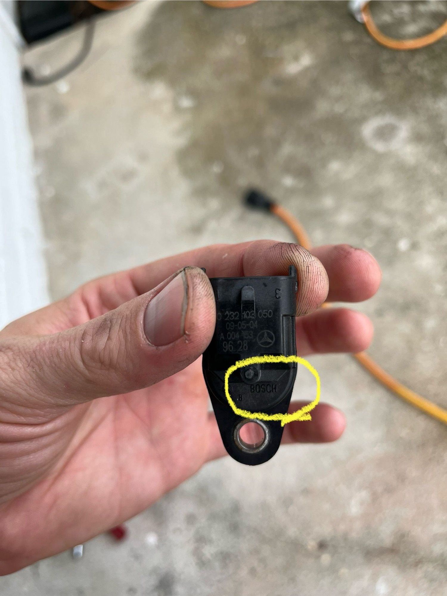

Can you compare old vs. new CPS sensors??

I bet misfiring will go away with good/working CPS.
Well I tried cleaning out the CPS connectors real well with electrical cleaner spray, now its having trouble even starting and staying running...

haha no I bought them from the official Bosch Automotive store on amazon:
Amazon Amazon
I even swapped out some of the old OEM sensors to see as you suggested and the same codes / misfires are happening.
The OEM ones even say Bosch on them (see picture)..
Im beginning to think its the harness or ECU...
Another guy I talked to mentioned maybe something to do with the timing of the engine but I'm unsure about that..
Yeah, you're running out of good options... did you say the ECU got little oil or a generous amount of it?
