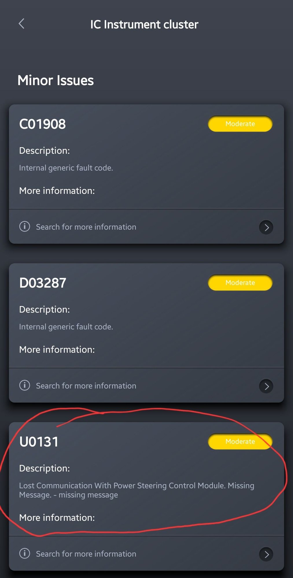

-I have not ever received any instrument cluster errors like the common "Power Steering Malfunction" message many report, however, the day I purchased the vehicle at the dealer, I scanned it with Carly for MB and I found 39 trouble codes, all seemingly related in some way to the battery>assumed at the time the vehicle had probably sat (dealership had it for sale since July 2024 according to VIN report) and main and/or aux batteries likely drained below threshold>cleared these codes and didn't worry about it, but have not re-scanned vehicle since (will do so later today and report back). However, I have not had any issues with any vehicle systems, electronics, etc. not working other than the backup camera (which sometimes says "not available" and other times works fine) - I happened to review the code history again this morning - 3 specific modules that reported codes related to the power steering system, steering column and backup camera were present which I didn't think to look for beforehand, which I found interesting, will attach screenshots of the codes

-I am wondering at this point if the battery voltage issues indicated by the codes (even after having been cleared day of purchase) could be causing the horrific grinding/whine from the electronic steering rack, the steering column up/down adjustment issue (I'm aware of the stuck 13mm nut fix, haven't pulled the underpanel to check if that's the issue yet though) and the intermittent backup camera issue? If so, how would I properly discharge both batteries to reset the system if that might help?
