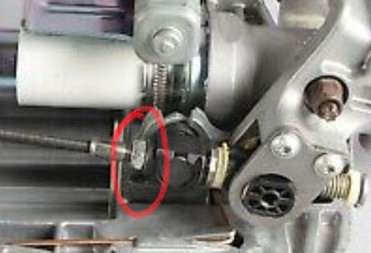

W212 TILT COLUMN
the nut circled in color is the defect that cause steering column-tilt to get stuck over and over until nagging feature is disabled from setup menu.
disfunctional tilt column
nut self tightens to jam mechanism
Once loosened, 1 Mo later... bingo again.
So what would you recommend? Because I really need to be able to adjust the up/down height of the steering wheel manually. I don't care about any convenience auto-adjust feature (I'm also not sure where to turn this off, if you could point me to how to do that?). Advice? Thanks.

That nut is self-tightening ... that's the only issue.
Don't buy replacement: this is defective all new.
Simply GLUE THE NUT so it does not tighten itself during Up/down motion.
It needs a little functional freeplay so its not tight, nor loose.
If you only loosen the nut without glueing it,
then it will get stuck again after a while from in/out "convenience entry".
