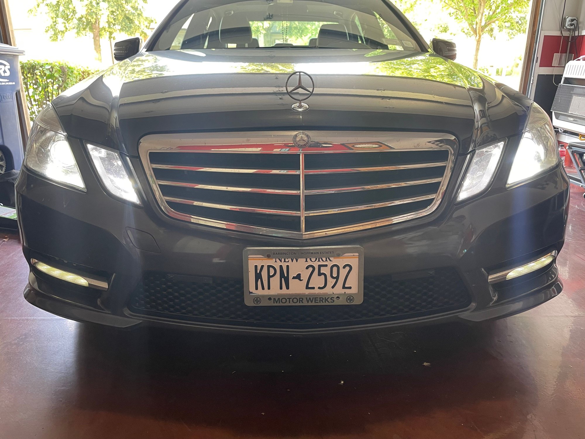

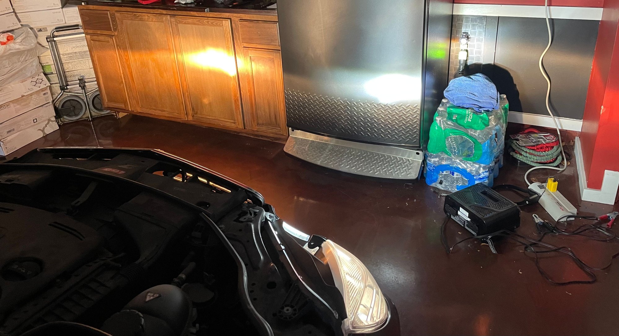

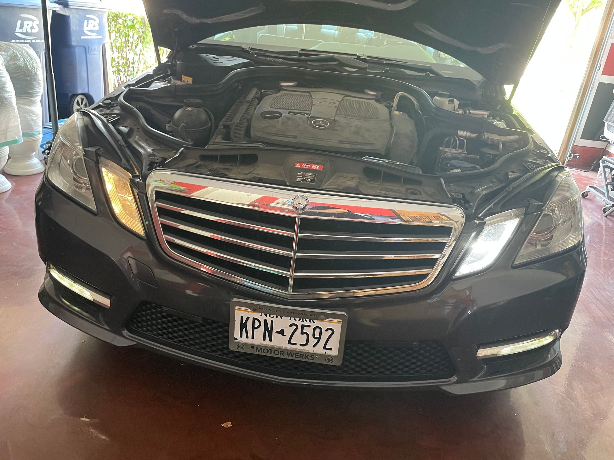

LED bulbs successfully installed in place of high beam halogen bulbs!
Started by installing the Lasfit H7 led bulbs in place of the high beam bulbs first because ofcourse they are much easier to access, and happy to report they fit perfectly in the factory bulb adapter, were vertical after locking the bulbs in place, and worked perfectly with no errors in the instrument cluster!
The first time I turned them on after install they did start flickering a little but, but after about 2 or 3 seconds, the flickering stopped, and they were lit up perfectly. I’m assuming the cars CANBUS system was adjusting for the different load/wattage of the new bulb, then everything was ok!
I then tested turning the high beams on and off several times after that, along with turning the engine on and off and getting out of the car and locking it as well, to make sure that flicker wouldn’t keep happening every time I turned the high beams on or flashed them, and they worked perfectly every time after that.
So if you install these LED bulbs and see them flicker the first time you turn them on, don’t panic, it will stop after a few seconds after the car adjusts to the new bulbs.
Will be replacing the low beams next with the same bulbs and will update you guys after those are installed as well. Crossing my fingers the low beams don’t cause any issues either, and then all the headlight bulbs will match the DRL LED strip’s which imo will make the car look much better and more modern.
Lastly, I know some people think LEDs don’t actually provide more visibility and/or light output than halogens do, but I can already see a huge improvement in visibility with the LED high beam bulbs vs the halogens.
Quick test to see if there were any issues after first LED bulb was installed, on the passenger side, and after the initial flickering stopped, it looked perfect!
Quickly compared the difference in the shape of the light output, sorry not a great picture, but looked pretty similar with the LED just slightly bigger
After both LED high beam bulbs were installed, they look great to me here and not blindingly bright… also perfectly matching the factory LED DRL’s!

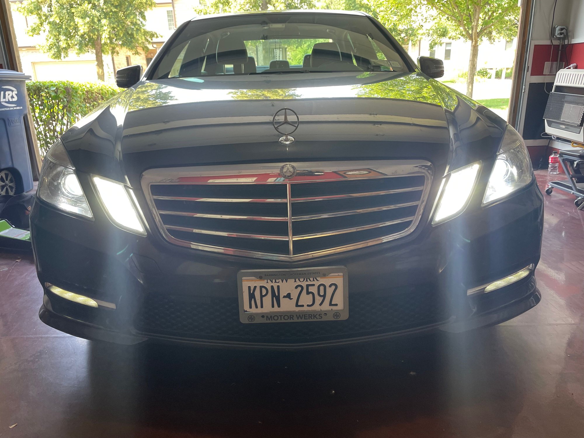

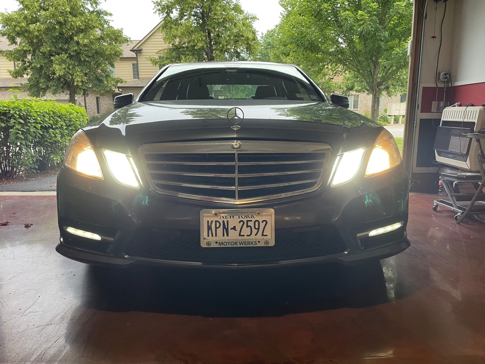

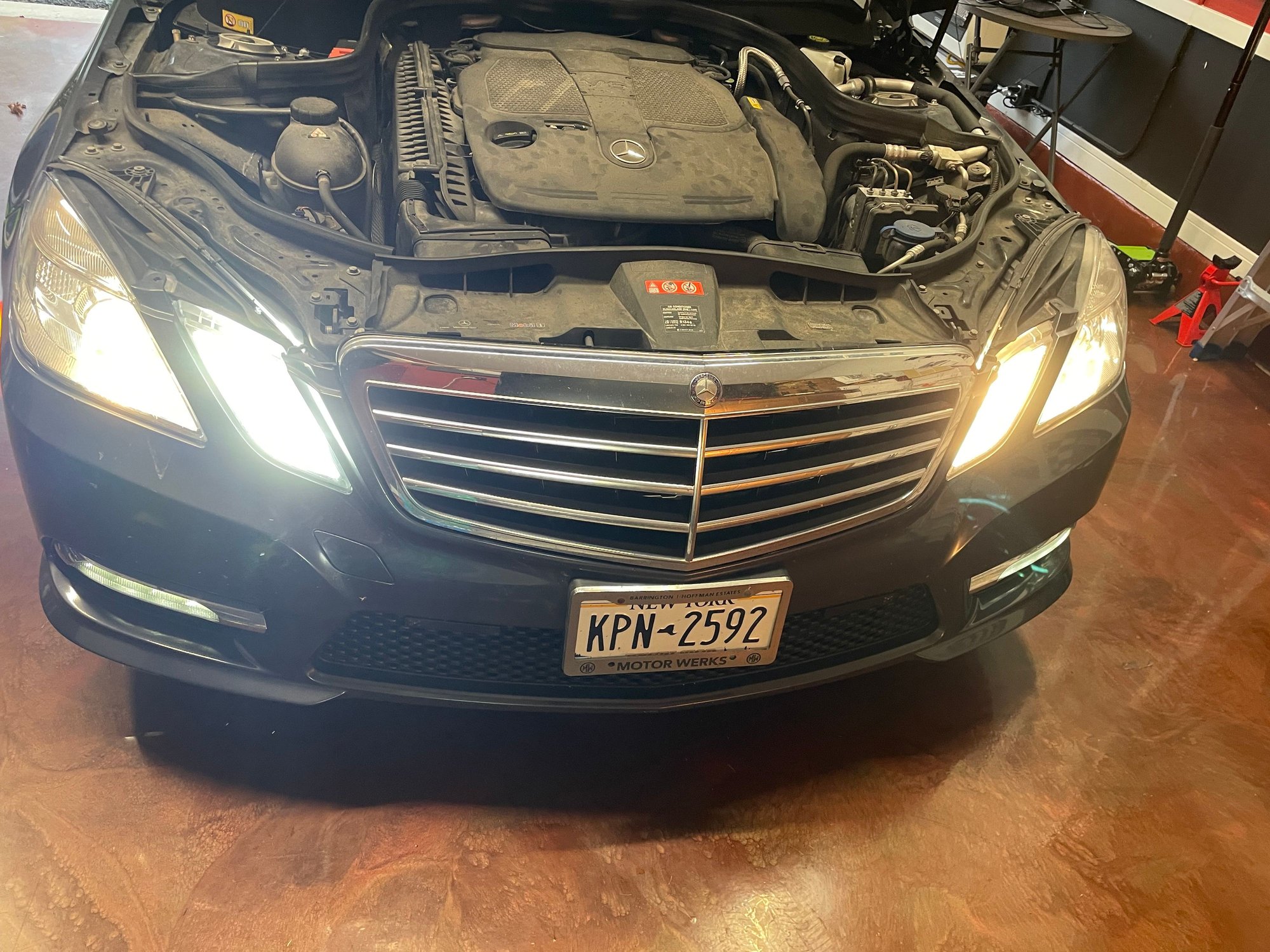

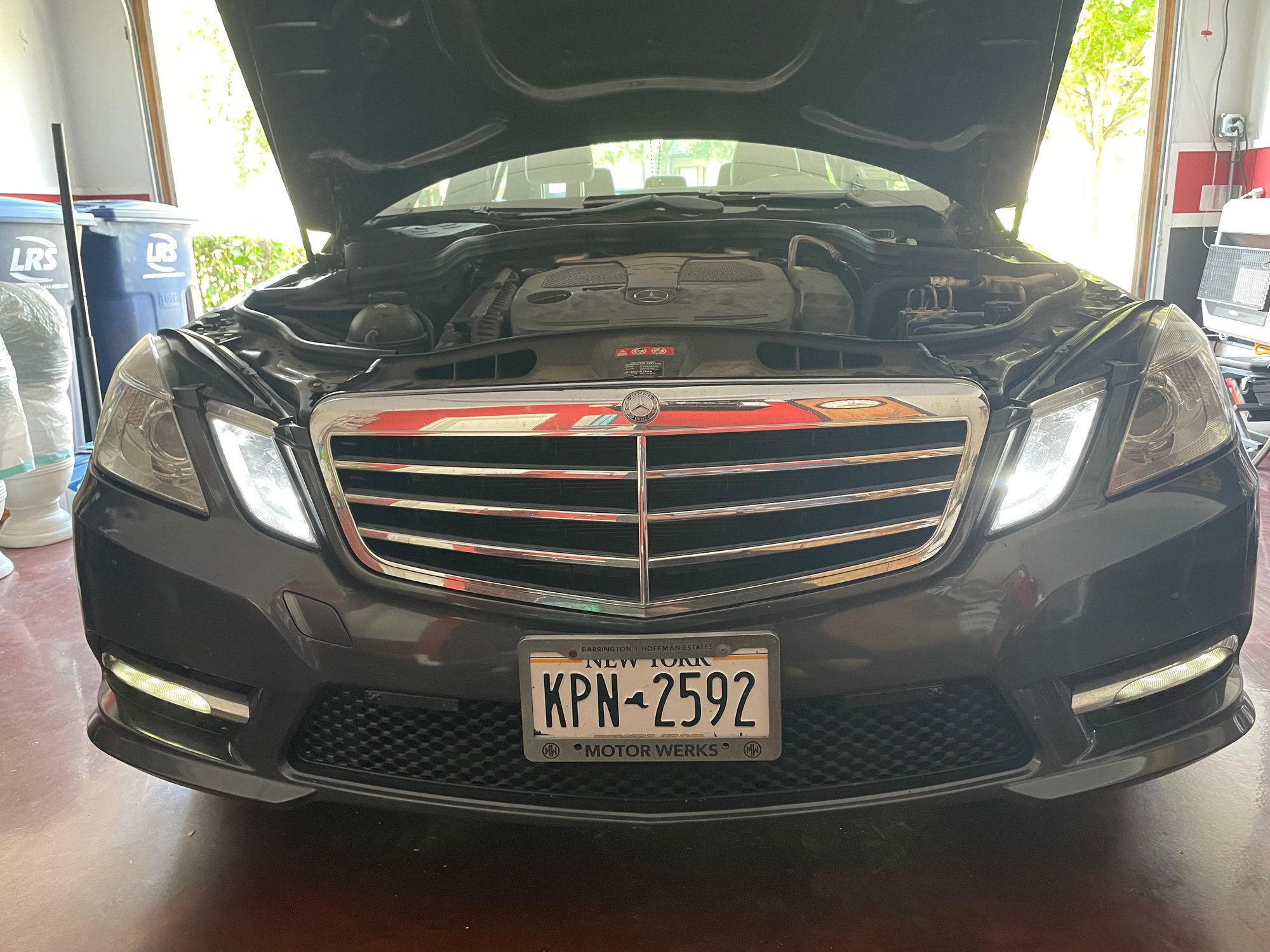

On to the parking lights next, which are last ones I’m gonna swap to LED. So far swapped 4 - H7 bulbs and 2 - 194/2825 bulbs. Car looks 10 million times better now, imo.
One parking light replaced with LED
Both in now, wow, much better
This is with headlights on, “auto”
Headlights on, and high beams on
Reply 2

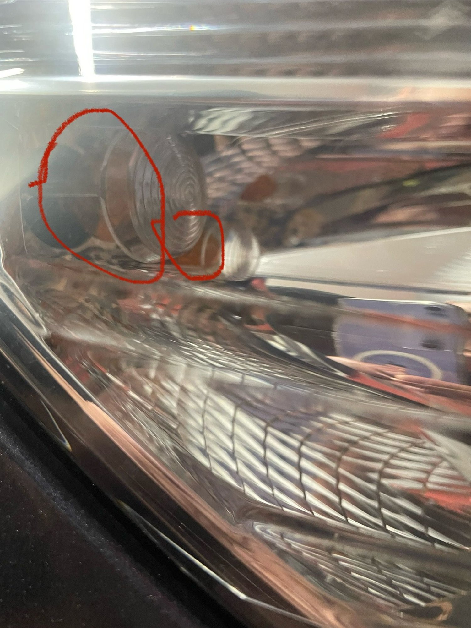

Today I realized that it looks like there are 2 different turn signal bulbs in the headlight housing and the amber bulbs in the reflectors (on the sides of the front bumper cover) do not flash with the turn signals, rather there is an LED strip in the driver and passenger side mirror that flash with them. If I decide to replace these, will only need to replace the 2 turn signal bulbs in the headlight housings and be done (4 bulbs total, 2 amber LEDs for each side).

Jul 26, 2025 | 11:21 PM
Why 2 turn signal bulbs?
Since I’ve solved the low beam bulb problem with the excellent Sealight H7 LEDs, I’ve already moved on to the amber turn signal bulbs, not sure why there would be 2 right next to each other in each headlight housing, but even stranger, it looks like one is size 3457a, and the other is PY21W? Can anyone confirm this?
Btw, I’m now purchasing all LED bulbs from the Sealight brand assuming this brand will be my best bet to avoid any CANBUS errors.
picture of the 2 amber bulbs in the headlight housing circled below…
Why is there 2 front amber turn signal bulbs on each side?
Why is there 2 front amber turn signal bulbs in each headlight?
