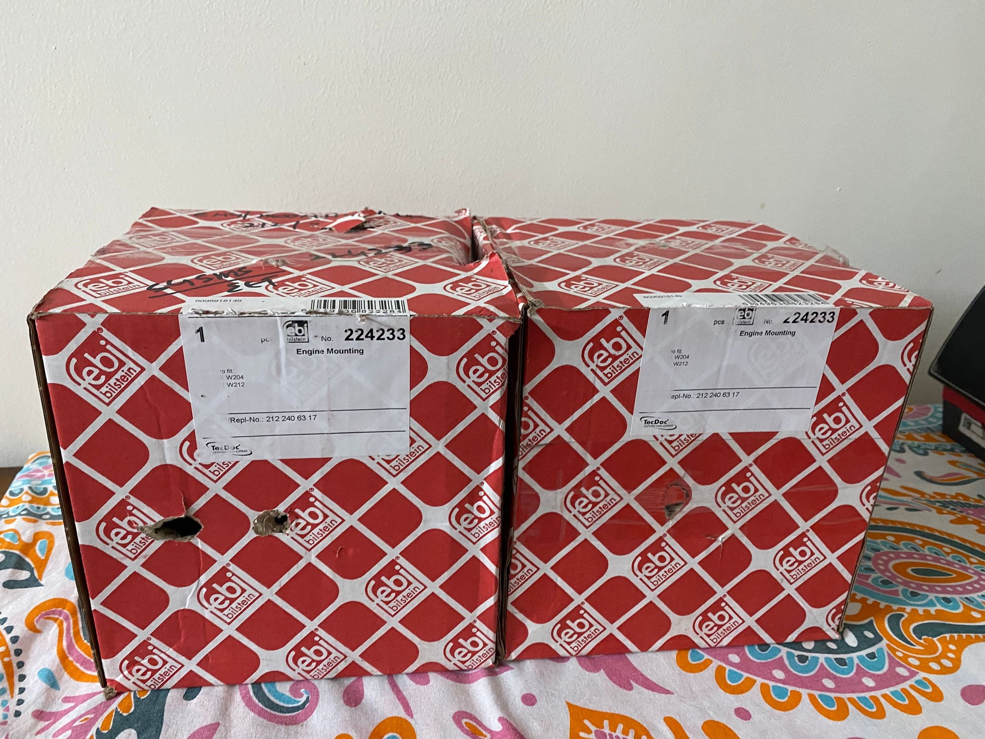

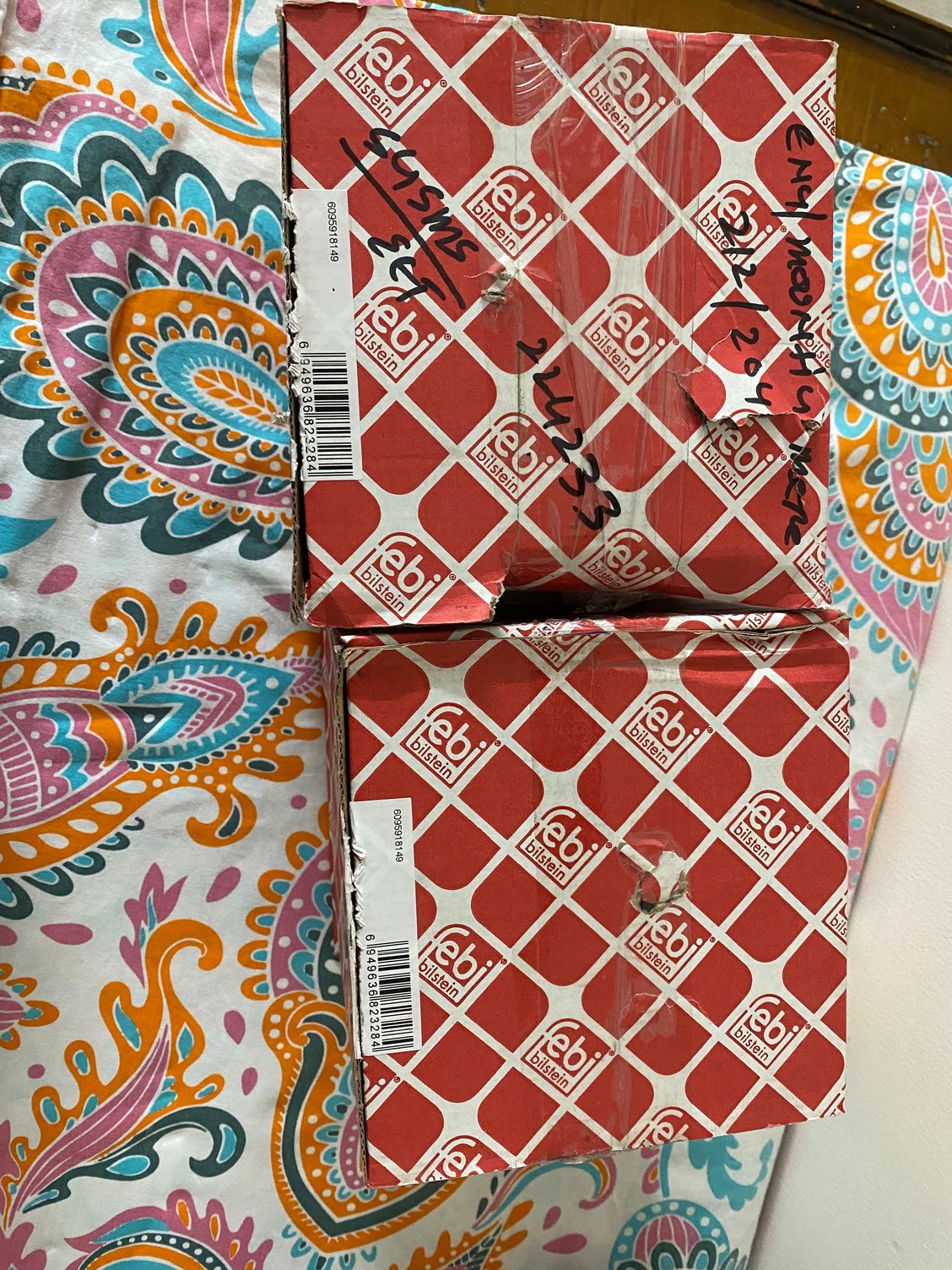

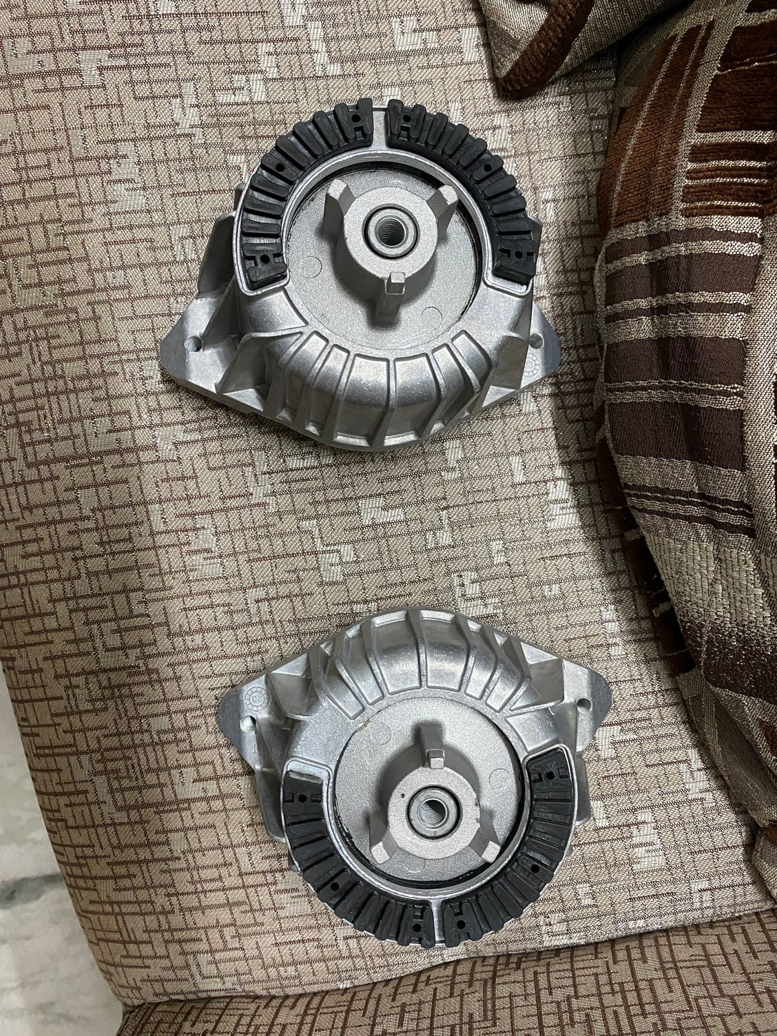

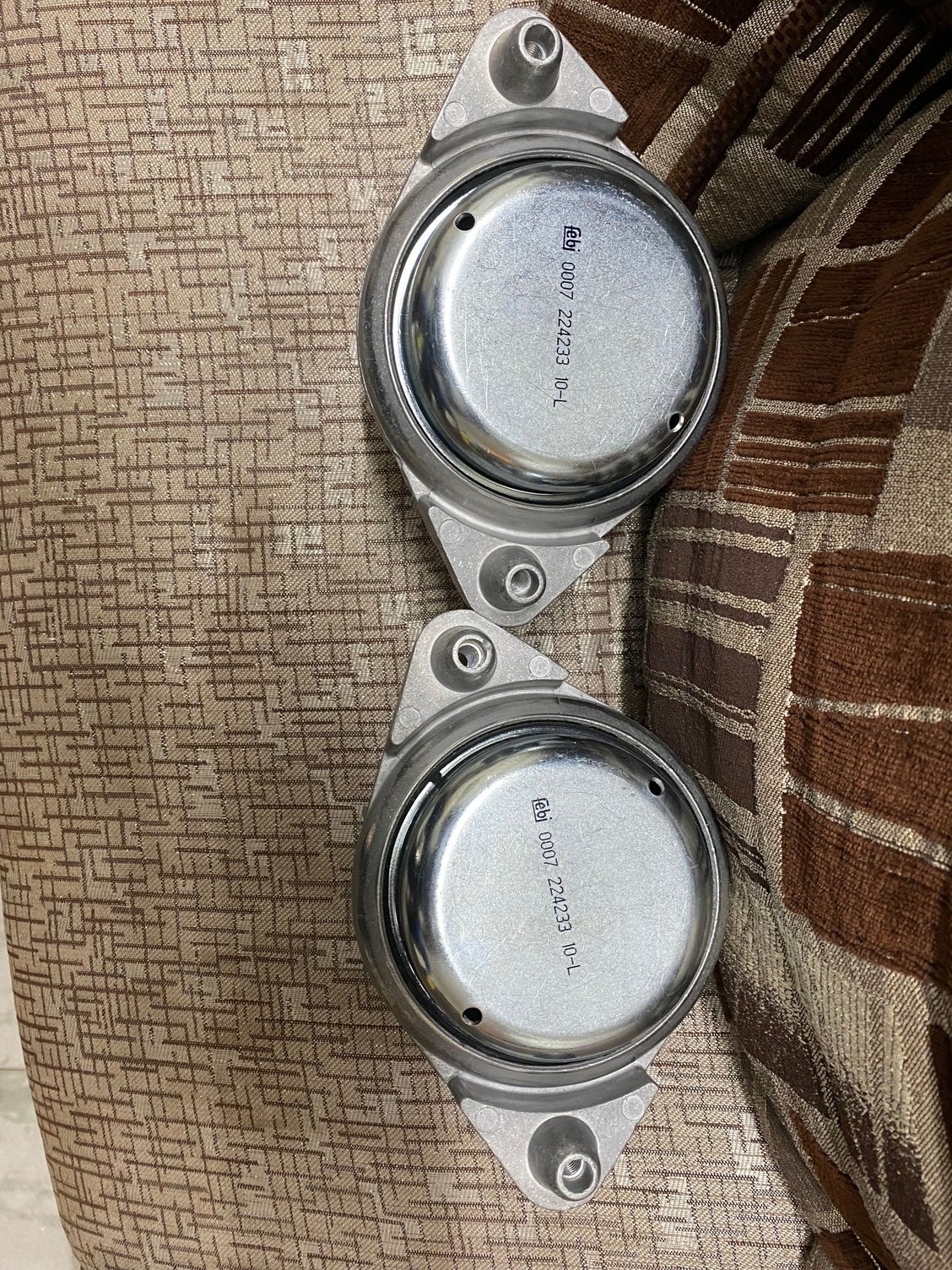

I recently purchased a pair of engine mounts for my 2014 Mercedes E250 W212 (Febi brand). I have a few concerns and would really appreciate your advice:
  1. Both mounts have the exact same part number, but they came in separate boxes. Shouldn’t there be a “LEFT” and “RIGHT” designation? There’s nothing written about left or right on either box or the mounts themselves.
  2. Are the mounts supposed to be identical, or are they usually different for each side on this model?
  3. I asked the shopkeeper, and he said it’s completely normal — that they use the same part number for both sides.
  4. I also tried searching the part number online, but I couldn’t find clear information regarding left/right fitment.
Should I keep these mounts, or do I need to return them and get different ones for each side?
Has anyone else faced this? Any guidance would be really helpful before I go ahead with the installation.

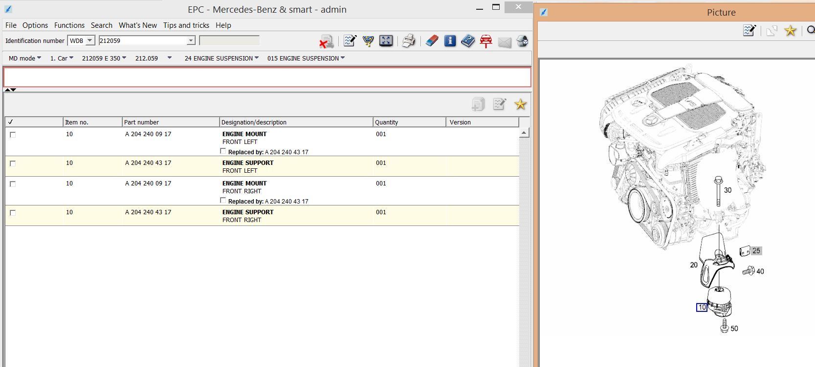

Must check EPC and your VIN.
Often both are different P/N , mine is and so is M276.9 3.5NA type W212 chassis code W212.059
M276.9 3.5NA engine. Same for both.
My E400 and a C200 W204 engine mounts P/N
BWT, Febi qualty I read is not so good. But since you already bought it, use it.

Originally Posted by Spruze
WDD2120036L035438
I am really confused and worried should I get mine installed or replace them with some other brand? Can you please confirm with the VIN that are they identical? Because I am sure the MB p/n are also different but in real do they really have a difference?
Here u go...... see different P/N for Left vs Right
So in India the MB cars ( unless true AMG ) is also locally assembled like in Indonesia ?
Get genuine MB mounts...... u will sleep well.
